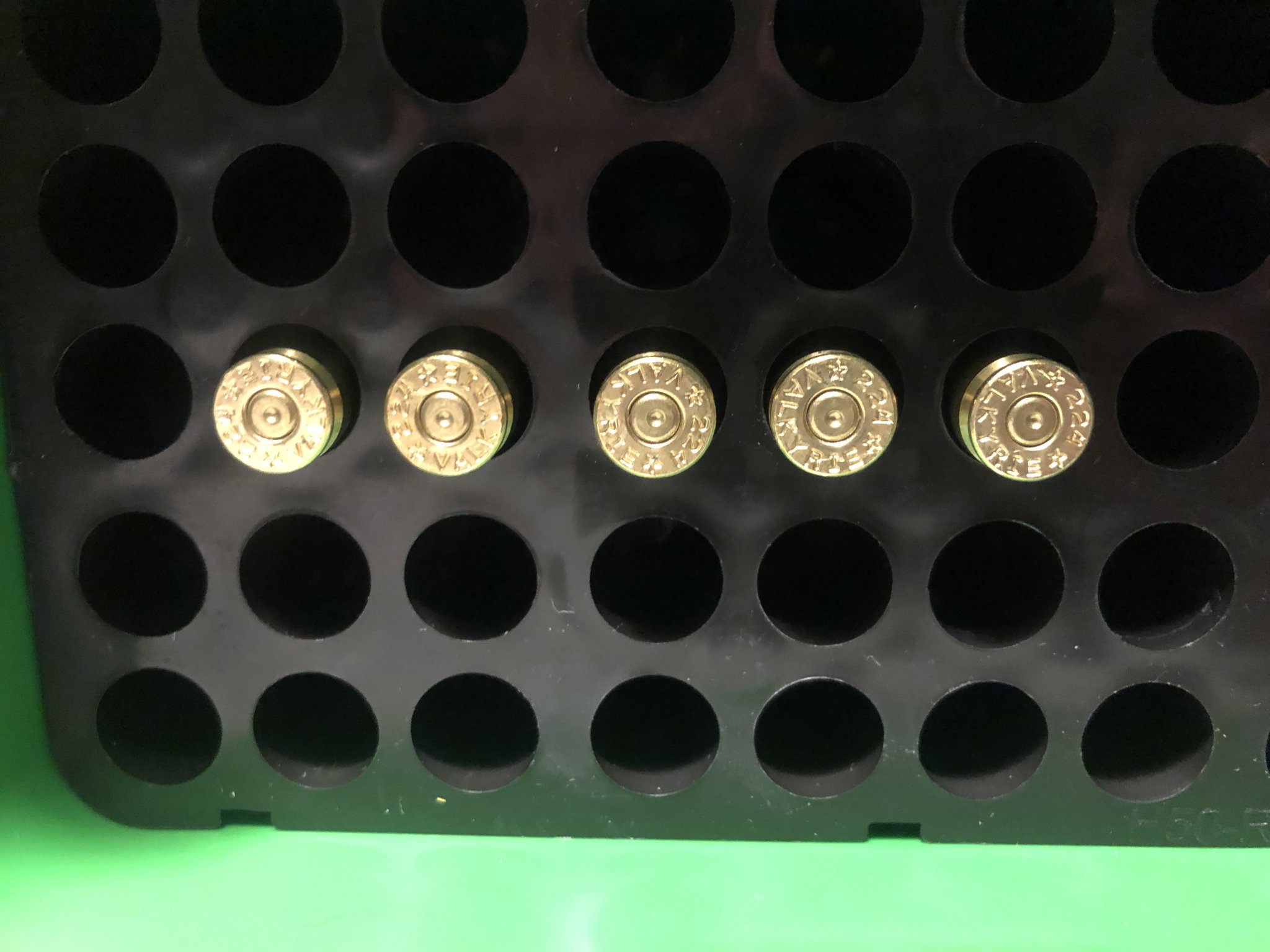

Going to load three each at 27.2, 27.3, 27.4 to test tomorrow. Here are pics of the brass (left to right low to high charge) and group from the last five shots 26.5-27.3.

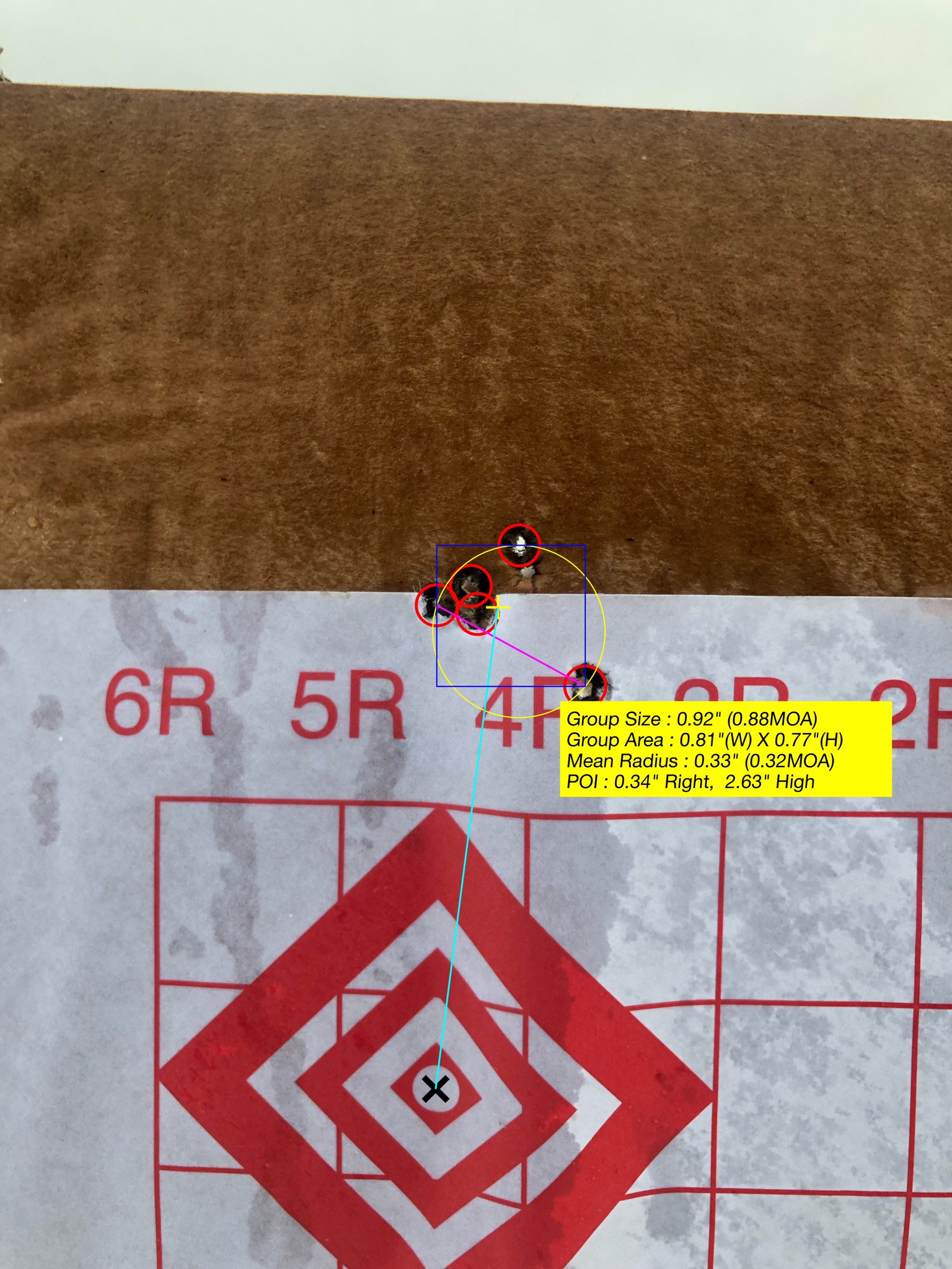

Well...I finally broke down and bought a Craddock Precision Rock Creek 6.7t 20" +2 in .875 Dia barrel. From what I've been seeing from others on here...CP is the way to go for the 224 Valkyrie. Does anyone have the Rock Creek 6.7t barrel here and how's it shooting?
I also have the Rock Creek 20" and full upper from Paul Craddock. I have been trolling these forums for a few days looking at starting load points. I have not spent any range time yet. I am waiting on a few more components before I get the rifle finished. I think I am going to start out with 88ELDs and CFE.
I bought this set as well. I am haven't loaded anything yet, tomorrow looks like the big day. Its my first set of Redding dies. I will post up once I get some loaded and rounds down range.
You will need the vld seating stem 09183. I like them so far, the amount I've used them. After I get my own reloading room/man cave done I've got some new techniques and tools to help with consistency/runout, and es, sd numbers. I've had good luck with cfe accuracy but its a temp sensitive powder and I haven't played with it enough yet. If I was to do it again I would get different dies, like a forester seating die, FL bushing die of some sort.
I have my cave set up. I have few additional items I apparently need to pick up. I have been prepping 224 brass this morning. Looks like I need to get the seating stem ordered, hopefully it will come in this week.
I guess I will hold off going to far and load some other stuff.
Thanks for the input.
Just finished my first range trip with reloads with my Craddock 24” 1-6.7 bartlein upper. I think there are some promising results. Everythkng is real conservative nothing over max. No pressure signs observed.

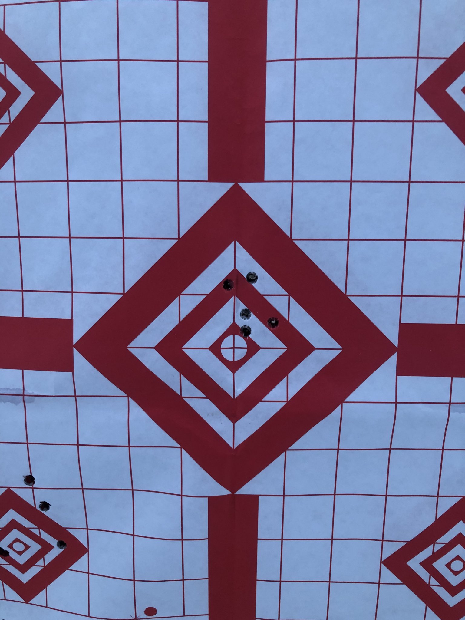

Settled on my hunting load using 77 Barnes LRX and CFE223. Here are my specs:
24” Bison Armory 6.5 twist, 0.089” gas port, Odinworks adjustable gas block at 13 clicks from seated allows lock back.
26JAN2019 39.9F, 78%H, 30.17inhg
224 Valkyrie virgin starline
Rem 7 1/2
CFE 223 @ 27.2 grains for 2942fps, sd8
HbN coated 77 LRX @ 2.265”
Again I will measure the jump when my oal gauge gets here but I am guessing it is 0.040-0.050” off the lands.

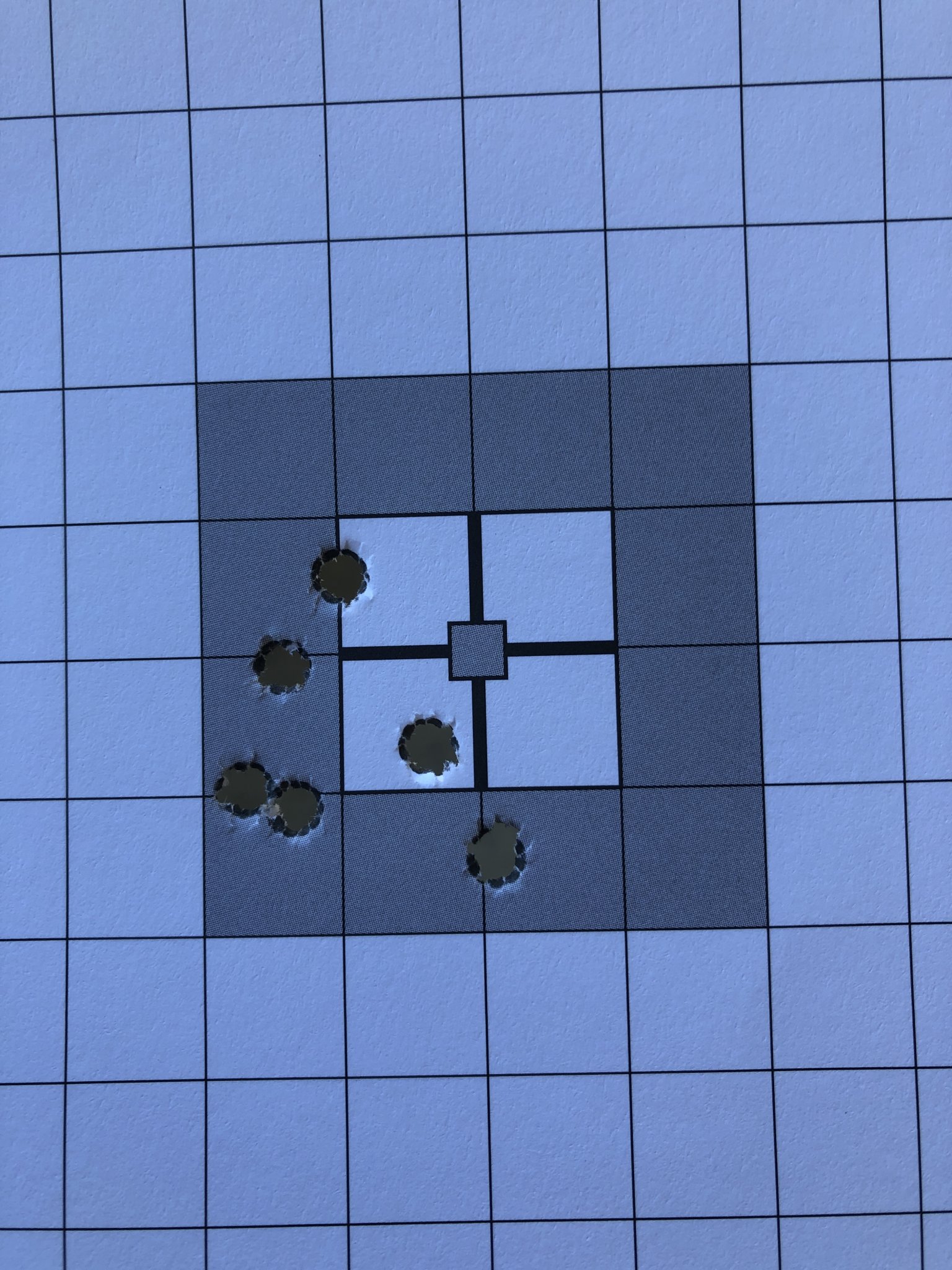

Settled my 88 eld-m load as well today. Hoping the sd will drop with once fired but she shoots well enough.
24” Bison Armory 6.5 twist, 0.089” gas port, Odinworks adjustable gas block 15 clicks from seated for lock back
28JAN2019 33.8F, 99%H, 30.39inhg
Virgin starline run through forester sizing die and chamfered
Imr4320 @ 24.5 grains
Rem 7 1/2
88 eld-m @2.320” I am guessing 0.030” jump
2705fps, sd25
Without the pulled shot the group is .55” and the cluster of three are .23”. Thinking I can get this shooting more consistent once I start using once fired brass. Still waiting on oal gauge to confirm jumps. I have 90 and 95 smk’s to work up next but waiting on the gauge.

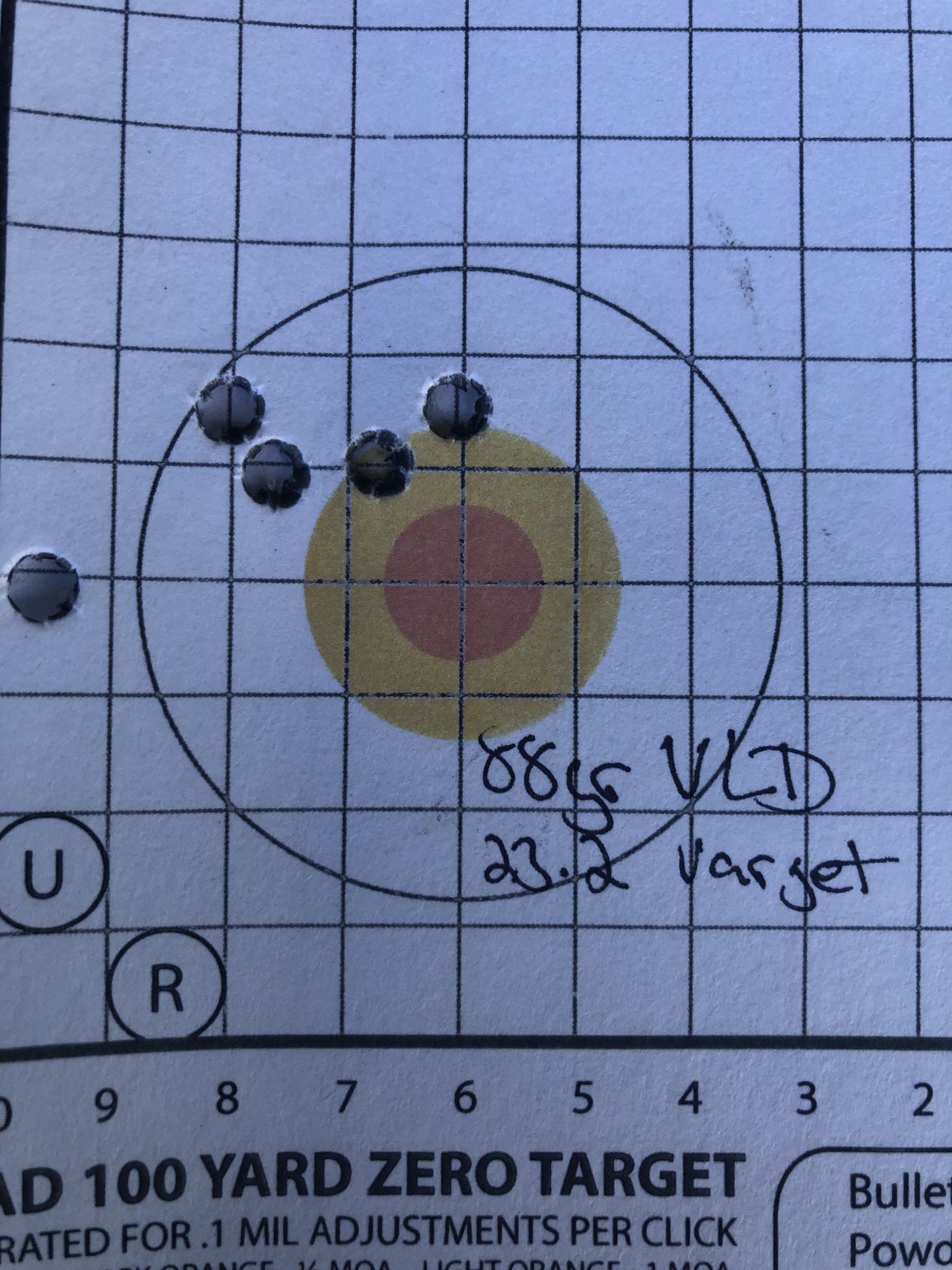

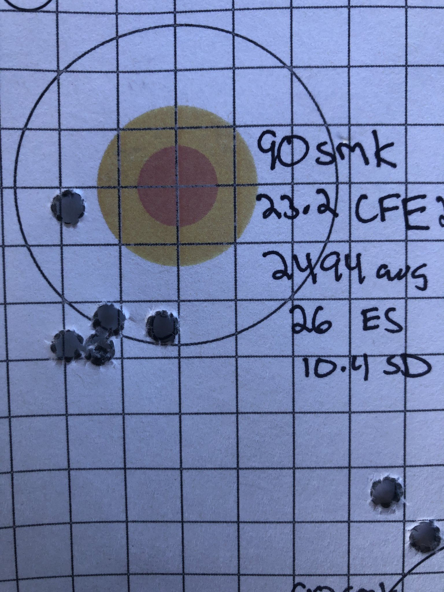

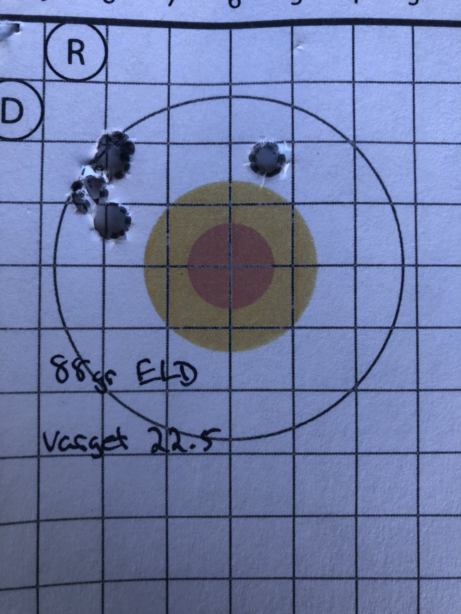

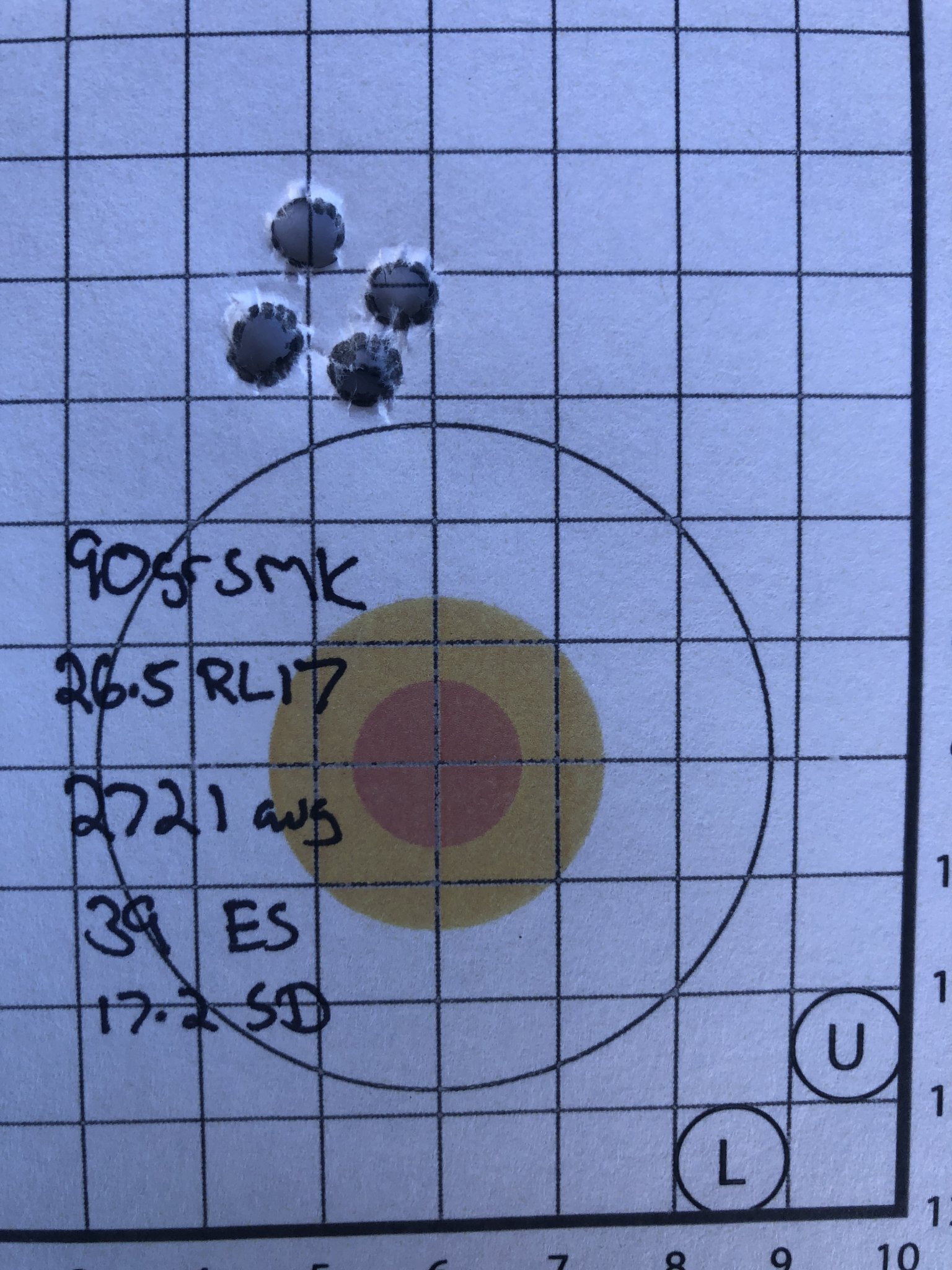

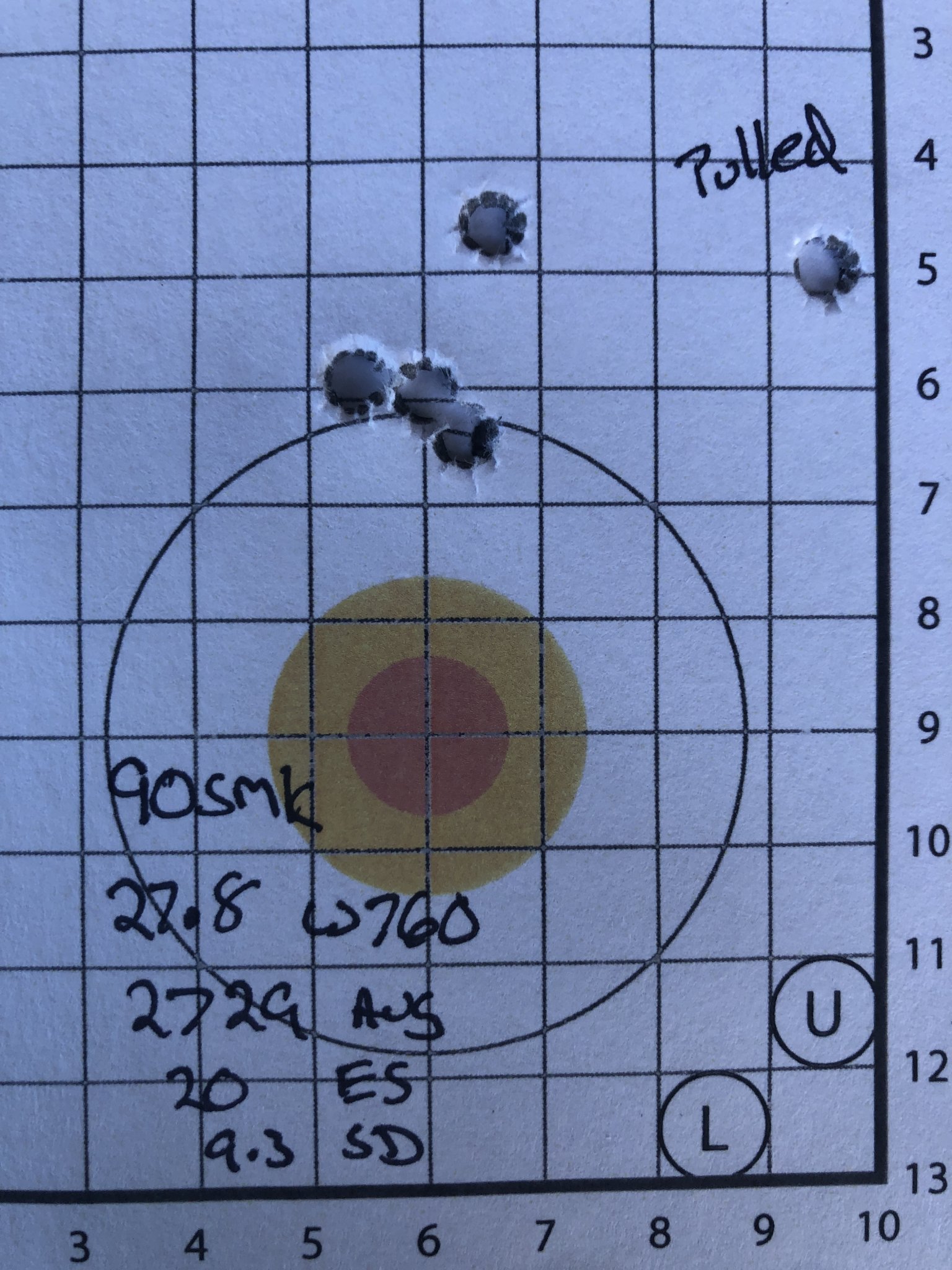

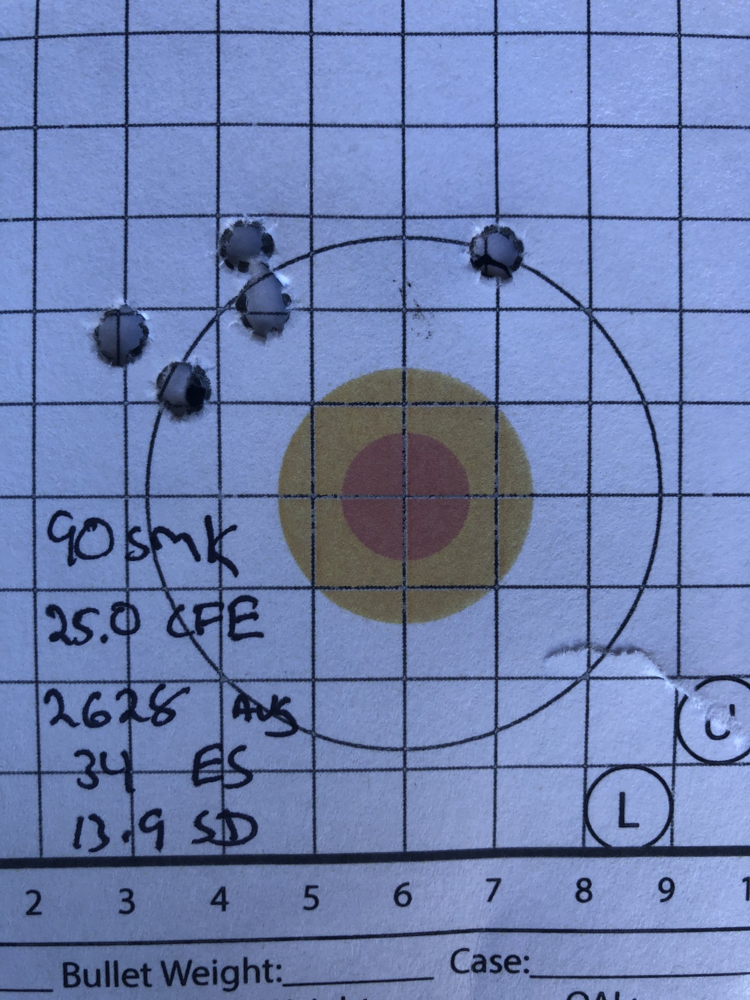

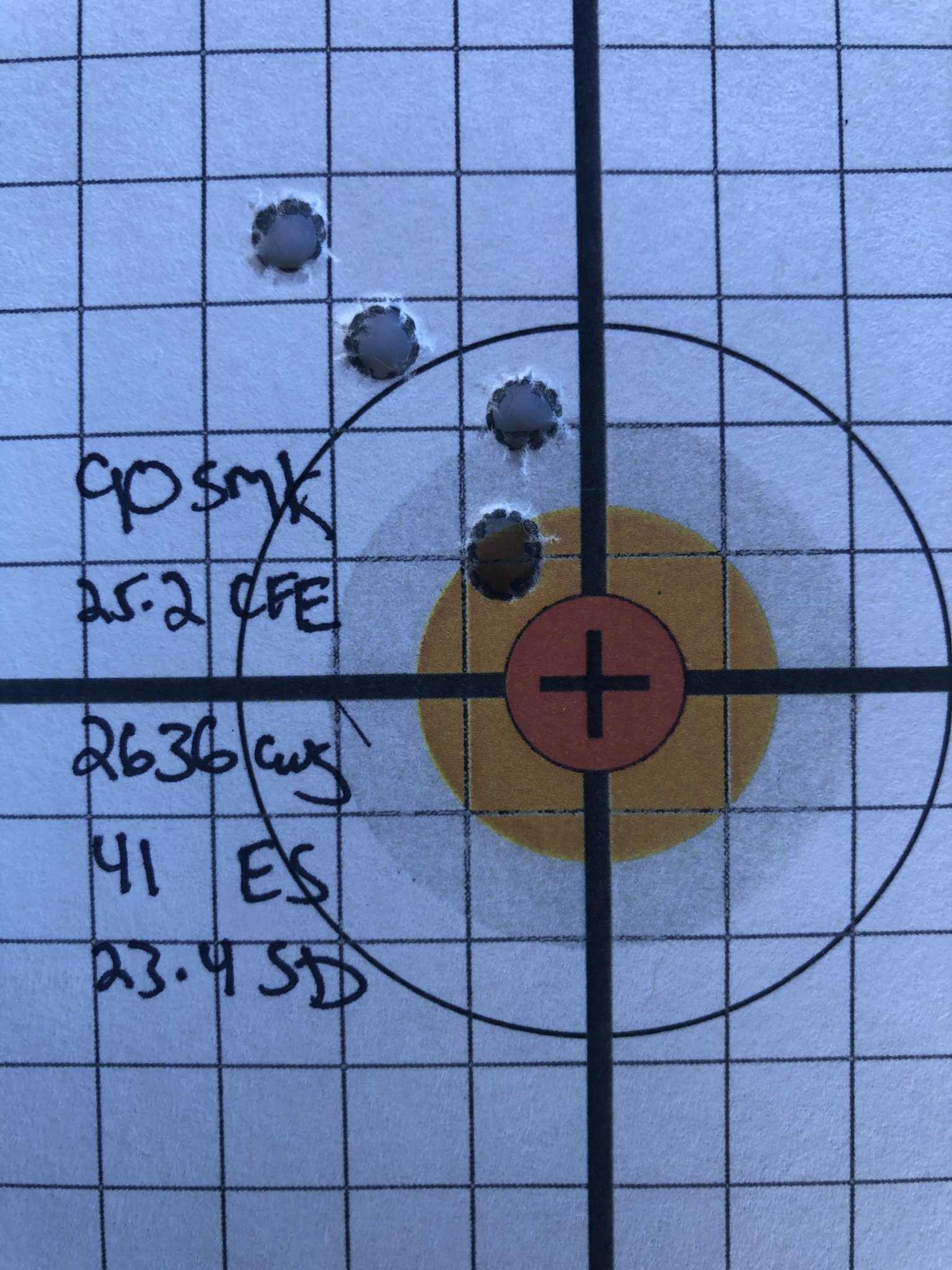

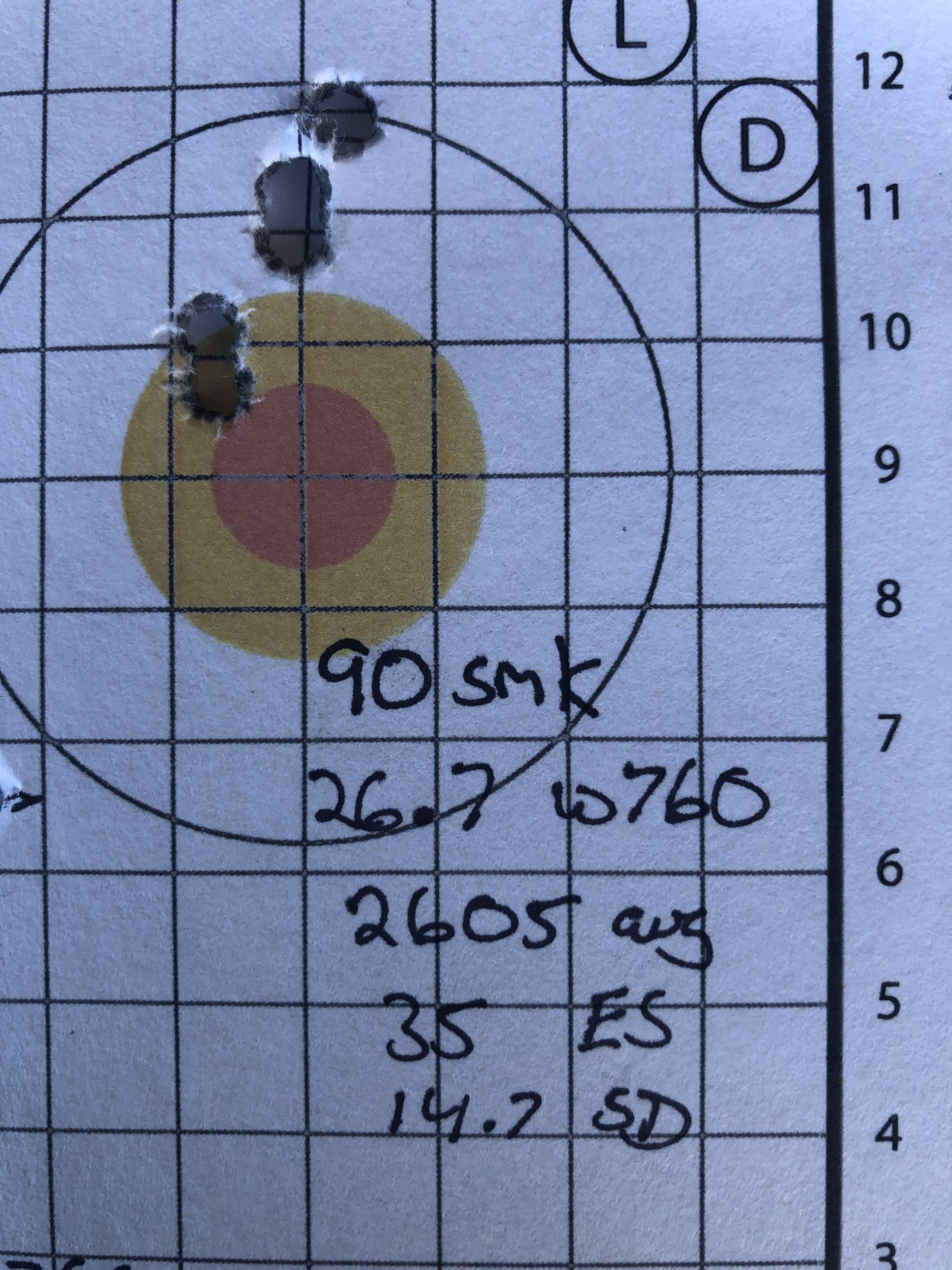

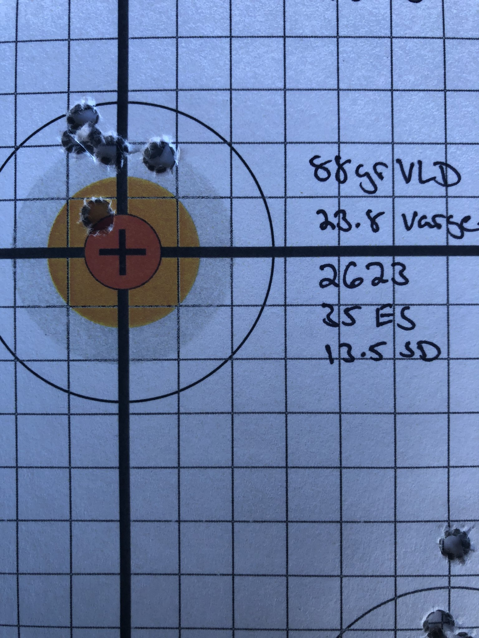

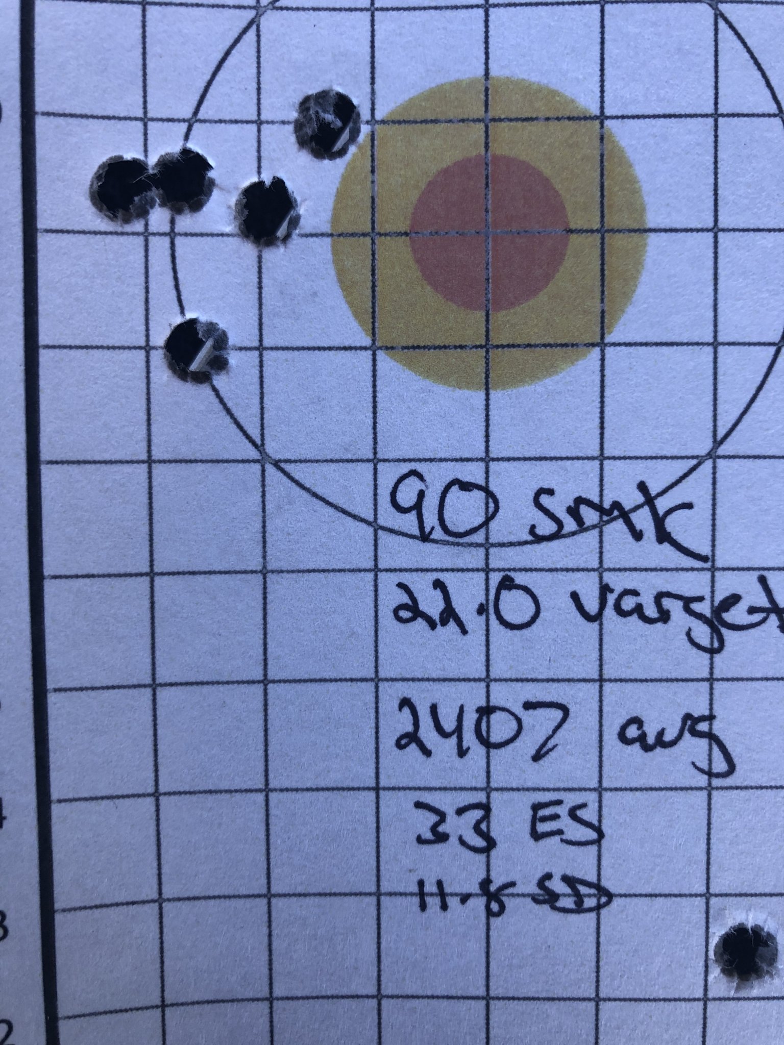

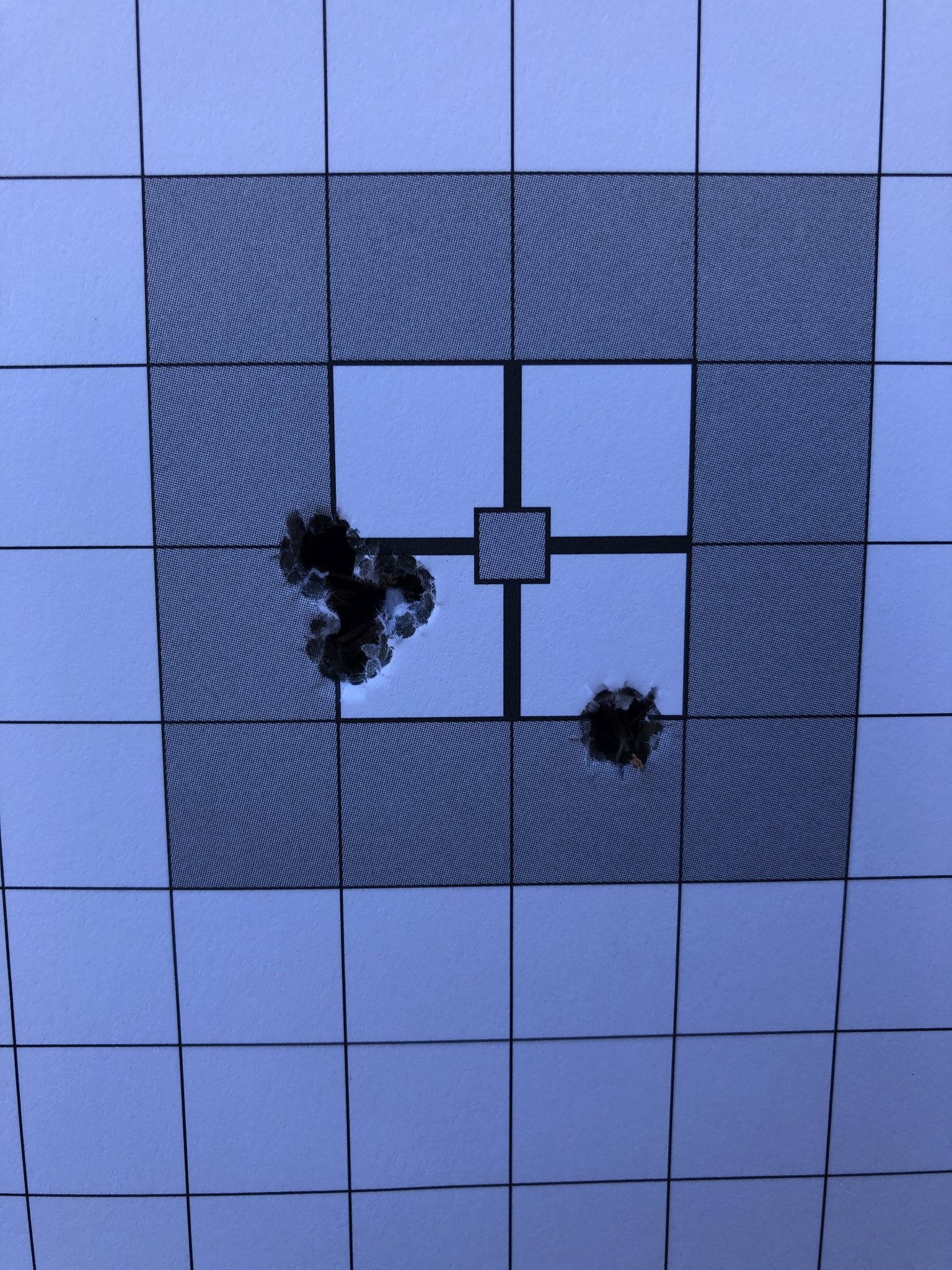

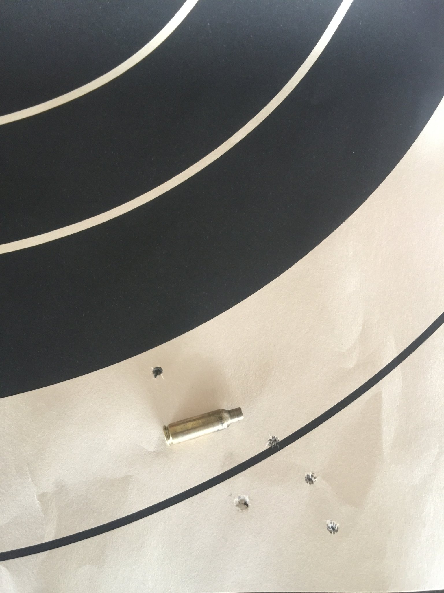

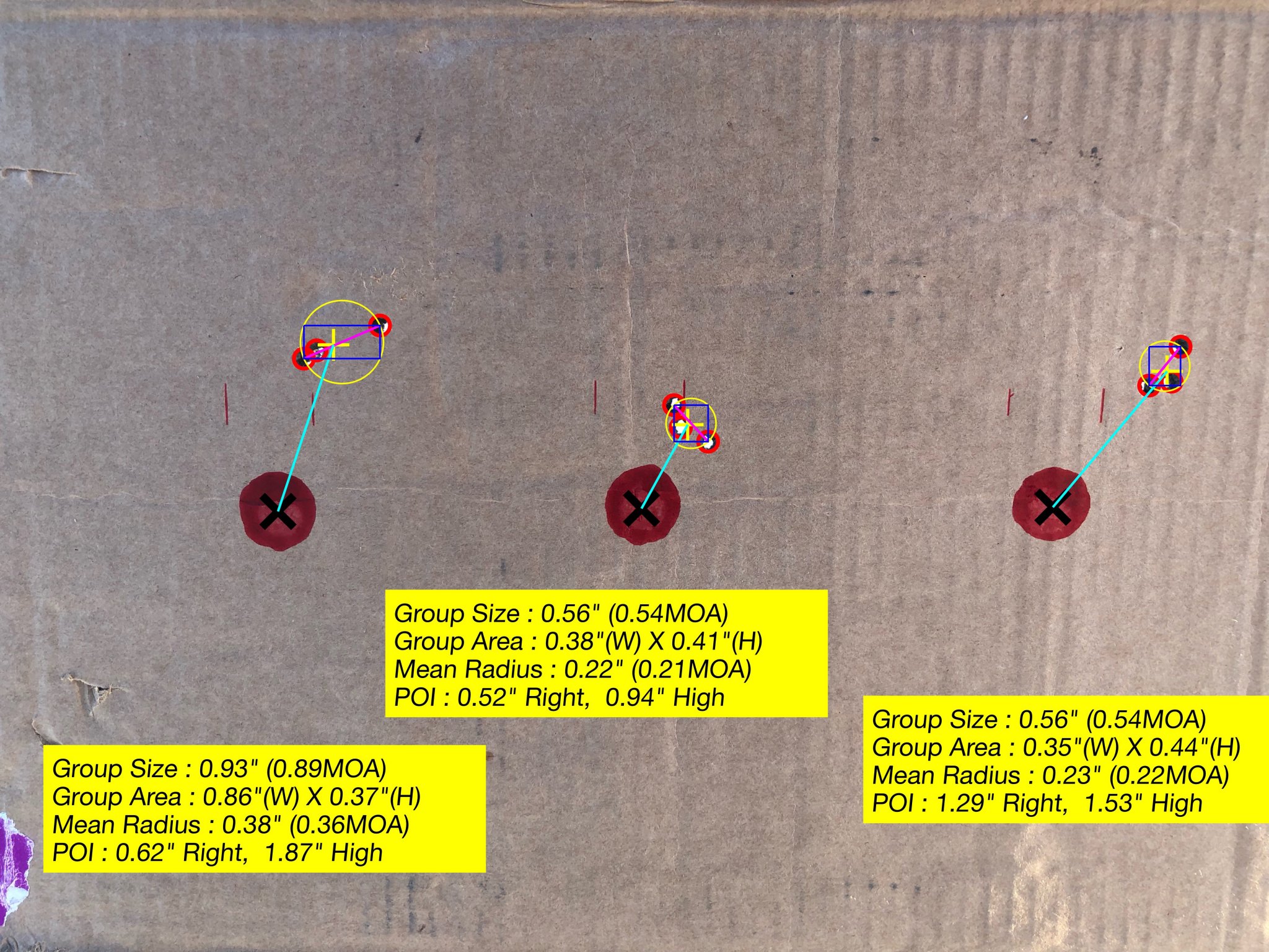

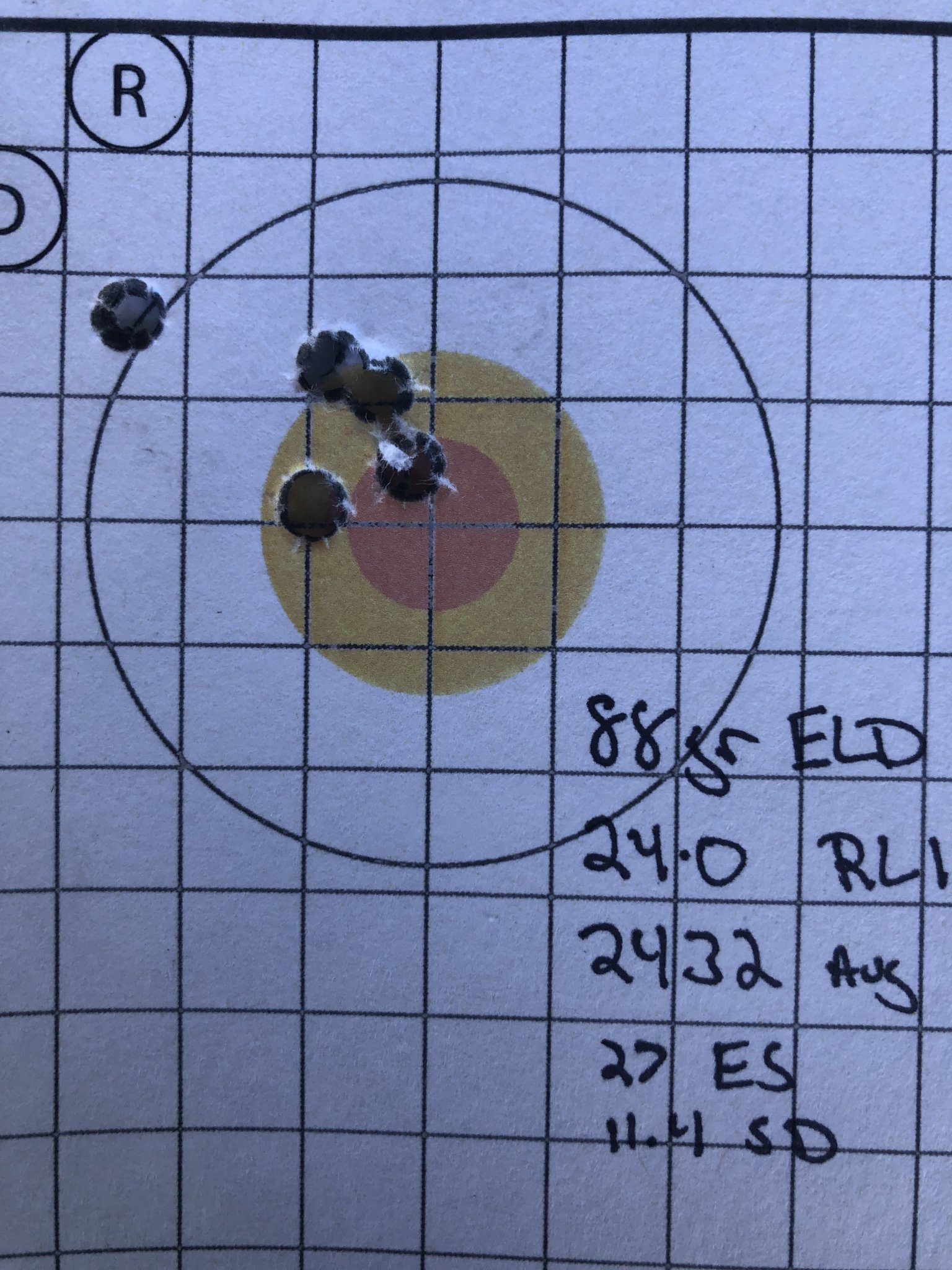

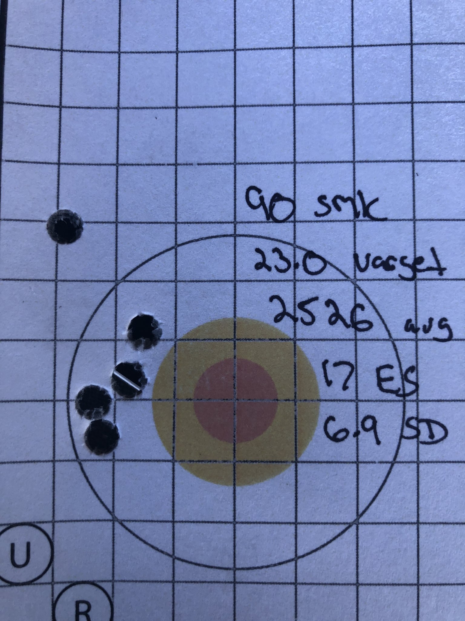

I'm in the same boat for the most part. CFE223 and 80gr ELDM, as well as PP2000-MR have showed the best. Even with the 75gr ELDM and 27.3gr of PP2000-MR in Starline brass and CCI450 and Wolf Mag Primers I have gotten a few clovers with the occasional flyer. I have a 20" Craddock Precision 6.7t +2 gas and this is my 3rd barrel. Had a Rainier 18" rifle +1 and a Bison 1/7 rifle +1...believe it or not the bison was shooting the best but I only tested with the 75gr ELDM at the time. I didn't have the 80's back when I had the other two barrels but now I'm thinking to get rid of the 88's and just stick to the 75's and 80's. PP2000-MR has been the best so far for me in those barrels though. All loaded between 2.270" to 2.280" has shown the best accuracy. My 6.5 Grendel 12" with 107gr TMK and 120gr ELDM shoots clovers under 8208xbr with a Rugged Razor 7.62.
First 2 are 224 Valkyrie factory 88gr ELDM, 3rd is 90gr Fusion, and last is the Grendel shorty. All in 45 degree clear low wind weather.
Also the Grendel with 120gr ELDM with PP2000-MR shot this last group at my indoor range at 84y...with a 12"!
I spoke to Paul and he advised that the factory 88gr ELDM is only shooting 1 MOA for most people and that the 88's like 26gr of Reloader 17 at 2.280" COAL. I'll give this combo a try but I'm leaning more towards the 80gr ELDM and 80gr CC which he also mentioned the Nosler 80gr CC's like 25.5gr of Reloader 15 at 2.260" COAL. If this works great then the 80gr CC's, and the 80gr ELDM's will be my go to 600y to 1000y bullets and I'm hoping to get a decent load with the 75gr Speer GD for antelope, hogs, and maybe whitetails.

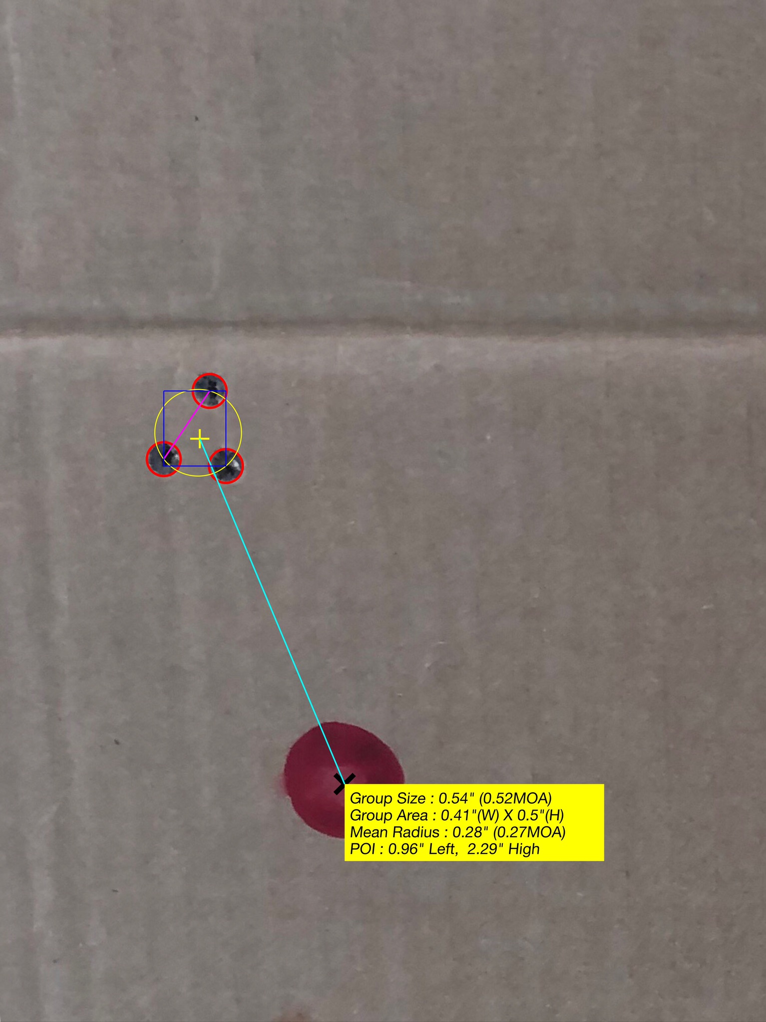

Rem 7 1/2
2705fps, sd25

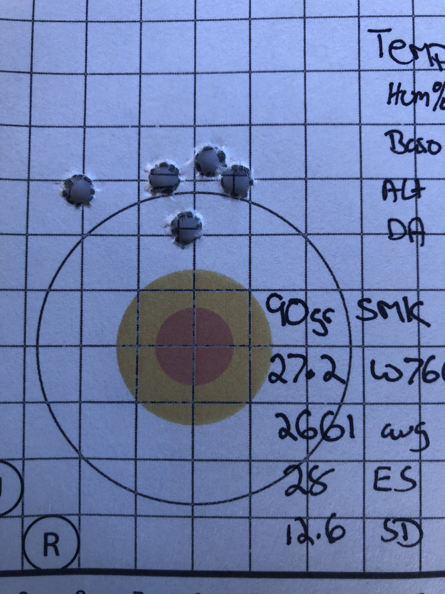

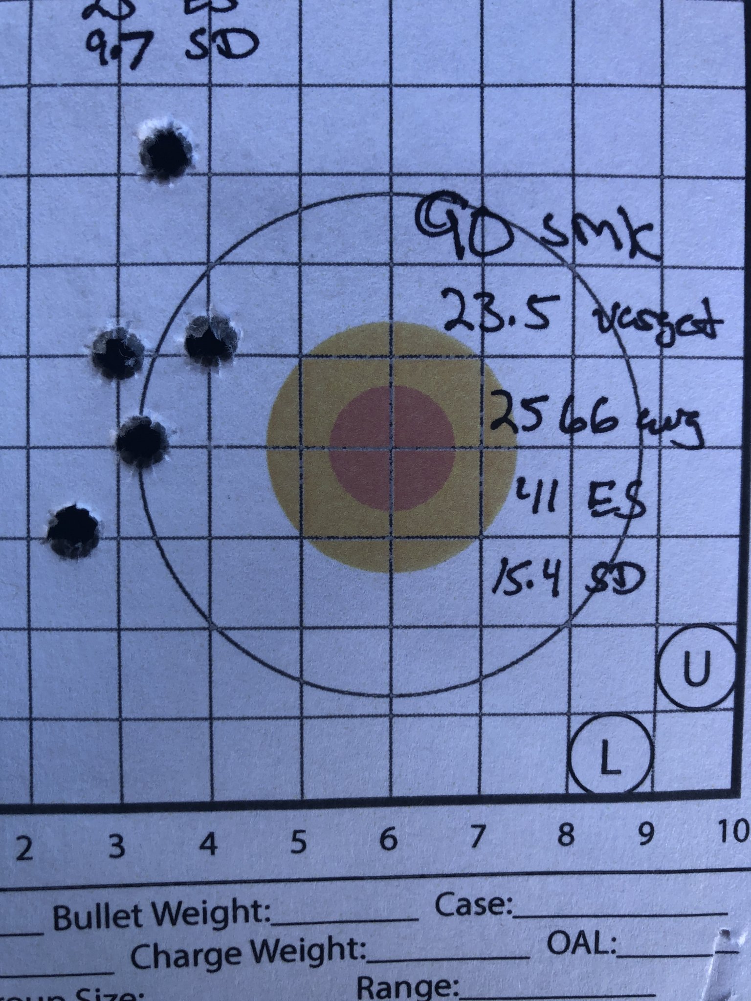

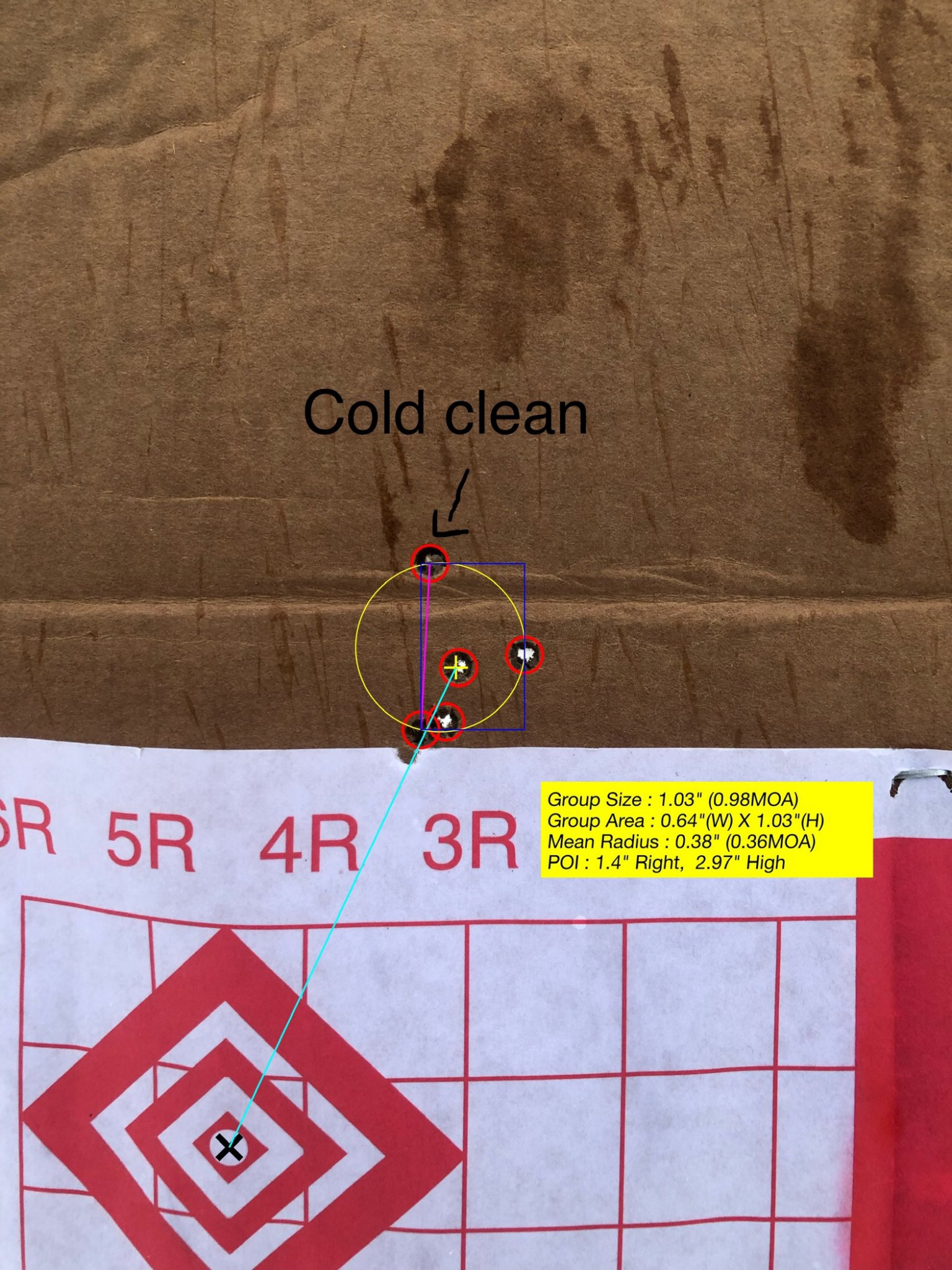

I have a 50rd box of 90 smk’s and worked up a load today using cfe223. There were two flat spots in my rig as you can see at 25.3-.5 and 26.3-.5. Using bare bullets I would assume that 0.2 grains lower would yield the velocity I’m getting. The last test was 26.4 and I didn’t let them get down to ambient air temp. I just loaded and ran to the range that’s two minutes away. I am sure that’s why the higher velocity but sd was great with no pressure signs. I think I just have to fine tune the depth to get best accuracy as it shot about .75” which isn’t bad but I think it can be better. I just wish they were cheaper as Sierra is proud of the 90’s.
02FEB2019 31.5F, 94%H, 30.37inhg
Virgin starline, cfe223, Rem 7 1/2, HbN coated 90 smk @2.290”
25.1-2562
25.3-2613
25.5-2617
25.7-2652
25.9-2660
26.1-2669
26.2-2704
26.3-2718
26.4-2720
26.5-2721
Ten rounds at 26.4-2743, sd4
Reactions: binazone
Here is what I found with the 95’s and H414.
03FEB2019 36.3F, 99%H, 30.30inhg
Virgin starline, H414, Rem 7 1/2, HbN coated 95 smk @ 2.340” one click less gas for H414 for lock back compared to cfe223
25.4-2332, 25.6-2405, 25.8-2431, 26.0-2466
26.2-2466, 26.4-2500, 26.6-2521, 26.8-2535
27.0-2549, 27.2-2587, 27.4-2608, 27.6-2589
27.8-2592
5 shot averages
27.4-2604avg, sd6
27.6-2614avg, sd11
27.8-2611avg, sd11
28.0-2667avg, sd24
28.2-2665, sd14
I believe I will retest the 28.0 grain loads as they shot the best and also be more careful in the seating as I believe some of the 28.0-28.2 loads creeped out and touched the lands resulting in a higher es. These are compressed loads at the higher charges and I believe this also aided in the bullet creep along with the violent action of the bcg. Here’s a photo of the 28.0 charge group. I rushed these due to fading light and also it was so foggy it was hard to see the target. There were no signs of pressure but the last two charge weights showed slightly flattened primers, but the brass looked great.

Cleaned barrel
Virgin starline, R17, Rem 7 1/2, HbN coated 95 smk @ 2.355”
26.0-2594 cold clean
26.2-2648
26.4-2668
26.6-2698
26.8-2683
27.0-2708
3 round average (running low on 95’s)
26.6-2682, sd22
26.8-2666, sd3
27.0-2694, sd23
I need to place another order for the 95’s as the groups are much better using R17. My first shot at the 26.6 charge registered 2701 and is the flyer but without it it measures 0.16”. I have 12 bullets left (thus the 3-shot groups) and will try and see if the groups continue to hold with them. 26.6, 26.8 and 27.0 from left to right.
I have a range session tomorrow that will include some different CFE loads to see if they are accurate and have low SDs. I'm also testing to see if applying a factory crimp (which I always have done with semi rounds) or not makes a big difference. My expander ball consistently resizes the Starline necks to .222 so I got to thinking that maybe that was enough neck tension and was consistent whereas my factory crimp might not have been. We'll see.
Well, the range session didn't produce anything worth taking a picture of, but CRIMP versus NO CRIMP produced no difference in speed for the same load but the SD/ES numbers were a bit better for NO CRIMP. With an 88 seated to 2.340", there is a bit over .340" of the bullet in the case. I've been shooting them with NO CRIMP for the last week and no issues with the bullets moving one way or the other. Your 95 load data is very promising so thanks for posting it. My 95s are still sitting in TN and they won't get to me in VA this week it looks like.

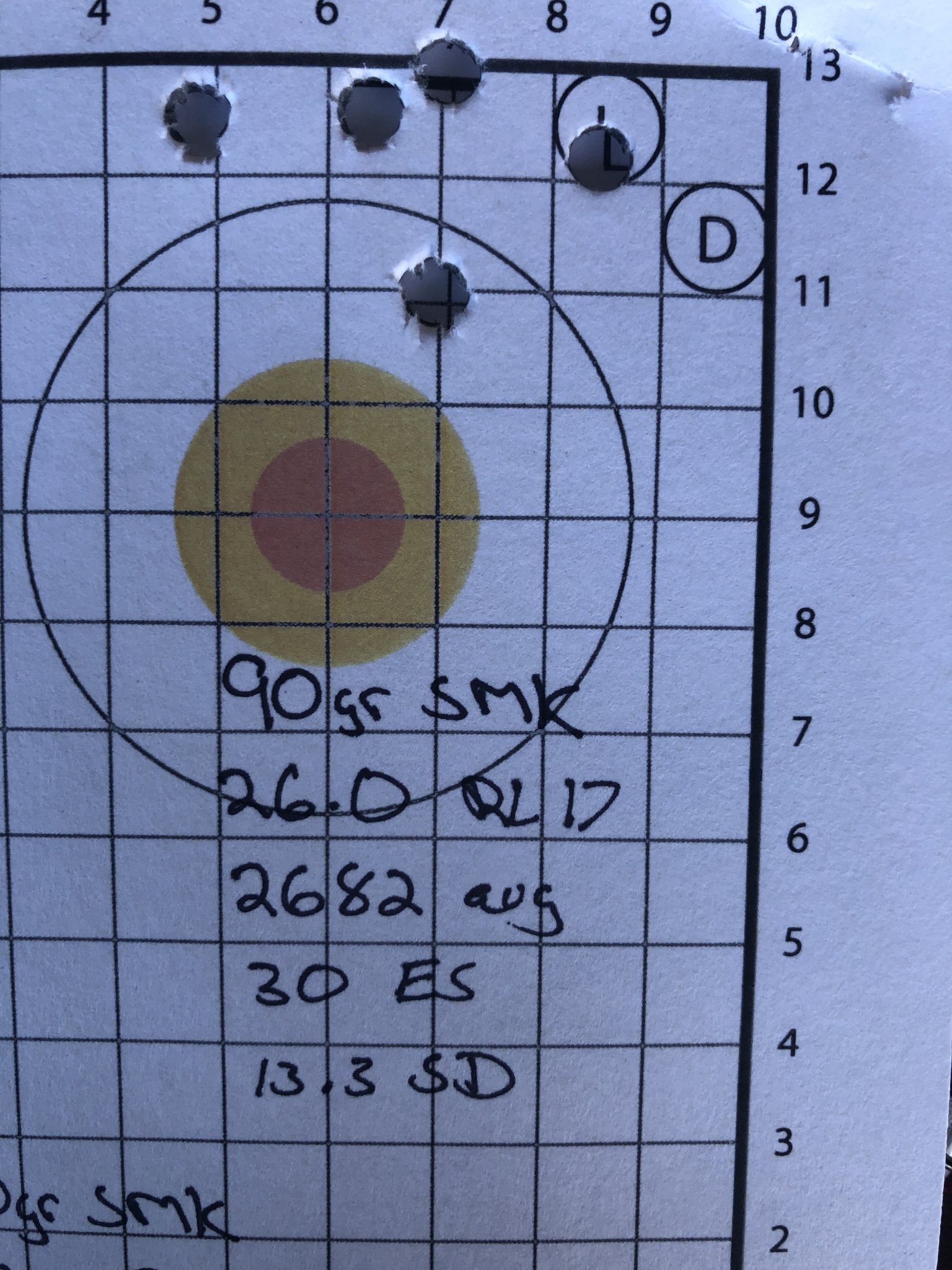

AK, just back from the range (100 yards) and some promising results and surprising numbers with the 95s and the 20" Bison 6.5T.
Since you already blazed the trail, I went right for 26.8 / R17, bullets seated to 2.345", BR4 primer, many times fired Starline. The barrel was cold and clean for the first shot which was 2" above POA. The next four were .75". Not so great SD19 and ES48 but the brass was ok and the AVG was 2580 which is good. You were right on with your 20 fps / inch differential. I think this is max for this barrel but the load can be tweeked. It's super out to 1300. This is one to work with even though I don't like R17 due to its temperature sensitivity. I've got a lot of experience with it from my early 243 loads especially during the summer.
Next up was a 27.1 of PP 2K seated to 2.300", BR4 primer, etc. I may have pulled the fourth shot which made the five shots 1.25" but the other four measured . .70", AVG 2626, SD 12 and ES 31. Also one that can be improved. Brass ok but close to max it looks like. This one I can seat out farther and lessen the pressure a bit.
The 28.4 H414 load was all over the place but the AVG for five was 2693 - never expected that out of a 20" with a 95. Otherwise a loser as loaded.
Last was 26.9 of CFE223 seated to 2.345", BR4, etc.. Six shots at 1" even, AVG 2710 (wow), SD 18, ES 51. This load appears to be at max so I believe dropping it at least several tenths will improve it. We'll get to that next week.
Powder temp = 60, Air temp = 66 today. DA would be in the low hundreds, but at 100 yards not important.
Just ordered 200 more 95s. Looks like the way to go with the Bison.
