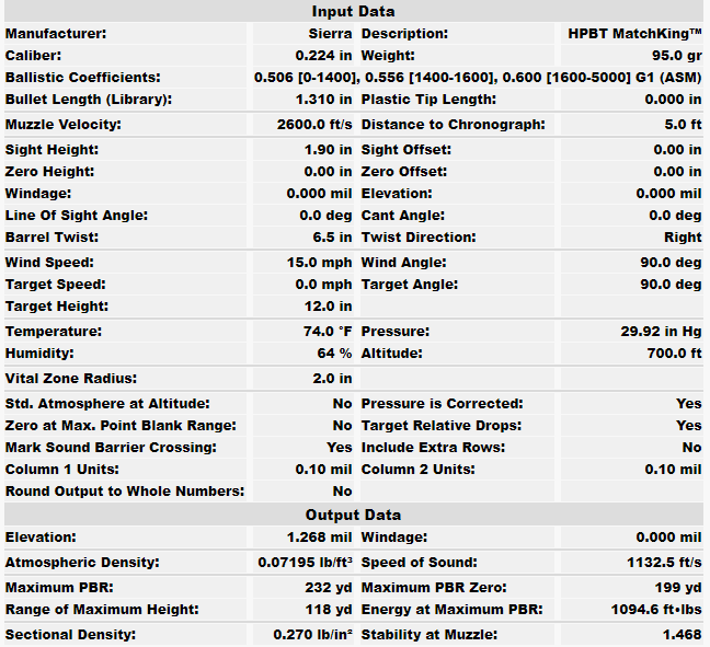

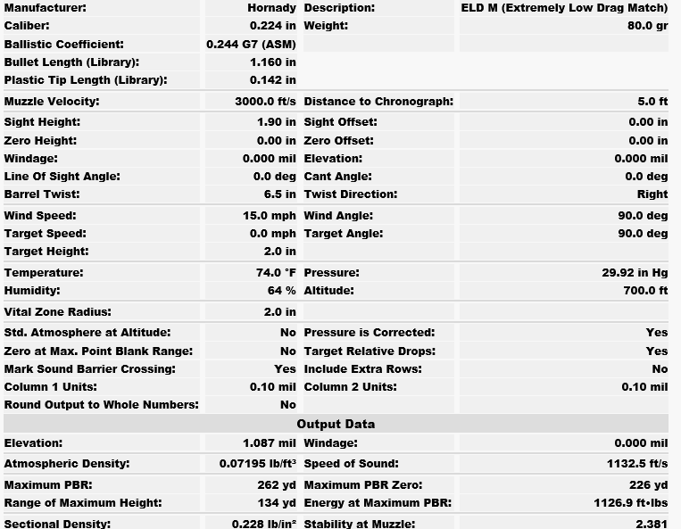

View threadYa well the g7 is what is supposed to be done for the vld but sierra don't list the g7 for them so for a sort of apples to apples comparison......g1, unless someone has a g7 of the smk's?IHFarmer07 check your BC input for the 88 ELD. Looks as though it is duplicated from the 80 ELD as both charts show G7 BC of .244

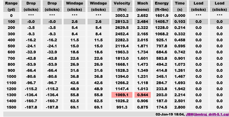

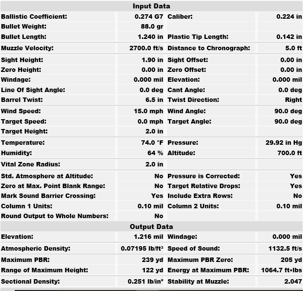

From the ballistics I have put together with the 80's, 88's, 90 smk's and the 95 smk's, using approximately the data that I have found others getting, the 95's are the cats ass for way beyond 1300yrds.
