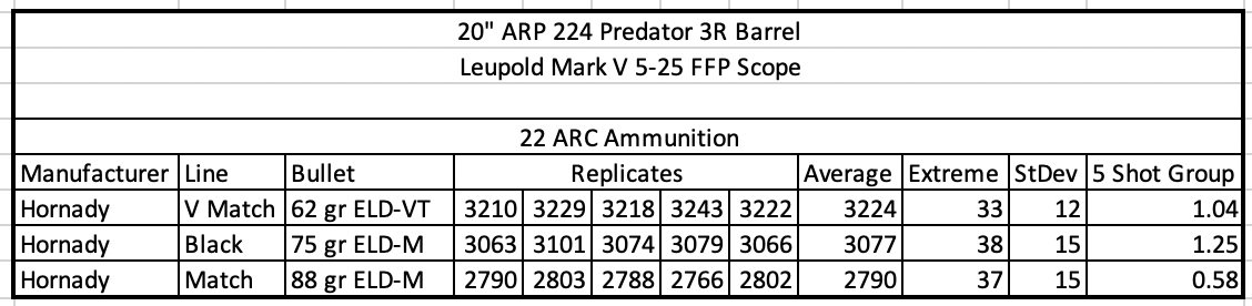

    22ARC - 85 Berger Hybrids .524 G1 BC at 2900 out of a 20" gas gun. That's basically 6 Dasher performance
    6ARC -105 at 2700 out of a 20" gas gun(being really generous). That's just under 6BR performance.
    You got a 200fps bump on essentially the same BC

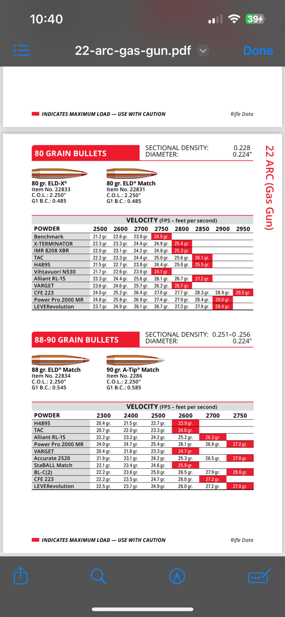

    2900 with 85s from a 20” 22Arc might be a bit generous. At least at SAAMI pressures. Maybe not, but I wouldn’t expect it. Below are some numbers from mine for those that might be interested. Though, no berger bullets…
    Reactions: 232593 and wade2big
    This is what Hornady shows for gasgun pressures (52,000psi) out of a 24” test barrel.
