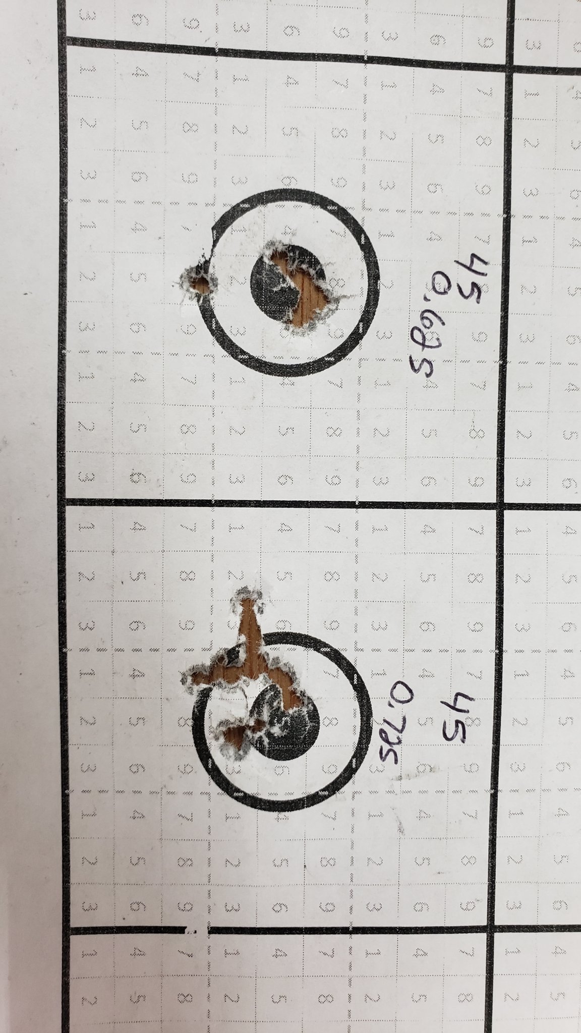

Here is some Center X 10 shot groups at 50 yds what I typically see.
It runs 8" at 212 yds

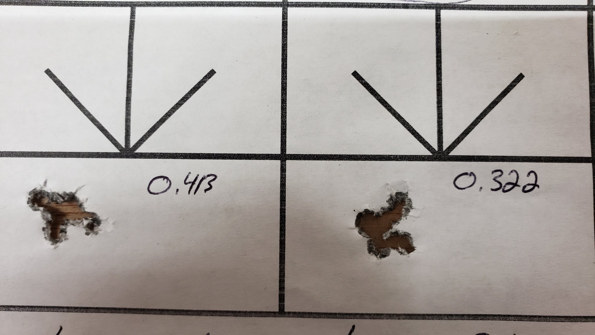

Here is some Eley Force at 50. Also 10 shot what I typically see.
At 212 yds average 3.87"
Crazy ain't it dont focus close is the word!
Yes. I've know this for awhile. 50 yrd doesnt mean much to me so I have been testing 200 yards for awhile.
I recently started 400 yards. That is another kettle of fish...
