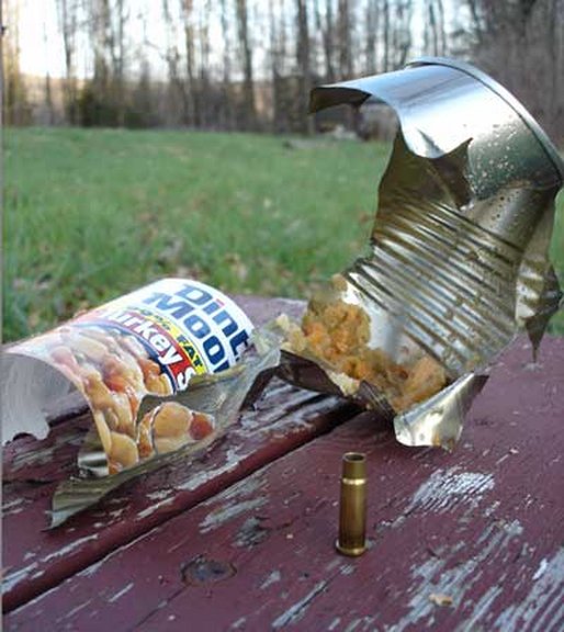

What the fuck is this? Turkey?

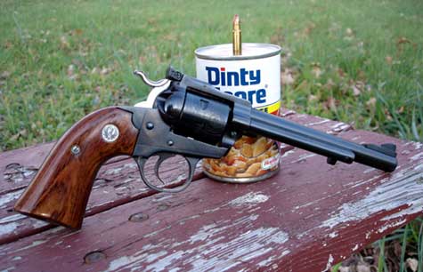

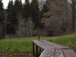

44-40?I got this one at almost 20 yards, iron sights no less.
Roll cage for your scope? Cool! Great for off road shooting.
44-40?
