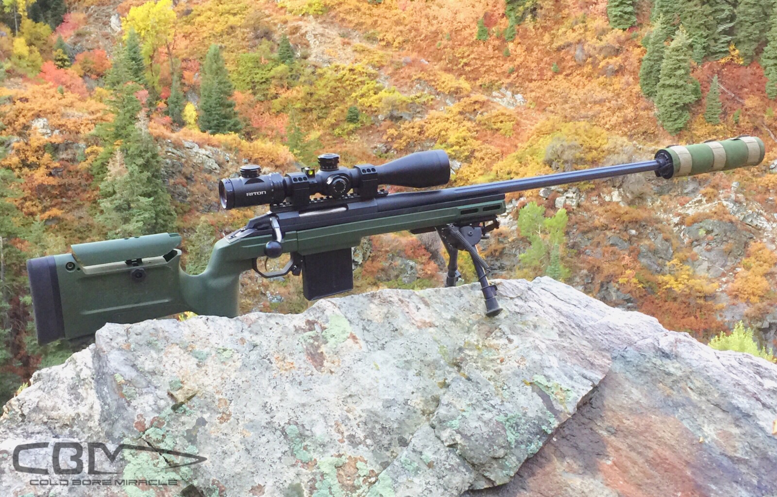

    “I suppose you could say I’ve come full circle, I started this game with a .25 caliber rifle, and after many many years I have a new one. I learned much with that first rifle, a Ruger M77 in 25-06, I still have it, and I dont think I’ll ever get rid of it.
    My love for the 1/4 bore was cut short, by the lack of high Ballistic Coefficient bullets. There is a good assortment of 115-120 grain bullets, but many of them peeter out long before my then goal of one thousand yards. So despite claiming many of my first’s, the 25-06 went to the back of the safe.
    In the defiance of time, I always had a 1/4” hole in my soul. Turns out that I wasn’t alone, and some folks with impressive math skills finally saddled the long range quarter-horse. Black Jack Bullets is a new manufacturer with a specialty in high BC 25’s.
    As soon as I had spoken with Miles and Logan, I was convinced that my old love of the 25 needed to be rekindled. I almost immediately started Operation Quarter Lord, my goal; a .257 rifle that I could build light, and haul all over these Rocky Mountains to take antelope, deer, and even elk.”
    Continue reading Operation Quarter Lord

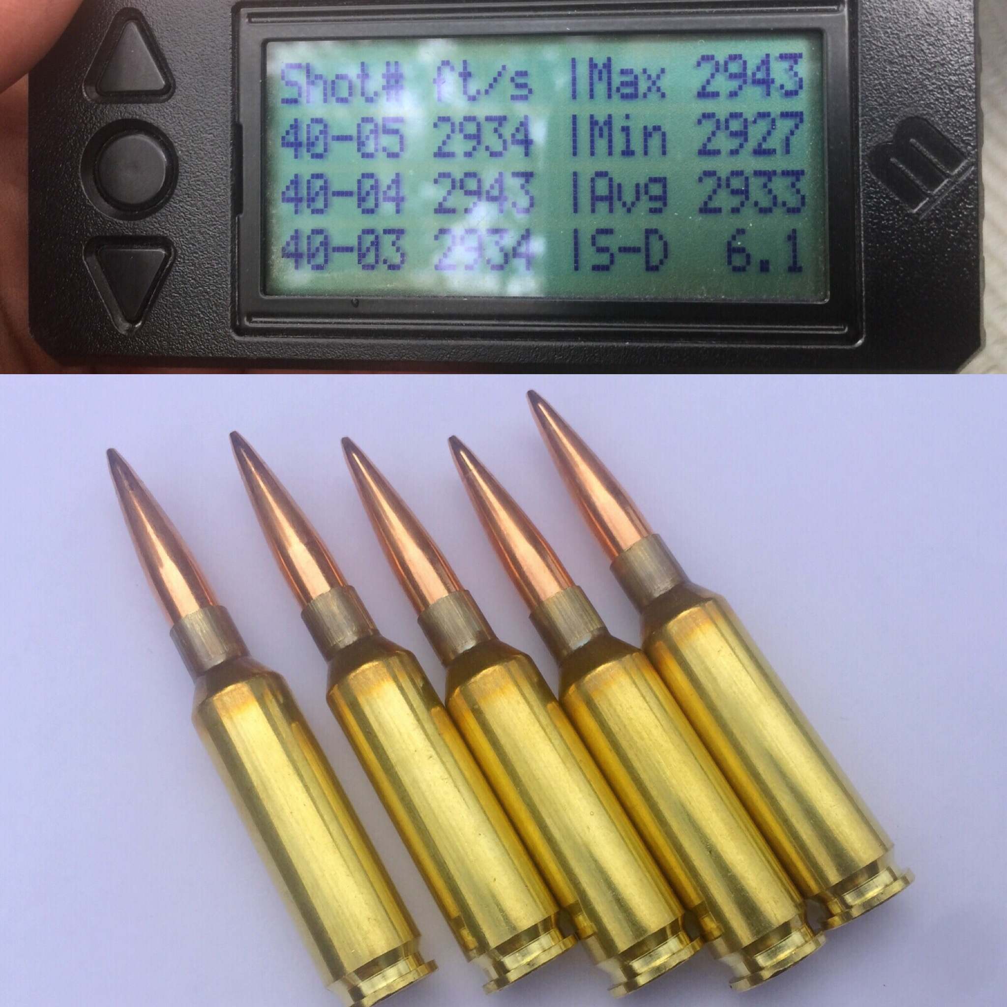

    I've watched BlackJack for a little while now, and the .25 cal stuff is pretty great. Their velocities are 3000 fps from a 25 Creed and 2950 (with no pressure) from a .25x47 Lapua. Running the conservative 2950 fps, they're within a tenth mil of the 6mm's in drop and drift (if you're within PRS fps limits), about the same recoil as the 6.5's with more energy delivered on target. I'm very excited for the .25 caliber revamp they've done.

    Yes, I was referring to the 131 gr ACE bullet. I was honestly surprised to see it was the case. It may just be the "hot, new thing" for some people, but there's some allure to the quarterbore that I like. I'm stocked up on 6.5mm bullets for now, but once my barrel goes, I'll be looking into a 25x47 Lapua.
    Blackjack really had their stuff in line before launch. They have a good supply of bullets it looks like, from the get go they had barrels that will stabilize their bullets from some really good manufacturers, and they've got a hunting bullet coming later. They saw a niche market that could be improved/filled, and they prepared well before dropping their product. It was a good market play and I'm glad to see they're having success.

    My blank and reamer are in hand.Brass is prepped. Ordered a while back. Just waiting on bullets. Encouraging velocity from 22” barrel.
