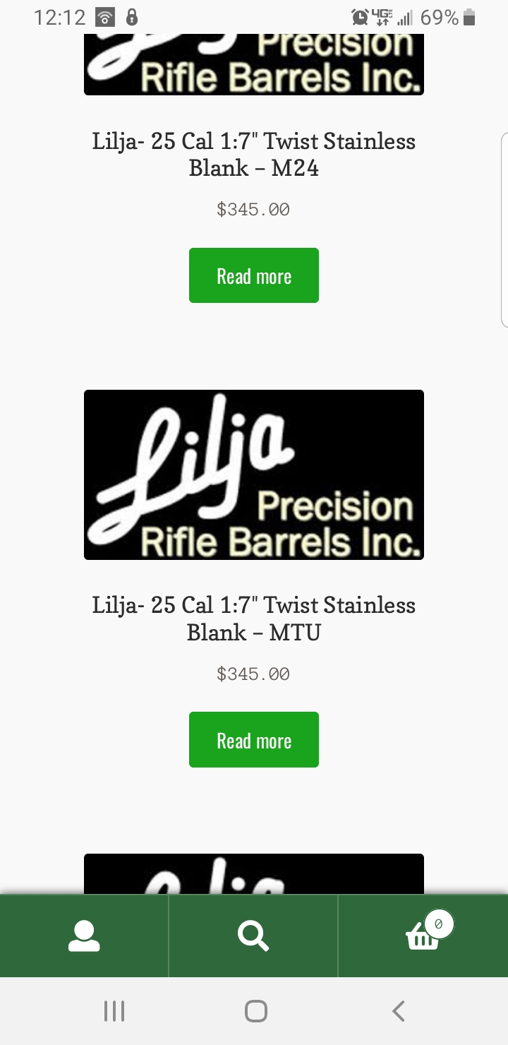

Blackjack has a very limited order of Proof 1:7.5 blanks coming in April. At $730 it's out of my price range but just the thing for those wondering what to do with their tax refunds.

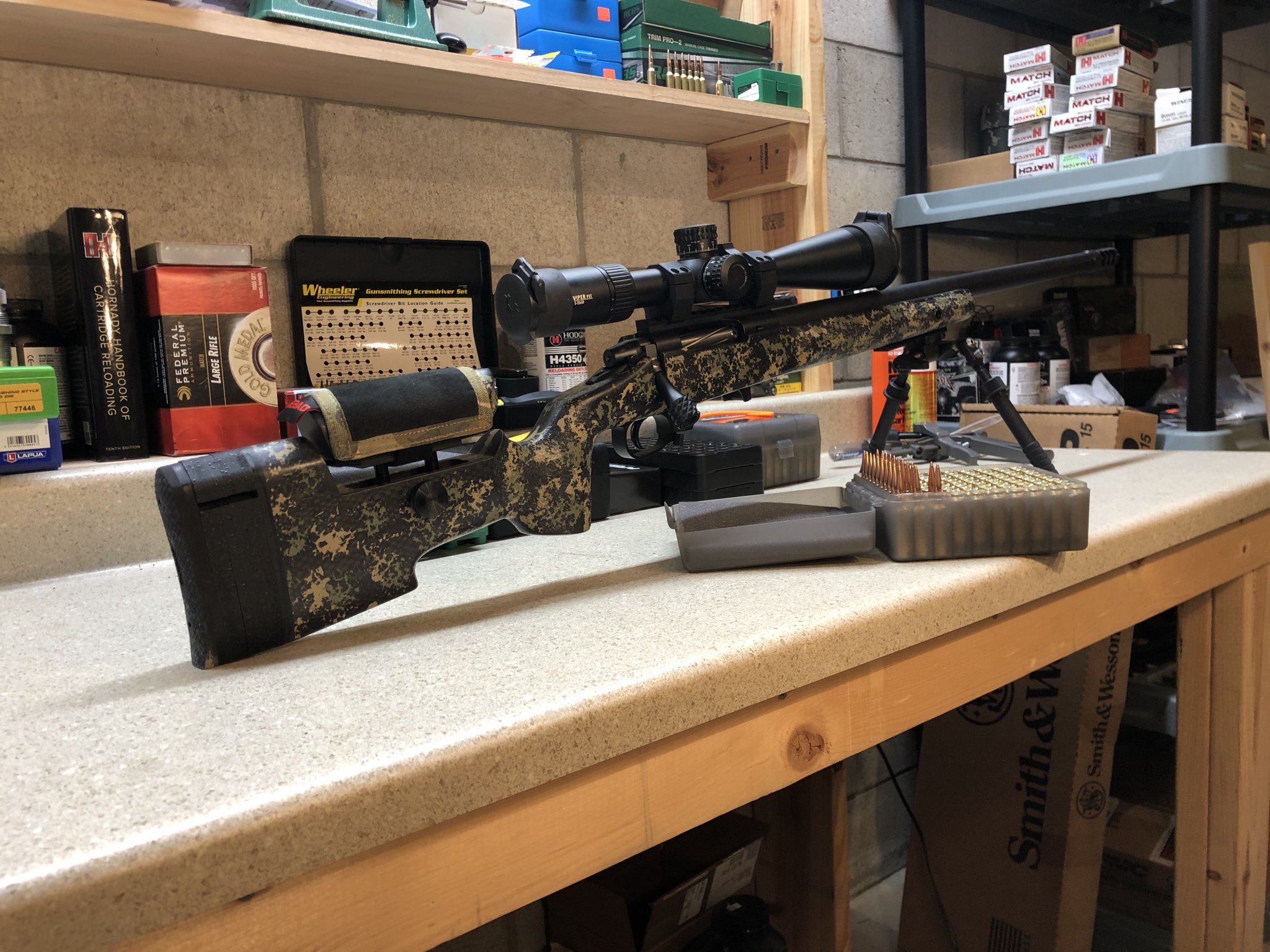

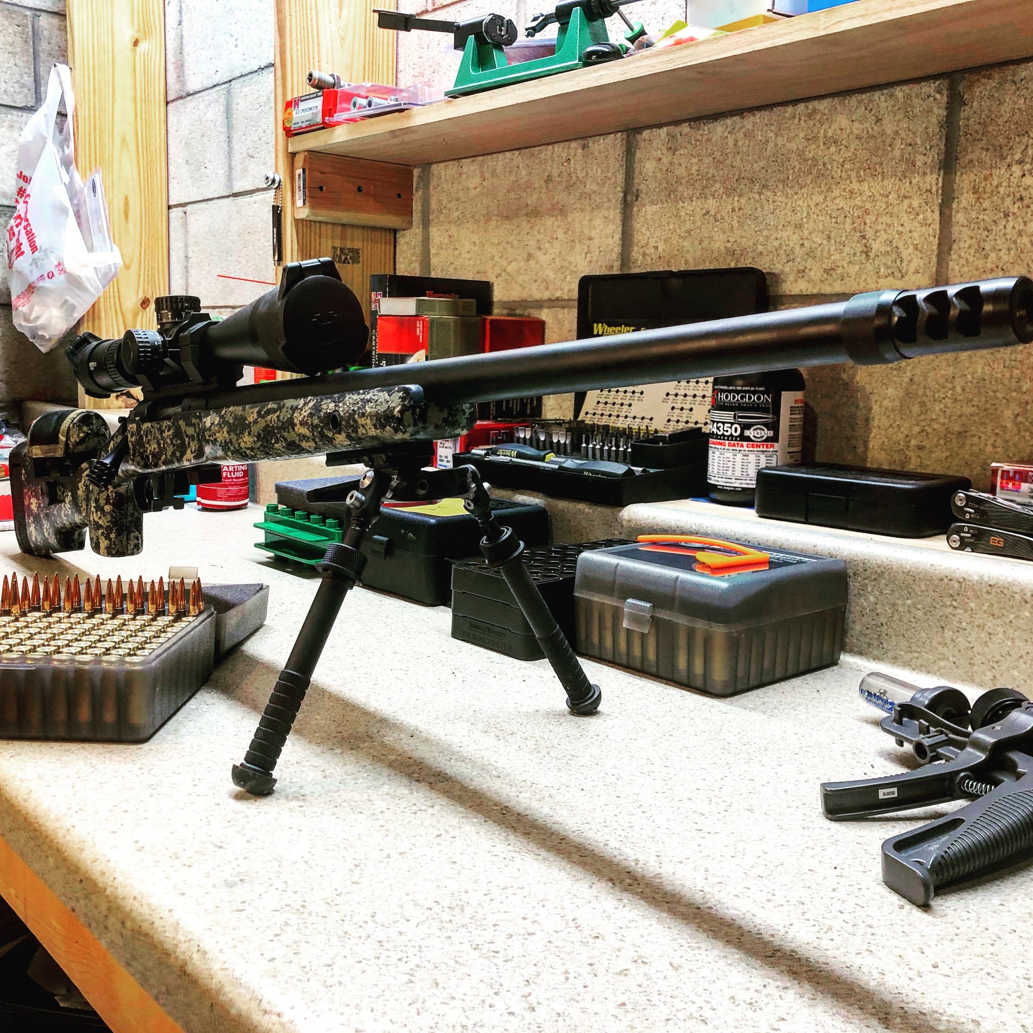

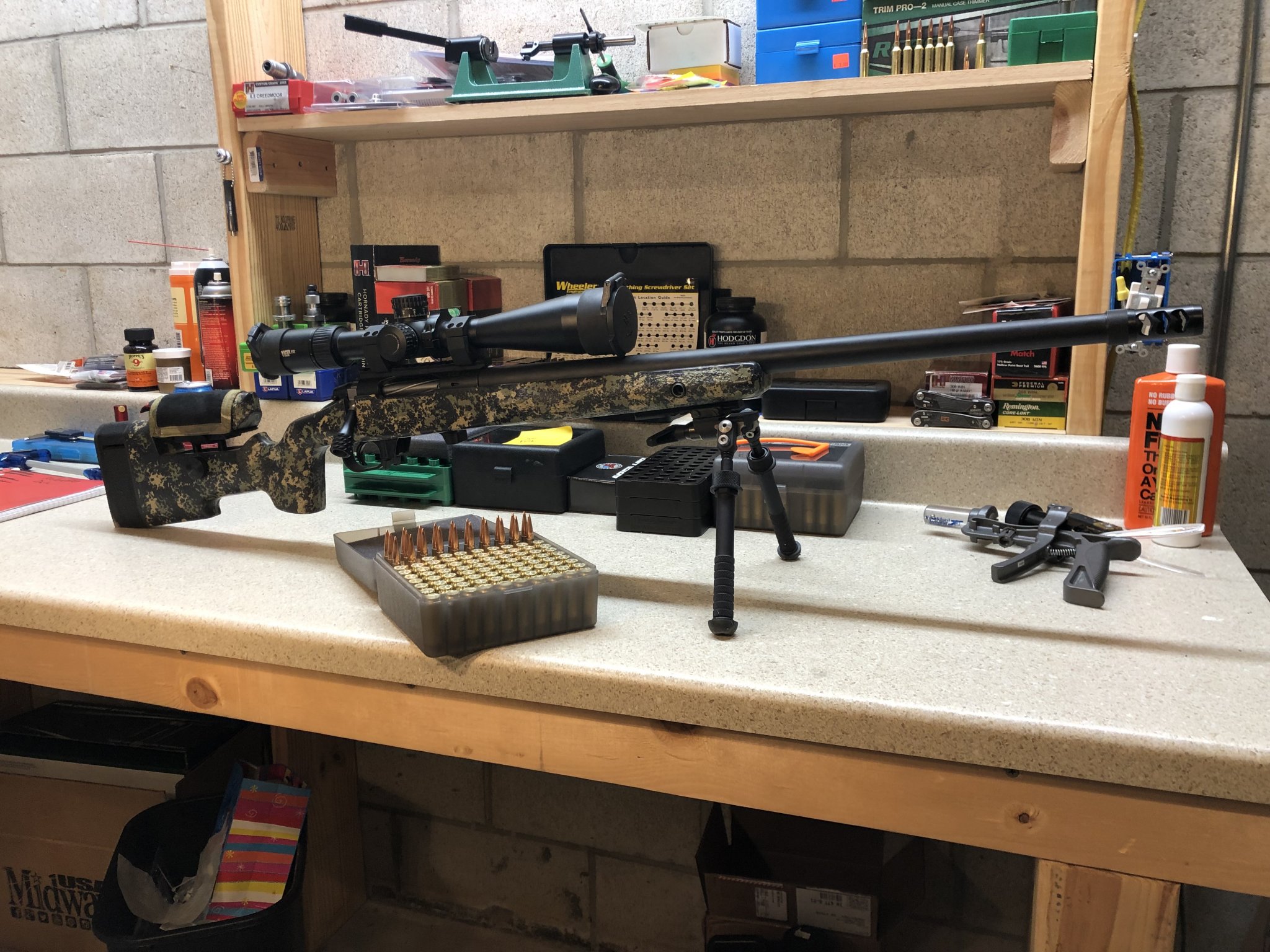

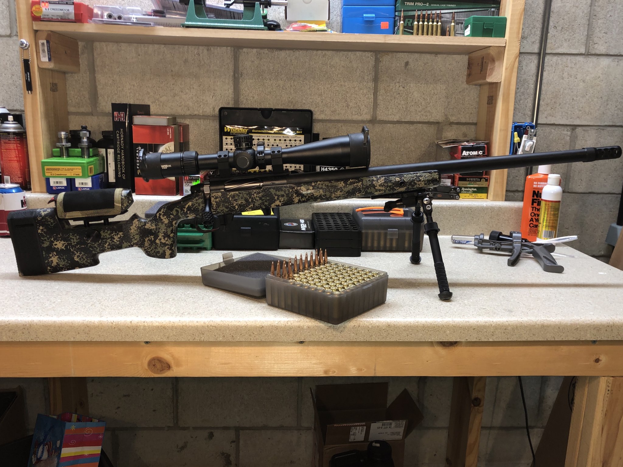

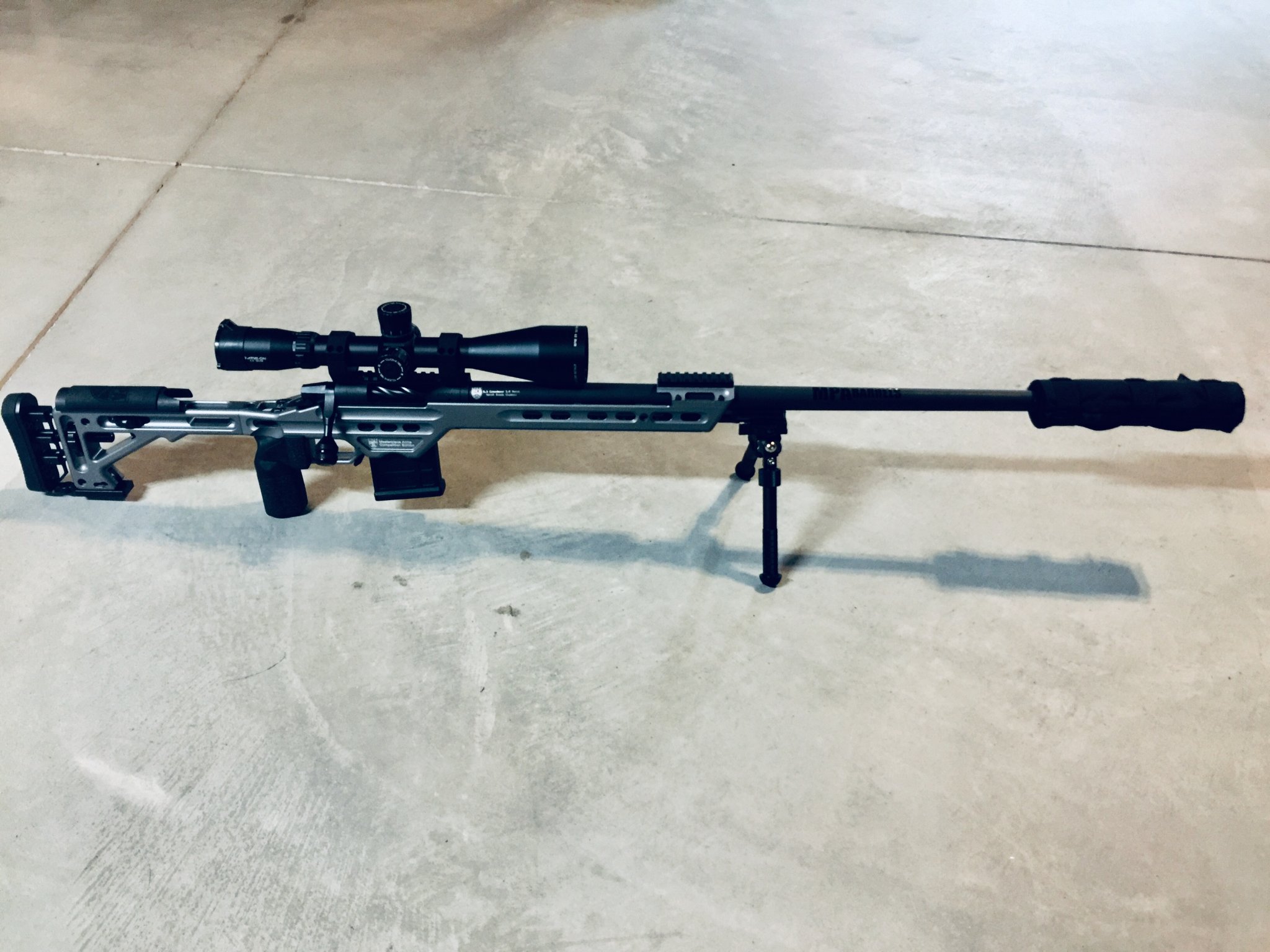

Already posted pics in the TL3 thread, but I’m just so dang excited figured I’d share here too! Lol!
Bighorn TL3-SA NP3 coated with AW cut
Bartlein 5R M24 1-7.25 finished at 24”
Chambered in 25CM
All smith work done by Southern Indiana Precision
Huber Concepts 2 Stage Trigger
Area 419 Hellfire break
McMillan A5-A Woodland Carbon Ambush
Hawkins Precision Bottom Metal
Atlas CAL Bi-Pod
Weibad Cheek Riser Pad
Gen II PST 5-25x50 FFP Mil/Mil
Vortex PMR Rings
TBAC Ultra 7 currently in jail
7054762
7054764
7054765
7054770
Chambered in 25CM
Atlas CAL Bi-Pod
Vortex PMR Rings
View attachment 7054762View attachment 7054764View attachment 7054765View attachment 7054770
That's beautiful, man, well done!

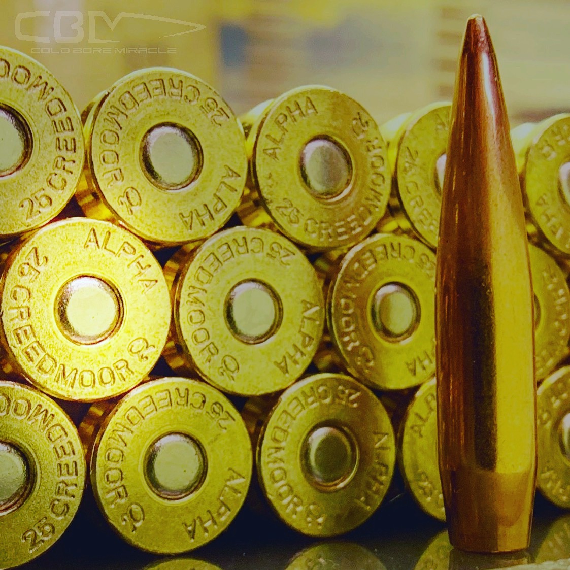

Is that Alpha brass and Blackjack Bullets?
Reactions: Bear24
Can’t believe I didn’t put that in there?
Of corse! Both of those are absolute top notch components! Prime em with FGMM Small Rifle Primers and fill em with H4350, had an SD of 9 while fire forming brass. Need to do a final chrono because I’m sure my barrel has sped up a bit since I checked it before the match!
