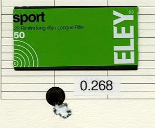

Yeah, I know, there's an ammo shortage. :rolleyes:
How can I waste valuable 22lr on the same old same old.
Because I won't have to fire a single shot, it's already been done.
All I had to do is some target analysis.
The targets and method were posted previously...it's been a cartridge reference since 2010.
https://www.accurateshooter.com/guns-of-week/22lr-rimfire-ammo-comparison-test/

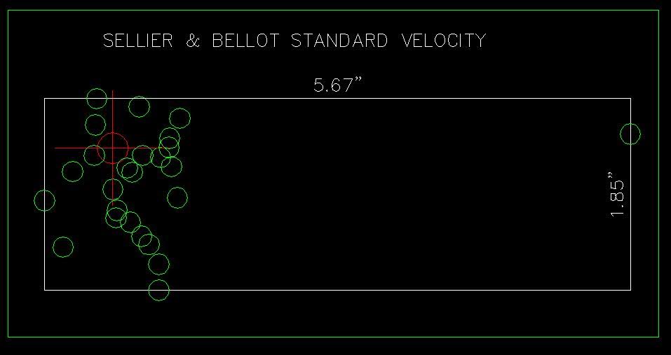

I'm not much for averaging results, as it hides problems.
I've built the 25 shot aggregates and compared the total spread from each target.
Makes me feel better when even a high end benchrest rifle can't make crappy ammo group. :D
Link to view original targets and aggregate images: https://photos.app.goo.gl/S7B4Dtbmp4ZZ5VUs5

I'm just building the group aggregates to obtain more information regarding cartridge quality.
Those averages posted in the original link bothered me.
Group sizes were substantially larger on many of the targets, than the averages indicate.
The results shown are a snapshot of how those particular lots of ammo performed on the day in 2010 when they were tested with that particular rifle. Two years later more results with the same rifle were posted. Eley Match, which had a .455" average in 2010, now had a .706" five-shot-group average.
The takeaway from those results? They should not be viewed as a cartridge reference. Different lots of each of the ammos would produce different results. Additionally, the sample size of 25 shots in the form of five five-shot-groups is too small on which to hang a hat.
Reactions: Memberberries
Y'er right G.
I plan on building the aggregates for the results from later tunnel testing also.
Those were shot with a Walther KK200, Sako P04 and a custom Ruger 10/22.
Looking at old information with new eyes.
It's winter, I have time to kill. ;)

That's the last of the aggregate builds.
4 rifles, off the bench, in a tunnel, 5 sets of data produced.
Have ya' noticed, 5 shot group average ratings don't agree with 25 shot aggregates?
Several have shown smaller aggregate size better than as rated from the average of the 5 shot groups.
Those groups wander up and down depending on the mv for those 5 shots.
I've reached the point where 5 shot groups are almost a joke. :(
They are pretty much random acts of accuracy when compared with larger sample sizes.
Especially when you average the individual groups together in an attempt to compare cartridge quality.

Someone posts a pic of a single 5 shot group
produced at 100 yards, then claims "all day long".....
Then they get irritated when I ask what does the rest of the target look like? :rolleyes:
ACtC-3fEirGdvgd6wqUEAMEVxq54Ui-L_6LdyHYrtz_gIau-43t5rak_aeBf7-vIolX7U4645KYki6_cnbM5ajmyrxgqRjabXXNTf5HiAxA6J5SX_mCoOYKOSzGjvswP-Tb0QhbPozcxywTsyU54brNiW0Ym=w659-h939-no
Or what does the aggregate group size look like...
ACtC-3eC5ar5lFXf39nS6CgHc6BheJDwMWIvzcIaKTB1mdRqfHn_0r-r1ec1Z1ebytmqwG2Jwwpgeuvnl-lg_jcV1-hxme1TYk8ZbAtxgW5sAG0ppHS-i-3xDrsPsynnYhx-8vqiGkTHBTaV1fIRoU7Y-YRf=w443-h543-no
Those strays and fliers do ruin a target don't they...all day long. :D
Doesn't matter how good y'er rifle is,
not even a tuner on an high end custom match rig, in a tunnel, off a rest,
can prevent a cartridge that was damaged on the assembly line, from going astray. :(
ACtC-3eHnMT5o1E8WEEuPcjfIcVJq9Me8ZXu1Oca3AluoKb-DXW5KjtBwtd8nxB7ehDehdkORL7C0MQxTsJSI1y_3E0_lgFJMDF2SYIcVI6zPp6O_bGt3RkdG9l6UEL5VQltDvrIZmEEDqG8ZfRW4Uwuasjw=w957-h507-no
With all the groups built from the 2010 and 2013 tunnel tests
some bits of information are easy to see.
1....Eley and Lapua products provide the best results with each rifle.
2....Tuners correct only small variations in muzzle velocity.
Anything outside that limited range and the mv spread shows up as vertical spread on target.
3....It doesn't matter which rifle you have, it can't fix cr*ppy ammo.
MV spread, poorly made or bullets damaged on the assembly line will still stray.
4....If the cartridges were assembled properly and have tight mv's,
even hi-v 22lr will produce sub-moa. Super-sonic transition has almost no effect.
Cartridge quality is the most important factor...not the design velocity.
5....Even the best grades of 22lr have bad boxes of cartridges.
It's not the rifle, it's the ammo that's producing those odd fliers.
