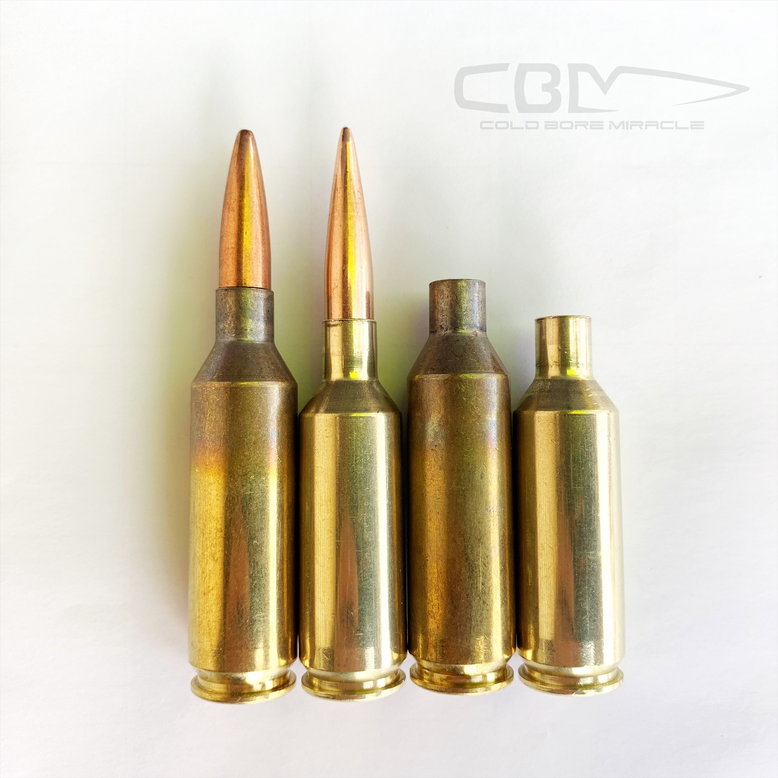

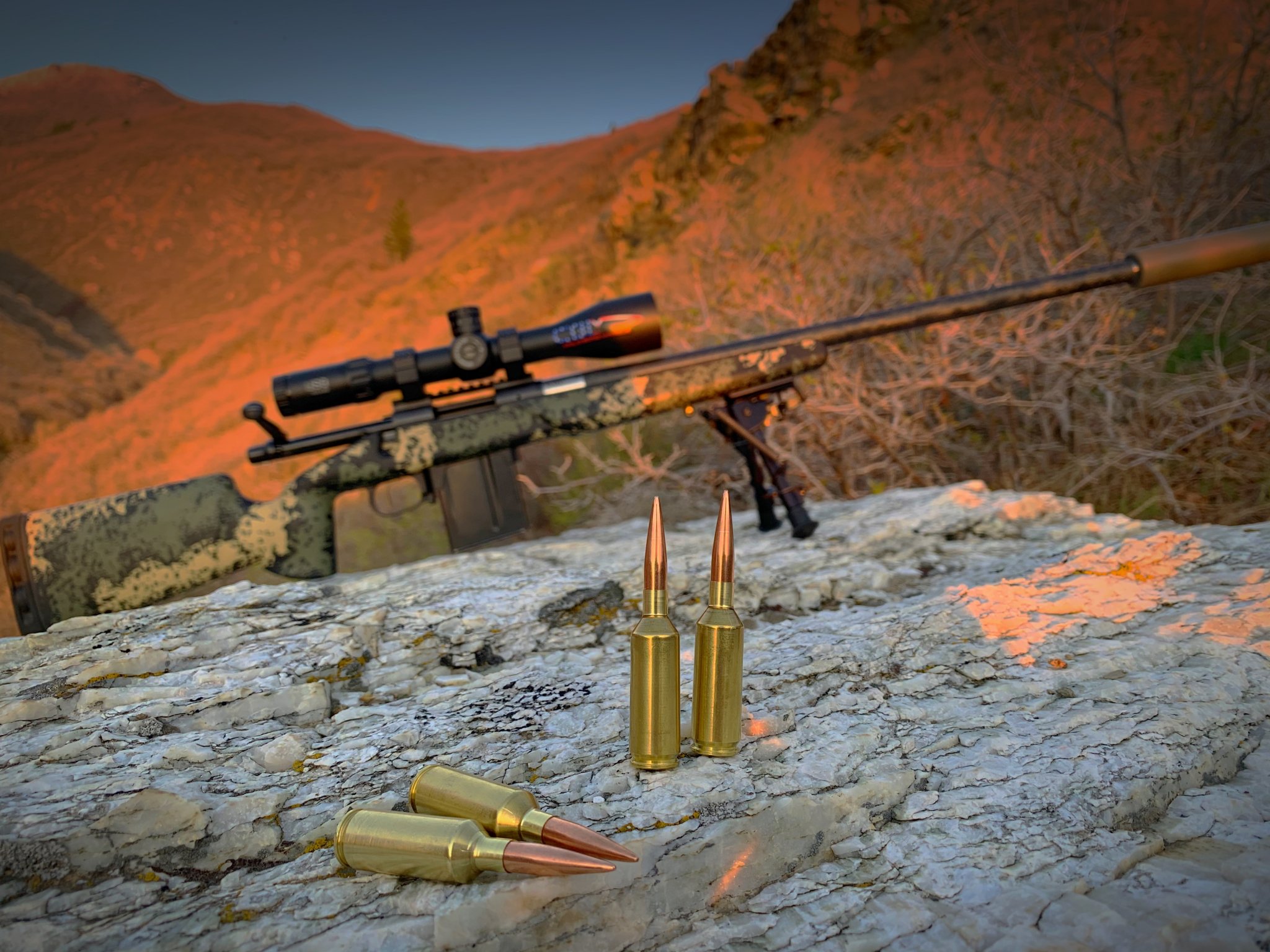

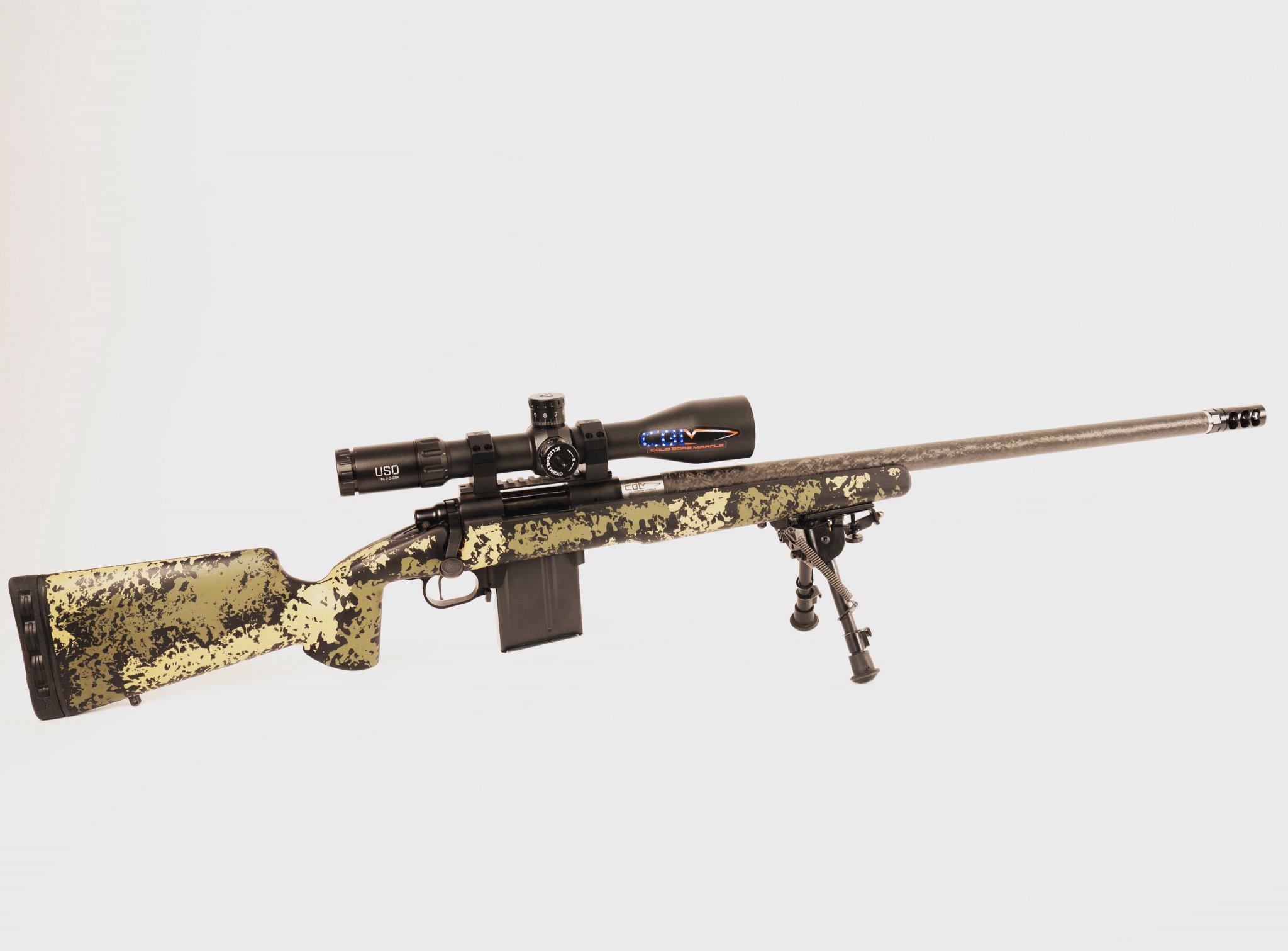

My latest project, the 257 Blackjack. A SAUM based cartridge shortened to run in a SA DBM, pushing the 131 gr Ace at 3200 fps with a BC of .340-.345. supersonic past 2000 yards and only 5.3 MRAD to 1k.

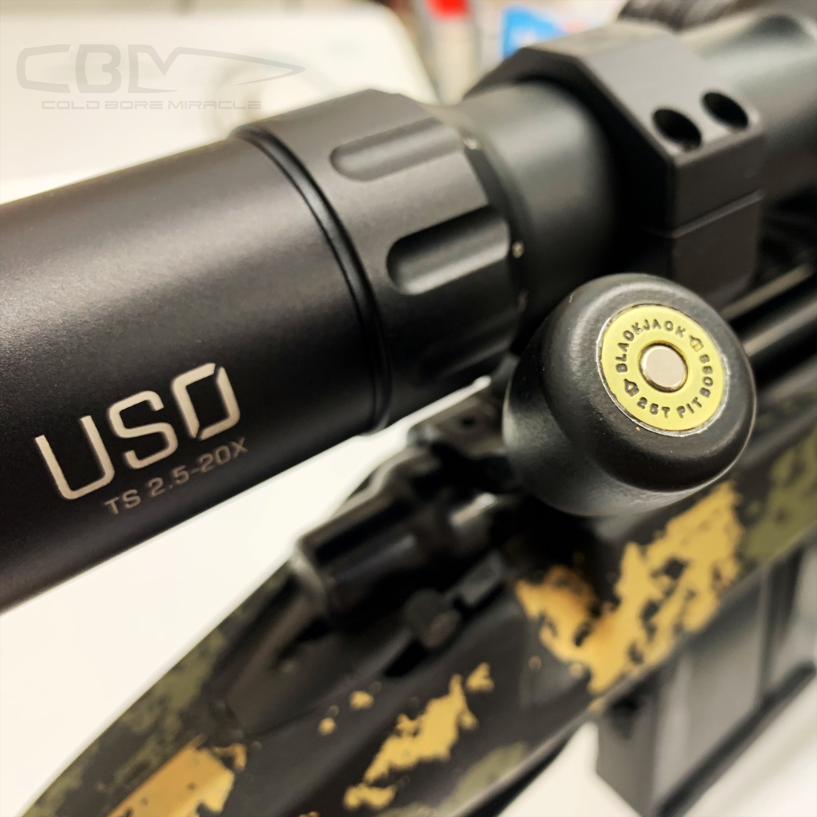

Built on a 700SA, Iota Carbon chassis, Proof 24" 7.5tw, US Optics TS 20, PVA Jetblast brake, A TT Diamond, and Hawkins bottom metal.
View attachment 7220468View attachment 7220470

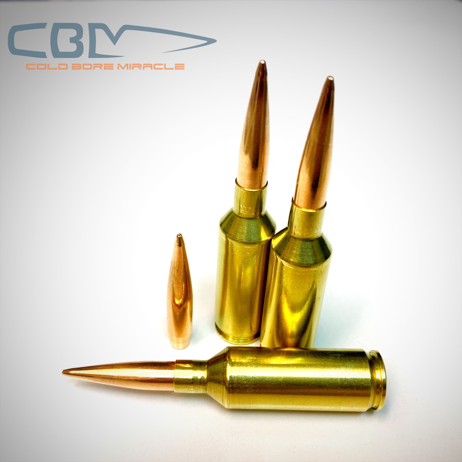

I was wondering what the parent case may be. What steps are involved in forming brass from GAP 4s to blackjack?
Several courses of cut,trim, anneal, turn.

So what is the difference between the Blackjack and the SST?
Blackjack COAL with 131 Ace = 2.855............. Shoulder angle? Is it 35?
SST COAL with 131 Ace = 2.860..........Shoulder angle is 30
I chose to go with the SST mainly due to the support and brass availability from Sherman. Load and shoot brass is the ticket for me.

I just wanted to let interested parties know, 257 Blackjack production brass will be available December 2020 or January 2021.
Of course reamers and a few types of dies will be available at that point.
Projects like this have a tendency to lag a few months and with the election year it is prudent to say that Q1 2021 is most likely a safe bet for those naturally inclined to some dose of skepticism. I definitely fit into that group. : )

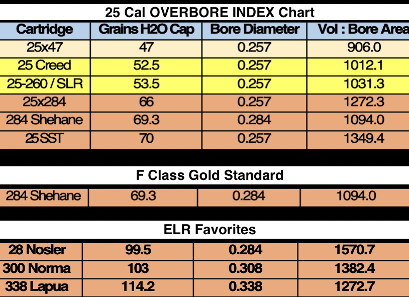

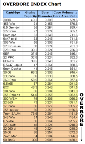

For those considering barrel life of the 257 BJ, it was designed to supersede SA performance but not be so hot as the 25 PRC/SAUM/WBY or even the 25-06 in terms of Overbore Index. A simple design goal of 3200 fps was set with the understanding some headroom would be nice. The 131 ACE likes to run 3140 and 3170 fps but upcoming releases to the high performance 257 realm like the upcoming release from Berger may indeed enjoy the headroom. Quickload calculates max pressure around 3260 fps and real world testing correlates this.
At 60 gr H2O capacity the 257 BJ shares the same exact OI as the 257 Roberts Ackley Improved which somehow happened fortuitously. You can see below that the 257 BJ will fall into the zone of cartridges that are a bit spicy but not completely overbore, akin to 284 Win. It lies nearly perfectly on the dividing line between the Yellow and Orange qualitative indicators of the original author.
For those who prefer simplicity, 257 BJ will equal or better 25-06 performance in a SA with 10% less powder or simply, a 257 Roberts AI in a SA.

We believe the design goal of 131 gr (0.340 G7) at 3200 fps suits the mountain hunter and the long range competitor very well offering high performance, ample energy at 1000 yards without unnecessary recoil, and I believe the market is as accepting of balanced cartridges as it has ever been. The magnum craze of the 2000's has passed and people want to enjoy shooting their rifles.
The recoil to performance ratio of 257 BJ is perfect for me at 170 lbs with a Carbon/Carbon rifle setup.
Anyhow, I'll be counting the days to the end of 2020. Selected 257 BJ testers will be receiving the brass soon enough and further reports should be trickling out in the coming months.
If you know of someone with rigorous data keeping and/or a philosophy of use prime for 257 BJ testing please let me know so we can review.
CBM will be getting the earliest of the production brass to test of course!
Super cool for sure @257 Blackjack. CBM turned me on to the quarter bore creedmoor (25 creedmoor) sometime ago in my desert tech. I love the cartridge. I’ve been reading his findings with the 257 blackjack and I’m very intrigued. Nice to see the .257 class of bullets getting some much needed attention. I look forward to future updates.
That’s awesome! I can’t wait to see more results from the 2020 hunting season with these bullets. After seeing coldboremiracle 25 creed I built one myself and absolutely love the caliber!! Would like to maybe do a little testing myself!

What load? I'd consider going to a slower powder. Reduce overall pressure. You've got a long barrel on yours, IIRC?
26" barrel. 53 grains H4831. CCI match primers. I got the barrel early when they were recommending 1:7.
I agree with Sandwarrior. Try a different powder, Im getting the same velocity with 4 inches less barrel and 10 grains less powder. My Blackjack is a 24" and using a grain more powder than your 25-06 it is giving me over 3200 fps. I'll bet you could get it significantly faster with a different powder, that is of course if you want to.
I love
I love 4831. But, in your case a move to RE-22/23 would help I think. Double base vs. single base. -23 is as, if not more, temp stable than H4831.
The big caveat sometimes is whatever you can find for powder. And, ya just gotta do with what you can get.
