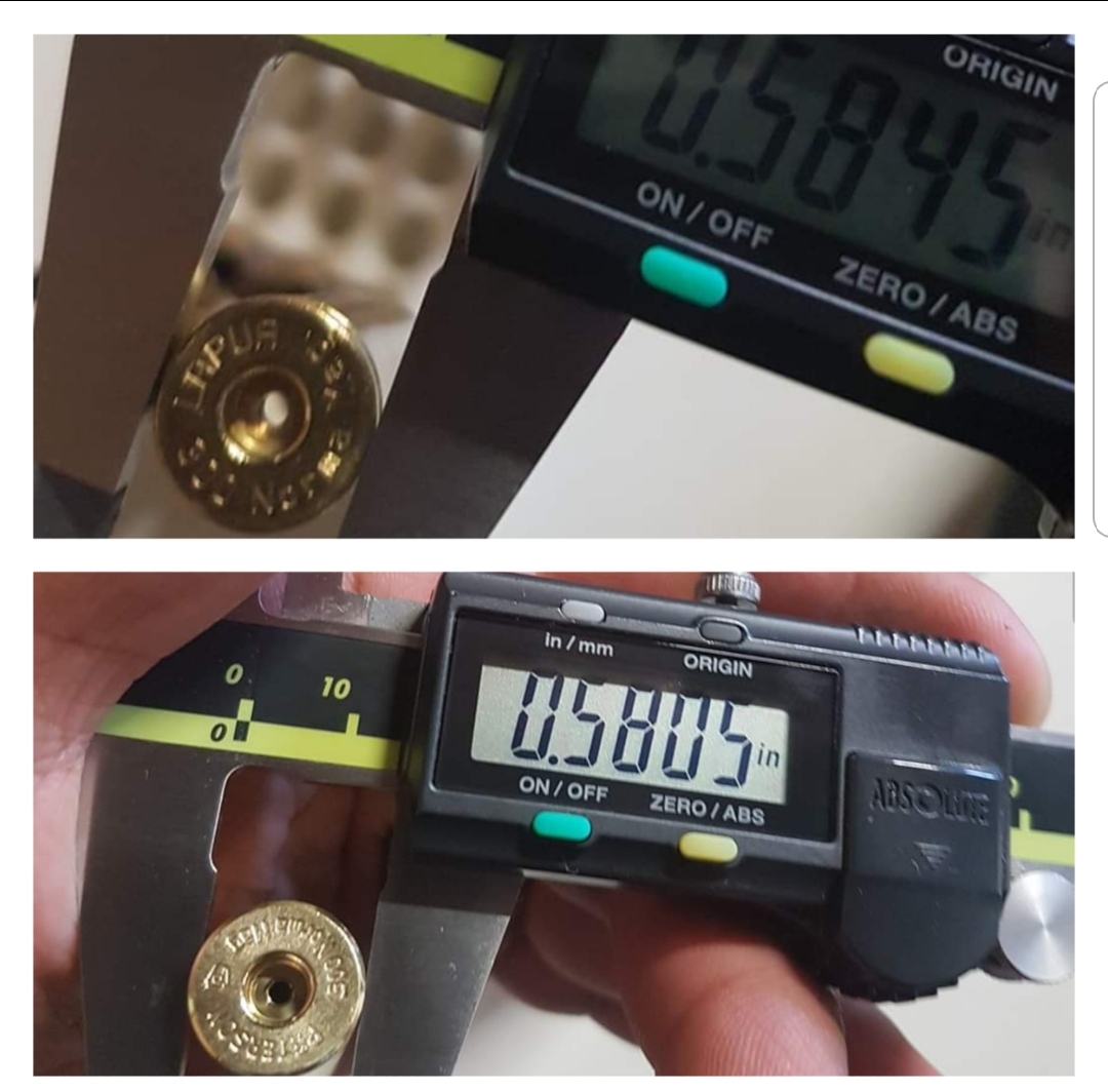

How much case lengthening do you guys consider acceptable after firing virgin brass?
My unfired Peterson brass was measuring mostly 2.022 to 2.032 with most in the middle using my shoulder measuring tool. My fired brass is all 2.042 or 2.041. 20 thousandths seems like a lot of stretch to me in one firing.
Any input?

I started a thread in the reloading section called "How Much Headspace Is Too Much?". I started it because I couldn't find any good answers to the question and my unfired brass was up to 20 thousandths short in my chamber. I wasn't sure if it was a chamber (SAC) or a brass (Peterson) issue.
As an added data point, I just measured 10 of my virgin Norma brand .300 Norma Magnum brass. They all measured 2.040 at the shoulder +/- .001 which would make them about perfect in my SAC chamber which is producing 2.042 fired brass.
It definitely looks like Peterson needs to refine the measurements in their .300 NM brass a bit. We will see if casehead failures are a problem for me later on.
Any input?
Mine grew about the same. I heard somewhere that the Sami spec for 300 N is a wide margin and brass usually sits at the bottom and chaimbers usually sit at the top? I have no idea if that is true.

My Peterson fireforming experience was similar. With a mild load (83 gr. N570) the primers seemed a little too flatty for the load. I'll check the HS delta against unfired brass. Being in Europe, I have a box of Lapua brass (at least this time this one is the right side of the pond) on the shelf to compare with...let ya know.
So Gents, here are my numbers.
Peterson unfired brass lot #W1AR0090 2.060"
Fireformed as per the above charge 2.068"
Lapua Lot#80111401/0661018 unfired 2.066"
Hornady gauge, 420 datum.
Reactions: BClrh and McCrazy
The headspace on the Peterson unfired is only .006 less than the lapua so the guys that are seeing ,020+ growth in headspace on there Peterson brass must have max spec chambers. gnatmm, the virgin lapua brass is matched up perfect to your chamber. What are the major diameter measurements on the virgin lapua and Peterson brass that you have coming in at?
