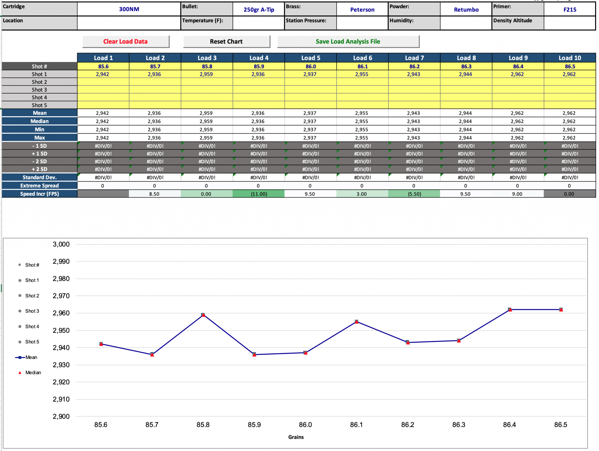

For those that are interested, here is Round 2 with 0.1 grain increments from 85.6 to 86.5.
I think I have decided on 86.1gr. Even though there is a spike, I think it was a fluke especially since the two loads on either side of 86.1 had an ES of 8.

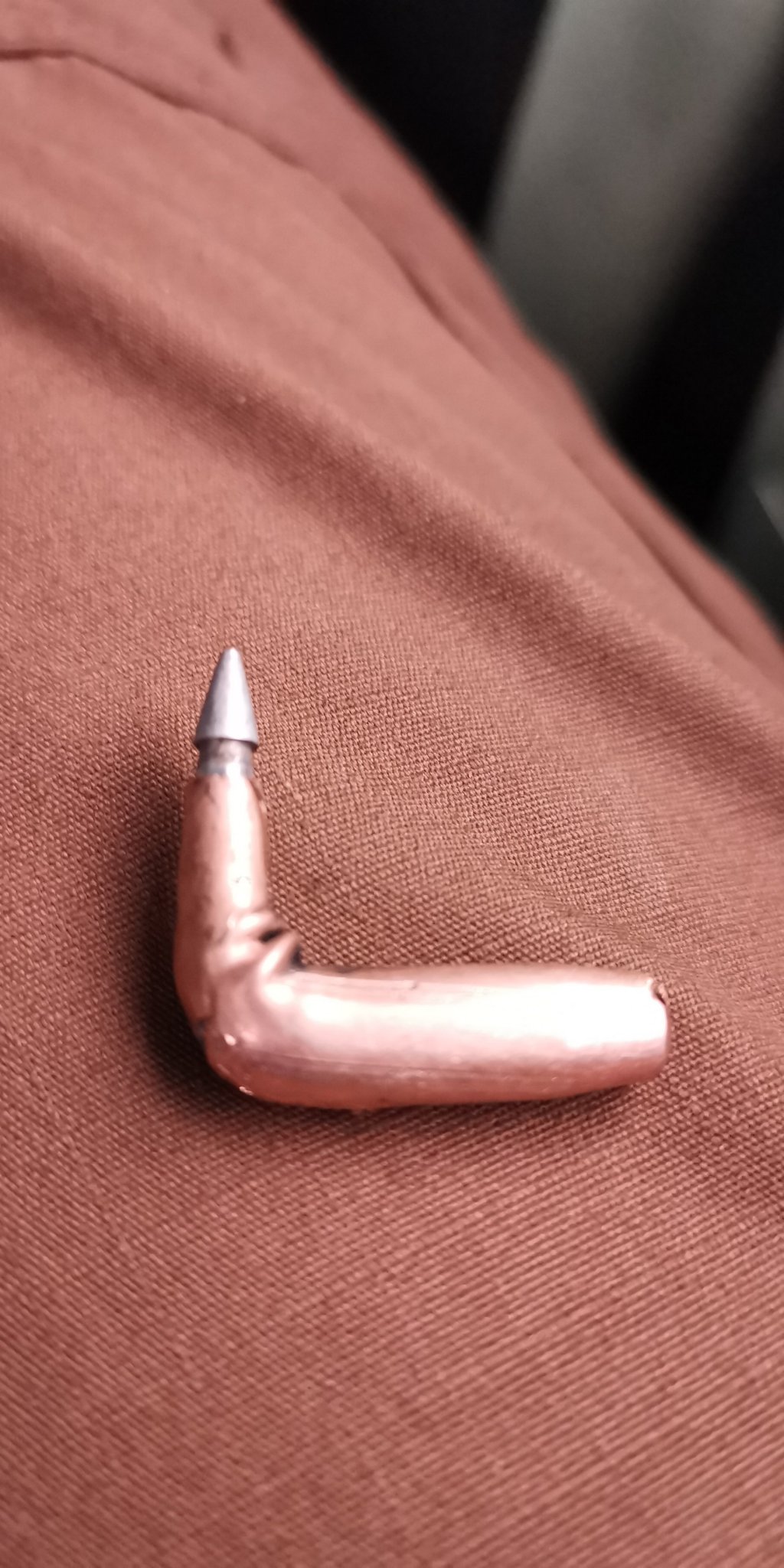

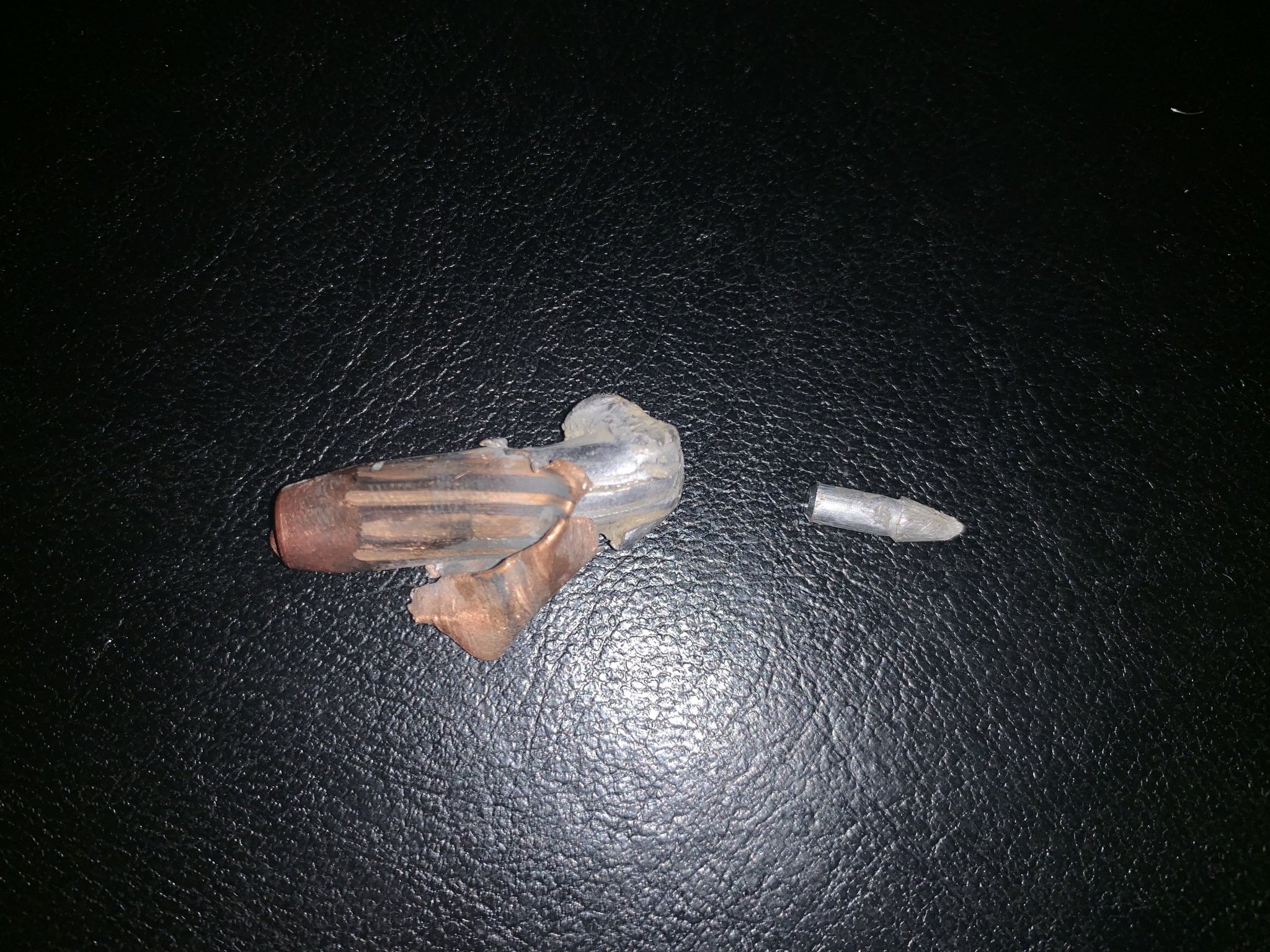

For those of you that are wondering what the inside of an A-Tip looks like, I posted a picture of one of my misses I found on the ground near my target.

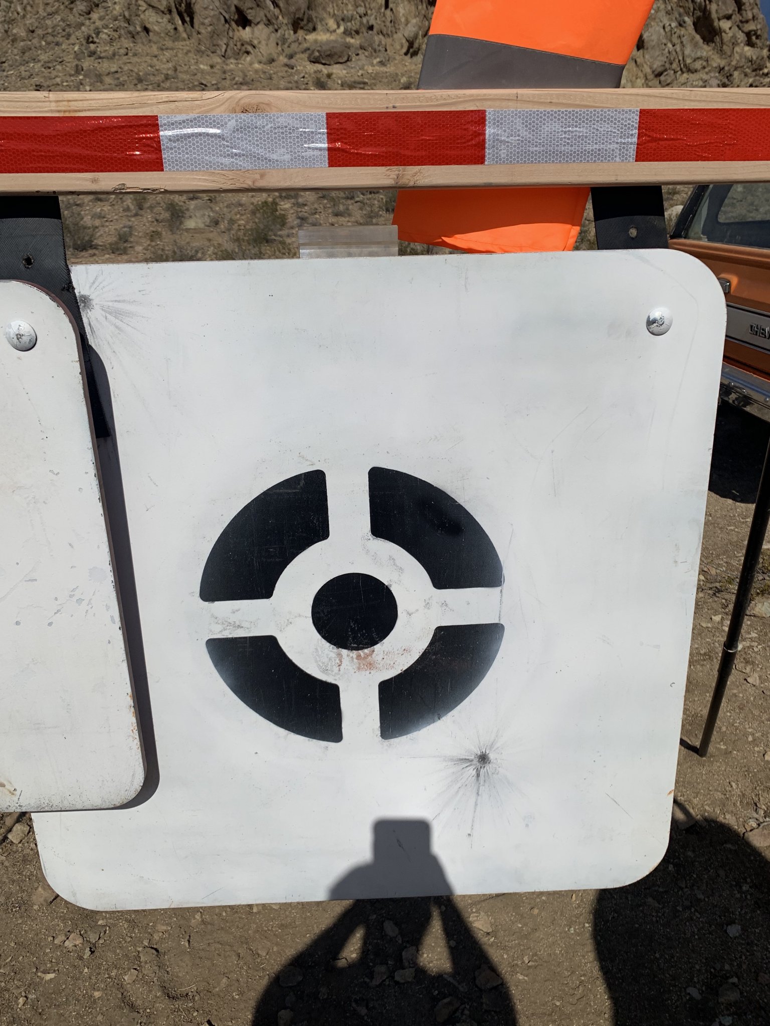

I also posted a pic of two hits I made at 2818 yards. I'm pretty happy with the hits given the fact that I was shooting a load workup with different powder charges / velocities.

Those are some really impressive velocities with a 250! And nice shooting!

Also, that looks like a very handy Excel sheet. Is that something you can share with us?

Excel is from 6.5 guys. Head over to their website or YouTube channel and you can download a copy. Here is a link http://www.65guys.com/load-development-analysis/

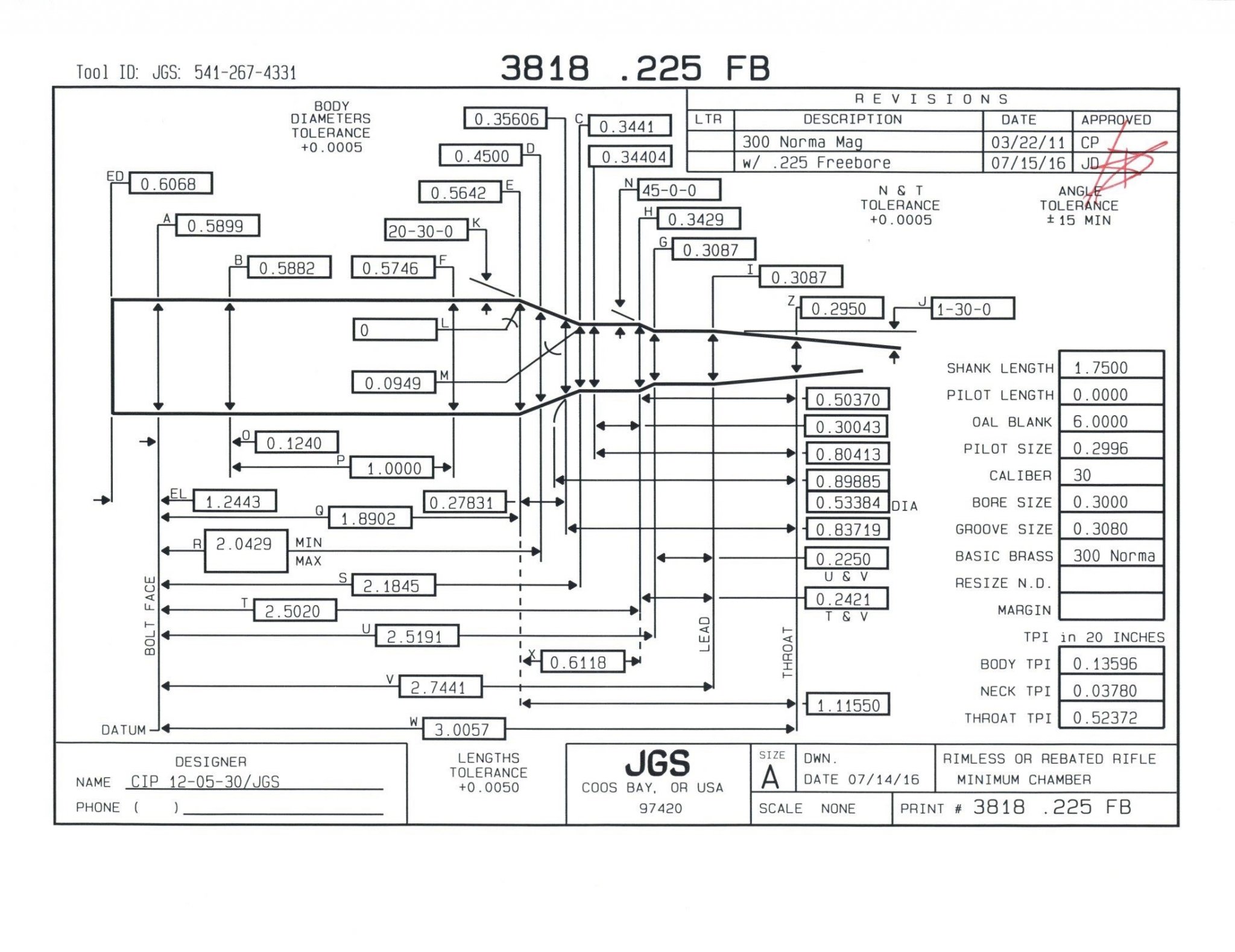

Do you have anymore details on the A tip bullet you recovered? Estimated velocity at hit? what part of the tire did it go through? There are a number of guys testing the Atips out for hunting rounds and that doesn’t look ideal to have the tip bend over instead of expanding.

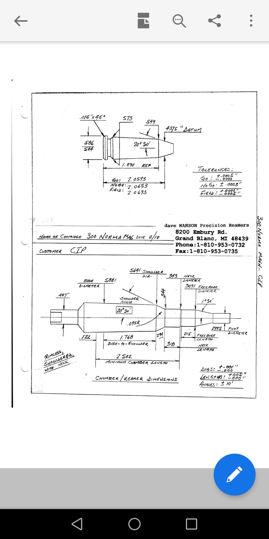

Ah, so a .225 freebore. Just a bit longer than what Manson Precision Reamers uses with their CIP reamer.
I‘m curious as to what I’ll be able to get out of my barrel with the .215 freebore.
I was shooting in a military base , main target site was an old tank bodywork and in front a metal target of 1 1/4 MOA , in the down part of target there were some old deflate tires with their rins, I supposed the bullet hit the tire as it was flat and inmediately found the Rin and bended, the tip was intact found in the rubber, the VO at that distance 1610 meters was 1293 FPS still supersonic , don t know much on hunting I only do LR, but as I can see it would be easily go through any animal but don t think it will expand ....but really don t now much.
Ah, so a .225 freebore. Just a bit longer than what Mansonuses with their CIP reamer.
Send brass, bullets and magazine you intend to use to your gunsmith and have him customize your free bore.

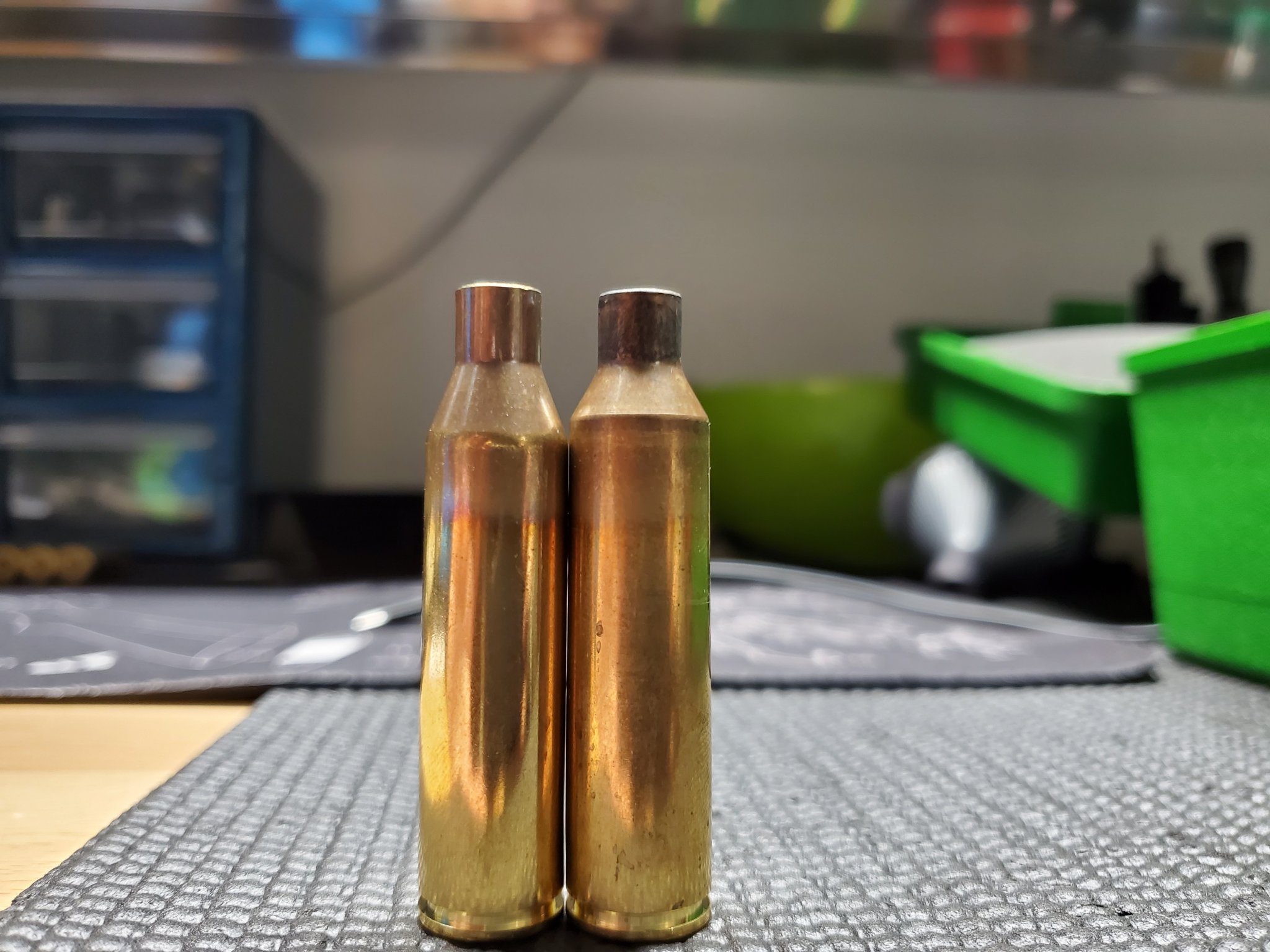

New to this. I was wondering if anyone else has experienced this with brass.
Lapua 300 norma brass new on the left and once fired on the right. That seems like alot of stretch.
It sure looks like you might have a 300 Norma improved chamber
Left is a standard case, right is the result of an improved chamber, right? It's shoulder has been pushed forward, the shoulder angle made steeper and the overall case length is probably a little shorter. So it's not so much the case has stretched but rather re-formed to the 'improved' chamber dimensions.
