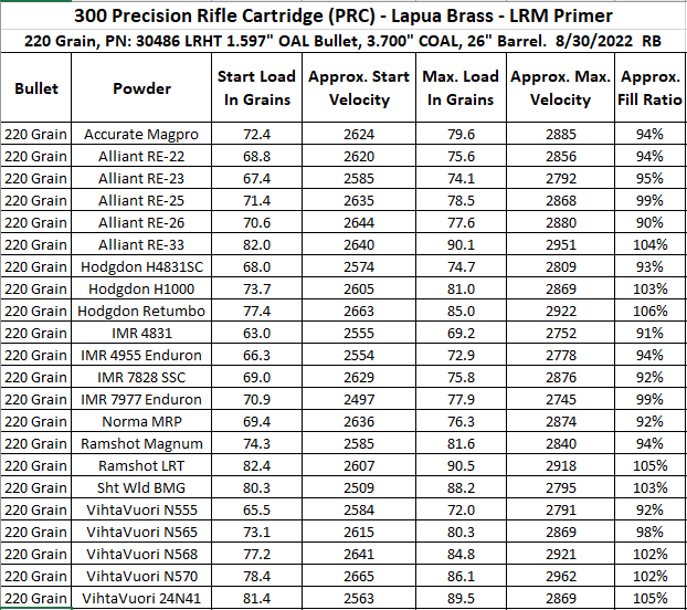

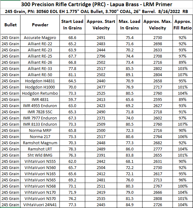

My Berger 230 Hybrids finally all but ran out (I have about 50 left), so I swapped over to Berger 230 OTMs and went out to the range yesterday to play with seating depth. It's amazing what difference .003" makes (lower left right is .015" off, 5 shots, other 2 are .018" 3 shots each)
GetAttachmentThumbnail
My Berger 230 Hybrids finally all but ran out (I have about 50 left), so I swapped over to Berger 230 OTMs and went out to the range yesterday to play with seating depth. It's amazing what difference .003" makes (lower left is .015" off, 5 shots, other 2 are .018" 3 shots each)
What are you doing?! 220s are available and amazing! :).
