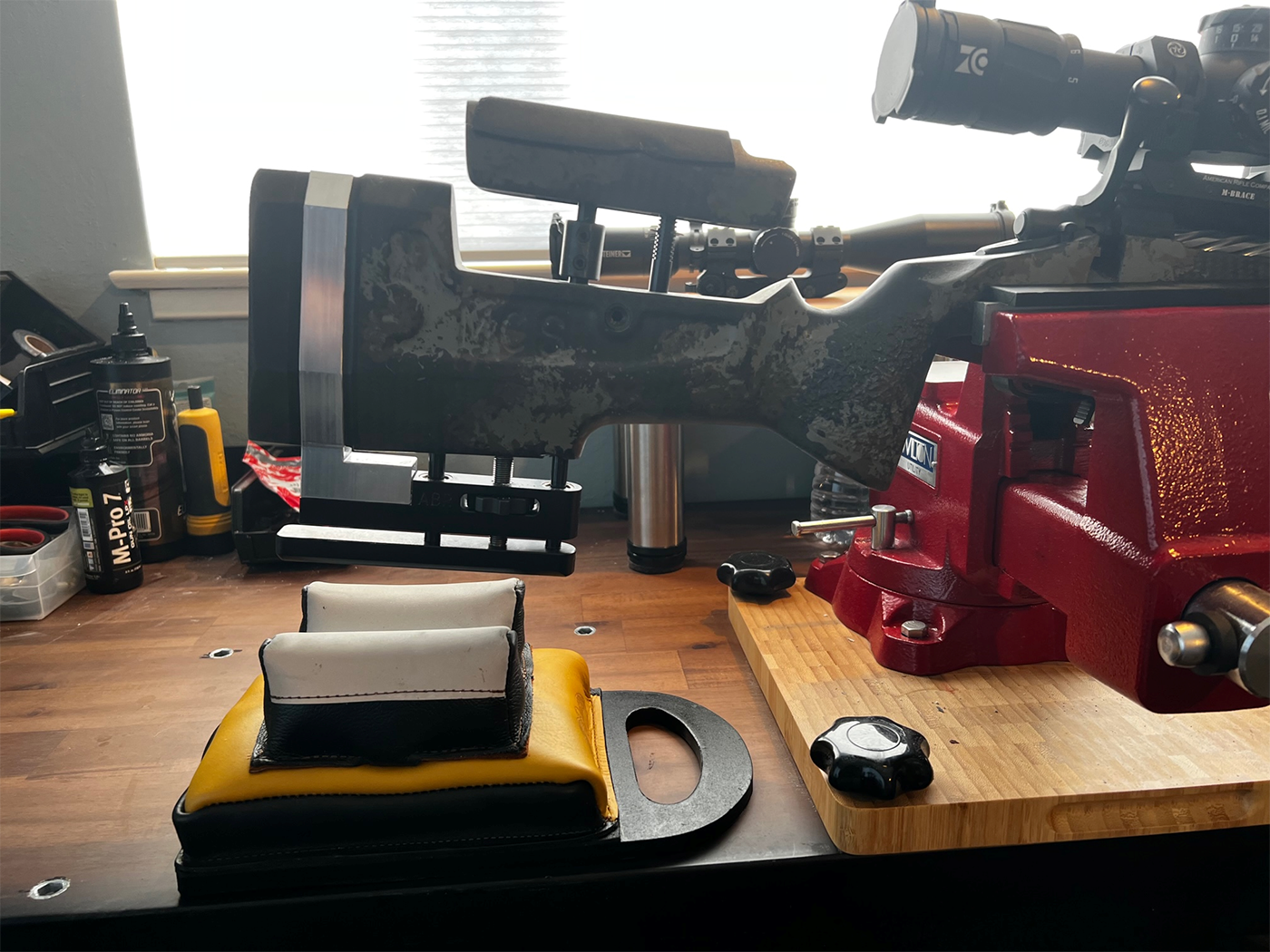

My 300 PRC got some new toys - @b2lee I got a new ABR bracket fabricated for my Manners stock and bought another ABR. Down below is a new custom Protektor bag that's lower to accommodate the ABR under the stock.
And, oh yeah, that's a new ZCO 5-27 with the MPCT-1 reticle up top - drove up to Sacramento yesterday to pick it up from @CSTactical. Great to meet them in person (and learn they can cut barrels for me too!)
