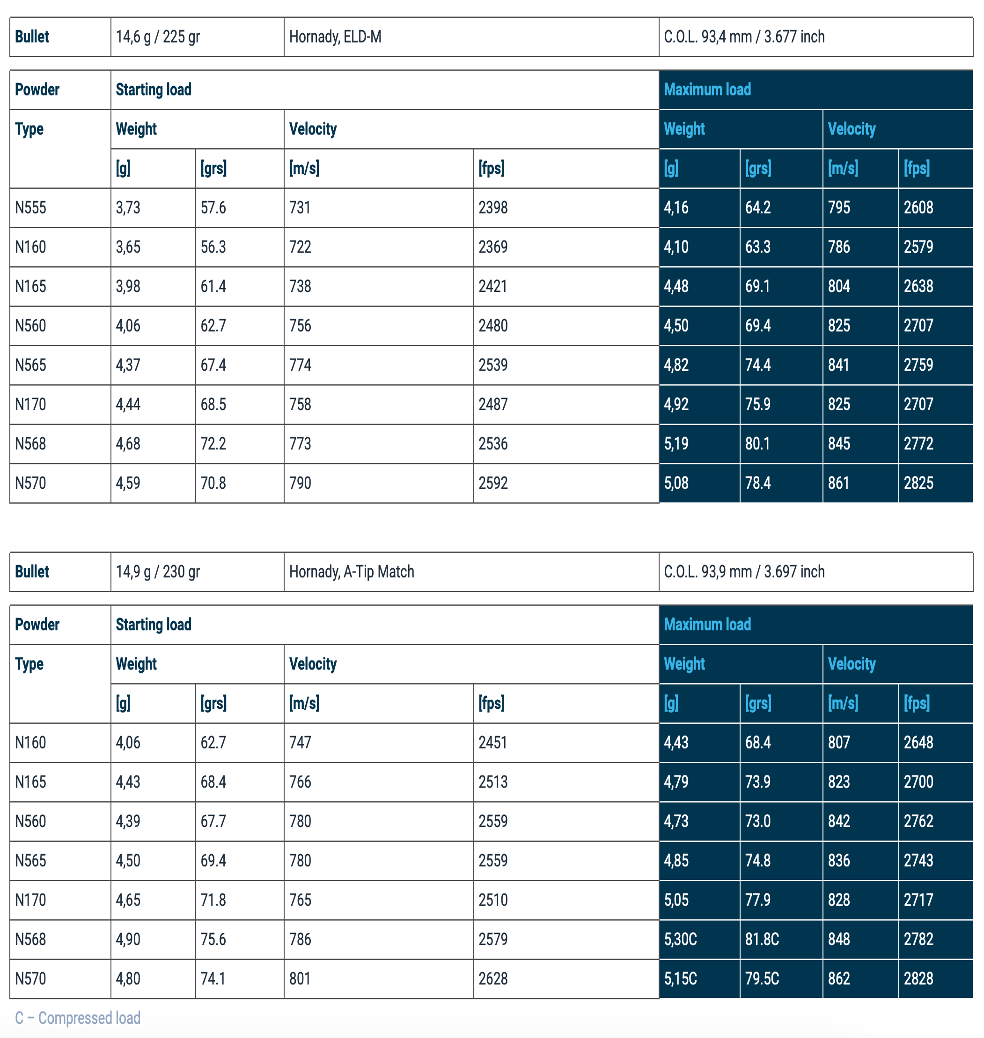

300 PRC update
from VV. PS: these numbers are by them stated as for a 26" barrel, you will notice N570 is quite a bit higher at all the loads.
G
Sorry that’s not what I was asking…. The 560
Numbers from GRT show much lower than nominal pressures for the max charge shown above (VVs website). The simulations show that you could push the max charge much higher than VV is showing here…. I was wondering if anyone has tried to…

I'm getting ready to test 220 LRHT with h1k and 565. H1k has always given me the lowest ES/SD. 31.5" Bart, 9 twist. But I've only run about 3k rounds of 300 prc. There are others here with more experience.
Curious, was / is being nudged to N565... but looking at the numbers for N570, it looks better.
For now it will be either ELDM 225gr or 230 A-Tip's down a 24" barrel.

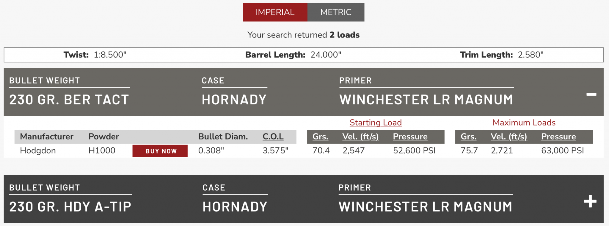

hi b2lee
2 questions.
1. get the idea this might be something you can assist me with, please cast your eyes over:
2. on my powder choice, I'm between N565 and H1000, and being more nudged towards N565... but low and behold, my poor eyes saw the cousins called N570... and seeing the numbers... wondering why not... might it be that N570 would give these numbers in a 26" barrel, but not in my little (I'm to short... 24") exhaust.

Yes I would run N570 in a 300PRC,
Reactions: georgelza
as much as I agree, think this is actually one of those subjects that falls under a it depends, its not just the caliber, it's depending on the bullet weight and the barrel length, which then define the powder used and how much.
as said, get the idea in a 24" for a 230 gr N564 would be good option (not discounting H1K) while a 230 or 250gr in a 26" would suit N570 and for 245/250gr in a 28"+ barrel Retumbo would be the go to.
