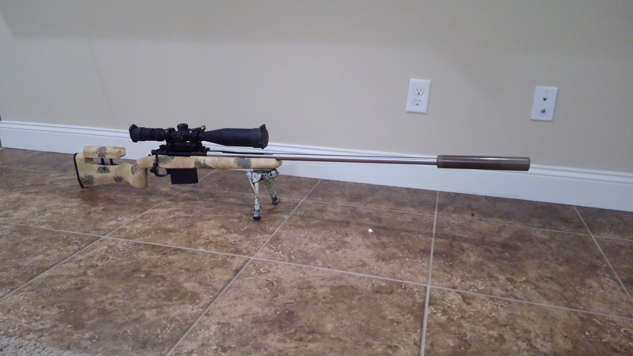

So with the leftover sized and primed Hornady Brass I had before parting ways with the Hornady Dies, I just did some workup with 215 Bergers today with H1k in .5 gr increments. CCI 250 Primers. Loaded with an fx120i with 419 auto setup. (these things are awesome by the way). Brass was full length sized with a neck bushing with 2 thou tension. Used the Gurard trimmer on all the brass also. Loaded to 20 thou off the lands for testing with the Berger 215 Hybrids. COAL 3.700.
Rifle is a 26 inch proof Suppressor was a TB Ultra 7. Magnetospeed V3 Chrono. 85 degrees in the shade with no direct sun. 20% humidity. Allowing rifle to cool between 3 shots at a time roughly. Shot two foulers after a clean rifle. Let cool, and then began. Started low as I didn't know what to expect.
UPDATED with my sweet spot
H1000 ___ FPS
79.26 _____2975 SD of 2.6. 5 shot groups under .45
Hope this helps someone out.
Jake

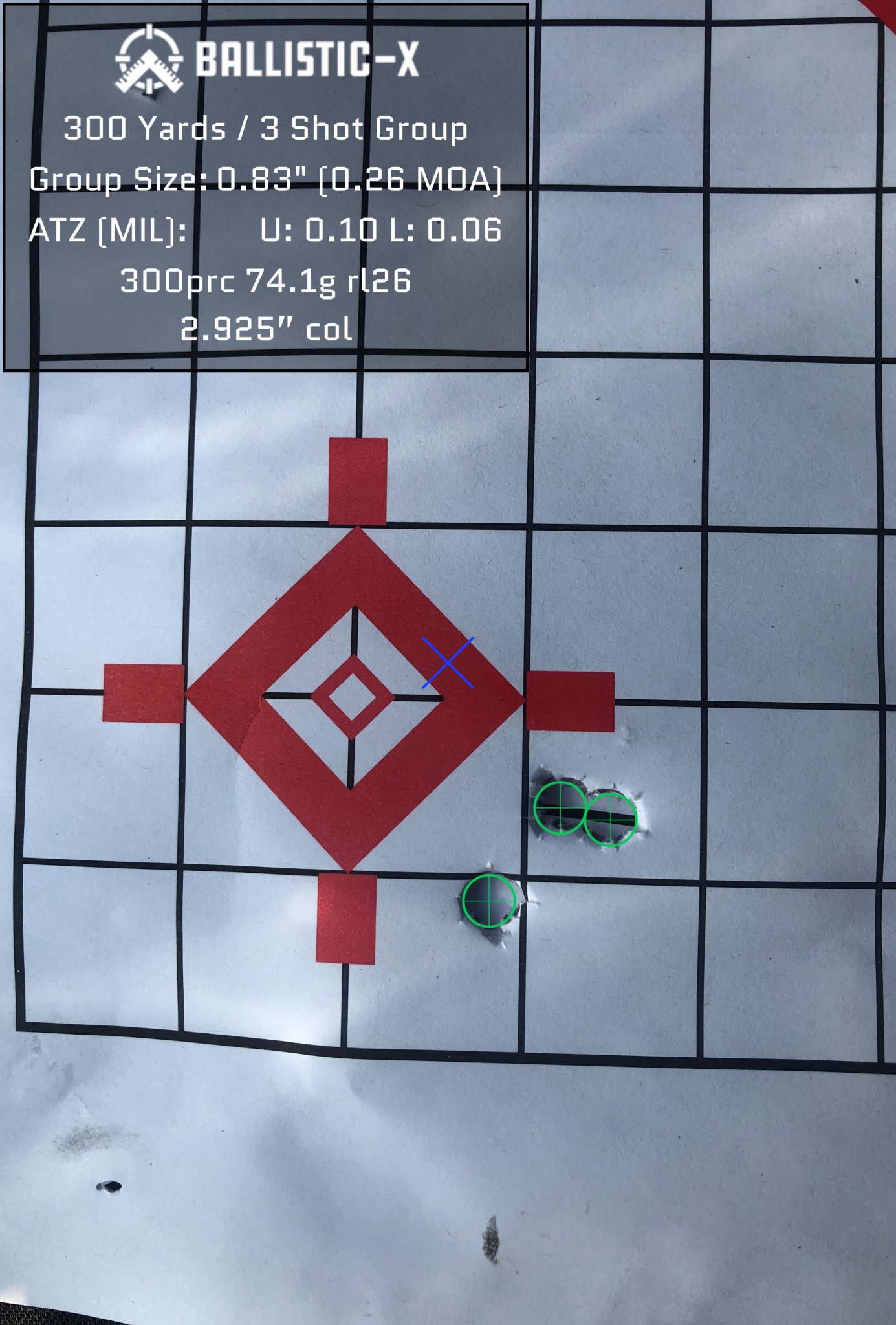

I just got back from the range where I did my big Reloder day (mostly RL-26). So, if you're thinking of trying RL-26, and can find it for sale somewhere, I wouldn't buy it. Instead, let me know where it is, and I'll do the precision shooting population a big favor by taking it out of circulation.
Two words: OH. MY.
Let's get to the meat of the day first: Reloder 26.
My first load was 74.1 gr. All groups today were at 300 yards and with the 225 gr ELDM (as always). I had expected this load to fall in the mid-2700 fps range. When I fired, I almost missed the target - as in the WHOLE target - because it fired high. The Labradar registered 2907 fps. The total group averaged 2913 with a 13 ES and 6.7 SD. Wow. Group size was 1.27" at 300 yards.
Here is all the data:
74.1 gr RL-26:
Average FPS: 2913
ES: 13
SD: 6.7
Group Size: 1.27"

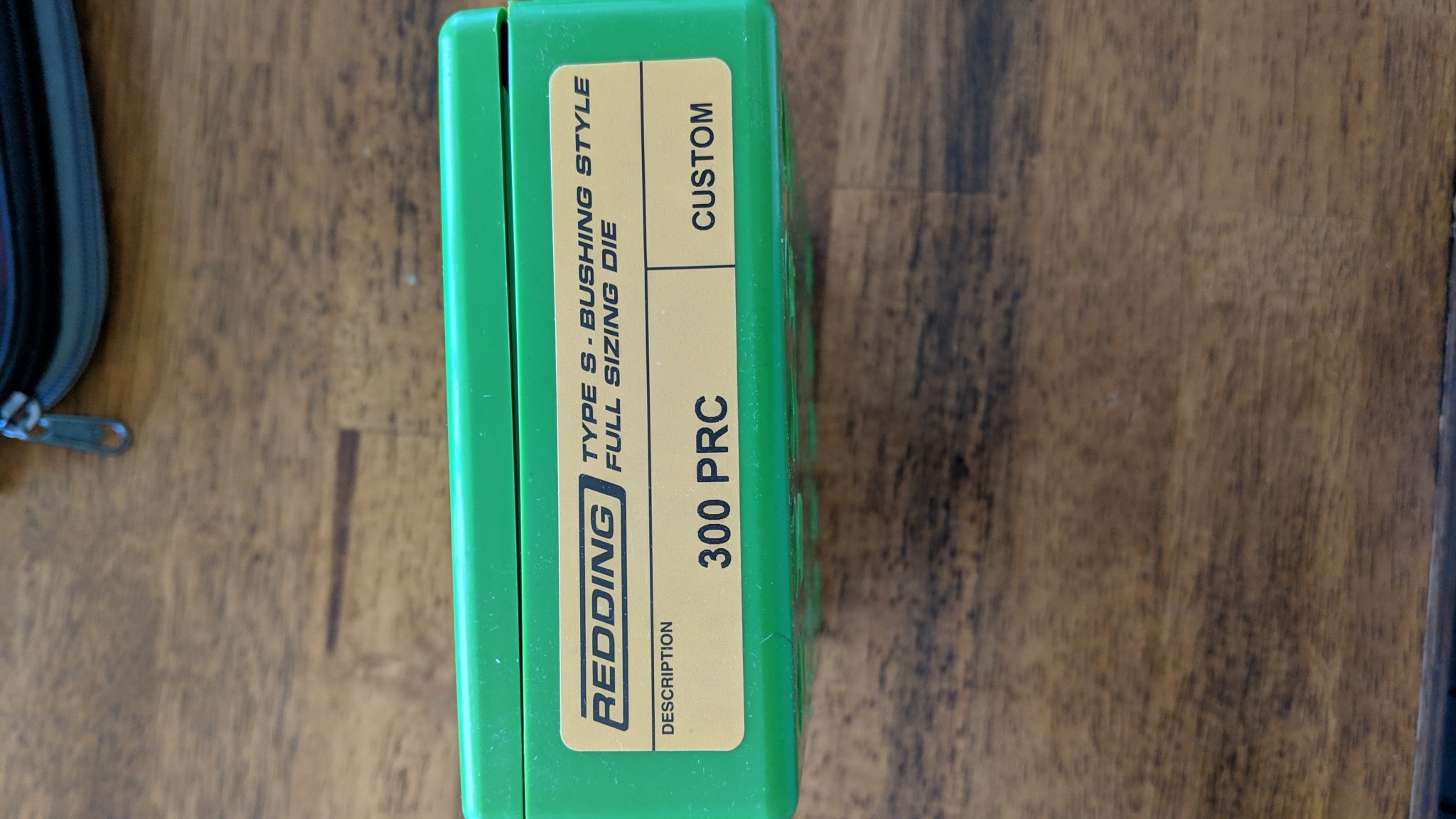

Next, I did my neck tension test. I ran groups at .001, .002, .003, and .004 inches of neck tension. I'm not really a fan of .001, but it clearly won the spread contest. This test was with 76.2 gr of H1000.
.001 Neck Tension:
Average: 2856
ES: 8
SD: 3.6
.002 Neck Tension (what I ran all other tests at):
Average: 2874
ES: 16
SD: 8.6
.003 Neck Tension:
Average: 2871
ES: 25
SD: 11.1
.004 Neck Tension:
Average: 2875
ES: 44
SD: 19.8

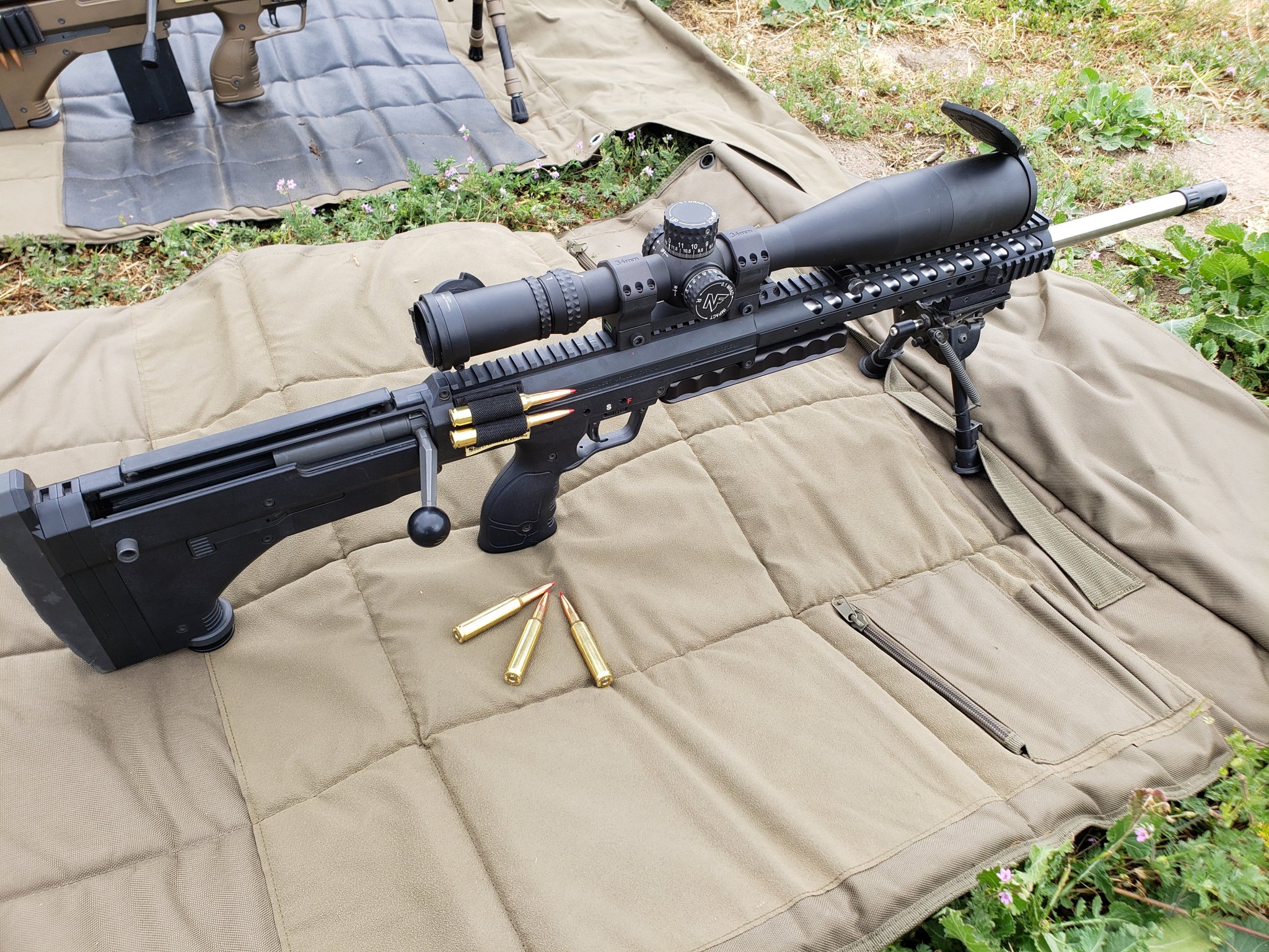

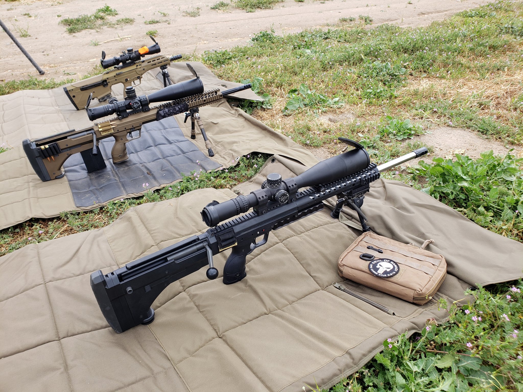

What barrel length and how many shots per group? No pressure and getting a 225 eld over 3k is impressive.
I’d love one for my DTA, but I can’t find anyone that will spin one up to my specs. Either they don’t flute barrels, or they won’t do the twist rate I want.
Dane will spin you up a barrel, he's DMR rifles. Doctor Doctor has a sick barrel from him.

I ordered the type S neck bushing full length sizing die. Had to go the custom route as they aren't making the type S for retail yet. 176 bucks for a die plus shipping... but it's worth it.. I've also found the 334 neck bushing is working the best with the Hornady brass.

I also played a little more with RL 26.
Best loads came out at 75.4 and 75.6.
75.4: Avg - 2970, ES 15, SD 6.2 - 5 shots
75.6: Avg - 2971, ES 10, SD 5.5 - 5 shots
Groups were hard to come by as the mirage was fierce. The 75.6 load was also one of my better ones from the last trip, so I think I'm going with this as the "champion" load for this powder. I'll also be playing a little on the lower end - probably high 73s to low 74s.
Also, I did another neck tension test, this time with RL 26. Again, the lower neck tensions did better. I'll be loading at .001 neck tension in this rifle with both H1000 and RL 26 from here on out.
Reactions: Ledzep and Forrest

Was able to get my barrel spun up this afternoon. Will start load dev/break-in next week, probably with 225 ELDM's. 1:9.5-1:9 gain twist, was able to finish at 31". I measured the groove dia. at the muzzle and it wasn't bell-mouthed as far as I could tell so I didn't cut the last inch off of the blank, maybe only 1/4" or so... If it doesn't group well I might try cutting it back.
Looking to run 230 or 250 A-tips. Will have to try both for velocity and see which wins out in the long run.

Today I was cleaning some of my rifles and noticed that I have a Hoptic 2 round quiver on most of my rifles. I was like, "Oh yea, I'm going to need one for my 300PRC". Ofcourse nothing I have comes close to fitting in a 300PRC. So, a quick email off to Matt Stoner at HopticUSA to ask, "What quiver can I use for the 300PRC?".
Matt must have been checking his messages right then and there because it wasn't 30 seconds later I got a reply. He said he's going to do a production run in July of some 338 quivers and he will open up the mouth enough to fit in the 300PRC. I'm already ahead of you guys on the 'List'. If you guys are interested just email Matt stoner at HopticsUSA and let him know your interest. I figure anything we can do to help get accessories companies offer us options in 300PRC is a big help to those that follow behind us on this journey of the 300PRC.
Oh...and he did mention a 50 cal version to be released in June....I don't have a Fifty...but I may buy a quiver and mount it to the side of my 22lr target rifle to make some people shake their head at me at the local range.
