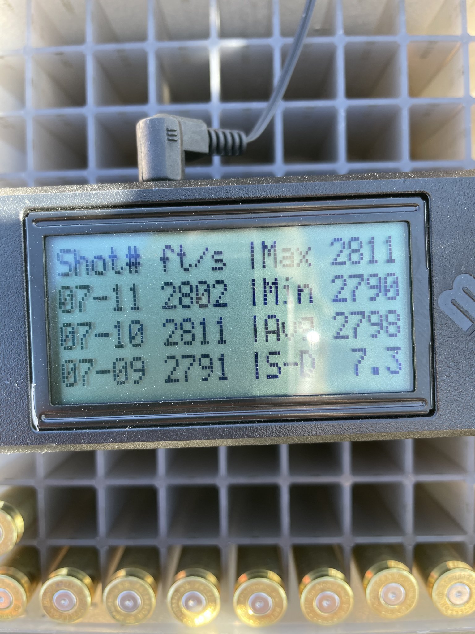

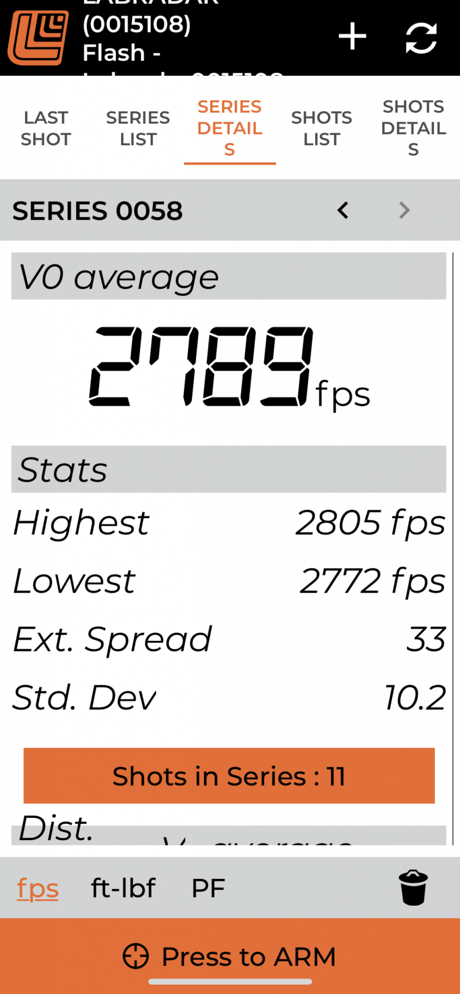

It’s weird how the these two have different readings as far as SD and ES considering nothing changes during the cof.

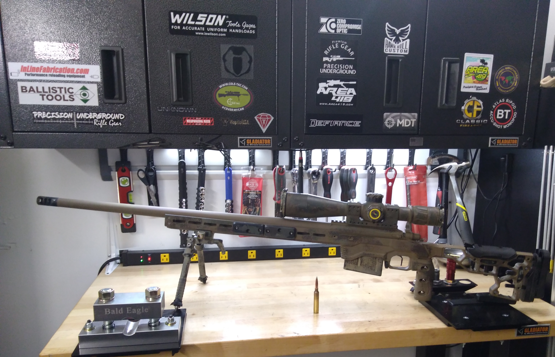

Moon called me and I jumped in the pool today.
Manners EH1 scorched earth
Defiance deviant
Bartlein 1-9, 25” w/ APA brake
APA CIP bottom metal
Triggertech diamond
Only 23rds down the pipe. It REALLY likes the following load:
215 Berger
ADG brass
77.5g H1000
Looking forward to more range time!

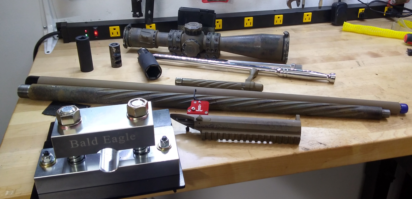

Just spent a few minutes taking my 300PRC completely apart again. UPS should be here in an hour or so with my new barrel. I'll spin it on and recheck head space. Then....I'll paint it to match and put the MDT ACC and ZCO 5-27 back on it.
My ATS barrel tuner won't be here until tomorrow or Saturday though...and I have to work all weekend. So, it looks like maybe Monday I'll get to the range and start getting the first 100 rounds or so through it to normalize the speed and then start tuning it for best accuracy at distance. Maybe by next weekend I can take it to TVP and check accuracy at 1mile +.
The learning curve for the new cartridge wasn't bad at all on the first barrel...so...it's all gravy from now on.
