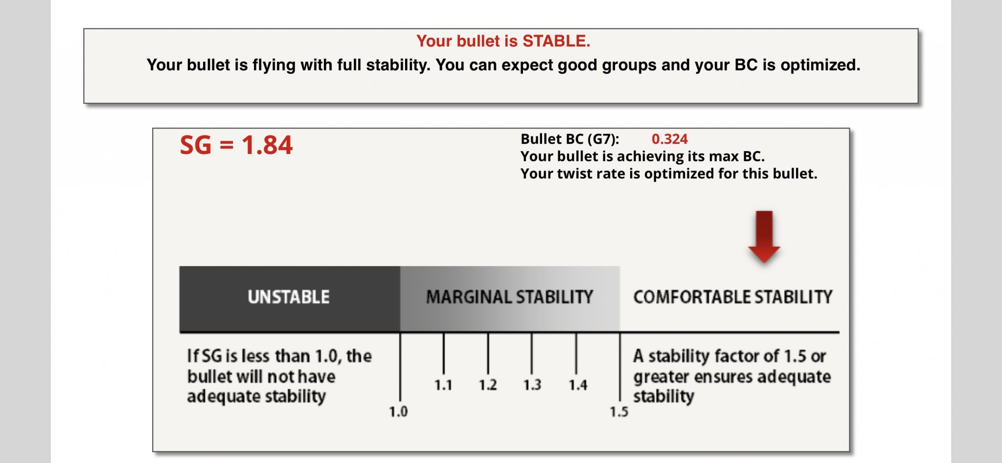

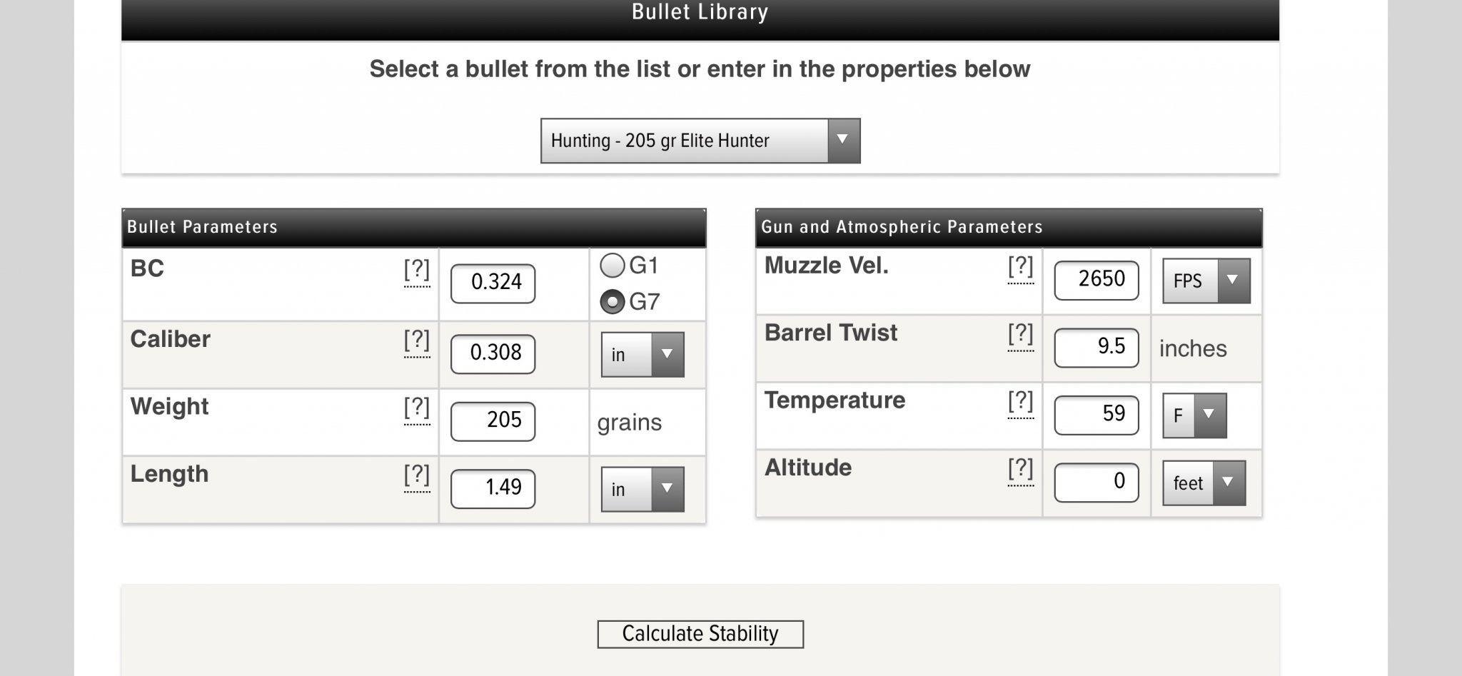

Check out berger’s stability calculator. (Screen shots below)
Even at the low velocity of 2650 it says you’re still stable. Can’t imagine you’ll have trouble hitting higher velocities than that with a 205gr and 26” barrel even with conservative loading.

@fmillik
Yeah, I’ve been playing around with the Berger calculator. I don’t see myself going beyond 220 grains.
