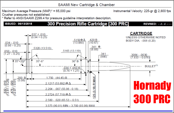

Having issues resizing 300 PRC once fired Hornady and ADG brass. Using Widden Gunworks FL bushing die. Below are the before and after measurements of the brass at the 0.20 area.
Hornady: New 0.527 Fired 0.532 Resized 0.5315
ADG: New 0.528 Fired 0.532 Resized 0.5315
The base end of the brass is not being sized enough. If I read the SAMMI info correctly for this cartridge, 0.532 is within specs. Would some of you please let me know the measurements your dies are sizing the brass too in this area.
The die is setup correctly and I'm bumping the shoulder .002 -.003. The barrel was spun up by a reputable smith and shoots very well.
Pic

Need a Little help.
What I don't get is the growth of the brass diameter after sizing, but regardless, the die isn't sizing it small enough. You may need to get Whidden to do a custom die for you.
I did that on my first 300 PRC barrel and it worked well. Now, my new barrel chamber is about 1.5 thou smaller and I need to get another custom done.

Thanks for the response, a tighter die would work as would enlarging the chamber but I don’t understand if everything is in spec why the problem. Not sure I understand what you mean about growth of the brass after sizing. New brass measures about 0.527, after it is fired the first time it measures about 0.532 then I resize it and only get about 0.0005 change to 0.5315. When I fire the brass for the second time it measures 0.532
hopefully someone will measure a fire piece of brass that has been resize for me
I measured a few
New Hornady .5293
Fired .5320-.5325
Sized .5315-.5320
I have reloaded some as much as 4 times with no chambering issues.
I have a couple once fired cases from somone else that measures .53365 sized. No matter how many times I try, my die wont size the base enough to make it chamber.
My theory is. Standard die will only size that portion of the case so much and since its harder brass than the neck spring back is greater.

I measured a few
New Hornady .5293
Fired .5320-.5325
Sized .5315-.5320
Thank you sir, exactly the info I was looking for. Our results are similar. After looking at the chamber and cartridge specs the best I can tell is that by design the cartridge/chamber can be very tight depending on the actual min and max tolerance values of each. So guessing it’s the luck of the draw if you have problems or not.
Got it on the resize - misread your original and thought you wrote the brass grew in diameter after resizing.
Heavy bolt lift can primarily be attributed to brass being too big going in or to over pressure. Even though you're slightly sizing down the case, and it goes in to the chamber easily, it still might be a large enough diameter that it causes a heavy bolt lift after firing.
When I was getting a friend into reloading with his 300 PRC, I used my old Hornady die for his initial loads of once-fire factory and had similar measurements to what you have. Every round had a slightly heavy bolt lift after firing. When I reloaded using my smaller diameter custom die, the problem went away.
I agree, thank you. I feel there is no doubt the heavy bolt lift is a result of limited space for the expansion/contraction cycle of the case. Doing some testing I’ve reduced these second firing loads by 2 grans from my summer loads and shooting in 30-40 degree cooler weather so the loads, still sticky bolt lift.
Common problem with ADG brass and Whidden sizer. This thread goes into it pretty in-depth. https://www.longrangehunting.com/threads/the-prc-die-problem.253223/page-12#post-2058785
I switched to a Redding FL sizer and was able to get the brass sized back to spec. Whidden blamed the problem on the ADG brass and were supposed to make me a custom die, that was almost 9 months ago. Needless to say I just requested a refund.
Thank you for the response and the link. Looks like this problem isn’t uncommon. I might just try to polish the first 3/4” of the chamber out a bit and see what happens. But the Redding FL die might be a better route, you mention that it resized the brass back to spec, could you give me what that measurement is.
Thanks, yep at the .200 line the SAMMI cartridge measurement is 0.532 and SAMMI chamber spec is 0533. Unfortunately for me the .001 isn’t working well and hoping that there might be a die out there that is sizing that area down a little more. codym mentioned back to spec and since most brass when new is .003 to .004 under the 0.532 at the 0.200 line and that possibly his Redding die was sizing down closer to that size as when new. I should have probably included the SAMMI drawing from the start, thanks for doing that.

Yes they fit in the chamber and accuracy is fine the problem is sticky bolt on ejection, some more then others and occasionally some force is needed to eject the fired case. You also end up getting false positive pressure signs on some of the cases and that being ejector smear.
Are you using a comparator before and after sizing? I assume so if you are measuring your bump. Are the cases growing back exactly the same amount each time?
i had the same issue with a whidden die and 7SAW
had to run the brass through a small base and then the new redding
wasnt sizing the web enough
my 2840 load was fine
on second load had to drop to 2800
third load i stopped and we figured out the issue
