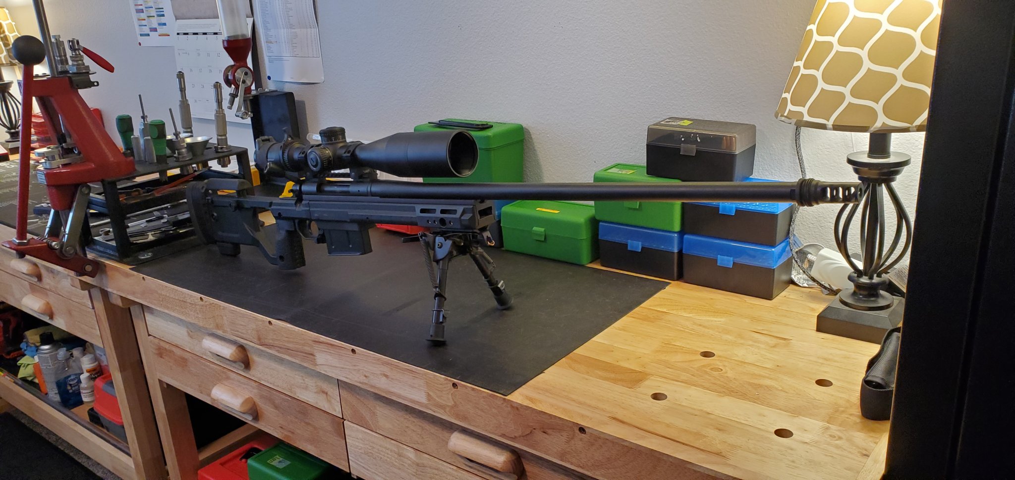

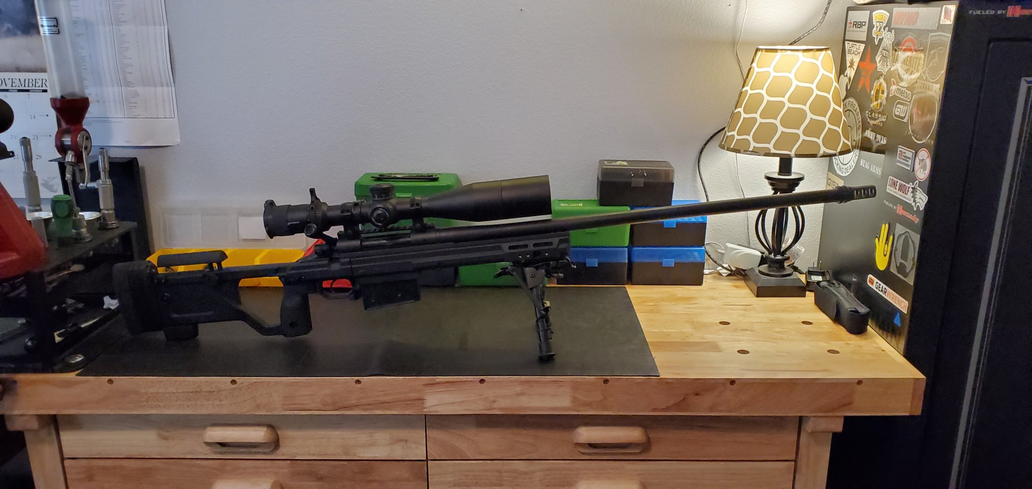

Shot my new barrel today. After over 1350 rounds I retired the old barrel. New barrel is a Bartlein 1-9tw at 29.5" Heavy Varmit....measures 0.968" at the muzzle shoulder. I installed a new Aaron Hipp ATS Barrel Tuner while I was at it.
Today was an absolutely beautiful day in N. KY with zero wind and 74F temps...sunny as can be. If anyone cares it was 51% humidty and a pressure of 30.11" falling. Elevation was 912ft ASL. 28 rounds fired at a distance of 100 yards.
After installing my new barrel it headspaced perfect. I used 6x ADG brass freshly annealed with a shoulder bumped back 2 thou from my previous barrel. 230gr A-Tips....only thing I have at the moment.... and 75.0 grains of RL-26. First shot was just a chamber a round and fire it into the dirt and then do a check of primer and brass. I ran a dry patch down the barrel to see how much carbon was on the first shot. RL-26 is dirty...but I like it.
Round 2 I installed the Magneto Speed and got a velocity of 2877 fps. I was also 2 mils high of my previous zero. I had taken the ZCO 5-27 off and reinstalled...but I think it had more to do with a +40fps muzzle velocity increase due to 1.5" more barrel....and the installation of the ATS Barrel Tuner. I spent a few rounds getting a semi-perfect zero and then I pulled the MagnetoSpeedV3 off. I was getting erratic readings and then I noticed that due to the ATS Barrel Tuner...I had the MagnetoSpeedV3 mounted too far rearward and it was giving me some false readings that were around 2830fps. I used a Labradar for the rest of the shots. It sped up a tiny bit and my last 10 shots had an average of 2887 fps with a SD of 1.9. Heh...I'll take that any day....on any rifle.
No pics for todays session because due to not actually charging my phone...it died once I was at the range. However, I did keep the target for study and will take a pic of it later.

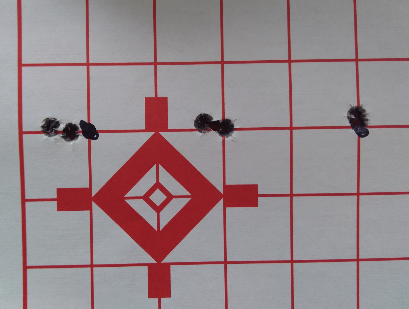

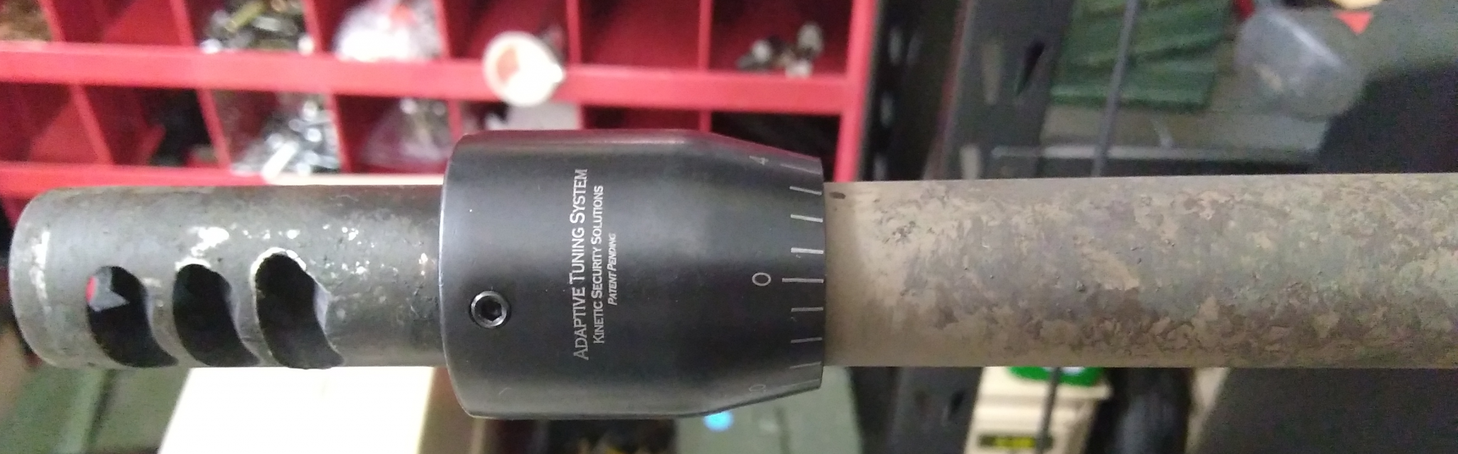

I decided to play with the barrel tuner. I shot a 5 shot control group with the ATS 'centered'...an arbitrary middle setting that I deemed at 'zero' and went up from there....I could have just as easily gone in the other direction and dialed down from center. Control group of 5 shots was 0.689" Not bad for shots 6-11 on this new barrel. Using the tuner I took a sharpie and made aiming dots on the square junctions on the typical diamond target. I shot two shots...if they didn't touch, I dialed two markings on the ATS Barrel Tuner.....shot two shots....repeat. On the third group I had two touching and sent a third shot and a 3 shot group measured less than 0.100". Moved the ATS two more clicks....shot a two shot group that was touching but moving away from what I measured on the previous group. I kept spinning the ATS and the group kept opening up and after group 6 it was back to about a 0.60" group.
I spun back down to the #4 setting on the ATS and shot a nice 0.312" group and decided to call it a day. I don't think I can rely on these ATS settings until the barrel speeds up a bit more....after it stabilizes at around 100 rounds through the barrel or so....I'll double check the ATS settings and play around a bit more.
Groups were great....exceeded expectations for a brand new barrel that hasn't 'broke in' yet...heh...hate that term. I ran a few dry patches through at the range..but I didn't run any wet patches through the barrel until I got home. First 5 wet patches of BoreTech Carbon Remover were pretty black....then almost white....the first 3 patches of BoreTech Copper Remover were just a hint of blue....not bad...I expected a dark purple on a freshly machined barrel. A brush for 30 strokes wet with the CU remover and a few more patches and all is clean.
Maybe over the weekend I can run up to Thunder Valley and dial it in at 1 mile + and get that first 100 rounds knocked out. Be nice to true my ballistics calc on this new barrel with data out to 2300+. Big thanks to Greg and Russ at SPR...they do awesome work....with awesome parts. One note....fired brass shoulder bumped out exactly 2 thou longer than the 2 thou bump back from the previous load....so chambers are identical.

I've been shooting ny 300WM and absolutely love it. Been shooting 220gr ELDX with 75.6gr of H1000 at 2858fps out of a 26" 9 twist bartlein. I love this barrel.. it has 980 rounds down the tube and I've only measured 0.027" throat erosion. ts been shooting 1/2moa consistently on paper out to 500 yards and banging steel out to 1040 yards. Going to take it out to 1500 today and see how she likes this cold Wyoming weather. I dropped it into my X-ray that I bought for my 300PRC build to see how much I like it.
Now to relate to this awesome thread. Ive been slowly purchasing parts for my 300PRC build. I've got an ARC archimedes action, triggertech special, KRG X-ray chassis, CIP magazines. Ive been going back and forth on barrel length and manufacturers. After verification of my throat erosion on my win mag I am definitely going to have another bartlein spun up. Now to length..26" or 28"? Any help either way would be greatly appreciated. Only thing that sucks is im going to have to wait on the barrel purchase until after Christmas...bummer.
My 300WM in the KRG. I like it.
Reactions: b2lee
Barrel length is up to you on your preferences. I just went from 28" to 29.5" on my new barrel. However, I do most of my 300PRC shooting at 1760+ yards...Weight is of no concern to me....don't know if it is for you.
However....You may find that with the extra length on the barrel you may need to switch from H1000 to a slower burning powder like RL-26 or VV N565. Sometimes you will find that your powder burn is 100% well before the bullet gets anywhere near the muzzle.
View attachment 7468819View attachment 7468820
Beautiful rifle! I was so close to getting the KRG chassis but ended up with the MPA.

When adjusting the tuner to tighten the groups up, how much of an adjustment from the left group to the right group?
Thanks
