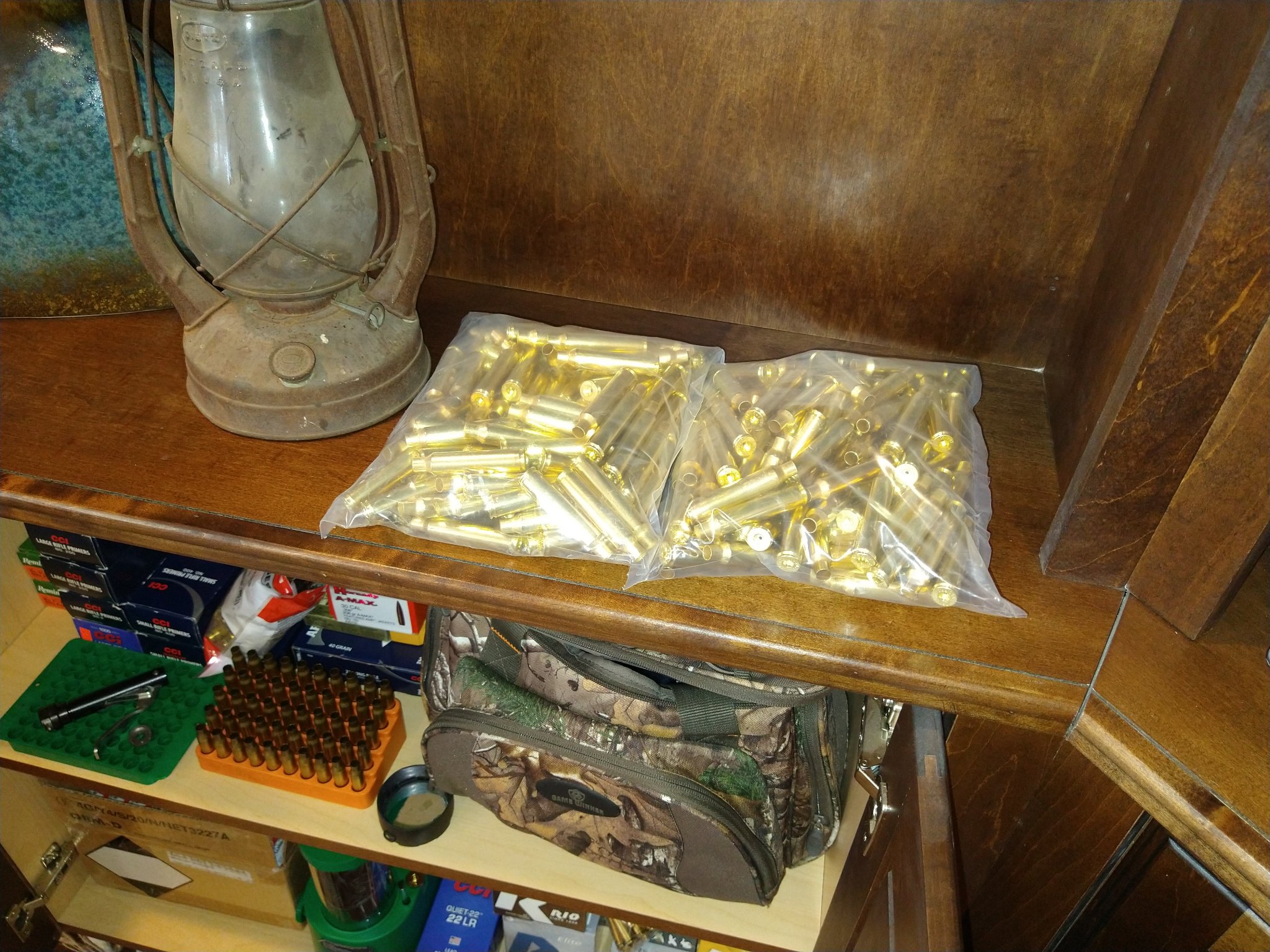

Ok...so in reference to my on going sub thread of converting 375 Ruger Brass to 300PRC Brass....I decided I wanted to finish out the reloading process and see how this stuff loads after the initial fire form. So, I got bored and decided to seat some primers. Everything went in very consistent and with a nice bit of force. Primer pockets after ONE firing are good to go. Dropped 49 rounds of powder with the ATV3 at 75.0gr of RL-26 and then took the tray to the K&M Arbor Press using the Sinclair/LE Wilson Arbor Press Micrometer Bullet Seater. The first time around, bullets went in rough. Most were tough to seat...even after my normal neck mandrel...some took 80 inch pounds of force to drive in. With the short throw arm of the K&M....it seemingly feels like you have to stand on your head.
So, after a full run through my normal reloading process....I seated 49 bullets.....only 1 of them could I tell a difference in seating force. They all were seated with about 20 inch pounds of force and they were all 'butter'...just smooth...no grittiness no popping from going through a smooth section and then grabbing in a donut.....none of that. These were seated at magazine (CIP) length....so the boat tail is passed the neck/shoulder junction. This is where you expect to get a pop when hitting a donut. I felt none of that.

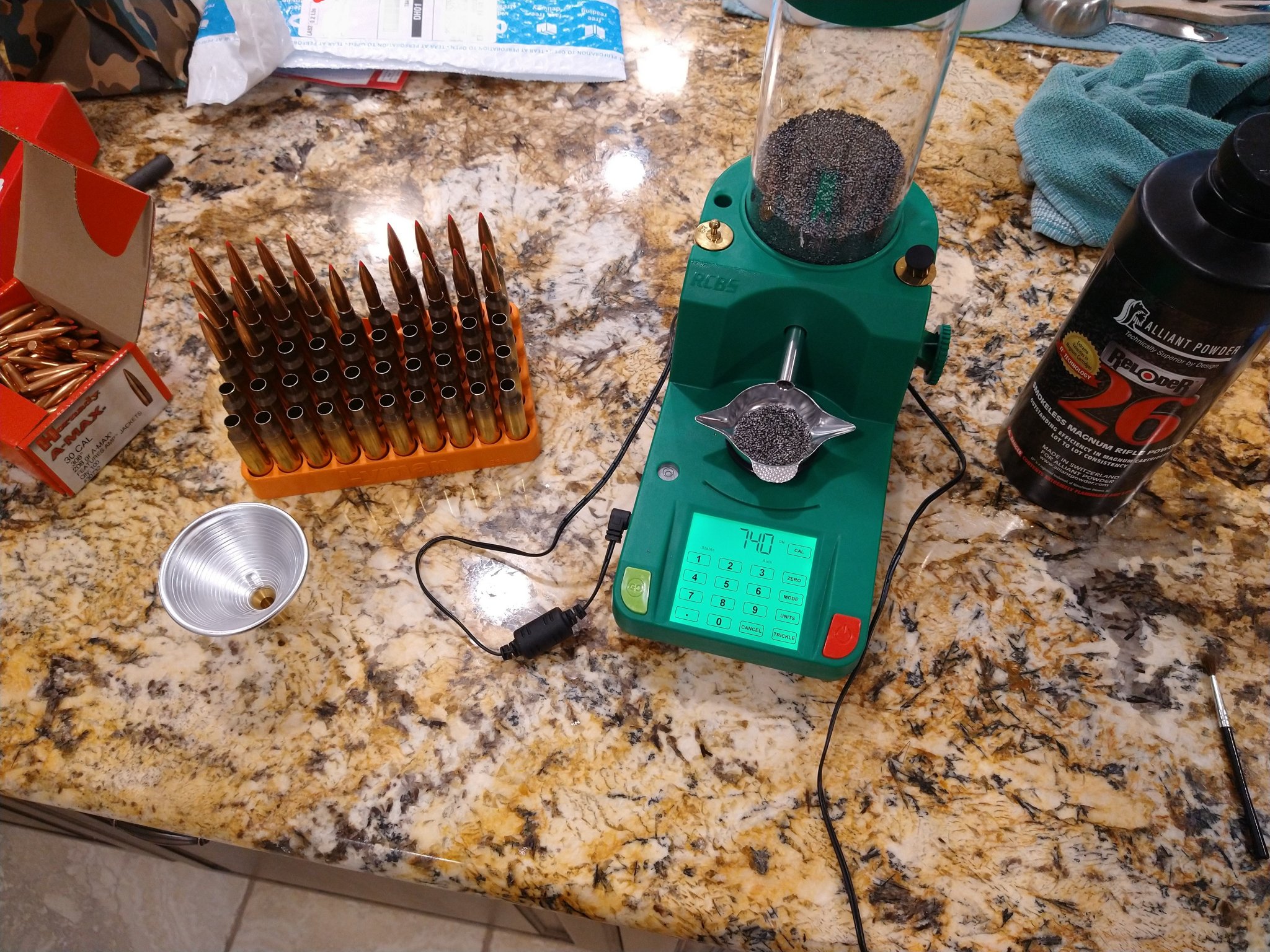

I have been looking for a new powder measure for a while now. Will be putting the Chargemaster on the PX soon. The Chargemaster has been good, but just looking for the next level of accuracy and speed to reduce reloading time.

Picked up two of these. Thanks for the tip this should keep me learning and shooting for a while.
