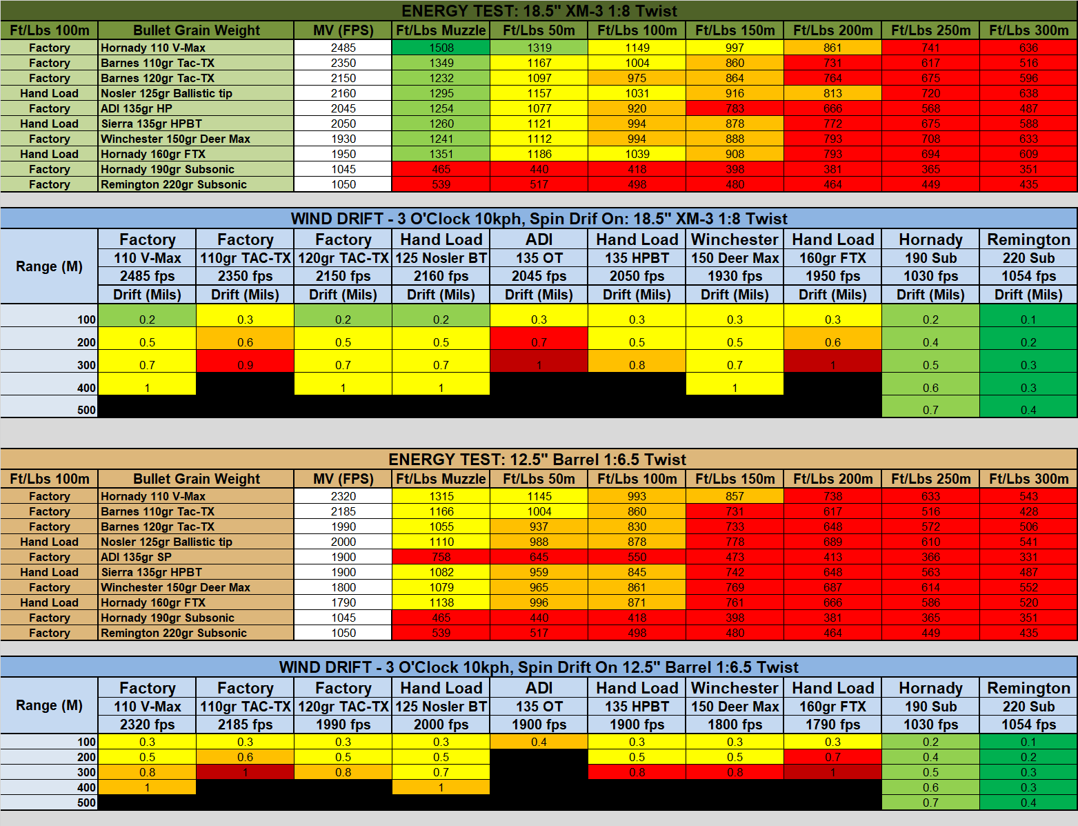

    Dunno how useful this will be to you but we did testing in the 300blk. This is our 12.5" barrel results.
    There's no accuracy results here but this is the energy.
    Accuracy wise, the hand loaded nosler 125gr was the best, but the 110gr V-Max was awesome as well for the light and the Winchester Deer Max ammo was really good close range too for that middle weight.
    The Remington Factory 220gr was all over the place FPS wise. ES was massive but impacts on plate were 10/10 at 200m on a 20cm plate. We had it out to 300 and 500m as well, but i'd be lying if I listed impacts for those ranges. Wasn't as bad as you'd expect.
    The shorter barrels were done for comparison sake but the 18.5" gun is the bomb with 300blk ammo. We are able to hit targets at 1000y with the 125gr Nosler ammo.
    our 18.5" is a remington 700. Platform wise, i can't really help there sorry.
