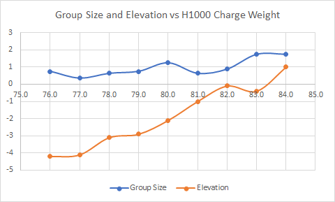

I got a custom built 300PRC +P from Defensive Edge and am trying to work up the best load for it. The +P indicates a tapered entry into the rifling which reduces pressure and allows more powder and a bit more velocity than standard: https://defensiveedge.net/300-prc-p/ for more info. The =P certainly seems to allow for significantly higher powder charges, so these loads would liely not be suitable for a standard chamber.
I used H1000 and Berger 215gr Hunting Bullets with Hornady factory load brass that my son and I had fun emptying at the range a couple weeks ago.
My first loads were at the same OAL as the Hornady factory loads which I believe now were touching the lands, and chambering the round probably seated the bullet a bit further. I started at 76gr H1000 and worked my way up to 84gr where I could see faint marks on the brass if I held it up to the light right, and the primers were getting a bit more cratered, i.e. a slight ridge around the firing pin impact, but not flattening.

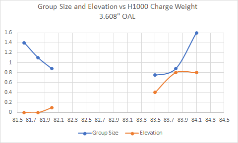

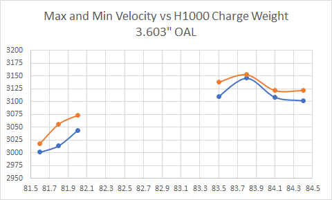

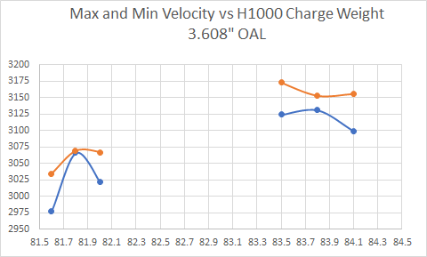

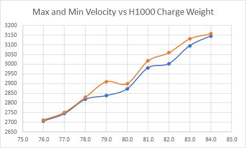

Max and min velocities vs charge weight shown below:

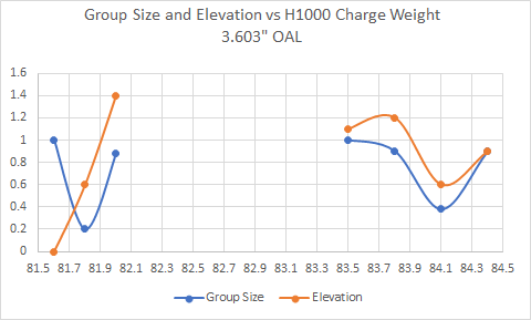

100 yard 3 shot Group size and elevation above or below aim point shown below:
I decided to try and further refine things by trying two different seating depths between 81 and 82gr (minimal change in velocity and > 3000fps) and 83.5 and 84.1gr (3100fps+ and still relatively small dependence of velocity on powder charge). OAL touching the lands is 3.618" as near as I can tell using a modified case and Lock-And-Load tool. I am not very confident in the accuracy of this measurement as I could not get very consistent results, at least at the level of precision we're talking about here.
Results were as follows:
I was originally thinking that 84.1gr and OAL of 3.603" was going to be my load. But after graphing everything out, that same load just .005" longer quadrupled the group size and ES of velocity. Is this sort of sensitivity to seating depth normal? I was hoping to find at least some consistency in trends of powder charge variations between the different OALs, but I don't really see any.

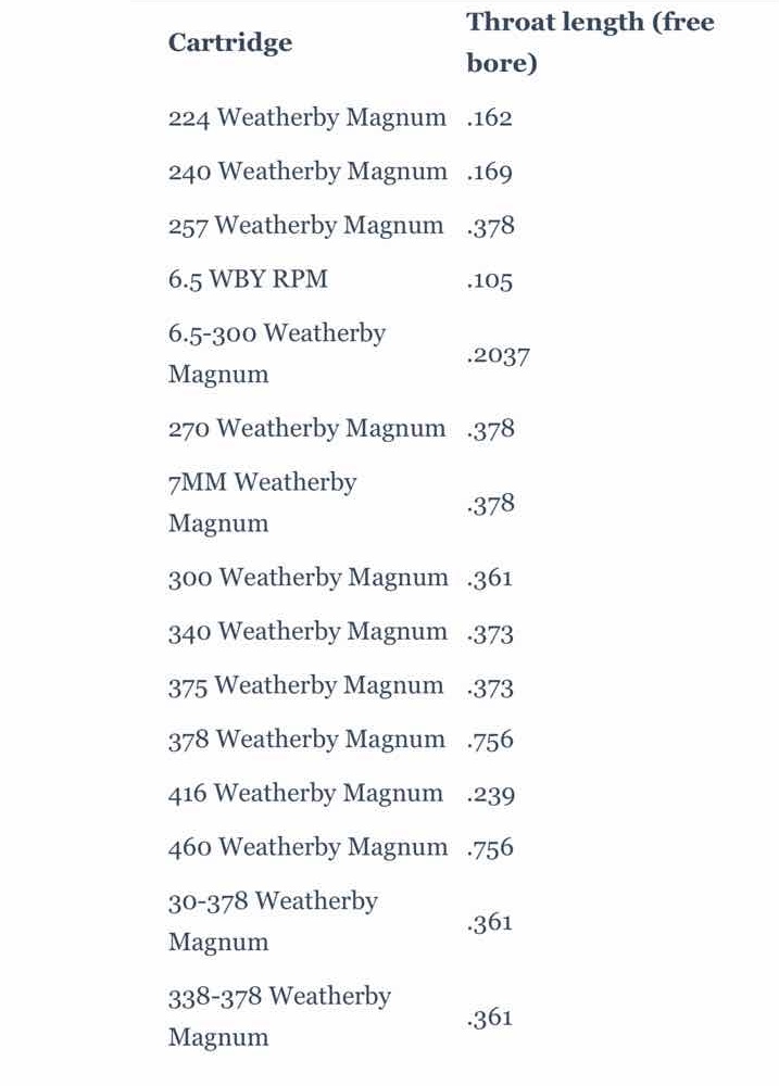

Also, regarding your throat geometry and pressure... Are the claims of higher velocity with 6 grains more powder than published load data with a SAAMI chamber at safe pressure substantiated with any test equipment?

I believe Weatherby throated rifles in sort of the same fashion to run more pressure. I would personally just get a bigger round, I don't think you are only making 63KPSI to make 3150FPS, when with standard throating 63KPSI should be around 2870. The 300PRC doesn't have a lot of bullet in the case to begin at SAMI OAL. I just don't see making room for another 7g powder and 200FPS by throating it longer. By running overpressure, sure. But the difference in performance inst worth the squeeze.
I’d like to see the print/drawing of the chamber reamer that was used to chamber the barrel with.

Wasn't Weatherby the first to experiment w + P throats? To my understanding its a long free bore w a swallower leade angle.
It's never been referred to a +P throat or loads for WBY. Keep in mind those typically have a really long throat. As an example if I recall correctly on the 375WBY the bullets jumped .375" before they hit the rifling. Yes this long jump helps the pressure in my opinion but if so...it doesn't help when a shooter runs a heavier powder charge and seats the bullet out further to have the case capacity but he's running the bullet close to our touching the lands/rifling. Your not gaining anything in my opinion.
Guys do this with the 300WM. They think because you cut the throat longer so they can seat the bullet out further that it means they can run a heavier powder charge. It doesn't work that way.
Also if you do jump the bullet a lot...accuracy usually will suffer. You don't get your cake and eat it too as the saying goes.
They certainly had a good amount of freebore
I did something similar, ran a longer freebore in my 260 to get all that the 2.96 magazine and a bit of jump woul get me back when I was shooting it way out there a lot.
With roomy brass it did get me a bit extra speed.
Certainly not a game changer.
Reactions: Frank Green and BCX

I appreciate all of the responses and wish I had had time to respond sooner.
It seems to me the situation boils down to this: I have a 300PRC with a modified chamber theoretically allowing increased powder charges and velocity due to the throat geometry. This may be real. It may just be marketing hype. I can't get any actual test data to back up the claims, and the only load data published relied on qualitative pressure signs such as bolt lift to indicate excessive pressure rather than actual pressure measurements.
Max load data are readily available for standard chambers. However, I'm sure there are rifles out there with out of spec or tolerance chambers for which these max loads are beyond safe. For that reason, it is highly recommended to start with lower charges and work up towards or possibly to that max load but stop if signs of excessive pressure are seen. For example, if I had a 30-06 that showed flattened primers, ejector marks, etc. at 60gr of H4350 and 150gr bullets, I couldn't safely go to 61.5gr even though that were still under the "Max Load" weight. How much different is working toward the max for a +P chamber than that scenario?
It sounds like I have two options: One- Ignore the +P chambering and stay at published max limits for the 300PRC or Two, work my way above those loads as long as I know I'm not exceeding safe pressures. Obviously Option One is the safer route, but if I can safely take advantage of the +P chamber and get a significant performance boost, I'd like to do that.
To do that, I need a reliable indicator that I'm approaching safe pressure limits. Flattened primers are somewhat subjective to begin with and can be caused by pressures within safe limits. Ejector marks seem a bit more reliable but not enough to go by on their own. Bolt lift, for me anyhow, is right out as it's somewhat "stiff" already and enough pressure to cause a noticeable difference in this rifle would be cause for serious concern.
What about case head expansion (CHE)? I used our CNC machine to cut several holes in plexiglass, each one theoretically .0001" bigger than the last. I'm measuring each loaded case before and after firing using the series of holes as a Go-No Go gage. Almost all of my cases have about .0001" CHE judging by this method, including factory ammo. In testing some loads recently with RL26, I got the typical .0001" CHE up to and slightly over theoretical max load as well as no signs of an ejector mark. However, a very faint ejector mark was present at the same load as the CHE jumped from .0001" to .0005".
I know CHE isn't typically used as a pressure indicator as there are so many variables, but is this method giving me any relevant data? Is there anything else I can use to indicate pressure reliably enough for what I'm trying to do?

The modifications to the throat are a bit involved. Essentially, it's a two step reduction to bore diameter that reduces the initial pressure spike and better aligns the bullet with the bore. The patent describes it in more detail of course: https://patft.uspto.gov/netacgi/nph-Parser?Sect1=PTO2&Sect2=HITOFF&p=1&u=/netahtml/PTO/search-bool.html&r=1&f=G&l=50&co1=AND&d=PTXT&s1=Shawn&s2=Carlock&OS=Shawn+AND+Carlock&RS=Shawn+AND+Carlock
It sure sounds good in theory, I'm just trying to figure how to test it for real.
