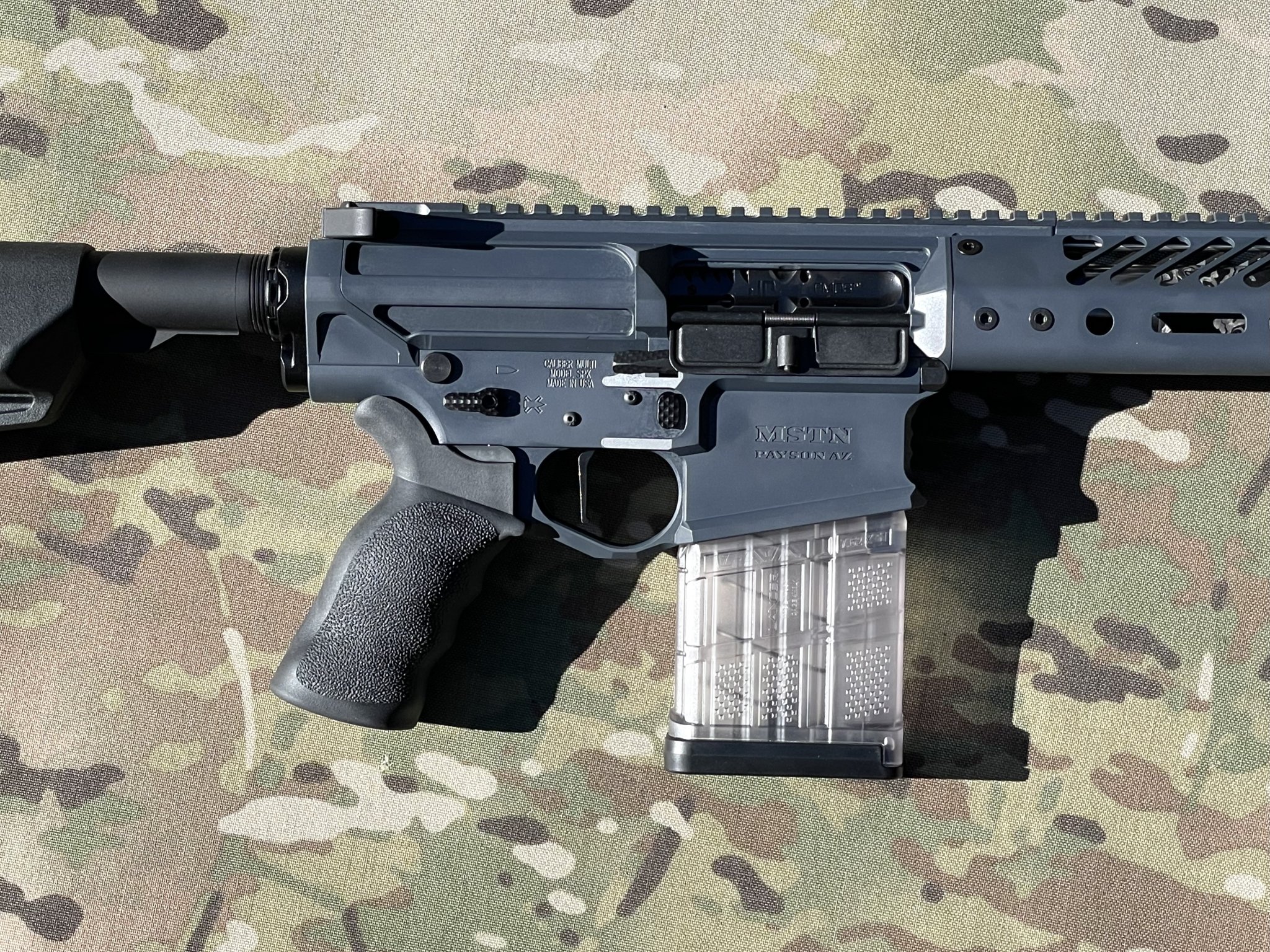

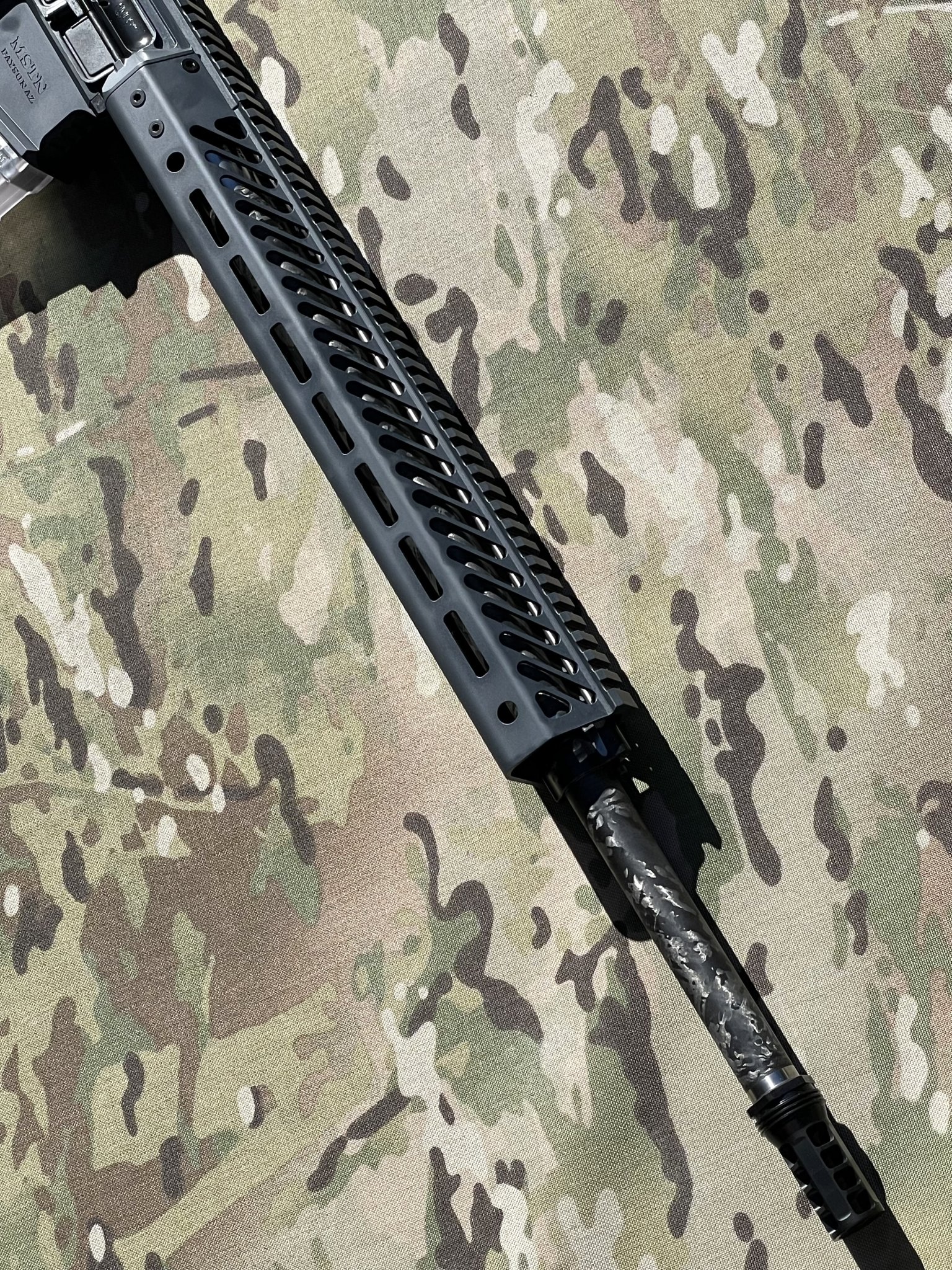

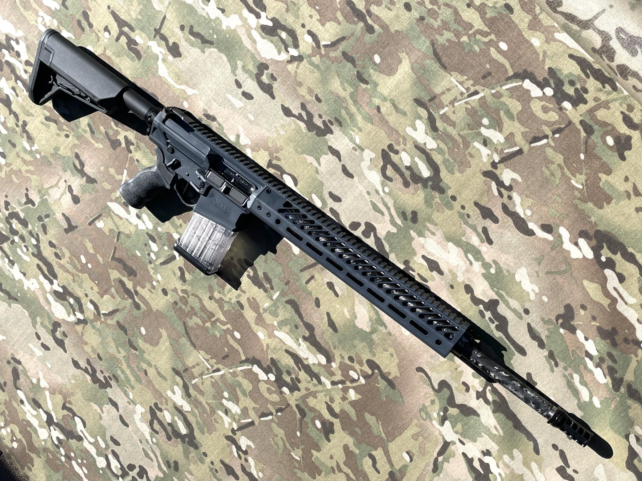

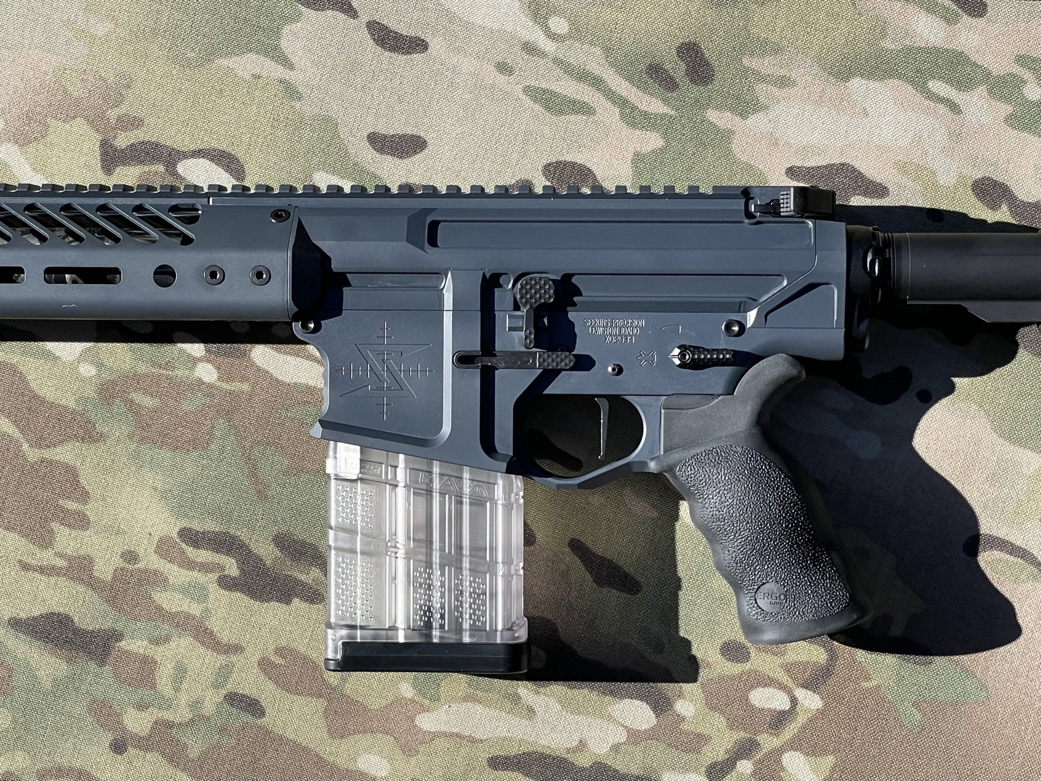

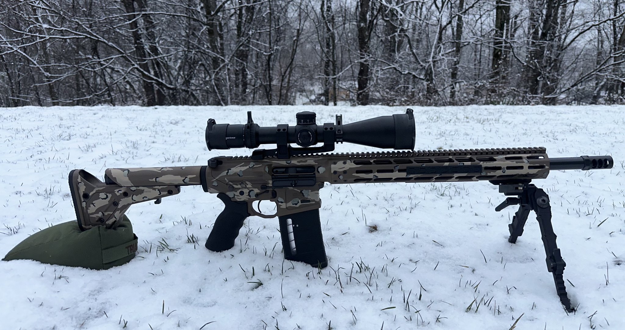

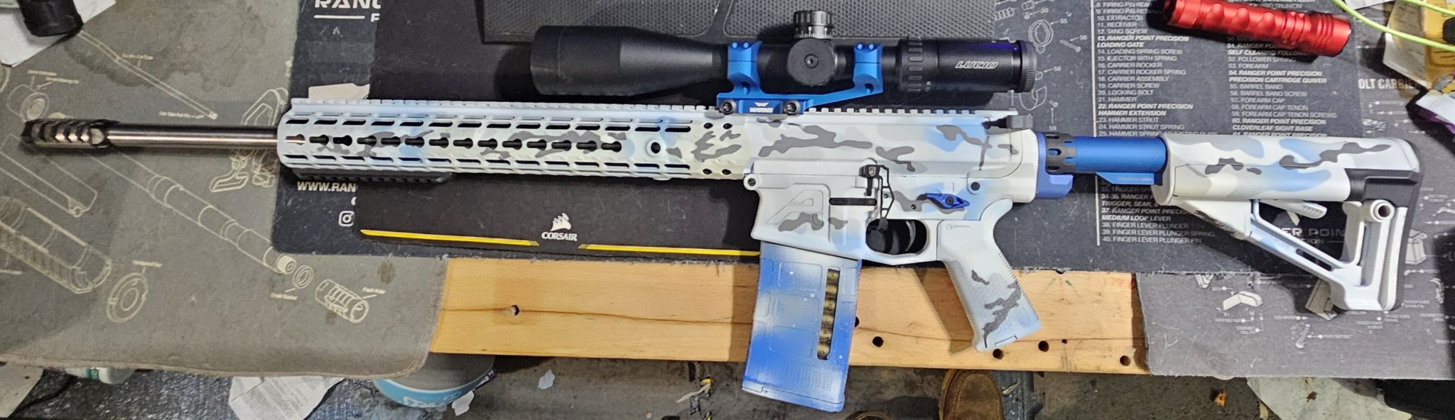

Another very successful build based on the superb Seekins SP10 Builder's Kit, Proof 6.5CM 22" carbon fiber barrel, TriggerTech Diamond Trigger, and JP FMOS Bolt Carrier Group. Right at 9 LB empty. Who needs a 13 LB bolt gun???
Placeholder for the completed build and range report, but here is a teaser pic. The barrel will be coated black this week. Chocolate Chip Cookie Camo Cerakote. Build list:
Mega Arms MML billet receiver set
X-Caliber 20 inch bull barrel .936 gb (6.5 Creedmoor)
Trigger Tech AR-10 Duty 3.5lb single stage trigger
Vortex Precision Cantilever Scope Mount
Vortex Strike Eagle 5-25x56 mrad
SLR Sentry 9 adjustable gas block
APA Little Bastard nitride muzzle brake
Brownells 308 nitride bcg
Accu-Tac Picatinny bipod
Replying to myself with an updated pic. All done and ready to sling some lead.

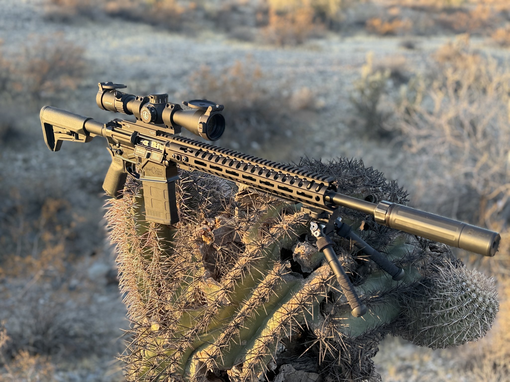

New to the site, appreciate the membership and the wealth of knowledge. Retired Marine, live in Northern VA, and frequent the ranges at Quantico. Built three LR rifles - .243 Win, .308 Win, and 45 Raptor. All use Aero Precision receivers and handguards, Geissele triggers, and Magpul furniture.
LR243:
-AP M5E upper and lower receivers
-X-Caliber 24" chromoly barrel, .243 Win, 8:1 twist, AR-10 HBAR profile, rear fluting, .0935" gas port, rifle-length gas tube
-AP BCG
-SLR Rifleworks .750" steel adjustable gas block
-Rifle length buffer with tungsten weights (8.85 oz)
-Mil-spec charging handle with Badger Ordnance Tactical Latch installed
-AR-Stoner Precision (3-port) muzzle brake, 5/8-24 thread
-Geissele SSA-E trigger
-Timney 45/90 ambidextrous safety
-15" AP M5E Gen 2 M-Lok handguard
-Magpul PRS 308 Gen 2 stock, MOE grip
-Vortex PST 6-24X scope (MOA), Nightforce 20 MOA base/rings
LR308:
-Ballistic Advantage 18" chromoly barrel, .308 Win, 10:1 twist, low profile gas block, rifle-length gas tube, birdcage muzzle compensator
-AP BCG
-Carbine length buffer (3.80 oz) (intend to swap to heavier buffer)
-Geissele SSA trigger
-Mil-spec safety
-12" AP M5E Gen 2 M-Lok handguard
-Magpul UBR Gen 2 stock, MOE grip
-Nikon P-308 4-16X scope, Nightforce Ultralight rings
-Magpul MBus Pro Offset steel sights
LR45:
-AP M5 upper and lower receivers
-X-Caliber 16" stainless barrel, .45 Raptor, AR-10 Heavy profile, 20:1 twist, .0935" gas port, mid-length gas tube, thread protector
-Brownells LR308 Nitride BCG
-Mil-spec charging handle with gun show tactical latch installed
-SLR Rifleworks .875" titanium adjustable gas block
-Geissele G2S trigger
-Magpul MOE Carbine stock, MOE grip
-Vortex SPARC II red dot sight
Thank you for posting the deets on these, and thank you for your service. 🫡

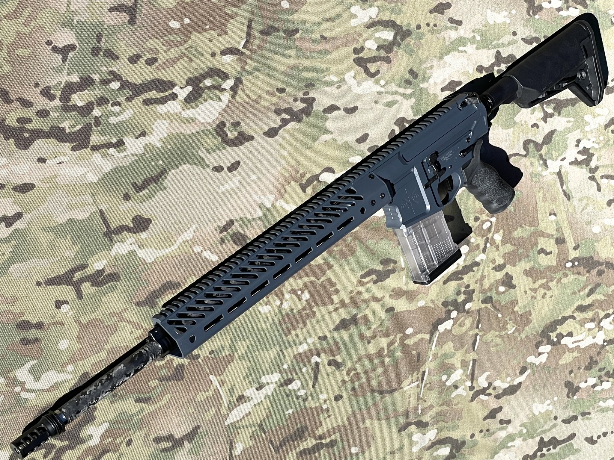

I've since sold the 45 Raptor barrel and assembled another .308 Win rifle to replace it. This one is very similar to my .243 Win with a 24" X-caliber barrel but with a rifle+2 gas system and Magpul UBR stock.

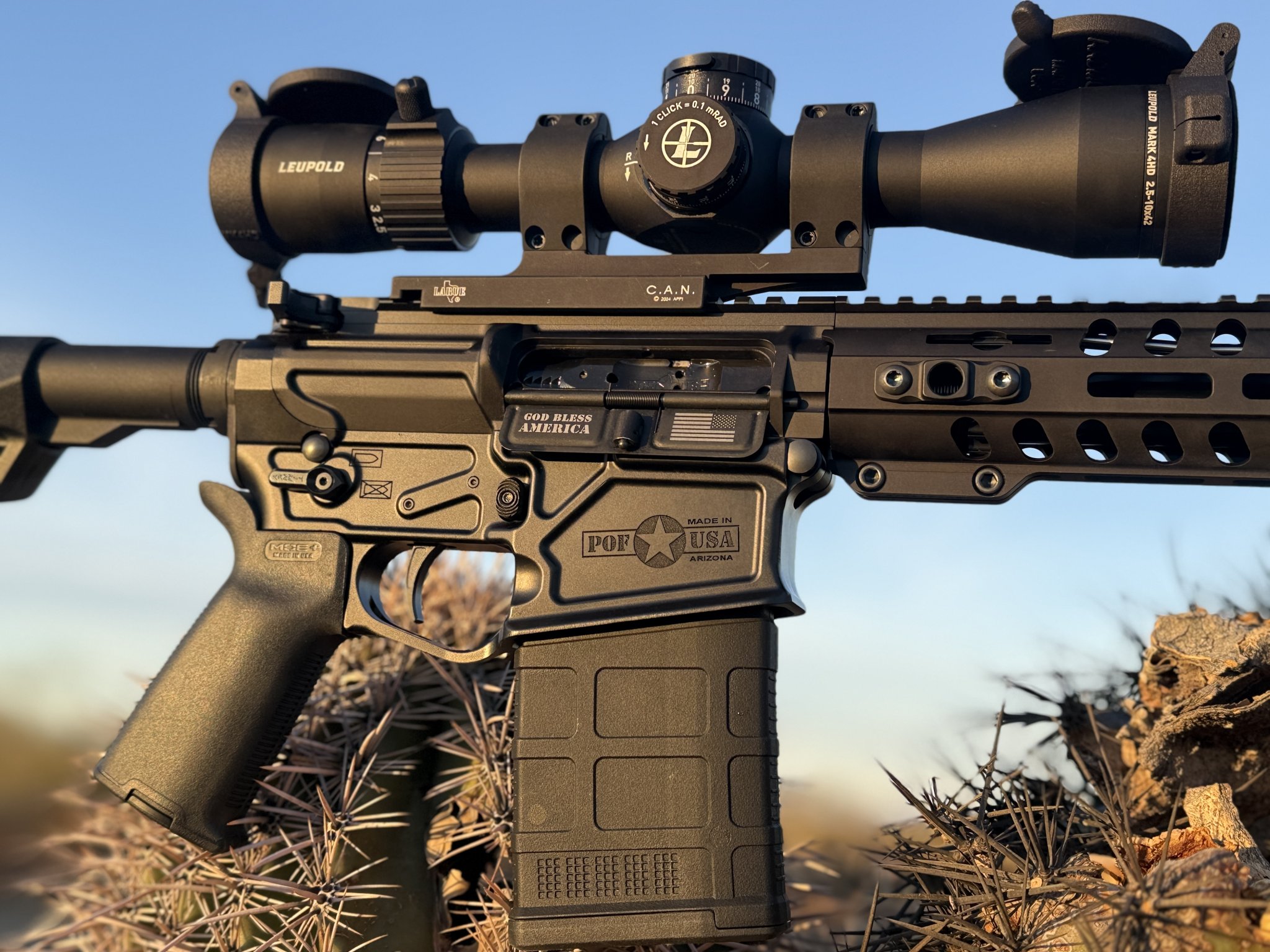

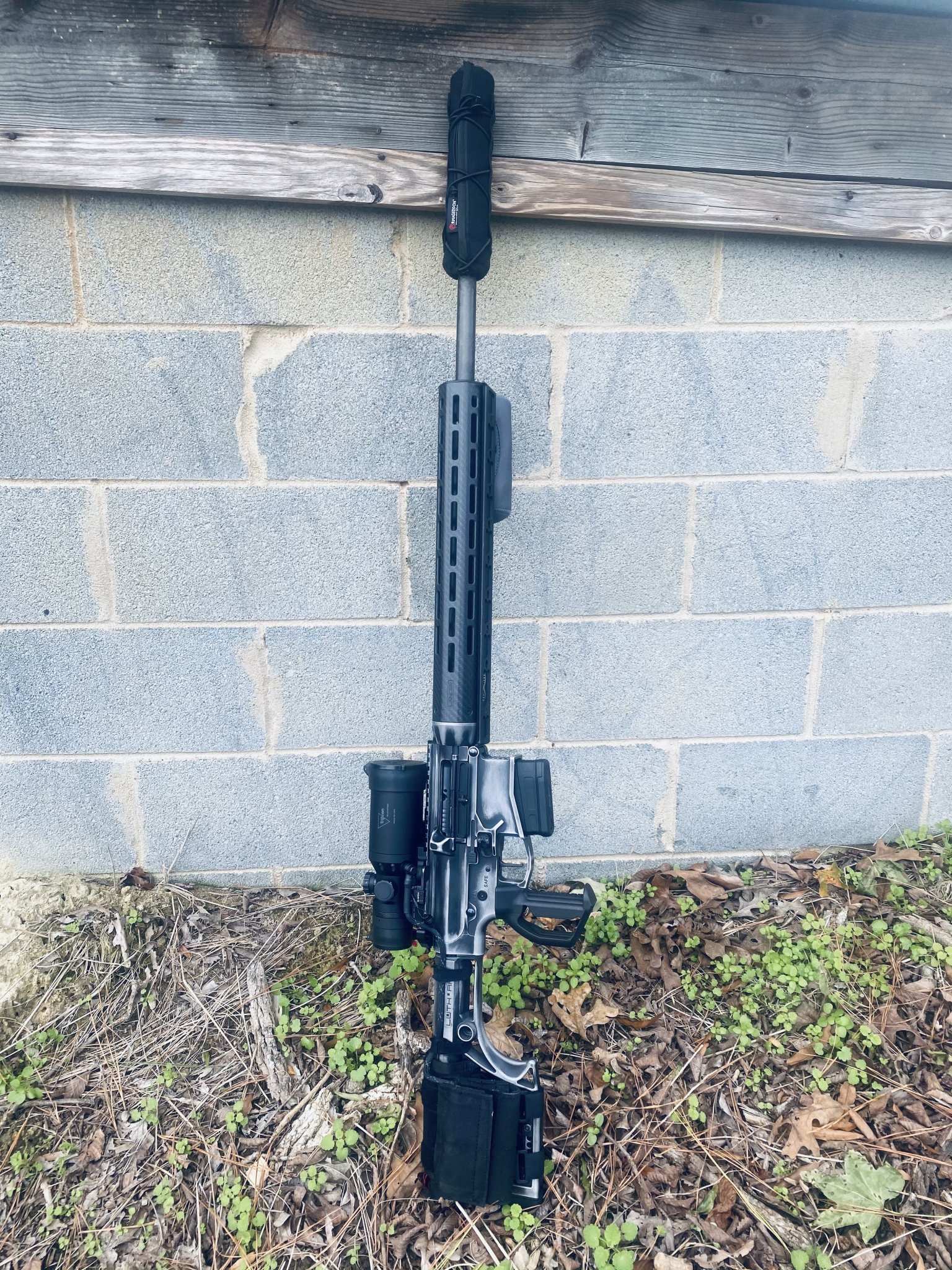

it's not. it's a 0moa.
He’s saying your mount should be flipped so that the “long arm” of the mount is toward the front, not the back as it is now.
Can’t remember if these Mega uppers are one piece or not. Obviously the idea of an offset (long arm) mount is to avoid spanning the upper/handguard junction.
Can’t remember if these Mega uppers are one piece or not. Obviously the idea of an offset (long arm) mount is to avoid spanning the upper and hand guard junction.
it just fits/mounts the way i need it to be for eye relief and chargehandle room. in most cases it's usually mounted opposite. being a south paw it works better for me. whether it uses nuts or latches it goes on trigger finger side.
Reactions: mrtoyz

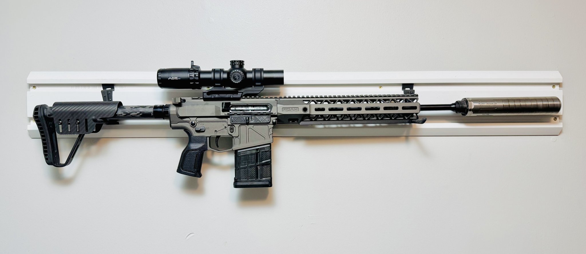

How’s it shoot?
Just OK so far. Started with Igmann 147's and tried Norma 168's.
Had a few FTF's and quite a few FTE's. I assume because of the can. Even tried a few different buffers.
Bolt doesn't go home with authority like it should. Had odd wear marks at 2 spots in the upper receiver. Will keep messing with it.
Accuracy is unknown. It's a bit harder to shoot a lightweight semi auto accurately and I was getting tired and sloppily shooting towards the end.
Reactions: Top O' Texas

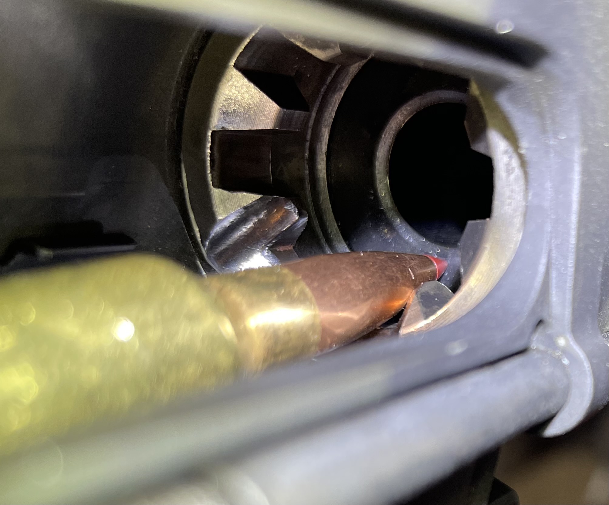

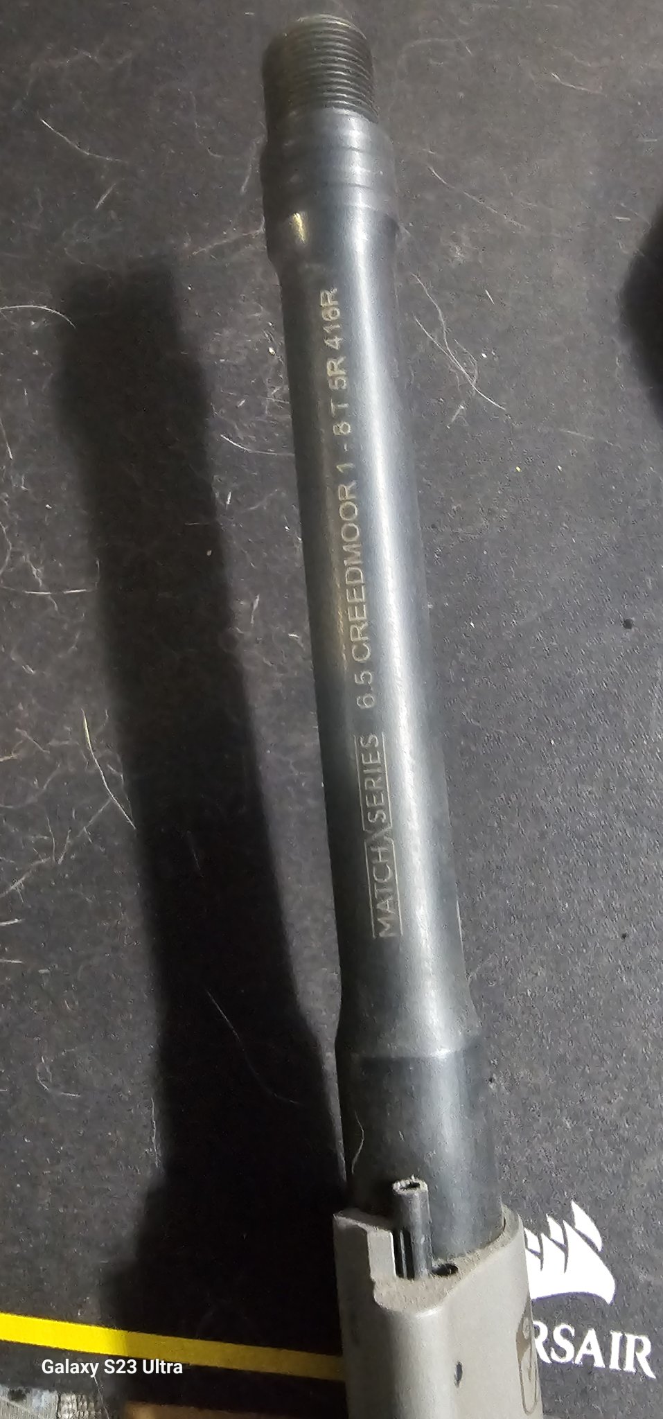

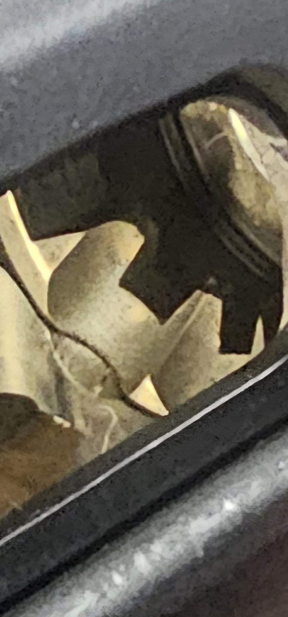

Anybody got a Faxon Match Series Barrel LR-308 6.5 Creedmoor? If so can you post a pic of your barrel face/chamber? I just got one and it will not feed anything. It just jams the bullet into the face of the barrel and drives the bullet deeper into the case. (See pic) I have 3 other 6.5cm barrels and they all have a chamfered chamber to aid in feeding the round. This Faxon barrel does not and I’m just wondering if that is by design or if mine is defective.
Thanks in advance.

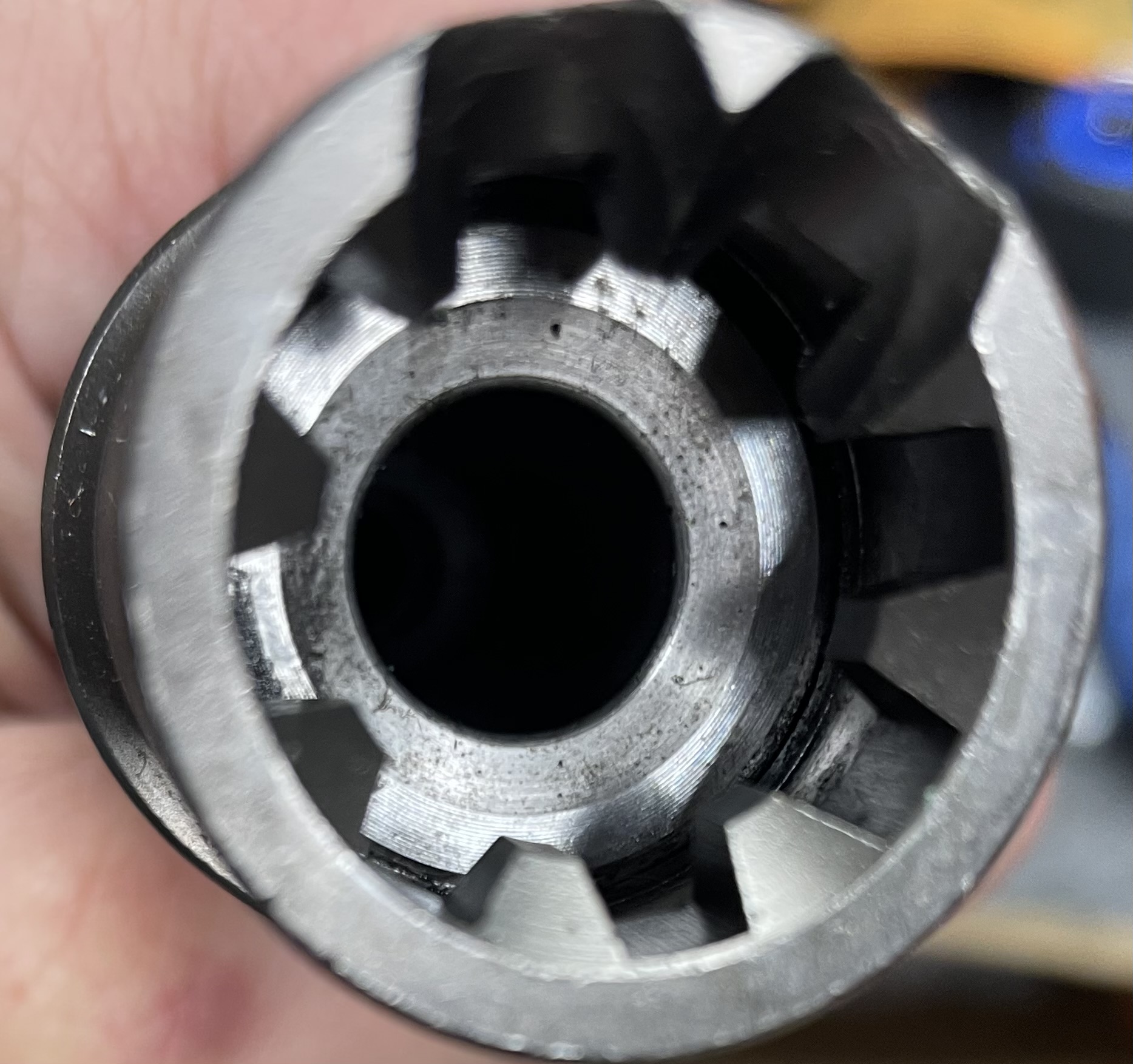

I have a Faxon 6.5CM, fluted match 24", but I had that problem only with certain ammo, probably an ogive thing. Unfortunately, it was the ammo I had the most of. eventually removed the barrel, got one of those rubberized (cratex?) abrasive cones, and tried my best to improve the lower part of the bevel at the entrance to the chamber, not too much, and polished afterwards. Also, took one of my metal mags and tweaked the mag feed lips a little so that the cartridge would have a better angle up the feed ramp to get to the feed cone, instead of the barrel face. So I ended up with a dedicated metal mag that worked reliably with that ammo.
Then I assembled another upper with a different brand barrel, no problems. So I don't shoot the Faxon anymore. But I did get it to where it works.
I'm half-tempted to remove the barrel extension so I can get better access to improve the feed cone, but, meh, got better things to do, and then you have to futz with the timing and clocking, gas port, headspace, shims, when you reassemble, probably not worth it.
Pics below are before the cratex rework. Pics below were the initial assembly. But they show the stock Faxon 6.5CM feed cone. Probably same as yours.
looks like the left lug near the feedramp is chipped? what ammo are you using, mags and receivers? more firearm info awaiting
Ammo: Hornady 140s ELDM, HPBT and 143 ELDM, 147 ELDX; S&B 140 HPBT & SP; Berger Hybrid, Federal 140 HPBT and couple other I can’t recall.
Mags: Magpul 5 & 10 rnd, CMMG metal, AR stoner metal, Amend2 poly & a couple other metal mags that I can’t remember brand.
Aero upper/lower receiver set, JP BCG and HP firing pin, JP silent capture spring, SA adjustable bleed-off gas block.
I have 2 other AR-10 rifles in 308 and have interchanged parts (BCG, buffer springs, bolts, mags, everything I can think of that could have an effect in this. No joy. My wilson combat 6.5cm barrel runs anything I throw at it and the only difference I can visually see is the Wilson Combat has more chamfer at the chamber mouth but it is heavy and I wanted a lighter barrel.
IDK. It’s going back to Faxon. I also have had good experiences with Faxon. This is why I posed the question here to see if anyone else has had this problem.
I did consider swapping the WC barrel extension with the Faxon but pretty sure if I did that they wouldn’t take it back. Plus I’ve never tried to remove the pin from an AR barrel extension either. Probably bugger that up pretty good on the first go around if I tried.
An issue you'll have when changing the extension is headspace with gas port at 12. Might get lucky on that? I use some of the same you do, but have only used factory Hornady 123a-max match ans 123sst..
At what direction is the brass ejecting? I state this as it'll let me know if the bcg is dragging or gas block is out if alignment/not centered above port. I'm trying to keep up with this thread and another person in another forum with the same cartridge (different barrel brand). What's the gas length?
Ejecting about 3 o’clock. Rifle length.
Everything seems to be running smooth with no abnormal signs other than it won’t feed. It won’t feed from a mag on initial load not just after firing and ejection. It only functions as a single feed.
  • Sad
It's a faxon issue then. ALL AR's should feed, but shooting/accuracy is another issue. Not ALL extensions are made for the same platform that use different cartridges just like feed ramps in a bolt gun (rum and wm are different). The Faxon is have is well overgassed as an agb barely chokes it enough to cycle correctly.
Send it back
so that kinda soured me on Faxon for 6.5CM. But their 308 barrels for me run like a sewing machine, all ammo, all mag types, several barrels (7 of them in 308). Just their large-frame 6.5CM barrels ... loss of confidence.
The only factory ammo my faxon heavy match 308 doesn’t like is the hornady stuff. It loves the federal stuff. Is really unfortunate because I was really interested in the 168 ELDM load.
Thanks in advance.
Same problem I had.... Faxon is stupid and they dont understand how things work.
I went back and fourth w/ Faxon , they sent me 3 different barrels because machining was so bad, finally got a decent one, and then noticed your same problem... the things are junk and wont work. I asked Faxon about it and they acted like a 5 year old, dumb and clueless then ghosted me. The whole no taper on the breach made the bullet tips ram into it and stop. I made a video on it. Thankfully even though several months later the place I got it agreed w/ me and exchanged it or a different brand. I didnt use that one, but got a Blackhole Weaponry barrel and all problems solved and works flawlessly.
