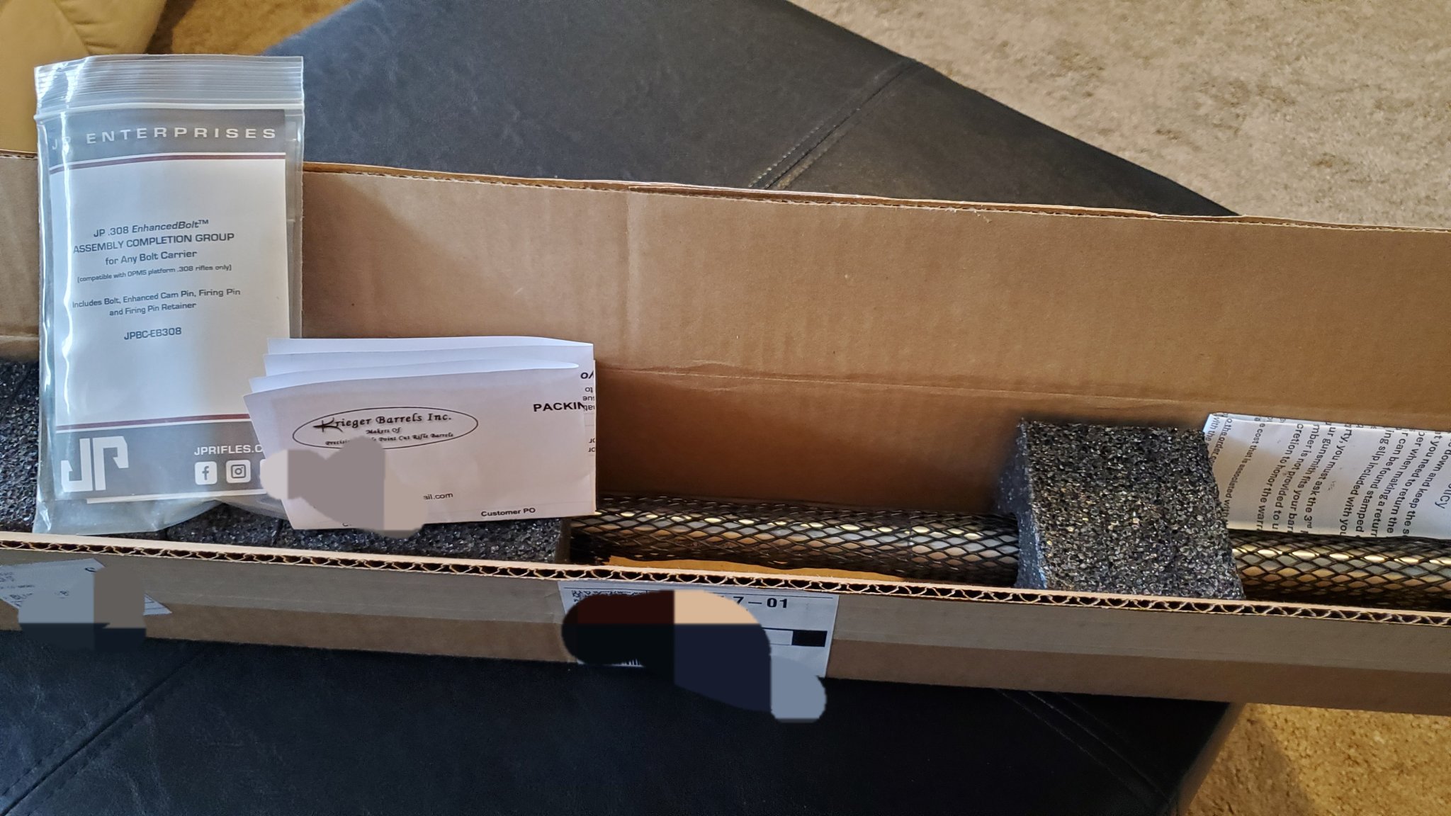

My Faxon 308 barrel was a nightmare from the get go, besides the shotty finishing, the gas port was too small, and in the wrong location also... the gas tube was a bit short so I got the Wilson longer one and then it was too long. Still didnt eject so drilled the gas hole out. Finally got ejection dialed in and then started to address the fail to feed which i thought was a magazine issue, tried different ones no change, then polished the ramps, no change.... I got a bullet from a gun store (I dont have reloading stuff) and glued it in a spent shell and got real close inspecting its operation manually by pushing the dummy round in with a pencil so I could watch and sure enough.... no taper on the breach.
My problems and emails to them were in may and june...... the chat on the webpage would get through..... then nothing.... Till November when this guy finally replied... I had long past returned it and already gotten another one, and it was NOT a magazine issue.
This is their reply when asking about the tapered feed. Reply came a month after i posted that video and had even sent them the link.

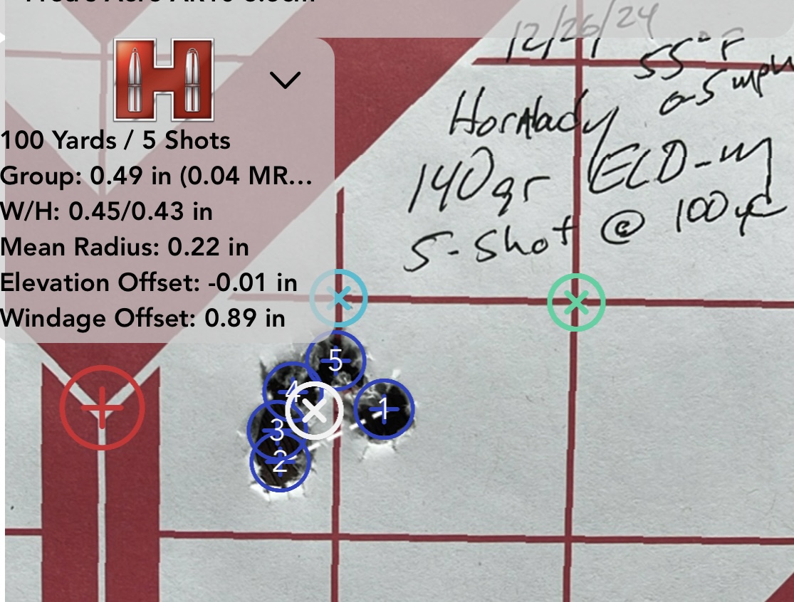

I’m a tinkerer at heart and don’t like giving up on a problem I really want to pull that extension and chamfer that chamber just to see if I can fix the issue. As a single feed rifle this barrel shoots amazing. All my other barrels have a chamfered chamber. But I’m not really wanting to gamble a barrel on it right now. And while I feel relatively confident I can do it, I am self-taught and the chance of ruining it are a possibility.
This was just one of the groups during a trip to try and figure out the issue. I had multiple groups like this but only way was single feeding it. This is the only reason I didn’t just jerk the barrel off and send it back immediately.
This was just one of the groups during a trip to try and figure out the issue. I had multiple groups like this but only way was single feeding it. This is the only reason I didn’t just jerk the barrel off and send it back immediately.View attachment 8592668
What mags are you running?
if you pull the barrel extension off, be prepared with some very thin shims, e.g. 0.001" or so, when you re-assemble the barrel and torque the living daylights out of the barrel extension, it might go beyond it's original clocking, and your headspace might be too tight, so you might need to shim it to restore your HS. Typically when you retorque something it goes just a little bit more as the threads mate better.
just my 2 cents.
just my 2 cents.
Not to mention gas port alignment.
Yeah. I thought about the whole gas port alignment when reassembling. I’m not going to be messing with this barrel. It’s already boxed up and ready to go back. I do appreciate everyone’s help and insight on the issue though. Even if we didn’t come to a solution other than the one I’m currently about to do.
Thanks again. This place is wealth of knowledge and experience.

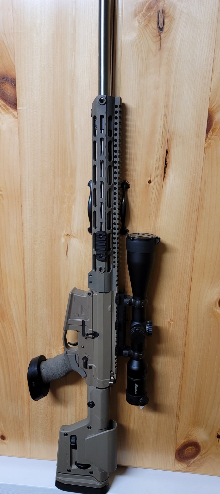

I've had several AR10 type rifles in the past and always got rid of them because of the weight. I decided to build a lighter weight AR10/AR308 pattern rifle and it came in at 7.8lbs bare, 10.4lbs loaded. I can't complain. Great shooter and very handy. View attachment 8597940
Nice, You nailed it, the MEGA is a heavy beast but shoots well.
The barrel is where I lost most of the weight, about 2lbs. Went with a 16" Wilson Combat 6.5 CM that shoots great. I could shave about 12oz going with a different handguard and prob 1.5lbs if I went to carbon fiber stuff, but CF is expensive for not much gain. This sucker balances great with the suppressor and, so far, I'm happy.

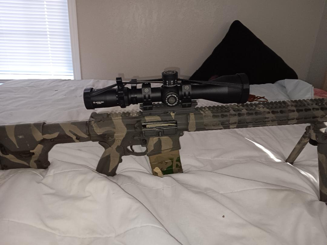

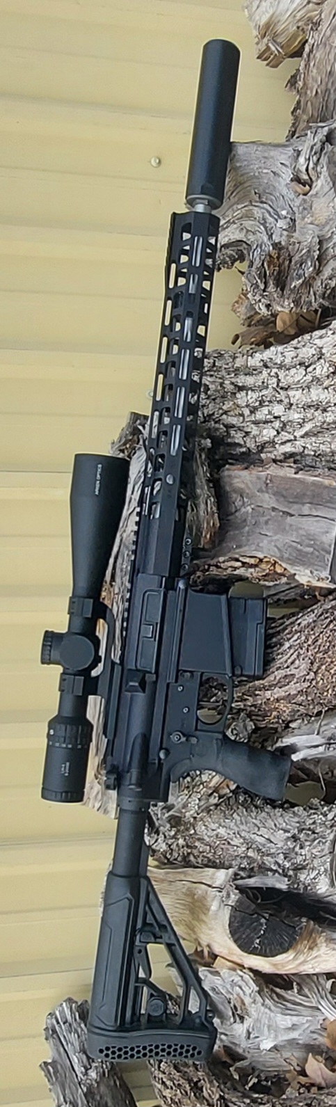

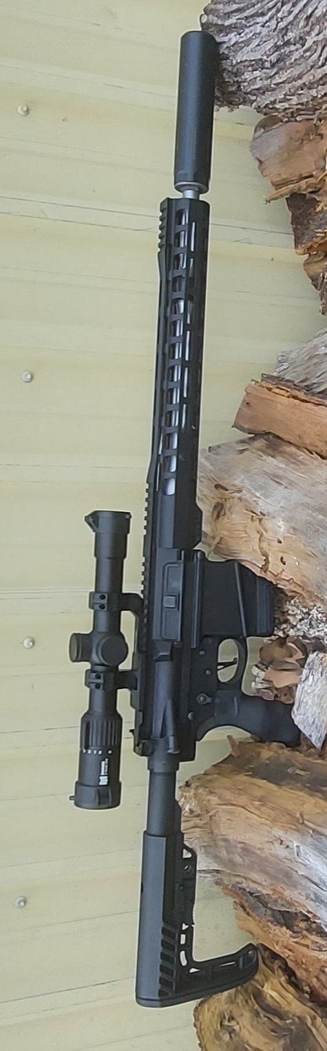

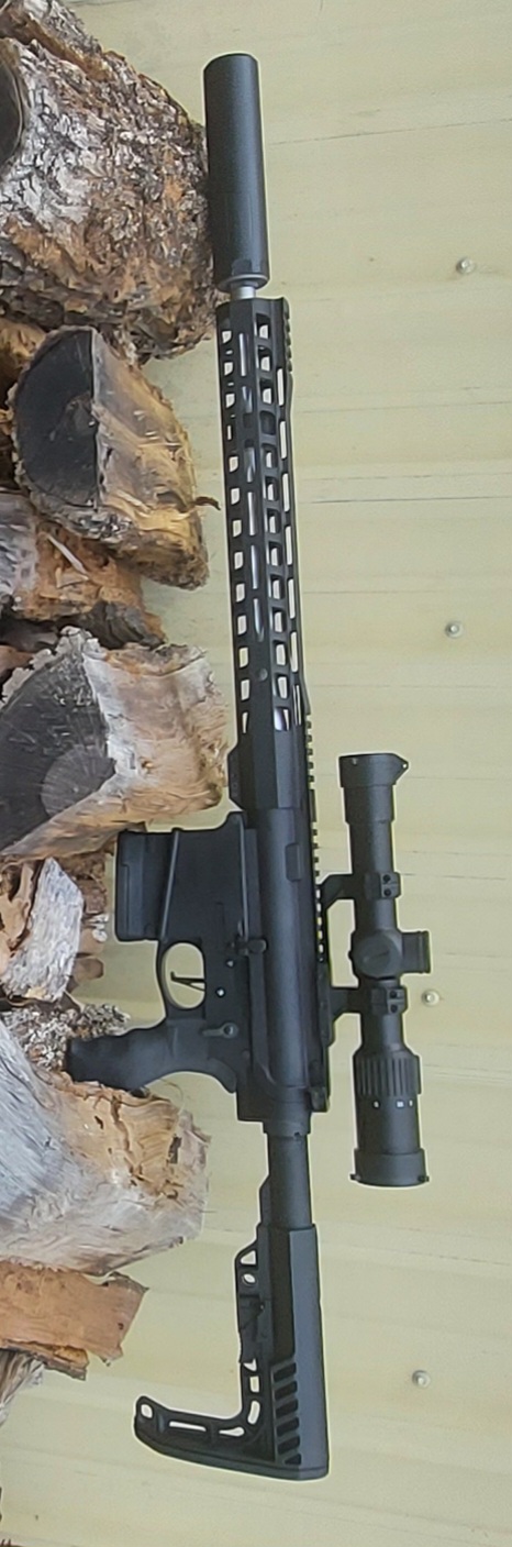

I was able to shed a pound off just by going to a different scope and stock. As it sits in these pics, I'm at 9.7lbs. Scope is a 2-10x30 Monstrum FFP. Inexpensive and nice for what it is. I don't a need 24 power scope for 500 yards and less. Lol

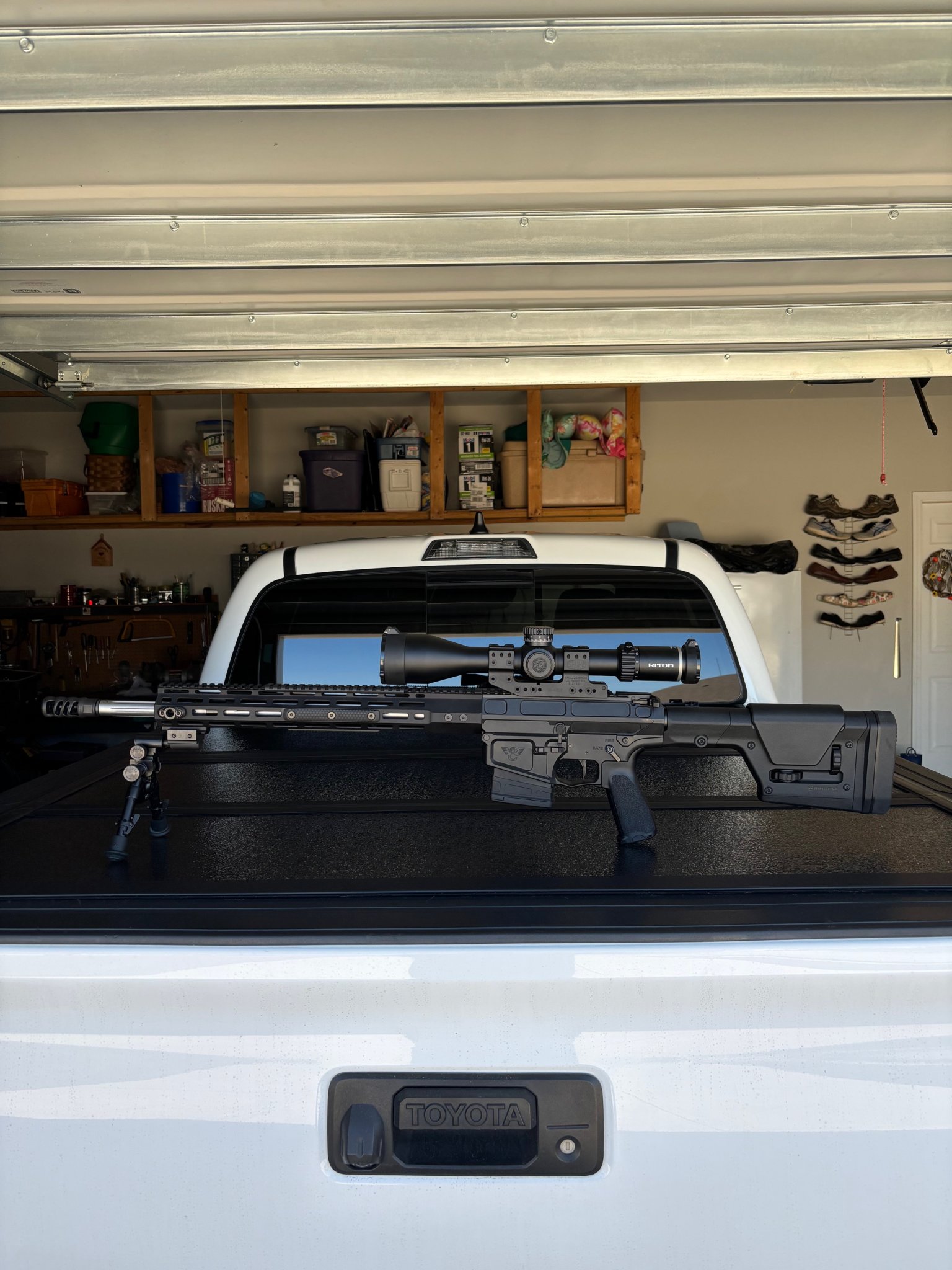

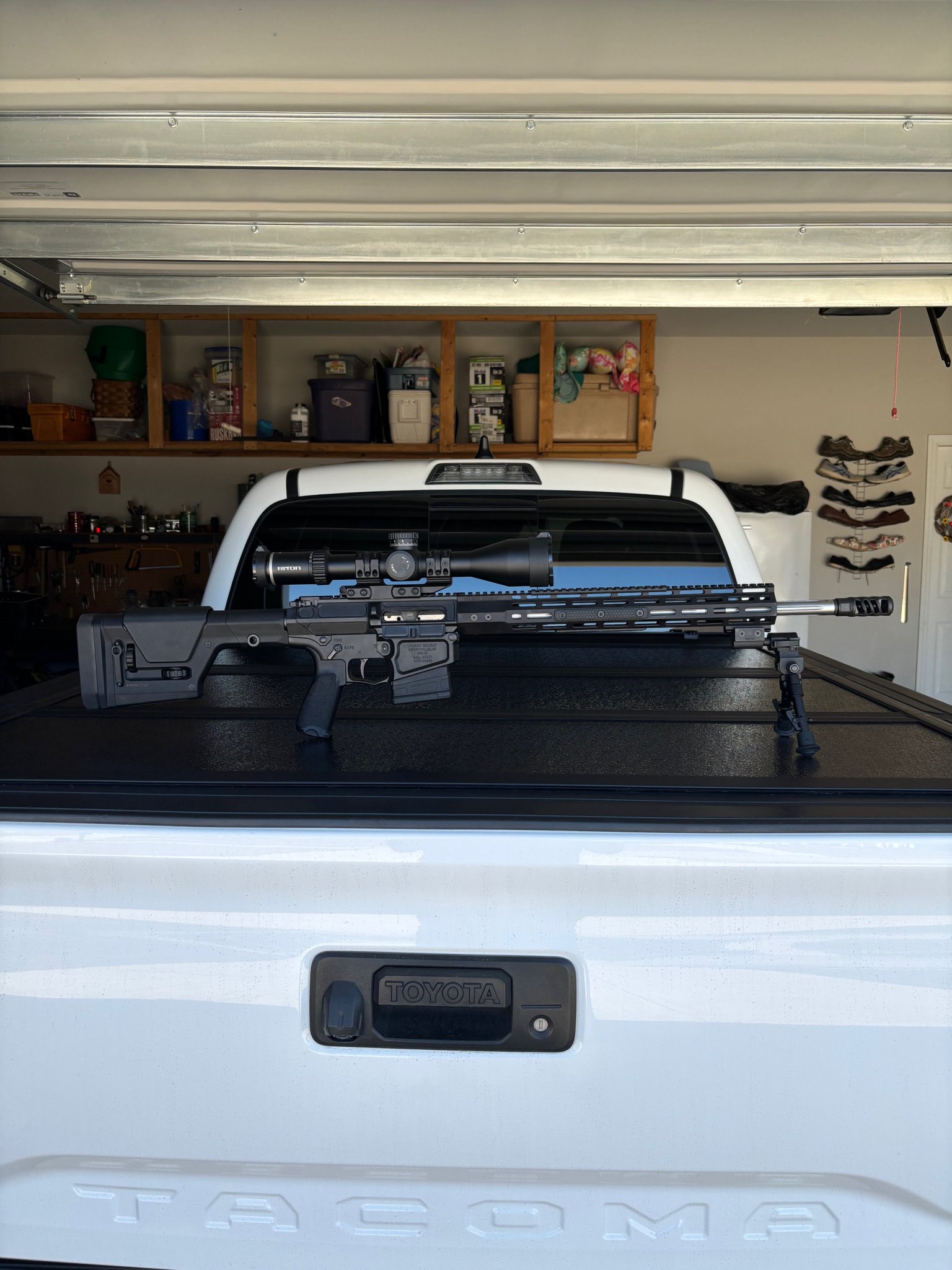

My Wilson Combat build in 308 Winchester. Wilson Billet light weight receiver set. Mostly Wilson parts. LMT Axle trigger and LMT four port muzzle brake. Timney 49er Ambi safety selector, DSI Nickel Boron BCG, AU Ambi magazine release and Breek Arms Warhammer ambi charging handle. Gun is accurate and functions perfect. Going to build another with a sixteenth inch Creedmoor barrel next.

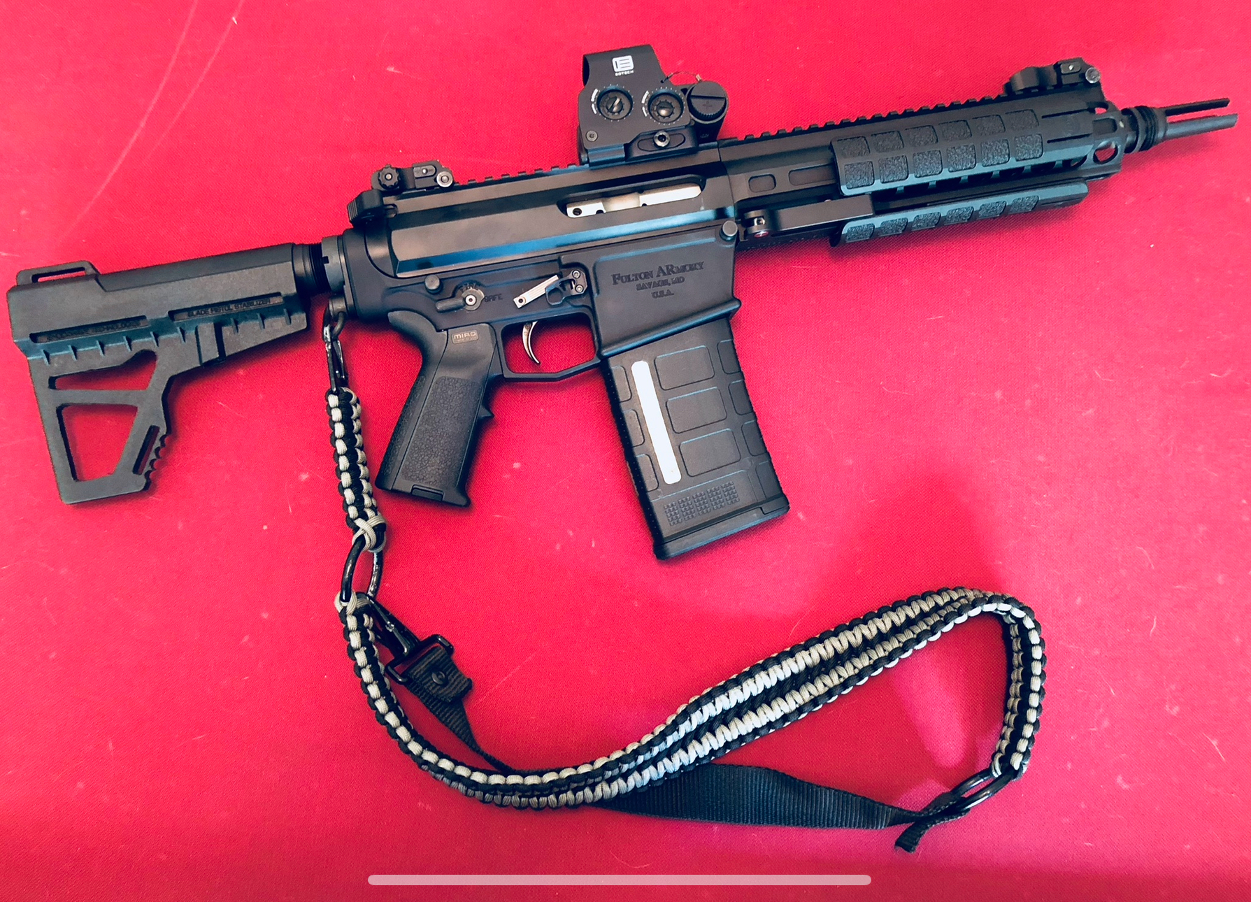

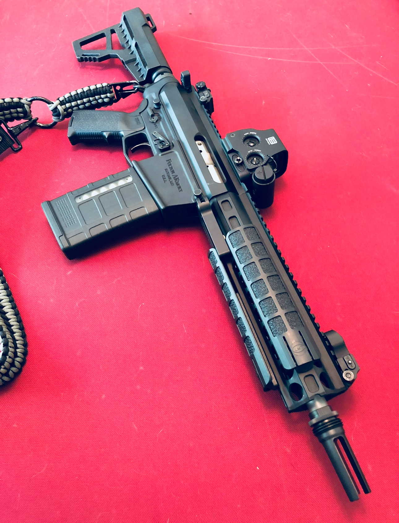

I just wondered if there was a good standard flash hider to go with the will cover the edges of a .850 muzzle, unfortunately not all brands list the OD of the muzzle device. I have one that is really close and waiting for a response from a manufacturer on another. Just wish everyone listed the od of their devices.

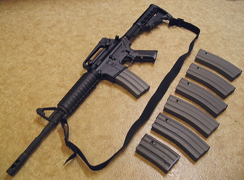

Carbine M4 model pictured

Good flash hider for a .850 muzzle, 5/8x24? I like plain and old school looking, think A2.
Will an A2 cover the edges of the barrel outside diameter right before the threads start? I don't want those edges exposed if you know what I mean.
An actual A2 type flash would need to be timed, either with a crush washer, timing washers, shims, or custom precision machining. The OD of a typical 5/8' crush washer is around 0.875", but the bevel side against the shoulder will look smaller, depending on the "crush". 5/8" Accu-Washers are around 0.835" OD. Have you considered these things as far as your perception of the final look?
Reactions: jLorenzo
You're right, I think I might be ok with the crush washer. We'll see soon.
