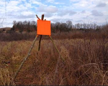

155 Lapua Scenars are great , bought some due to this thread took um to 1K past wkend. Found my favorite projectile . Screen Shot 2014-01-05 at 6.45.52 PM.jpgScreen Shot 2014-01-05 at 6.45.31 PM.jpgScreen Shot 2014-01-05 at 6.46.21 PM.jpg
