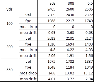

Using some of the short barrel velocity from other sources (rifleshooter) I build this quick and dirty chart using hornady 4dof
308 is 168 gmm velocity but 168 tmk bc, then a hotter hand load same bullet, last is 140 eldm
All that to show best case the difference in drift at 550 is less than 5” with a 10pm wind. Basically the 6.5 affords you 1 more mph wind error to still hit the vitals at 550. (.37 moa/mph 308 and .29 moa / mph 6.5) But that difference shrinks as distance shrinks.

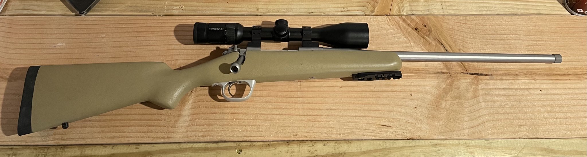

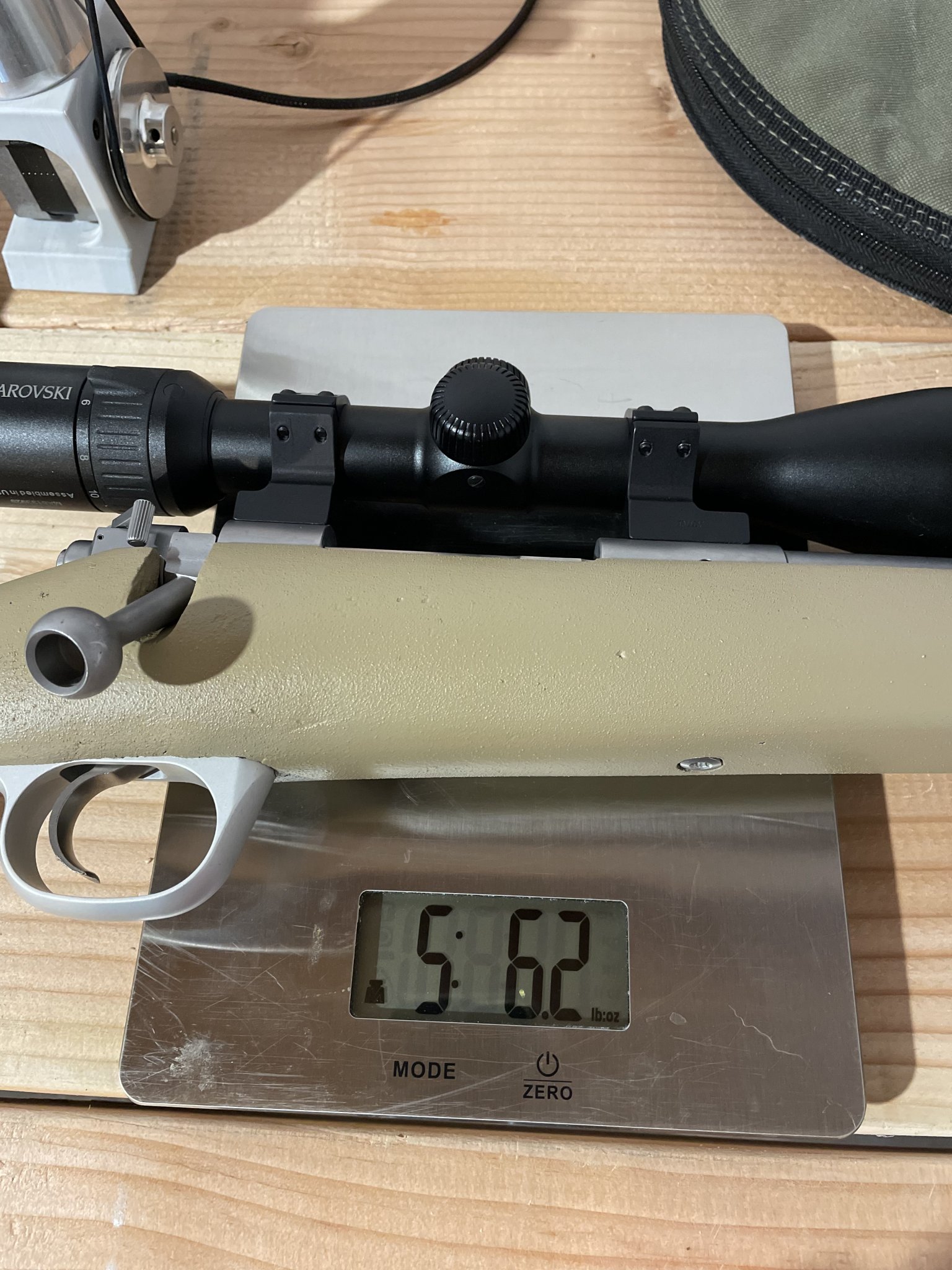

If you want a badass lightweight packable hunting rifle pick up a Q Fix, an 18-20” Proof CF 6.5 barrel, some Barnes 127gr LRX ammo and do the damn thing. It’s perfect for what you’re looking for.
For what it's worth, this is what I did. 16" Proof Barrel in a Q Fix with a Silencerco Omega using the Gtiffin Titanium Brake and Plan A Mount. Shooting 147s over 42.2-42.5 RL16 gives 3-shot groups in the .2-.4s and spits em out at 2555-2570 with SDs of 3.8 for 6 shots. With a Vortex LHT this is my perfect mountain/hunting rifle and it's pure sex to boot.
