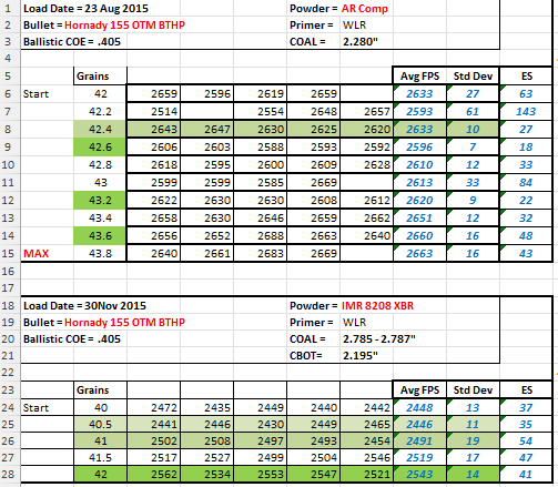

Using sierra 155s I have Ar Comp and Varget. GRT showing Varget would be a little less pressure and more velocity. Any idea where to start with a gas gun? Looking at 45ish gr of Varget and 43ish gr of AR COMP.
...some pressure test results I obtained. Brass was assorted year LC. Environment is tropical island, avg year round temp ~85F, Relative humidity ranges from 65-80% during daylight hours to 85-100% at night. AR-10 build w/16" CLGS tube & SLR AGB, standard carbine buffer system. YMMV

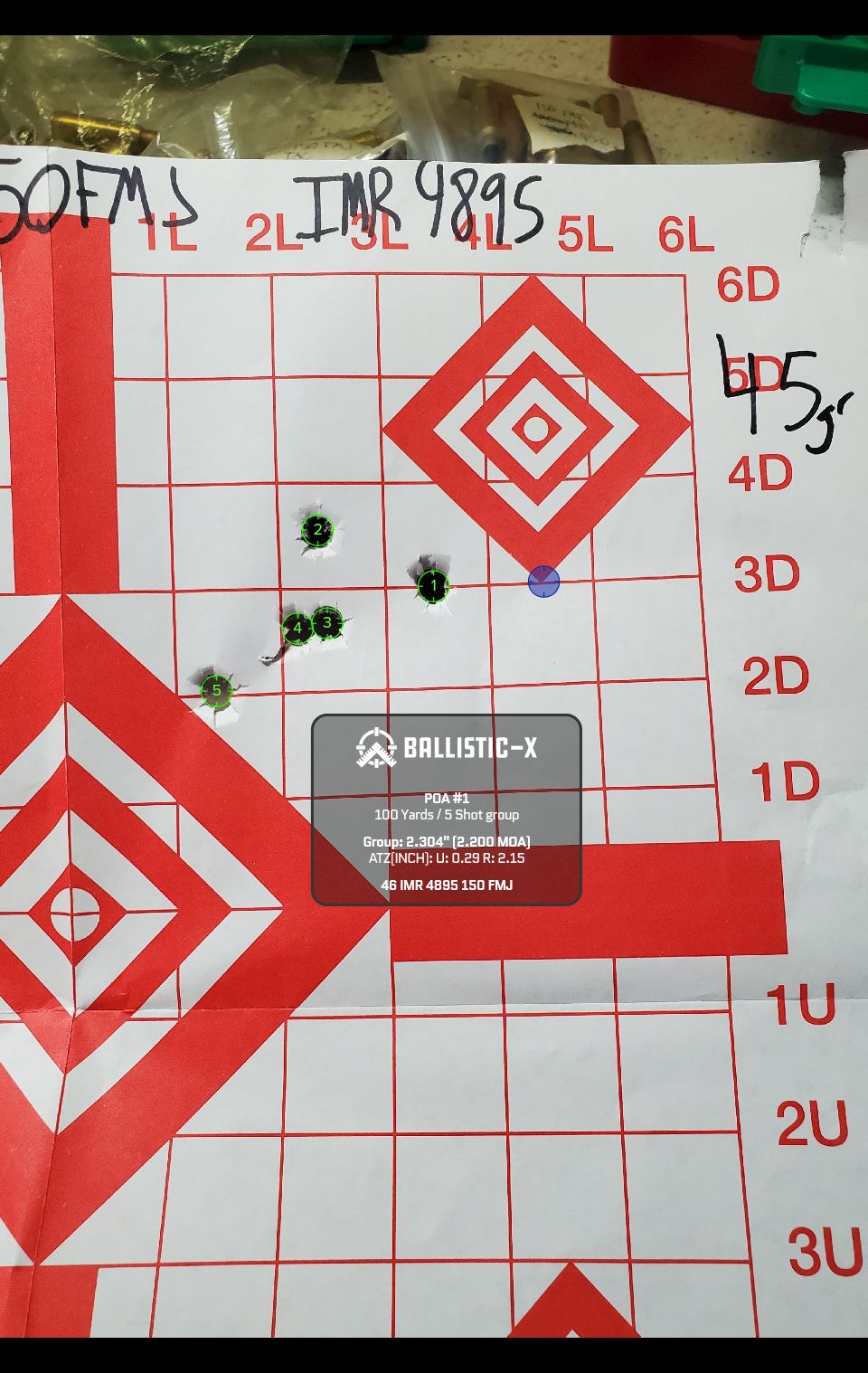

I bought some Hornady 150gr fmjs, gonna attempt to get something shooting with Varget. Just returned a Rainier match barrel that shot like shit, bought a BA on sale for 120$ on memorial day just to try before I buy something truly expensive. Shot 1.3-1.5 moa with Nosler 175s and Varget 42.5gr. Alot better than the 380$ Rainier ironically. Gas port was way cleaner on the BA too. Mustve lucked out because I dont really like BA barrels. Just loaded up to get the gun broken in. I'll be happy if I can get the fmjs to do that consistently.
Took two loads with Hornady 150 fmjs w/ cannelure (loaded long, case not touching cannelure) two charges of Varget. 46 and 46.2, shot just under 3 MOA tried a shorter seating depth as well, didn't make much difference. Got them to 2800 though with a 18" barrel, super sonic past 1k. Wouldn't go any higher charge wise. Brass looks good but primers were just barely starting to flatten @46.2.

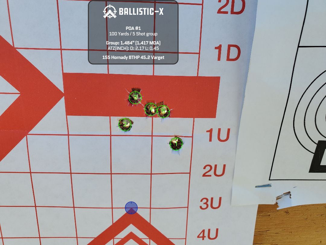

I had some Hornady 155 bthps laying around, loaded some of those @ 45.2 Varget, mag length. Shot well, 2725 out of the 18". I have some 155 SMKs and more Hornadys I am going to try.
I am hoping to get the 150 fmjs down to around 1.5 moa because they are cheap and nice to shoot recoil wise. I might try Tac or AR Comp next. Also run a seating depth test.
Side note, AR10 barrels get hot fast. I spent a lot of time waiting for it to cool.
Happy with the 120$ memorial day sale Ballistic Advantage so far.

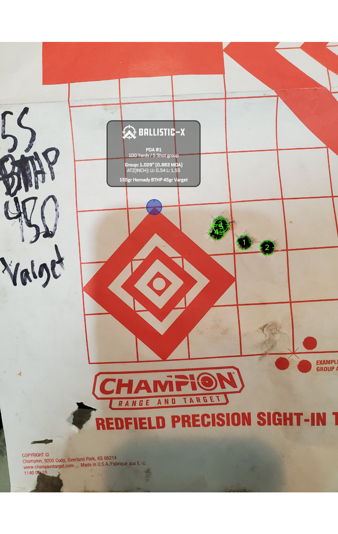

Confirmed the Hornady 155s, shot better than the 155 SMKs which seems odd but I won't complain.

I think IMR 4895 is going to do the trick for the 150 FMJs. Took it from 3 to 2 moa and gave a nice little bump in velocity. 2819 out of a 18". Hopefully I can tune it down a little more but for plinking at 21c per bullet this will work for me.
