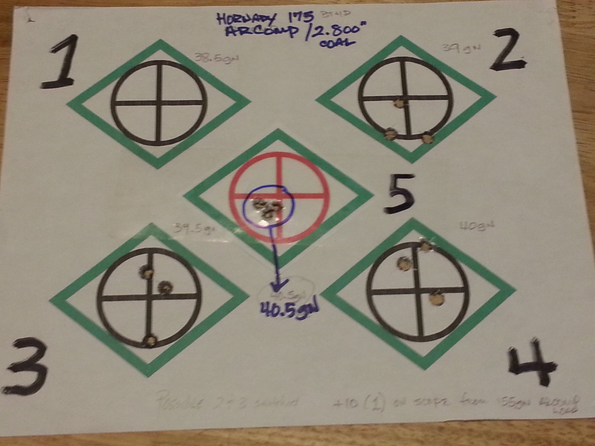

FWIW, 16" AR "self-build"....
Load Date = 23 Aug 2015Powder = AR Comp
Bullet = Hornady 168 OTM BTHPPrimer =WLR
Ballistic COE = .450COAL =2.280"
GrainsAvg FPSStd DevES
Start39.5
2416​
2435​
2377​
24092458
40
2452​
2441​
2447611
40.5
2411​
2449​
2434​
24311638
41
2443​
2451​
2464​
2453921
41.5
2486​
2484​
2474​
2481512
Bullet = Hornady 178 OTM BTHPPrimer =WLR
Ballistic COE = .530COAL =2.280"
Start38.5
2327​
2313​
2324​
23216
39
2343​
2328​
2347​
23398
39.5
2373​
2388​
2368​
23768
40
2404​
2411​
2404​
24063
40.5
2435​
2418​
2394​
241617

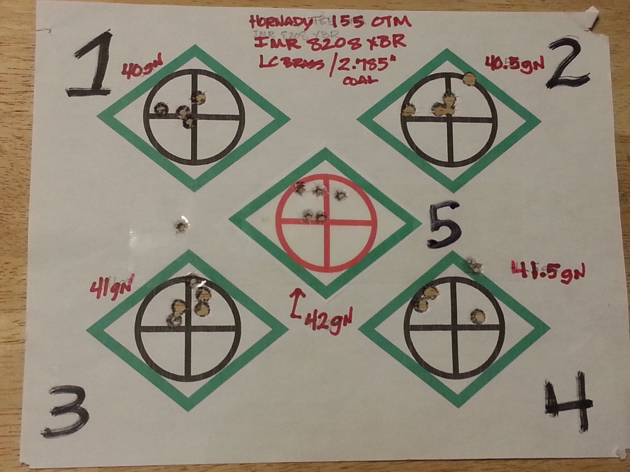

Well 16” ar10, starting load for service rifle is 41.5-43.9 (which I’m going to assume means lake city brass), IMR 4064 with 168gr SMK.
Accuracy at 100yrds is excellent at 41.5-41.8. Not saying others aren’t but up to 43.4gr it just wasn’t that good. Now 42.2-42.8 has produced good results as well.

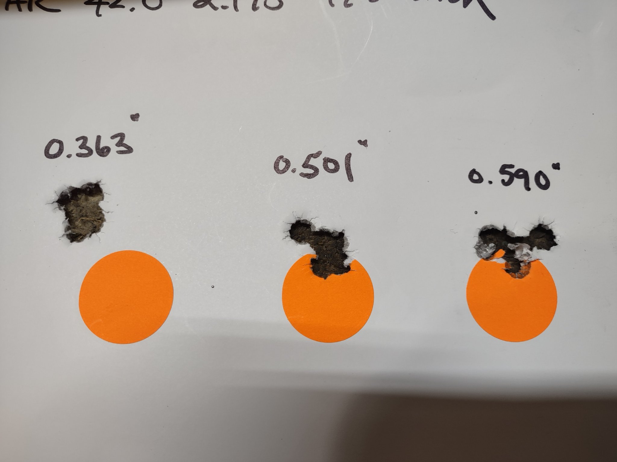

Finally got my AR10 308 shooting the way it's supposed to. Craddock Precision 18" (Bartlein) barrel. 5 rounds each @ 100 yards.
Powder. Varget, 42.0gr.
Case. Lapua
Bullet. Sierra 175 SMK
Primer. CCI LR
Ogive 2.195

What sort of velocity are you getting? Those are some fine groups.
Any of these loads in this thread should be good to go barring your barrel just doesn’t like a particular bullet. With the M118 chamber I’d look at these loads that use a 175 SMK or Nosler CC….
ETA there isn’t a free lunch when it comes to reloading, you still have to put in your own work because each barrel is an entity unto itself so to speak. While there are many proven loads that seem to work well across many rifles, sometimes you have a barrel that just doesn’t like them. I’d buy a box f whatever bullet you decide upon and a pound of whatever powder you’re thinking about and go from there. If your barrel likes it then buy kegs of that powder and larger quantities of bullets.

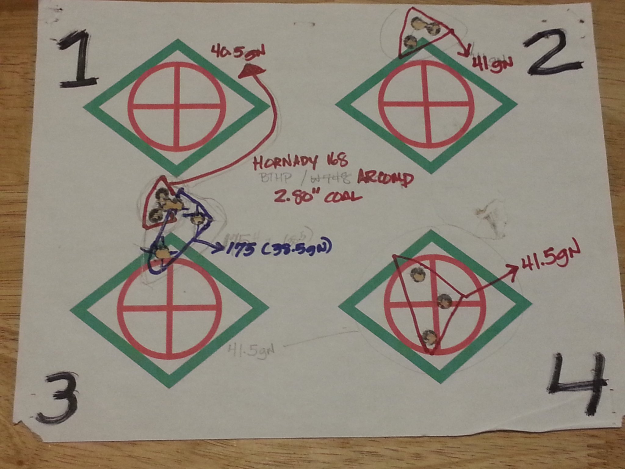

..for my purposes, each of the bullet weights had one good group. Understanding that my perceptions are just that, mine. I've added the test target results to this post, you can look at them and come to your own conclusions.
YMMV

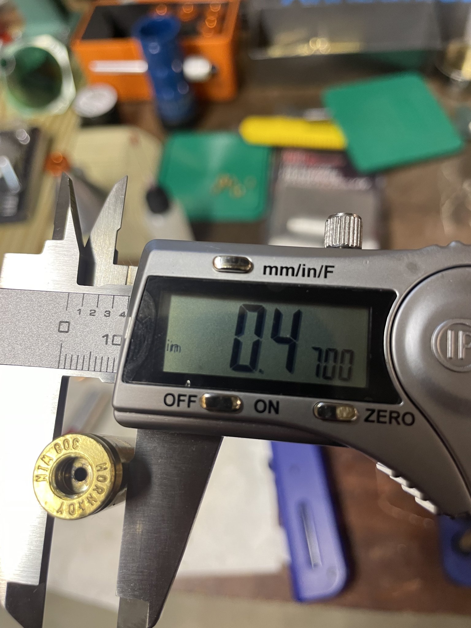

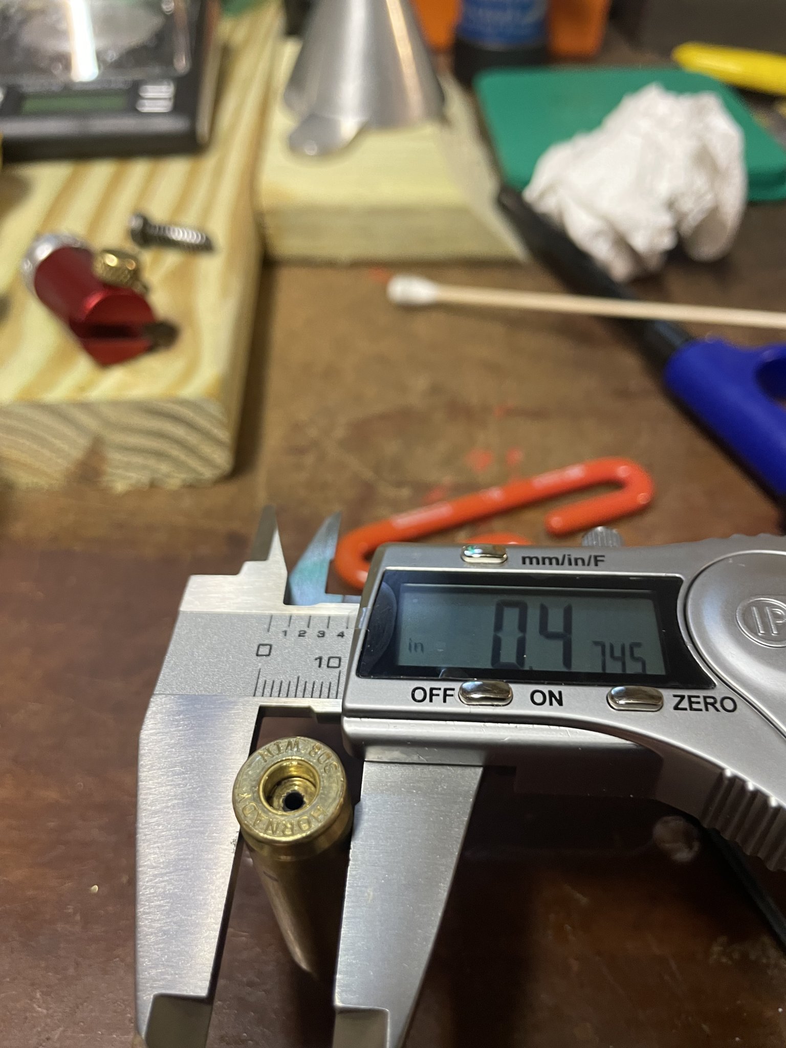

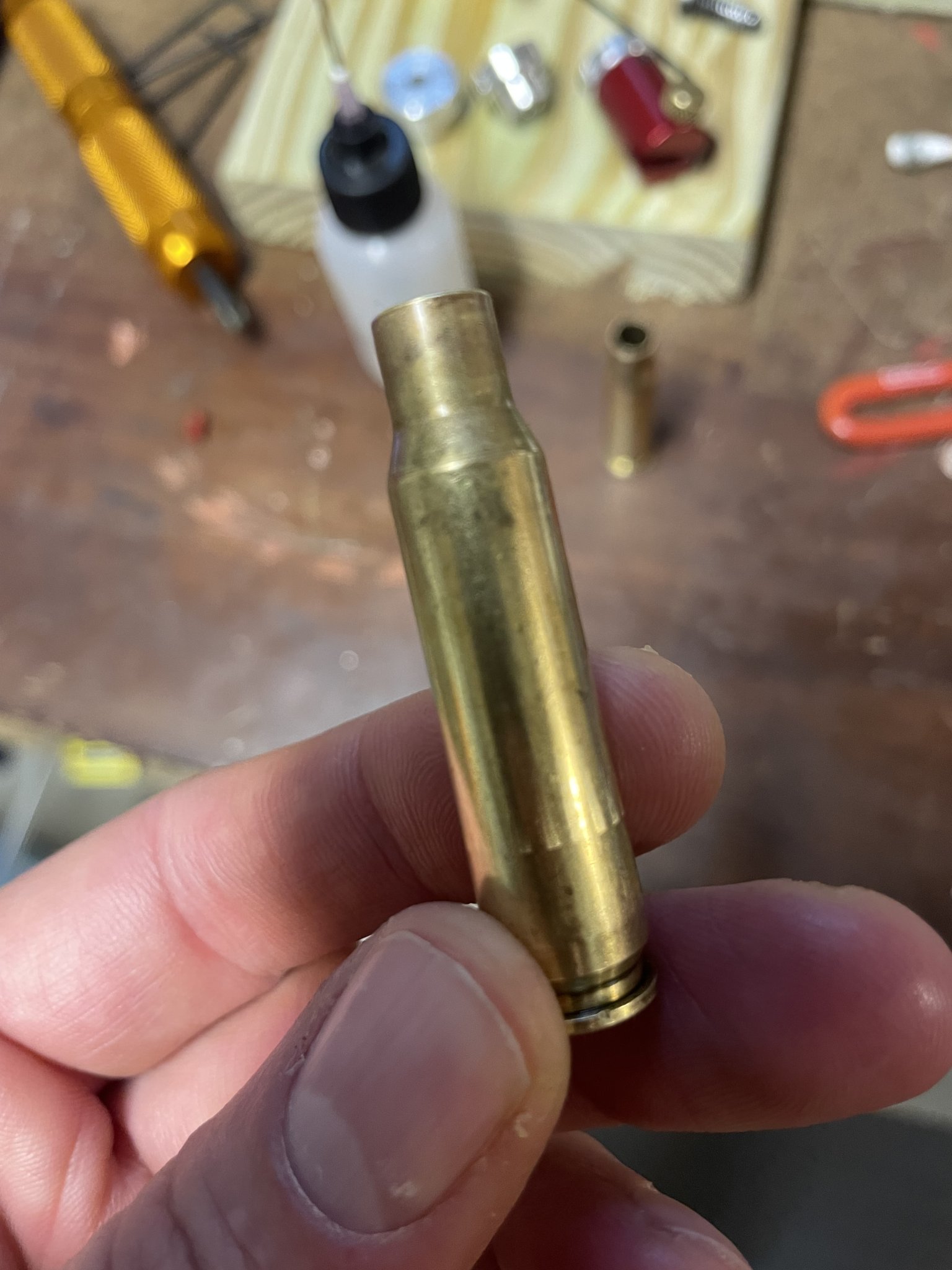

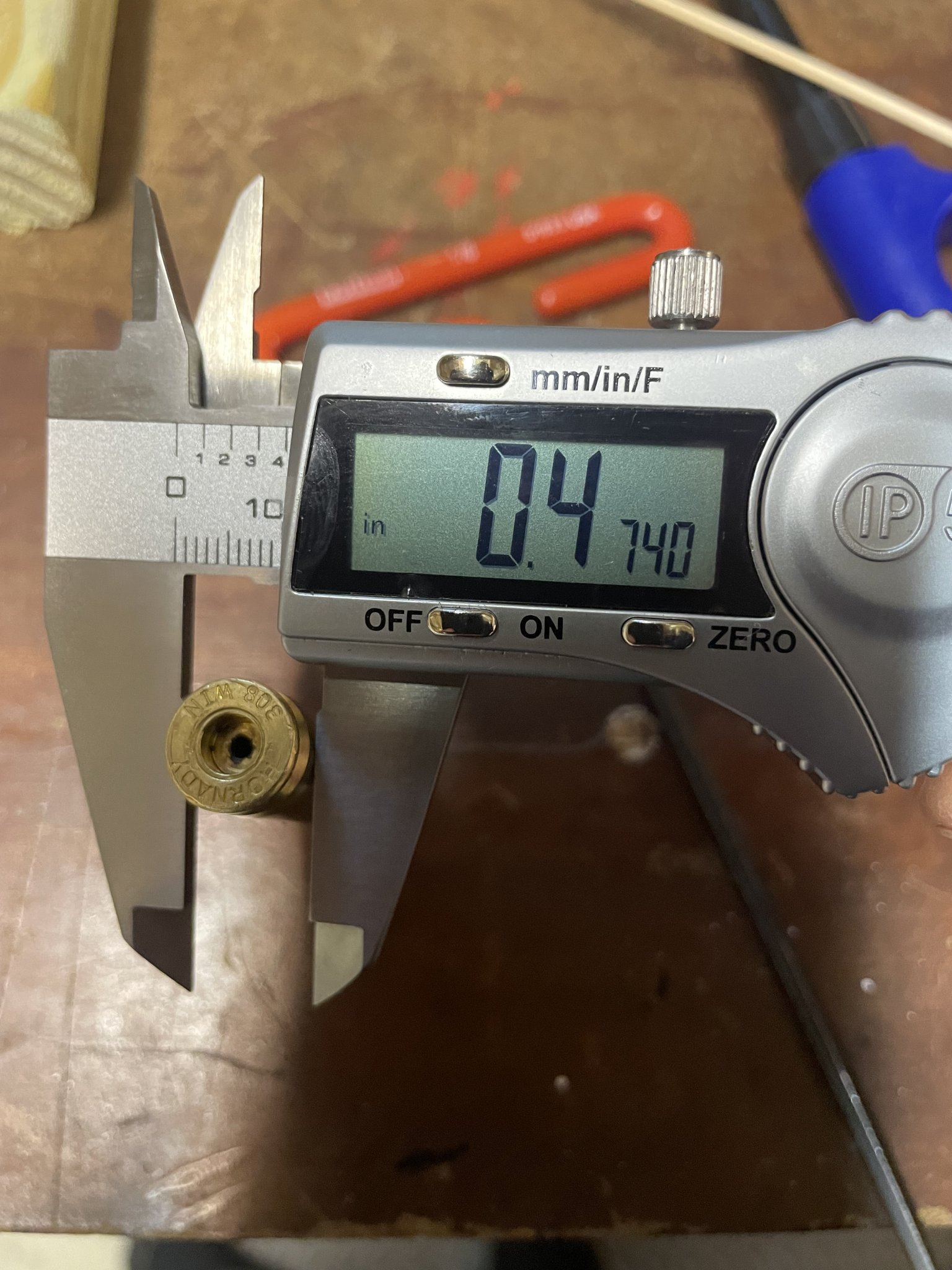

Hey guys. Looking for some help here. Put together an AR10 using an aero precision upper and lower. LaRue .308 20 inch stealth barrel and SA gas block and aero precision nitrated BCG. Purchased some clymer headspace gages and put it all together no problem. I’ve done several semi autos with no issues. But I understand what I got into here with a mix master large frame gas gun.
So I’ve shot some factory Hornady 168 ELD match ammo. I also loaded up some reloads using some 1x fired Hornady brass out of a bolt gun, with Berger 185 juggernaut over 41.5 and 42 grains of Varget. Velocity avg 2400 and 2450 respectively. No pressure signs that were evident with primers at all. Brass dinged up a little, but it’s a 308 gas gun so I expected some.
But the problem came up when I go to resize all these brass cases, and I can’t get them to fit in my RCBS match master sizing die. Press handle feels like it would be impossible to press down any further.
So I measured the 1x fired Hornady brass out of the bolt that I was able to resize and create my loads with. They averaged. 469-.470” @ .20” above case head. Everything being shot out my gun at the same spot measures .474-.475”. So this has to be the problem. Is my barrel chamber out of whack to allow that much growth in the case web area?
Again headspace checked out fine with go/no-go and field gauges. I added pics showing measurements the brass. Last pic show brass after I try to resize.

It could just be the chamber fluting that larue does.
Try a regular sizing die and not the match master?
Is it blown out lengthwise as well? How are the shoulders are they oversize too?
I had a 223 barrel from a certain maker with an out of spec chamber and when I rolled the cases across a flat surface they looked like little footballs.
The chamber in your barrel is fucked. It should not allow the webs to expand to that size. Though this can happen through spring back in a properly chambered barrel, you wouldn't be able to easily extract the brass. So the gun wouldn't cycle, and you would see massive pressure signs. If you're brass doesn't show pressure signs and the over expanded webs happen with multiple types of factory ammo then the chamber is oversized. The cause of the chamber being wallored out is often a loose tailstock allowing the reamer to wobble and over cut the base of the chamber.
Reactions: patscrazy
The headspace on this barrel is very tight to begin with. I know these my comparator numbers and don’t mean much to anyone but my fired brass in this gun measures 1.6225”~ so I bumped the shoulder down .003-004 to 1.6195-1.6185”~.
1x Fired brass out of the AIAW bolt gun measures 1.6260”~.
So basically I need to pull this barrel and send it to larue and see what can be done.
If your chamber is that wonky you should be able to put a sized piece of brass in there and wiggle it around by hand. I know how you're feeling because I went through the same thing with another barrel from a maker who tooted their horn a lot and they told me to get fucked. Hopefully if you send your bolt, fired brass and barrel to Larue someone with a brain will open the box and take care of it.
I sent an email to Larue explaining the issue and they told me to send it in. I’ve never dealt with their customer service but given their reputation overall in the firearms world I’m a bit pleasantly surprised. But we’ll see what they ultimately tell me and how they handle it.

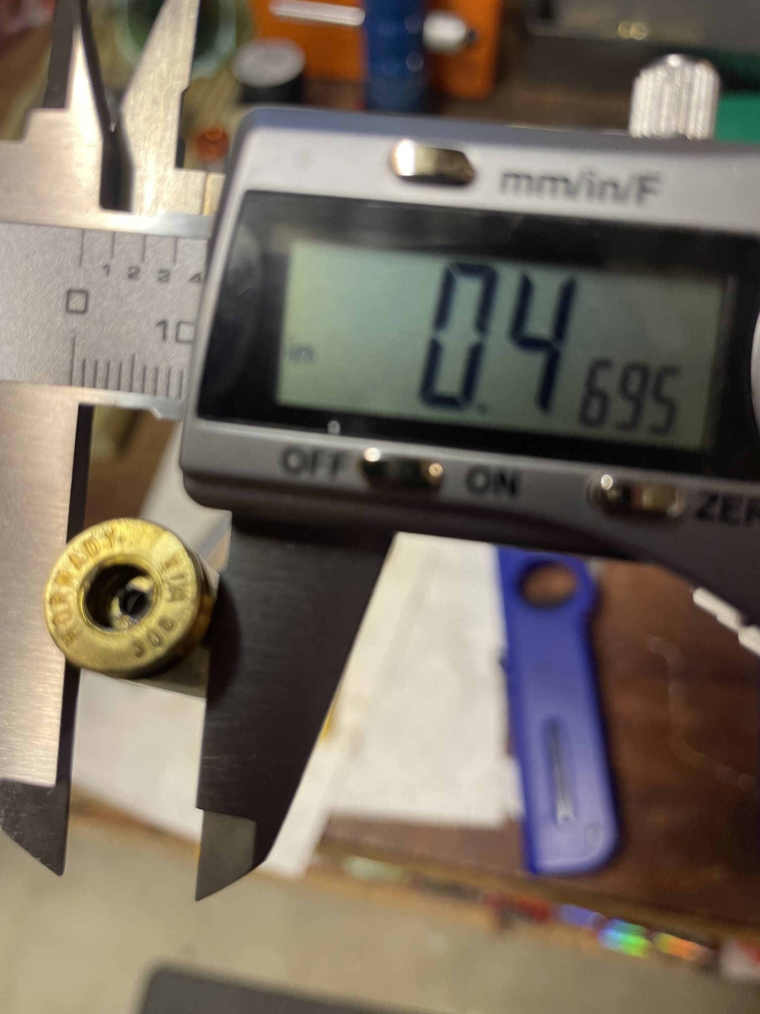

I’m getting the same measurements from my fired brass out of my Criterion barrel. I’ve got no issues resizing with Lee dies.
So you’re getting .474–.475” just above the case head on your fired brass, out of that barrel? I can’t even come close to getting them to fit in my RCBS gold medal match dies. I thought this for sure was my issue being that my other 308 rifles, including a gap 10, are coming out at .471~.
Maybe I have to try a different die set. But needless to say, I already pulled the barrel and sent it to Larue for them to inspect. We’ll see.
Web diameters on these caseheads are standard at .470. Give or take a few ten thousandths depending on custom reamers. If someone is getting over .471 they are either over pressuring the brass, have an out-of-spec chamber, or are measuring incorrectly. The correct tool to measure the webs will be a mic, not a vernier caliper
I measure 3 fired cases and got .4695, .4705, and .4705. I apologize, I didn't scroll down and see the last two measurements of .474 and .4745. I did not have any cases that measured that big.

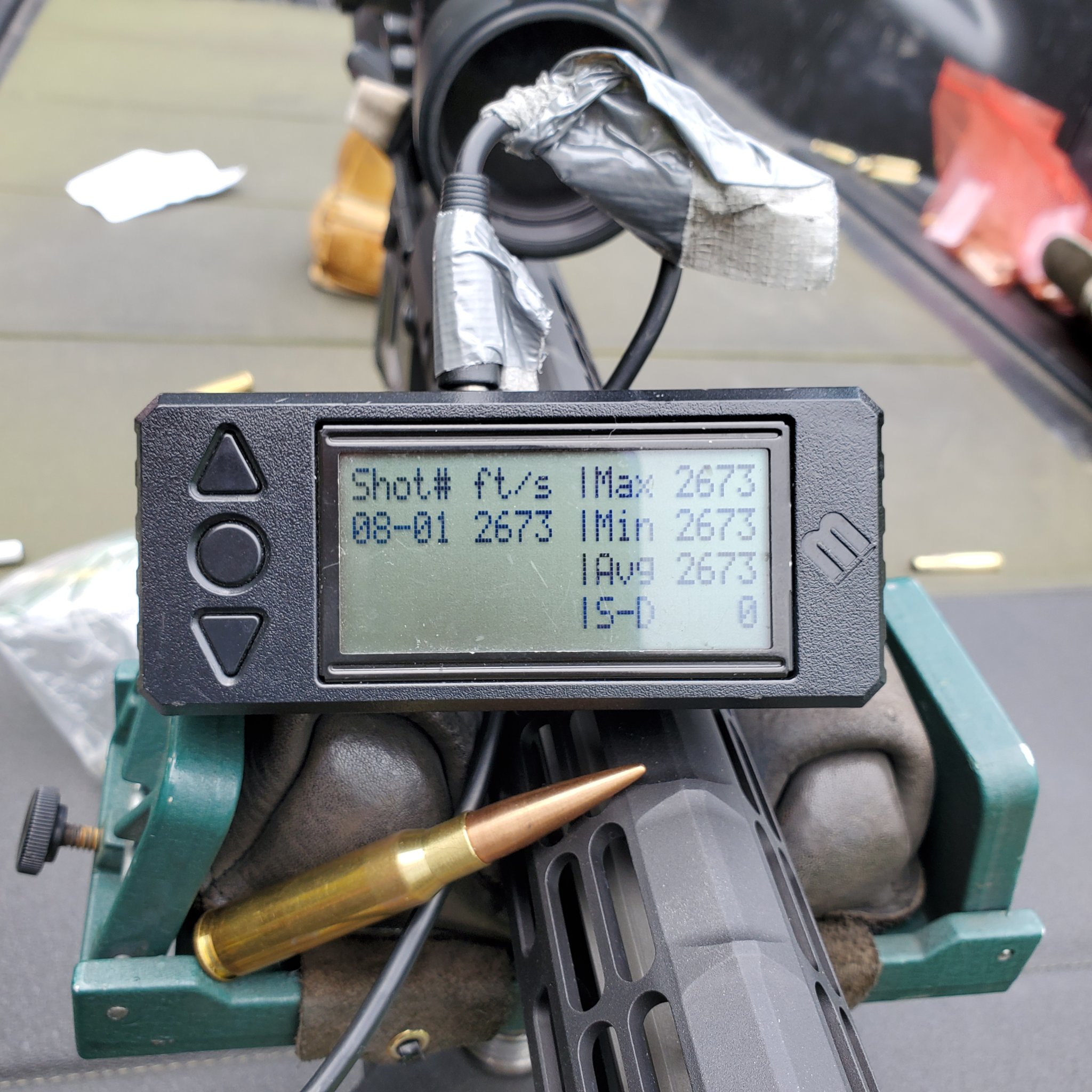

I'm relatively new to 308 gas guns, how am I doing with a 150 fmj doing 2760 out of an 18"? 42.8gr of AR Comp, Fed brass.
First the digital caliper is not an accurate tool for measuring, but considered a reference tool.
Next the go and nogo do not measure chamber diameter...it measures the length of the chamber.
If the primer is not falling out from over pressure of the expanded web of the solid head not covered by the barrel. The solid head does not expand much or your primer falls out. Its expands in an area about .150" to .200" above the rim...the "bulge area" as I call it. That's what gets resized with the FL die not most of the solid head.
You have a bad chambering job...most likely not a reamer ground out of print.
Things like tailstock and spindle alignment out...(even in CNC pockets that have been crashed.) And not using a floating reamer holder. The back of the reamer will shave slightly more material off one sides its forced into the bore with these problems.
Not indicating the outboard portion of the barrel held in a spider.
Barrel bores are not straight....ever heard of barrel straightening.
Not indicating down the bore where the throat is comparing it to the head area on the indicated barrel...then pre bore it at an angle to get a true running hole before the finish reamer ever touches the barrel.
This shows how hard it is to resize brass.
Lee Resizing white lube works better than most. Polish out the bottom of the die for the first .200" and blend so it's easier to size and doesn't work the brass down but chambers and sizes easily....for your chamber only. Or send it back...
I sent the barrel back to LaRue. They inspected it, test fired it with my bolt and said there was nothing wrong with it at all. Who knows how much measuring they actually did but their customer service was quick to respond more and happy to take the barrel in and look at it so I’ll give them that. I already sold the gun because I’ve moved onto other projects like I do with things.
But maybe if I just tried some different dies like small base dies maybe I would’ve never even noticed the issue. I’ll never know.
That is typical nomatter who does the work...the headspace IS correct, but we already knew that.
The problem is elsewhere as already explained...in the actual chambering, but will not hurt the functionality of the firearm as I already stated.
Here's what you do ...
DO NOT GET A SMALL BASE DIE IT WILL MAKE THINGS WORSE.
If anything just buy a cheap Lee FL sizing die, and polish the die out in the head area to make it slighty larger. DO NOT POLISH THE SHOULDER AREA or much of the body area just a blend....the case bulge is where you polish.
And this takes that diameter down enough to chamber easily in that chamber only.
So no big deal if the bulge is .472" and everyone else is .470" as long as the reloaded cartridge chamber freely in this firearm, but may have a bit of trouble chambering in another gun.
BUT BEFORE DOING ANYTHING...use this lube Lee Resizing lubricant ...applied liberally as shown.
Put in your press with the FL die you have.
Pump the press handle up and down 3 or 4 times as it gets near the top of row stroke on the oversized area of the case. Pump the handle until you reach the top and hold at the top position for a second.
Experiment here it may take 6 pumps to bottom out and hold for a second.
Or just 2 pumps as the die and lube work in harmony to size your case.
Then go have fun shooting your reloaded rounds that will most likely fit other chambers, but be over worked in your chamber sizing and firing cycles may shorten brass life...but it works
That's why polishing out the die a thousandth or so to help over working the brass in this area that's all, ...and ease of sizing a by product.
I like dies that have a bleed hole in the shoulder area, but wipe any lube off the shoulder as shown to prevent dents.
This will work guaranteed!... then go have fun shooting your gun.
