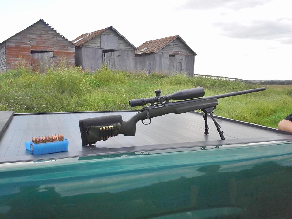

.308 Winchester
Rem 700 short action
rem 700 5r 20" tube
44.5gn varget
185gn Berger VLD's
CCI 250 primers
Federal brass
2.8750 COAL
unknown velocity, dont have a chrono..
shoots great at 100 yards out to 1200 which is as far as I have been able to stretch it. The VLD's did very well on a pretty windy day out to 725. Constantly on a 5" circle with far less hold for wind than the 175gn SMK.
Velocity is 2740fps avg..

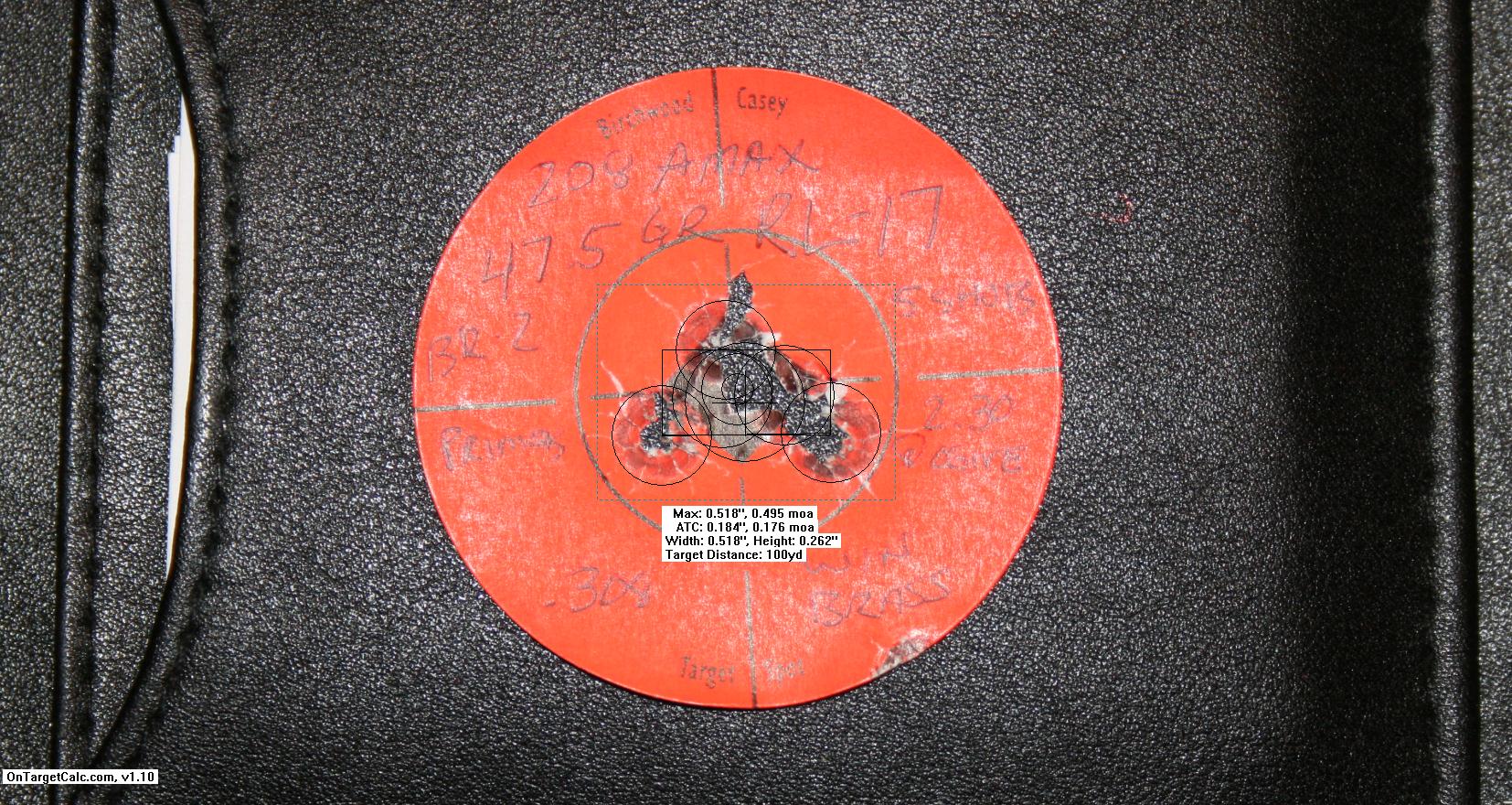

Found a good one.* WARNING IS HOT LOAD*
Rifle is a custom built on a Stiller action and a 28" Bartlein #9 1:11.25 twist.
47.3 Reloader 17
208 amax at 2.207 to ogive (2.961")
Lapua brass, fgm210m
Average at 58 degrees was 2650 fps w/ a magneto speed V2
