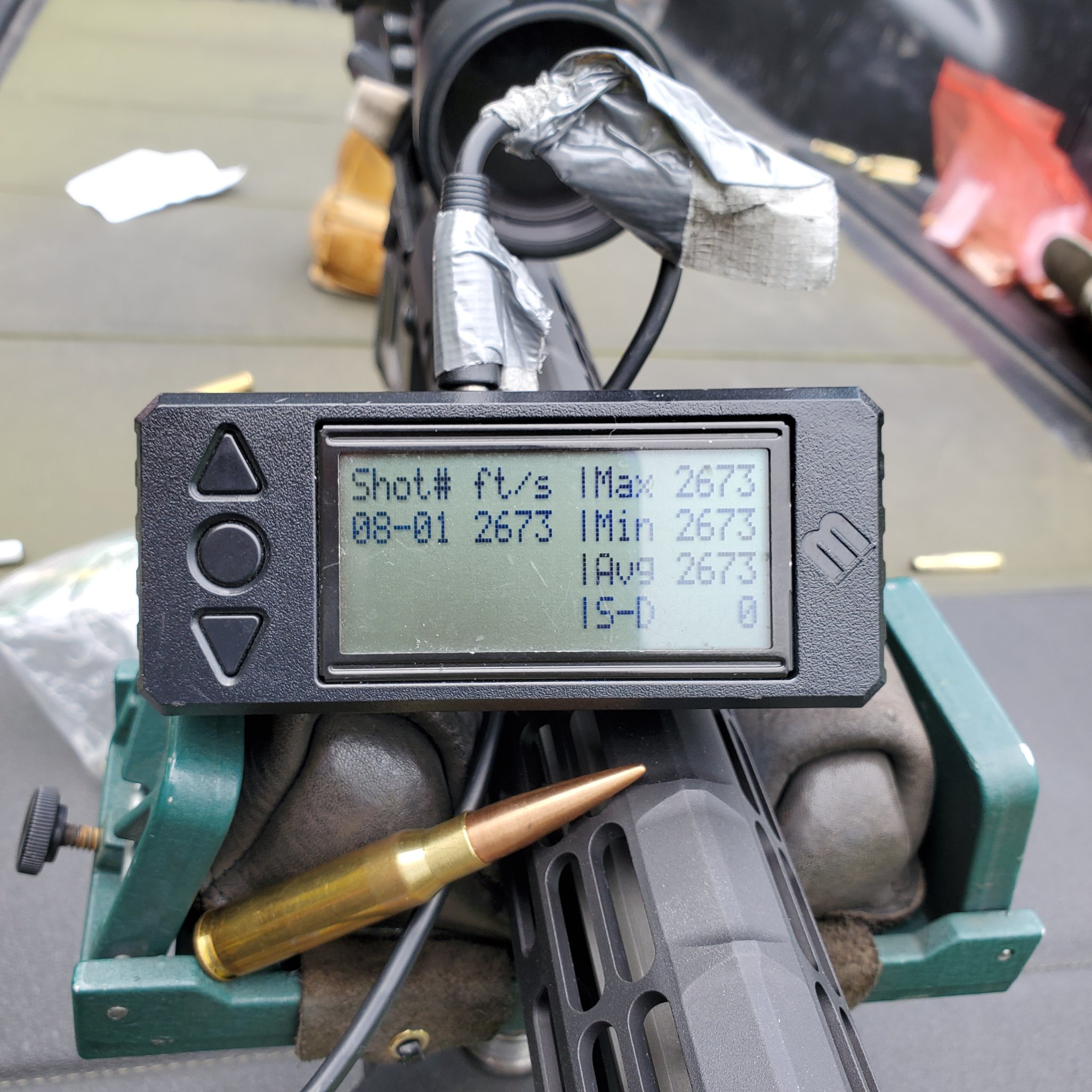

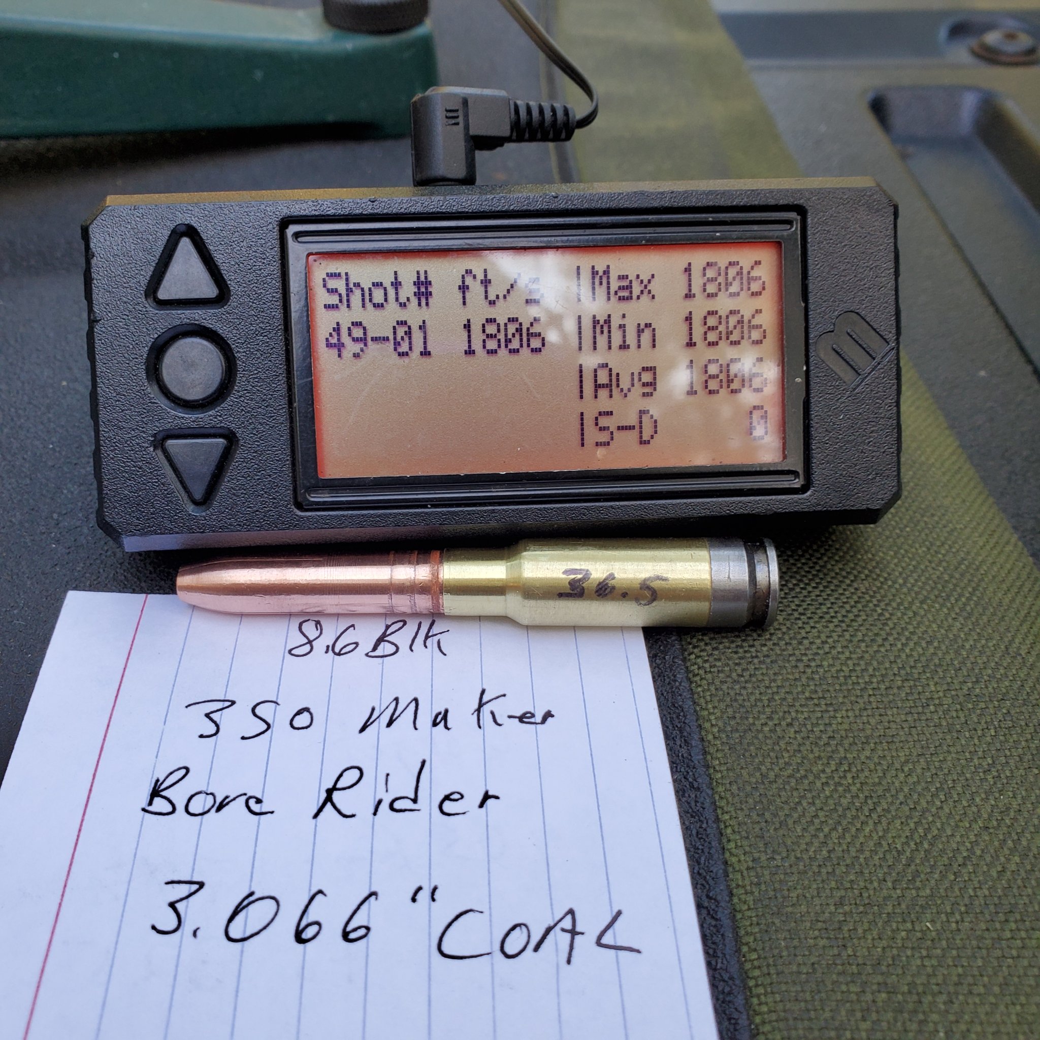

The 2740 fps for 200 gr SMK is from standard Lapua cases as shown in the picture with the empty cases...
The picture of the rifle with the Chronograph has the 2740 fps velocity on the chronograph screen!
Don't believe that...you don't want to believe.
It's not for those who don't want to do it, or improve upon the 308 Win. No one cares of ya do or don't, but it's real, & it's there for those who do...called choice.
My 30" runs the same load at 2856 fps for 200 gr SMK Lapua cases. And is my go to load for 308 LR. And 230 Atip at 2620 fps is a good 308 load, as is 225 eldm at 2675 with Lapua brass.
With hybrid cases the 200 gr has reached a maximum of 2951 fps, And the 225 Eldm 2719 fps. 3255 fps with 168 match with 30" barrel, as max...but I don't run the hybrid cases there.
Here is an 18" AR 10 shooting the same load 200 gr SMK around 2670 fps Lapua brass...do not recommend a steady diet in an AR but 200 at 2620 fps in an 18" AR 10 is doable, with Lapua brass.

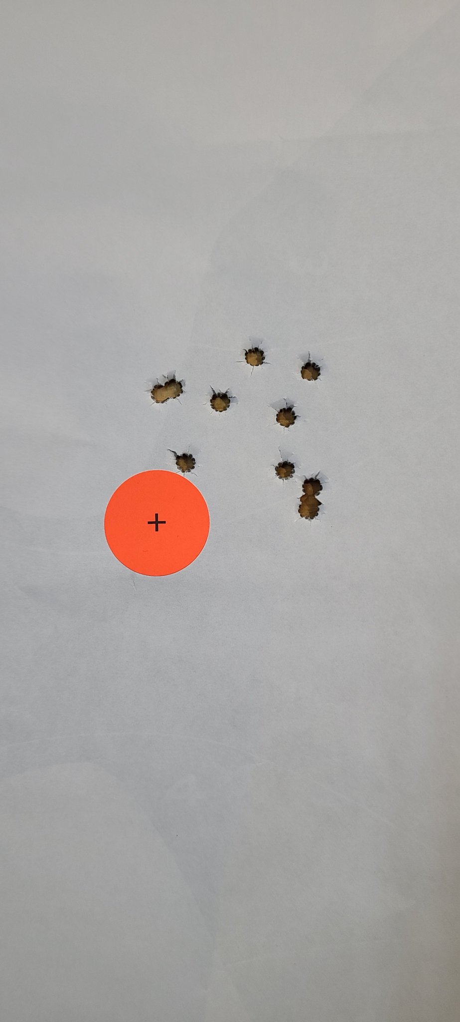

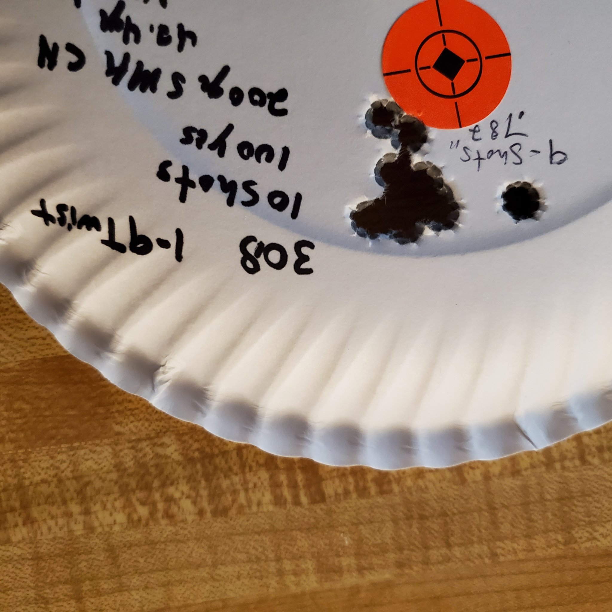

And the 200 gr SMK 10 shot group in 22" 308 9 twist, Lapua brass, with a light weight hunting rifle.

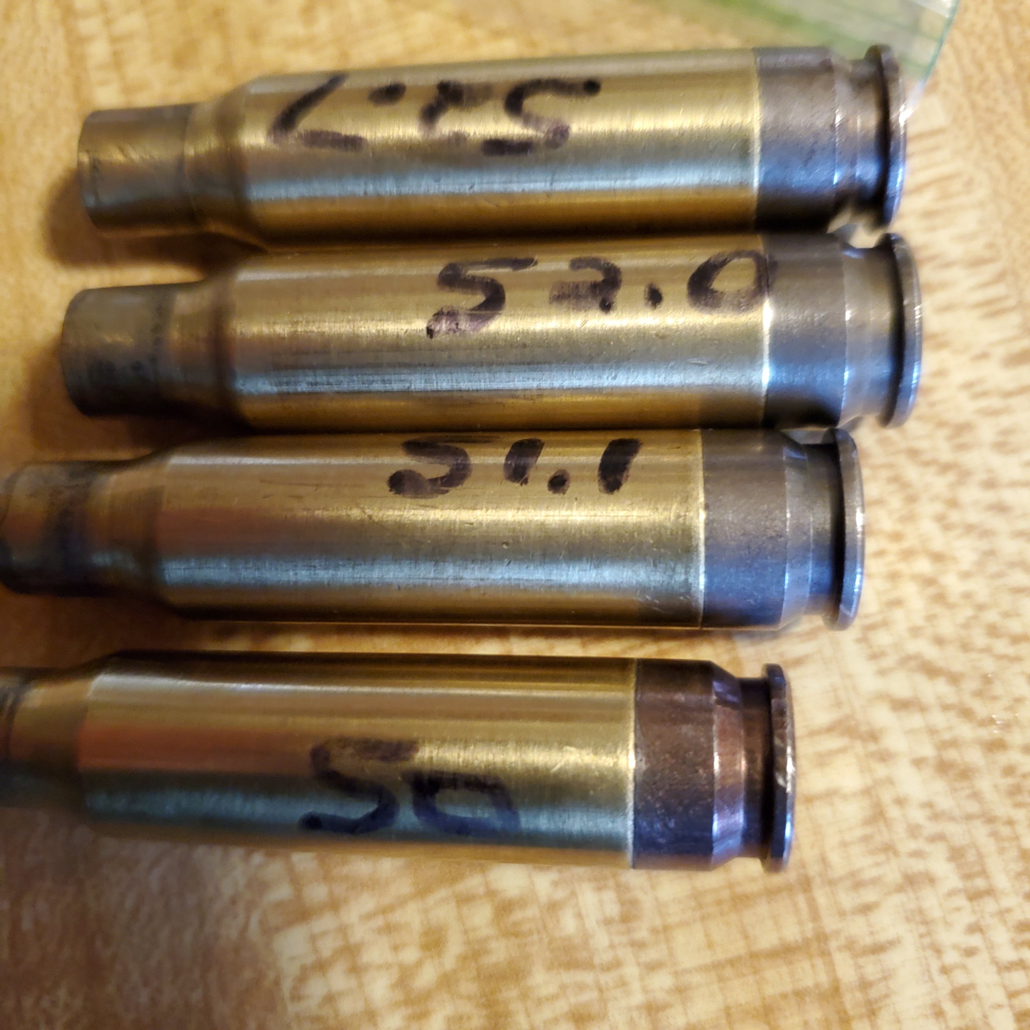

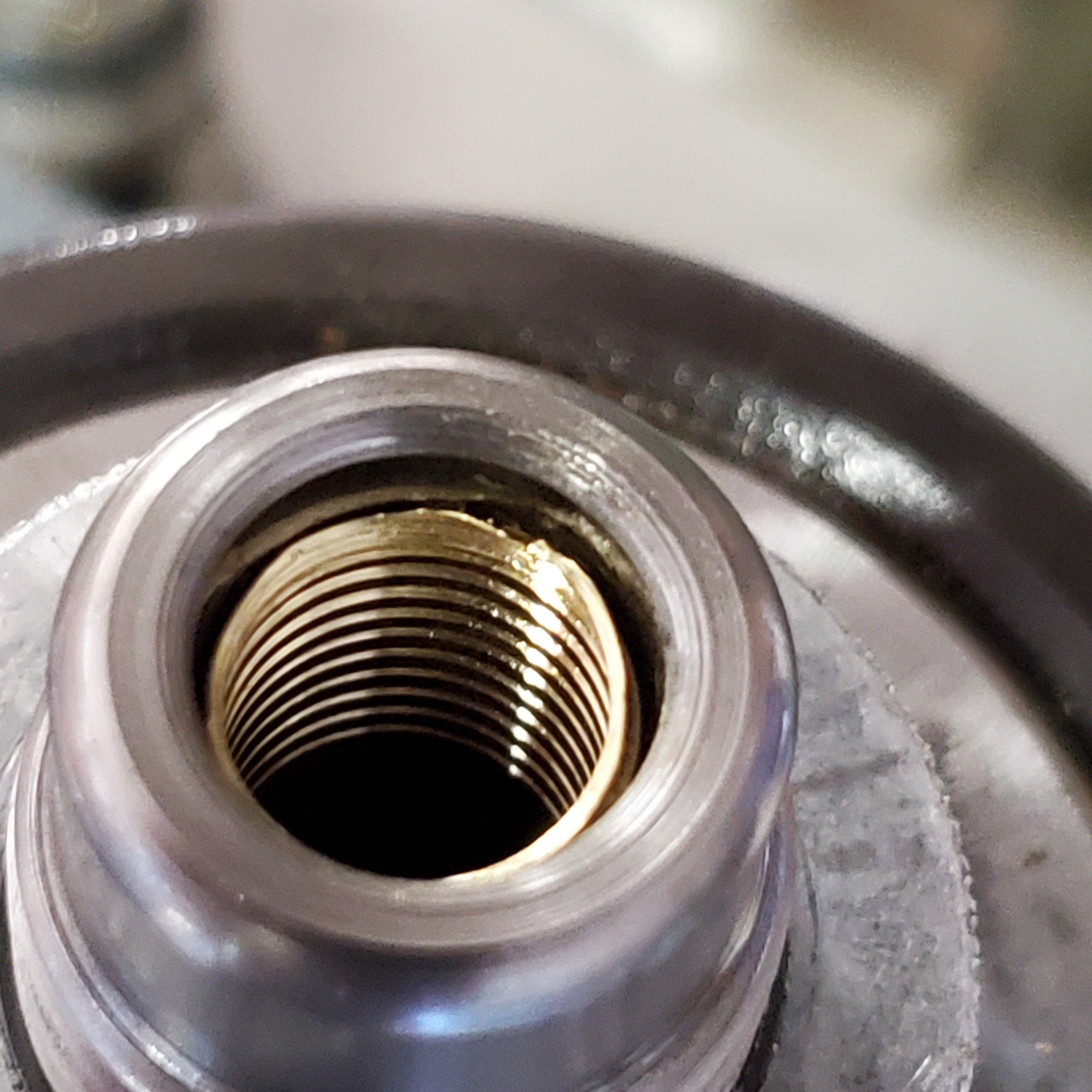

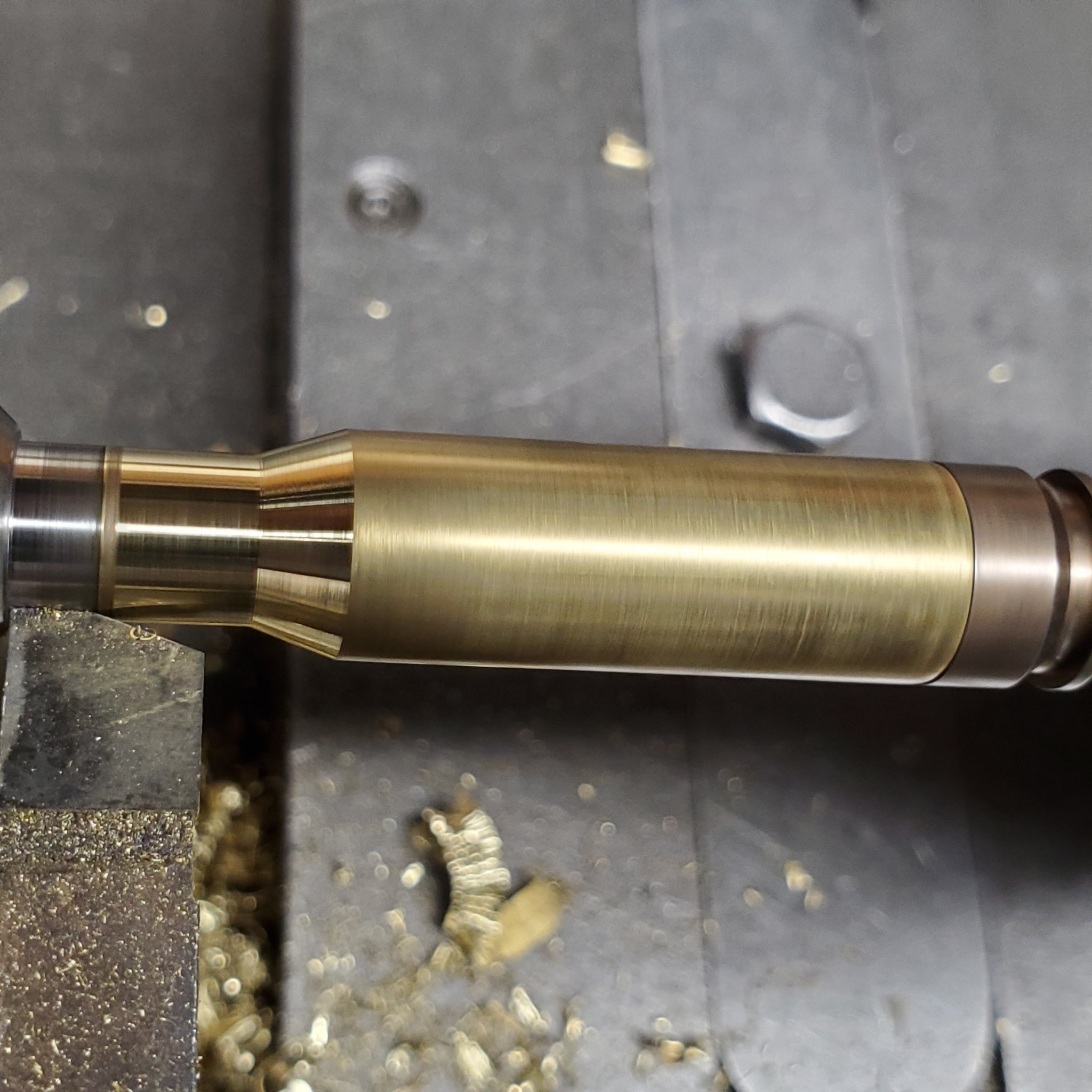

I get them through American Reloading, make sure ya get the hybrid cases cause sometimes both are in stock.
I have been reloading these hybrid cases for several years, in various calibers, just fired some today in 8.6 Blackout, with 350 gr Maker at 1806 fps, in a 6.5 Twist Only, no 3 twist that's limited to 1050 fps or the bullet comes apart, with disastrous results.
I have gone over the procedure and process of forming hybrid cases dozens of times on this site to those interested...everything from case forming, lubes, neck turning into the shoulder, or complete shoulder, annealing, to produce consistent cases with no pinch points...to stuck case removal, load testing, etc.
But it's scattered all over the site.
The few that are interested get drowned out by all the negative responses.... but others have taken the information over the last couple of yrs and applied it to their shooting endeavors...and are doing it successfully, and reporting back.
The thing is ya don't have to run the hybrid cases at max to see a nice improvement.
I have loaded some pretty zippy losds in hybrid cases 5 times and primer pockets still tight.
I have several thousand hybrid cases in different calibers,and not working on the 308 at this time, but am working on the 8.6 Blk, 338 Spectre, & 510 Whisper calibers.

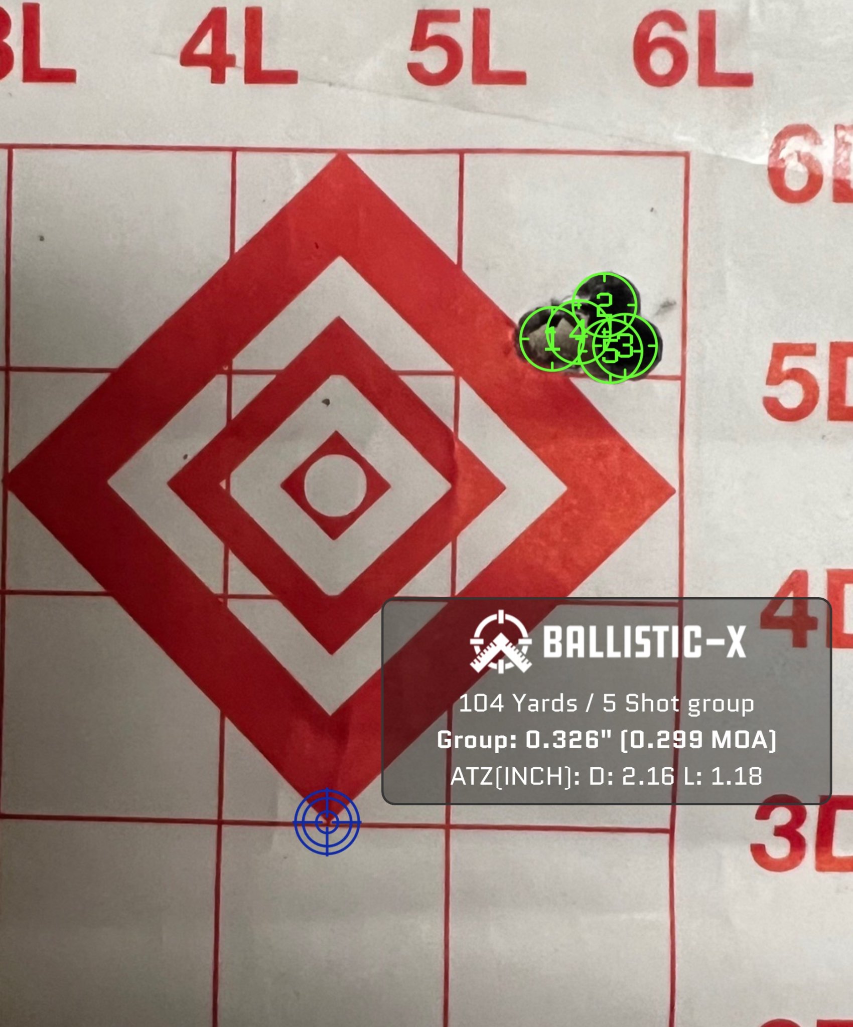

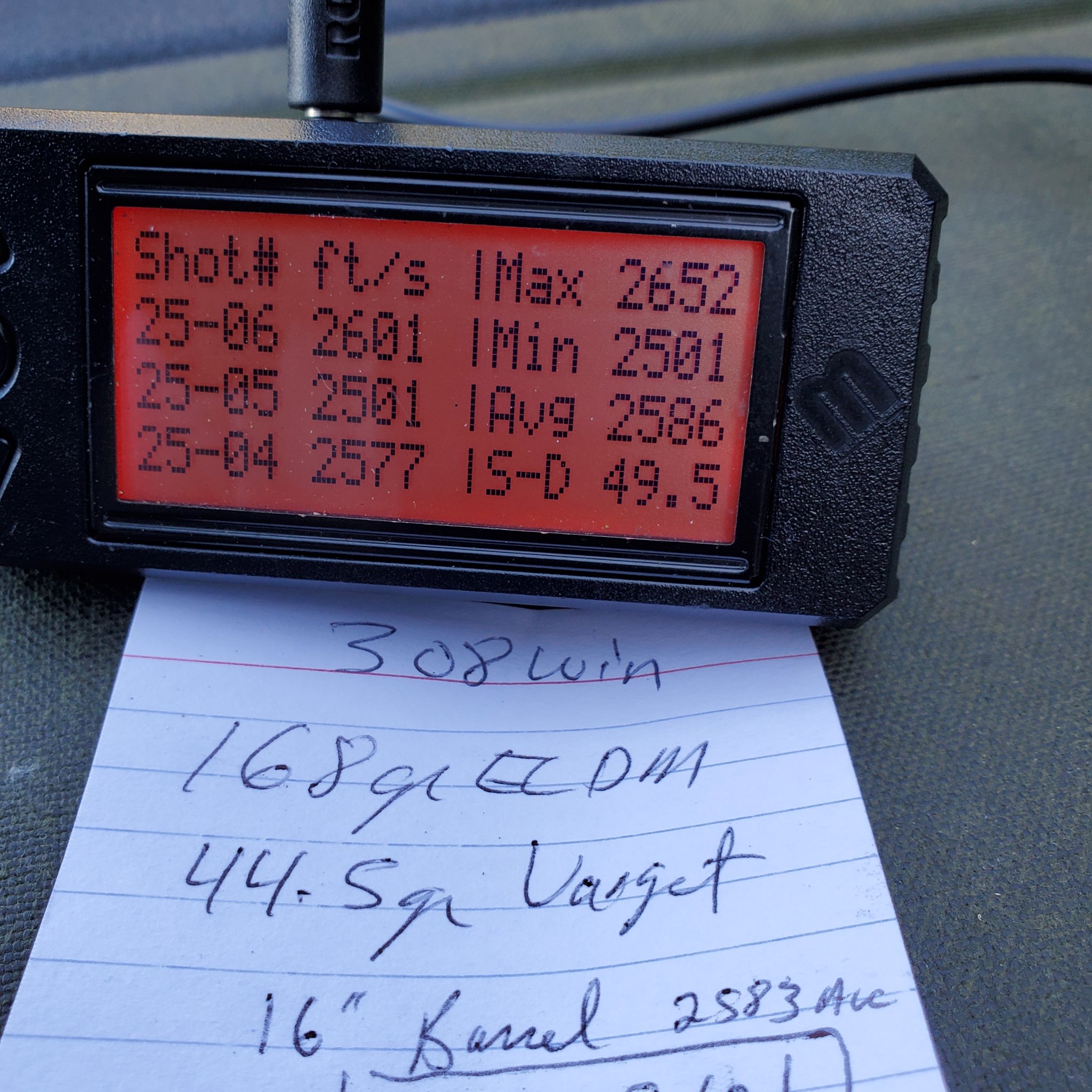

Settling in on a load I like for the M1A. Short range test (300 yards) , shot a 2.5" 10 rd group in unfavorable conditions. 2 degrees and very sunny but no wind. Mirage was so bad I could barely see the outline of the red circle.
Berger 175 OTM
40.5 grs H4895
CCI BR2
Virgin Lapua Brass
2.820 COAL

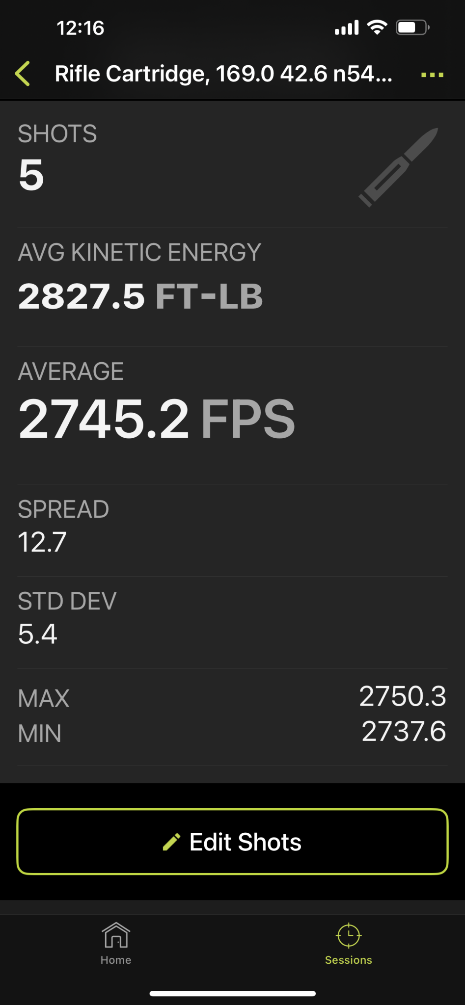

Loaded up a series of five charges of N150 pushing the 168gr TMKs increasing in .4gr increments. The intent was to find max. This group is the result. It measures .31”. Looks like I could pick any of those charges and have a great shooting load. Though the burn rate charts show different, in my .308, N150 seems to have a burn rate nearly identical to Varget.
John
Good info. What velocities were you getting and what charge weight did you go up to?
Reactions: XP1K
After checking my target, I just realized that I screwed up in my post. The powder WAS NOT N150 but rather StaBall Match. Edited to correct.
I have been using N150 quite a bit though, and it is nearly a grain for grain match for Varget in my .308.

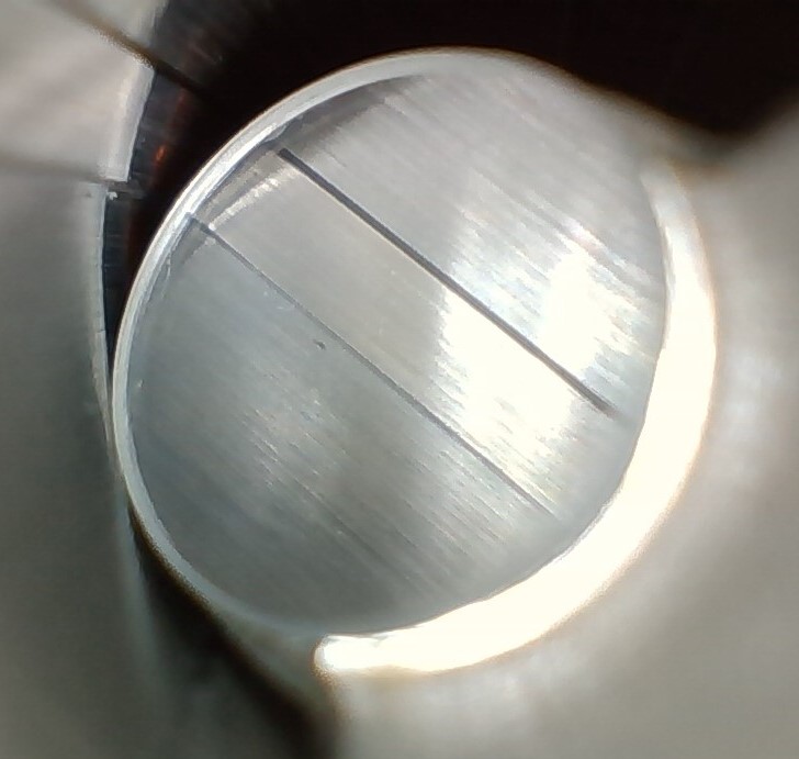

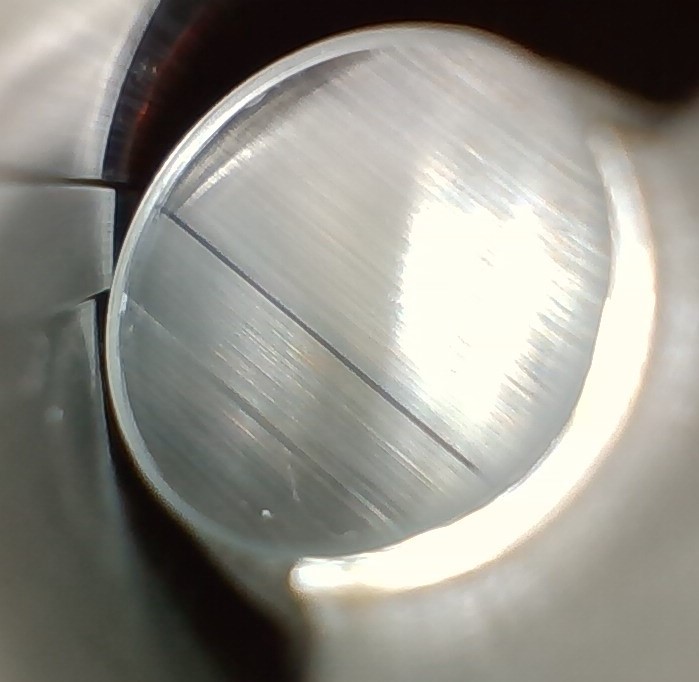

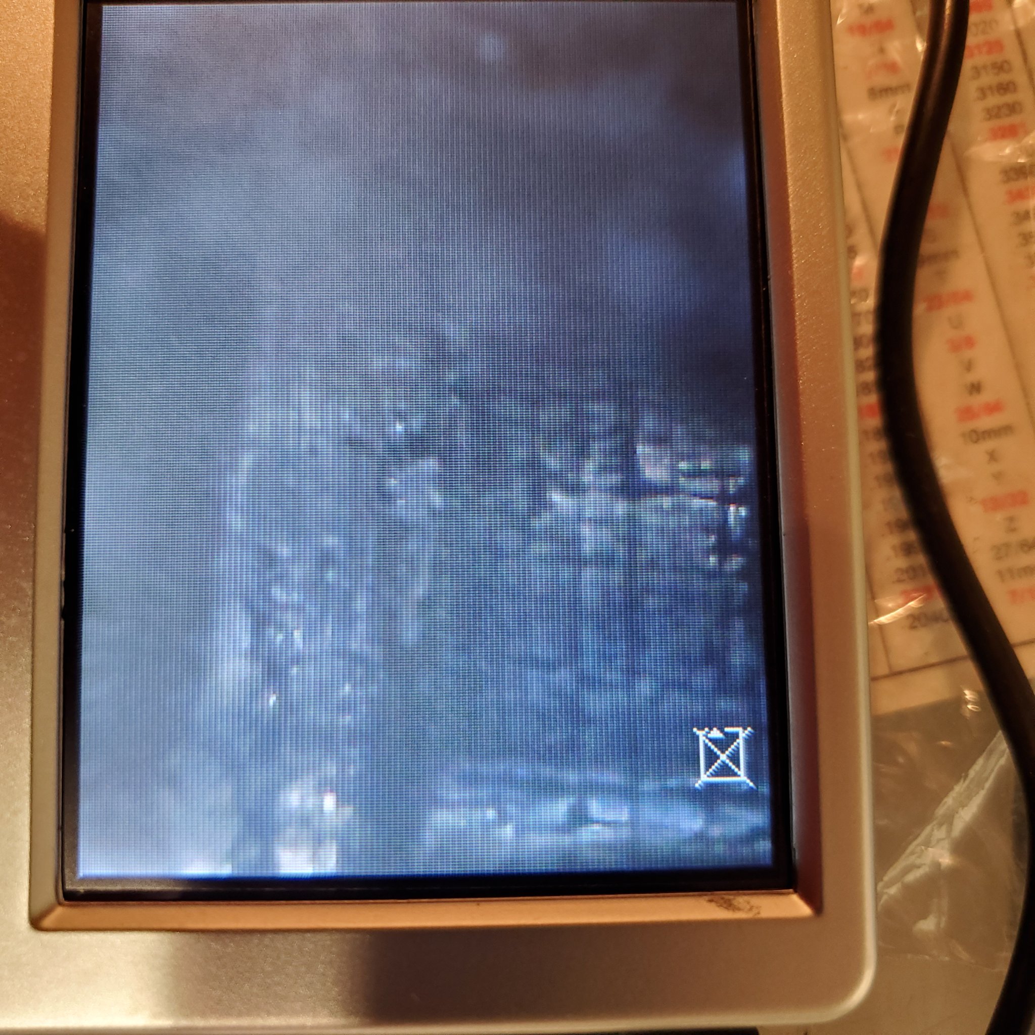

Here's a couple pictures of my Krieger barrel after a session at the range, I was struck by how it left what looked like just a light powder coating in the bore (am still looking for the Varget bore pics):
This is what that bore looked like after cleaning:
Compared to other powders I have used in my .308, Varget leaves very little residue and is much easier to clean the barrel than locally produced powders. Of it wasn't as expensive here, that would be all I would use. Unfortunately we don't get AR-COMP this side of the pond, but I doubt it could be better and still propell a bullet out the barrel.

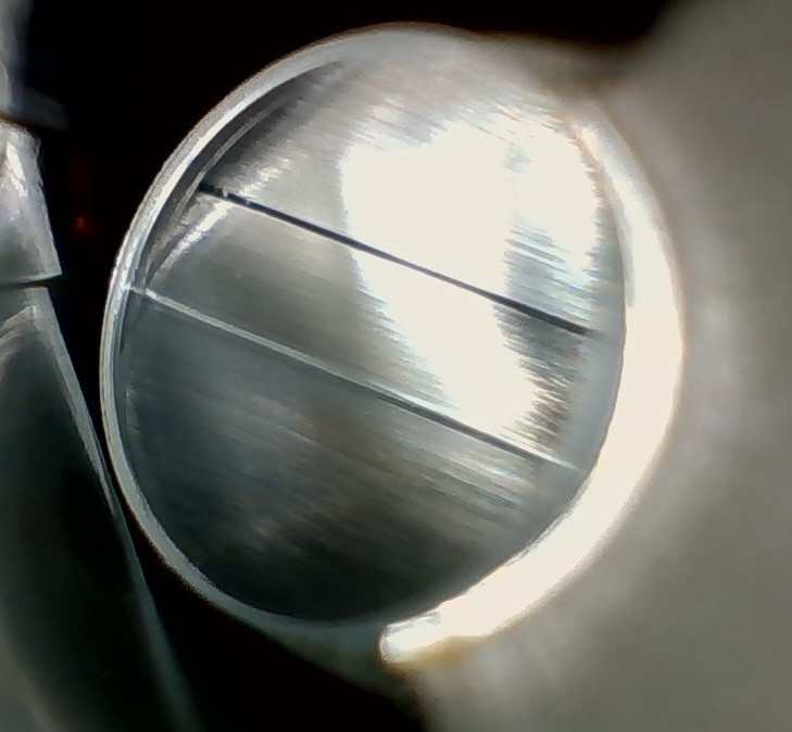

Here is a 308 win barrel with 8000 rds on it using Varget powder only.
It was still shooting pretty good, but I changed 308 barrels every 8,000 rds, back in the day with lots of LR shooting at 1000 yds mostly and quite a bit at 1400yds.
I Don't use Varget much these days, but it still has application for average velocity loads, with accuracy.

Well there is your problem. You use a bore scope. lol looks don’t equate to accuracy.

I took the above 308 Win barrel with 8000 rds of Varget and 155 Lapua Scenar bullets with a bunch of firecracking, and cut its 26" length down, then cut off the chamber.
Which took most of the firecracking.
Re chambered the 8000 rd 308 barrel to AR 15 barrel in 30 RAR, with used parts, like a barrel extension, gas block, profiled the barrel, gas journal, drilled a gas port, etc.
Put it all together and it's now a 30 RAR in AR15 shooting 155 grs Lapua Scenars with excellent accuracy....just like when it was a 308 but using H335 .
The point is one can repurposed these 8000 rd barrel and they can have excellent accuracy for another 8000 rds. Incase anyone is interested in that endevor.

I have used Varget in 308 with a lot of success over many years....
But it was the worst powder ever tried in a 16" 308 AR 10.
The S/D was 49.5 over just 6 shots with Varget being absolutely the most inconsistent powder ever tried in this rifle horrible stuff in this case.
  • Wow
Reactions: Zebulon and ColinW
