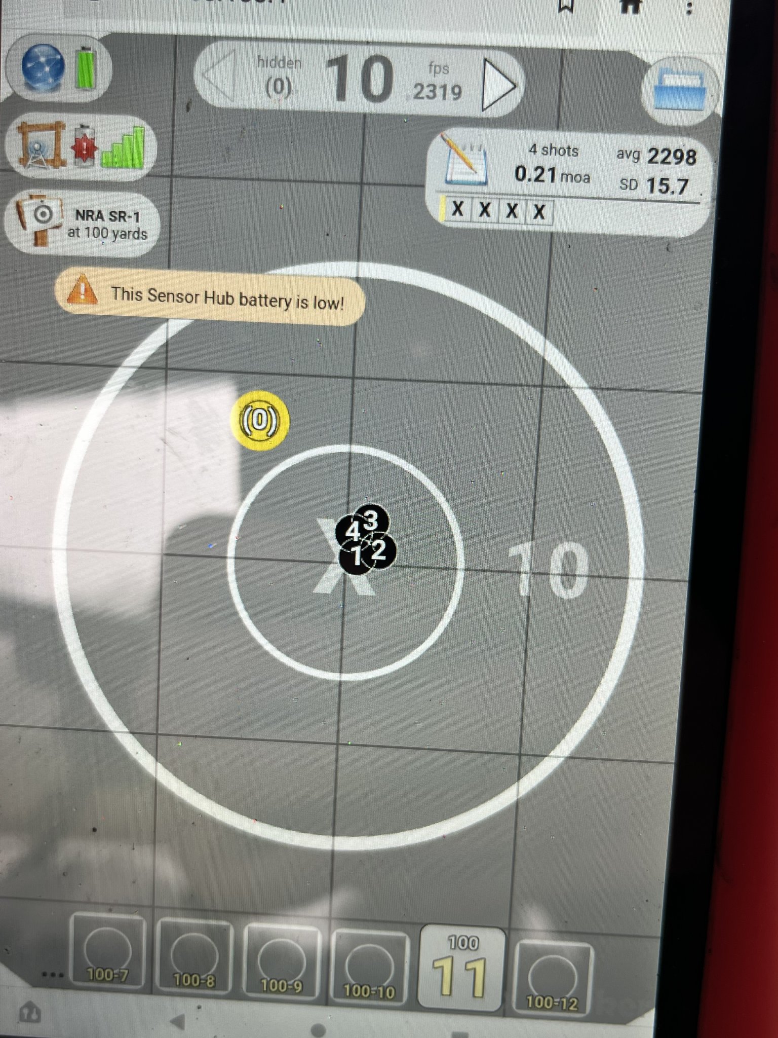

Checked zero on the XM3 with the 168. 10 shot group was kinda meh majority of the 8 shots were okay. Then fliers. I’m like half a mil low from POA. So I’m thinking I’m anticipating a little maybe. Adjust, load the last 6 rounds. 2 are perfect on top of each other and exactly at POA the next 4 are about half a mil high and roughly a 3/4 MOA group.

Last night, lol first thing my buddy suggested. I’m 300rds in as of yesterday. So i went ahead and cleaned it last night. Going to run some 175gr aac through it today. It’s been wonderful in my LMT thus far so i assume it should shoot in a bolt gun. I’m almost 100% positive it’s hornadys aeromatch 175gr OTM. I also have some basic 155gr amax that are loaded for my brothers 308. Might snag some of those

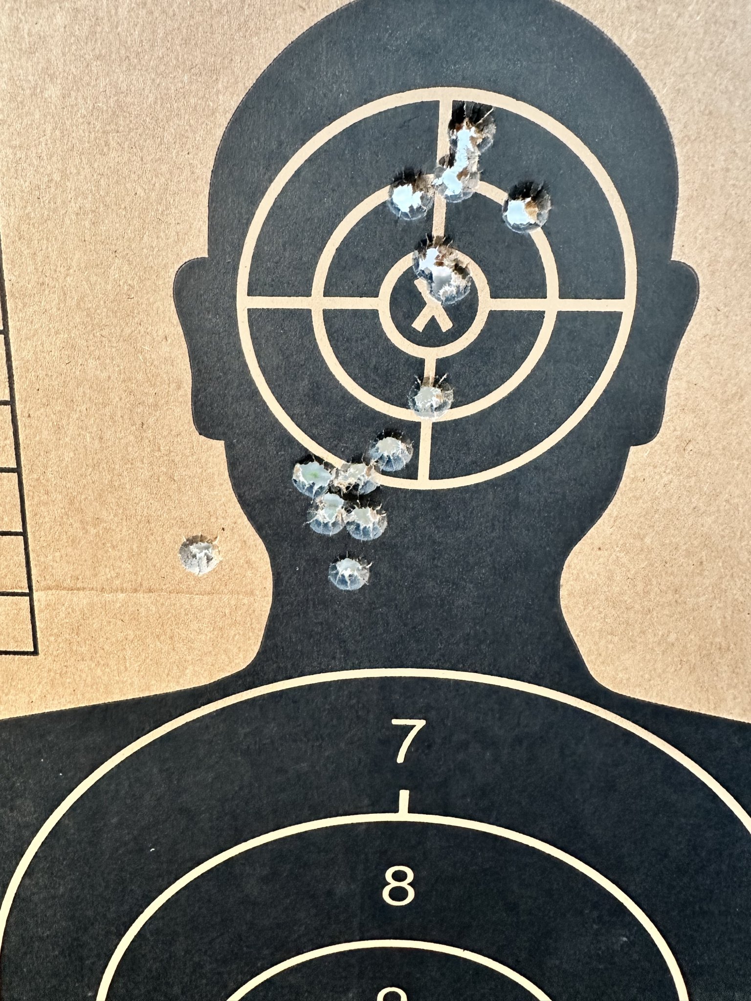

I forgot here was my LMT first 5 shot grouping with the aac stuff which again I’m nearly 100% positive that’s hornadys 175gr aero match bullet.

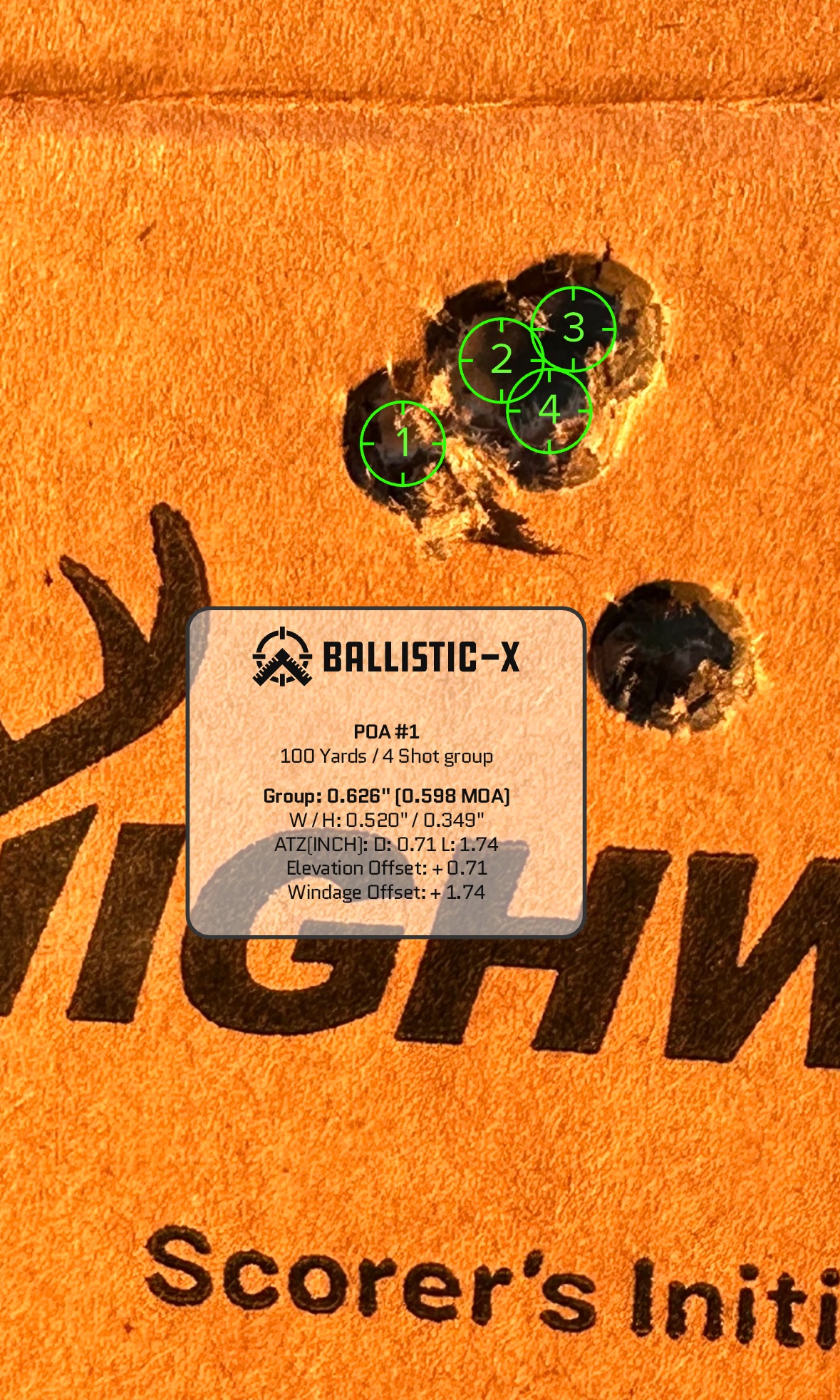

This was yesterday. 45.3 gr of varget was what i settled on. 10 shot group on the bottom. Then 6 shots at the X. I don’t have an explanation.

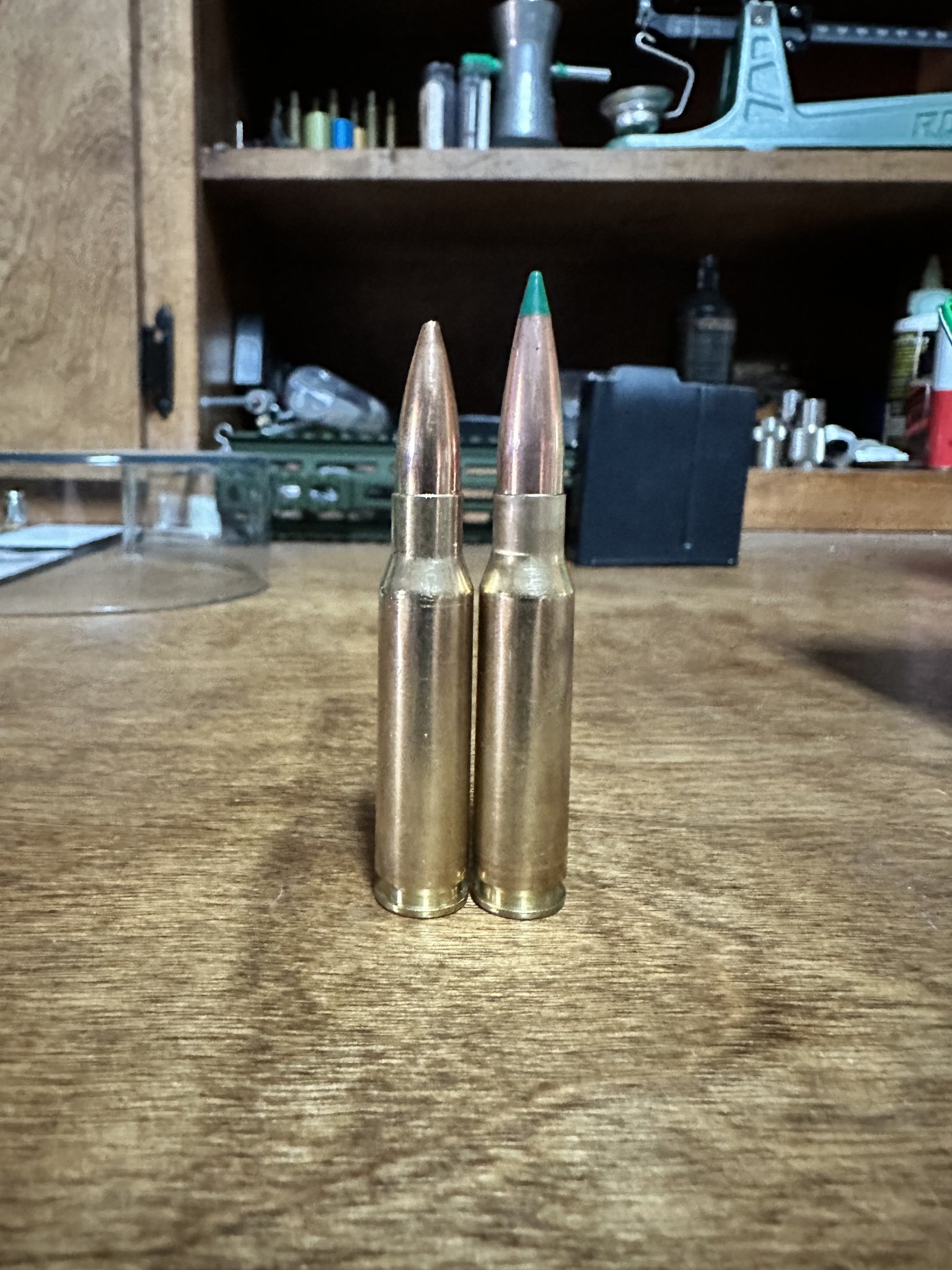

Yeah I knew they were super long. But i had my XM3 throated for the 168gr tmk which also very long. Granted I’m still limited to 2.970.
I’m not sure that it’s going to feasible in a semi. I also find it strange that there are no hornady factory offerings in it but all the other ELD VT have ammo available.
As far as load data pertaining to seating depth i have no idea. Google has turned up nothing.

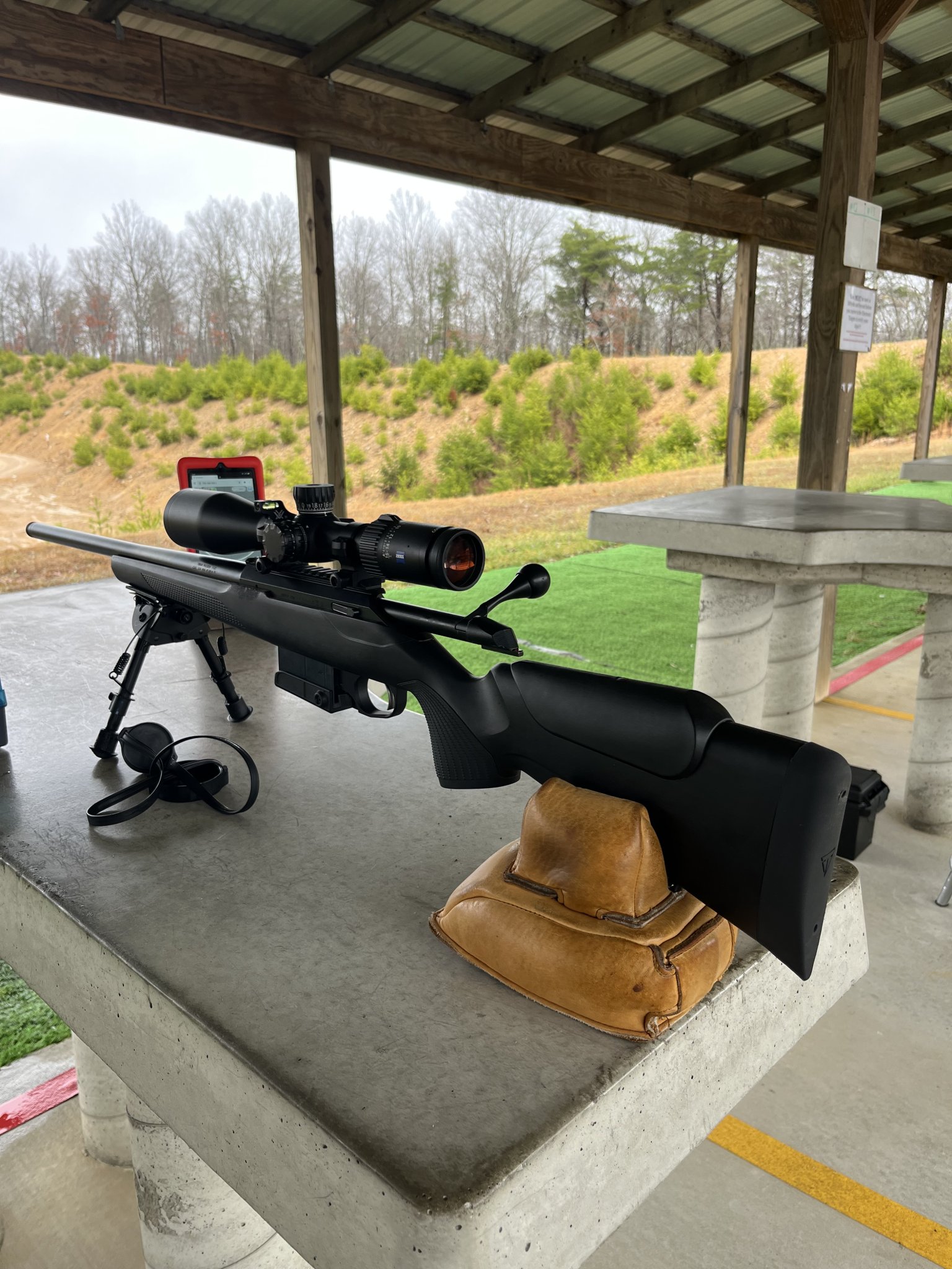

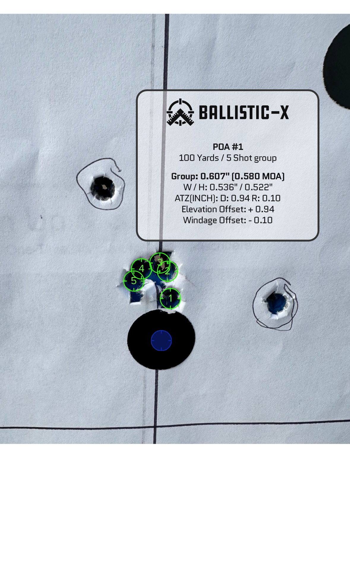

42.0 grains Varget, 178 ELDX, Alpha SRP brass and this Tikka 20” barrel CTR is most accurate rifle I own. Smooth 2517 FPS. No brake and no suppressor.
Frequently make it through the KYL rack at 600 yards.
This is primarily a hunting/range toy rifle.
Anyone got a Tikka 308 they would be comfortable taking game out to 500 yards.

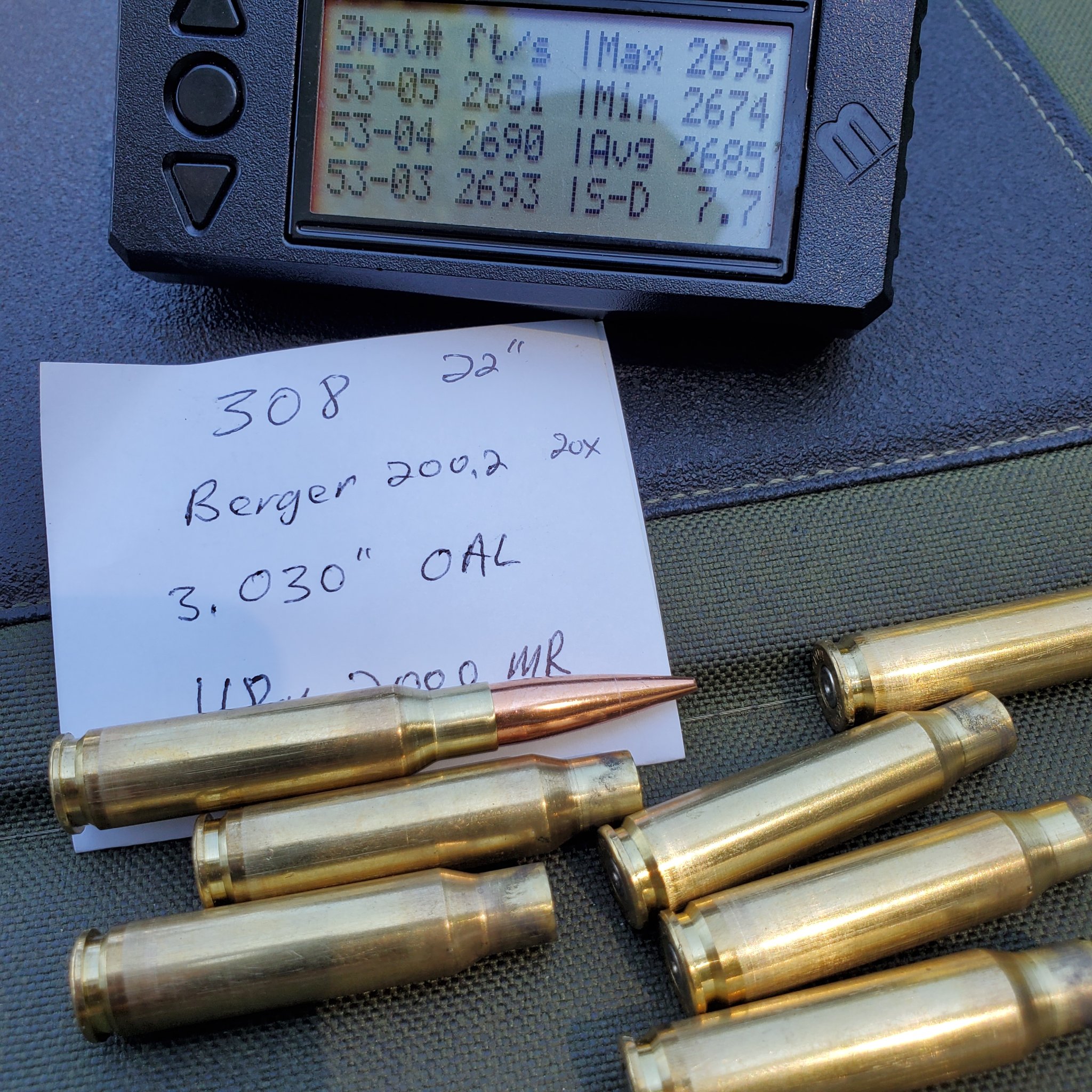

Get a 9 twist 5 R 308 22" Rem varmint contour, so it's fairly light in bolt gun, single load 200 gr SMK .715 BC 2740 fps...or put it on a long action...your choice.
Or get even more velocity use hybrid high pressure cases will easily beat the 6.5 CM, I shoot both calibers.
308 22" Rem varmint contour... single load 200 gr SMK .715 BC 2740 fps...

It's Totally true, here is the rifle and the chronograph, 22" barrel Rem 700 Bartlein 5 R 9 twist, a cheap build out of left over parts total cost less than $600.
The 6.5 CM would be hard pressed to keep up with these 308 22" barreled loads, add hybrid cases and add more velocity.
Even 230 SMK at 2510 fps in Lapua cases.
And with hybrid cases and longer barrel the 200 gr SMK hit 2951 fps in 308 hybrid cases...that's a fact.
