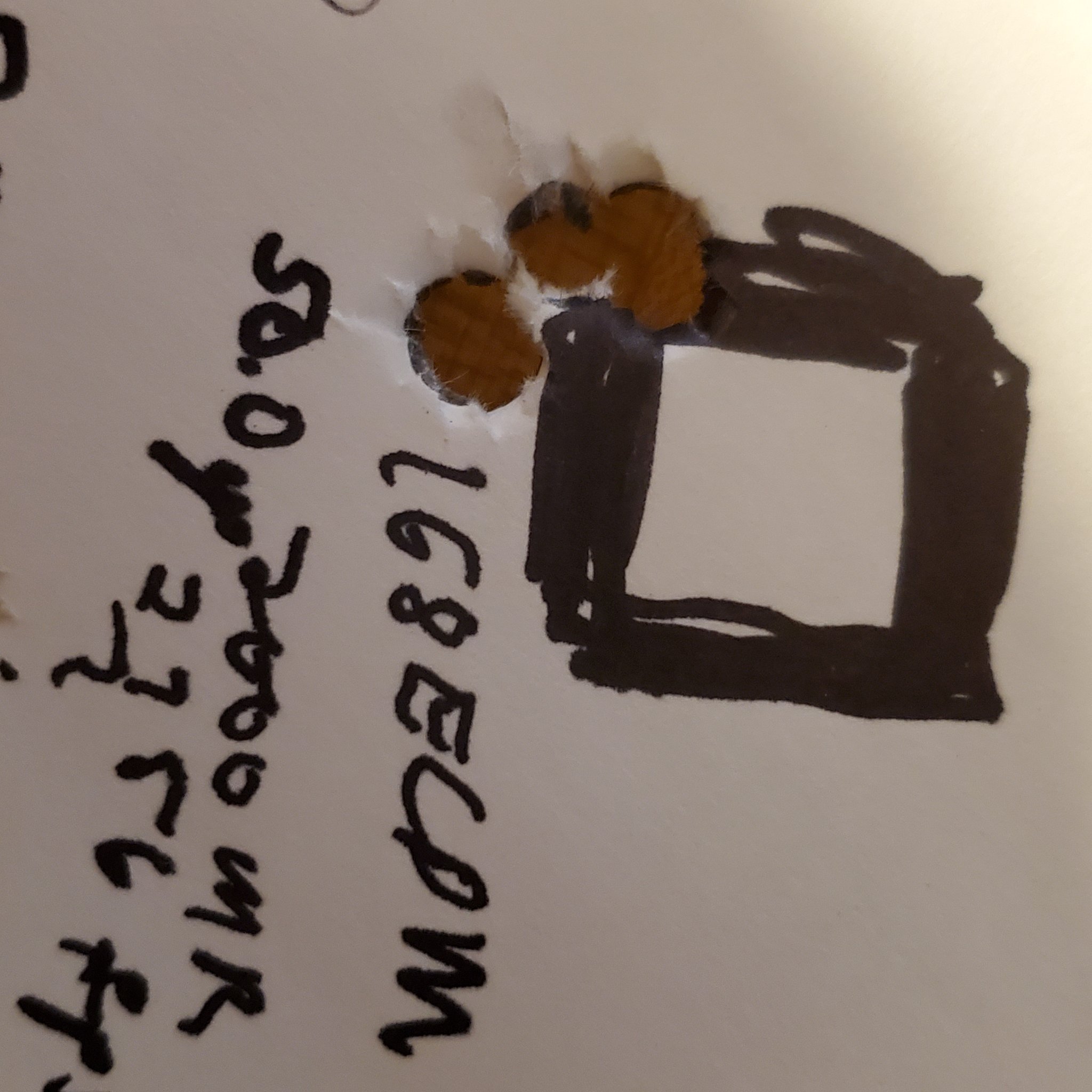

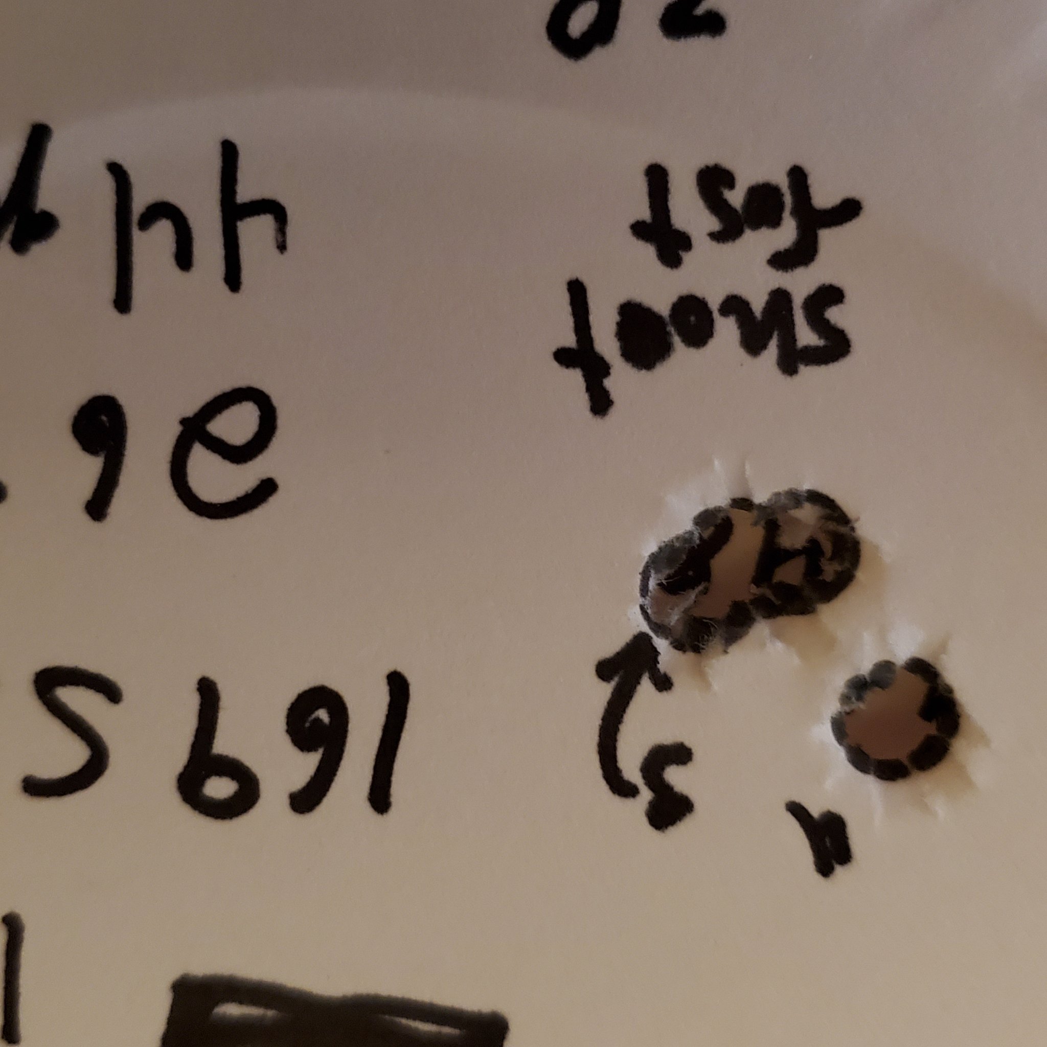

Just got done doing the sharpie method. If this isn't a clear indication of kissing lands, then idk what is.
View attachment 8443221View attachment 8443222View attachment 8443223
There's 5 total marks of paint scratched off. Pretty sure this rifle has 5 lands lol. Although there is a very very nice and blended brake that won't let me see the muzzle end to verify that. I have no idea how to remove it without scratching it. There are no wrench flats.

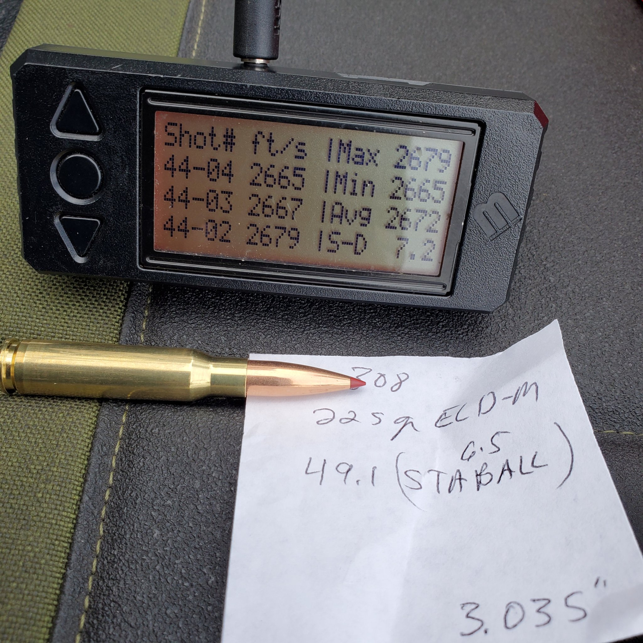

Considering I was running a LA 300 WSM and struggled to get 2675 with a 22" barrel and the 225 ELD, are you getting this kind of velocity with a 30" plus barrel?
Yes the 225 gr at 2672 average on this string was LA 30" Bartlein 5 R 308, with Lapua cases.
It shoots the 200 SMK 715 BC at 2856 with Lapua cases and over 2900 with hybrid cases. 230 Atip at 2620 fps in Lapua cases.

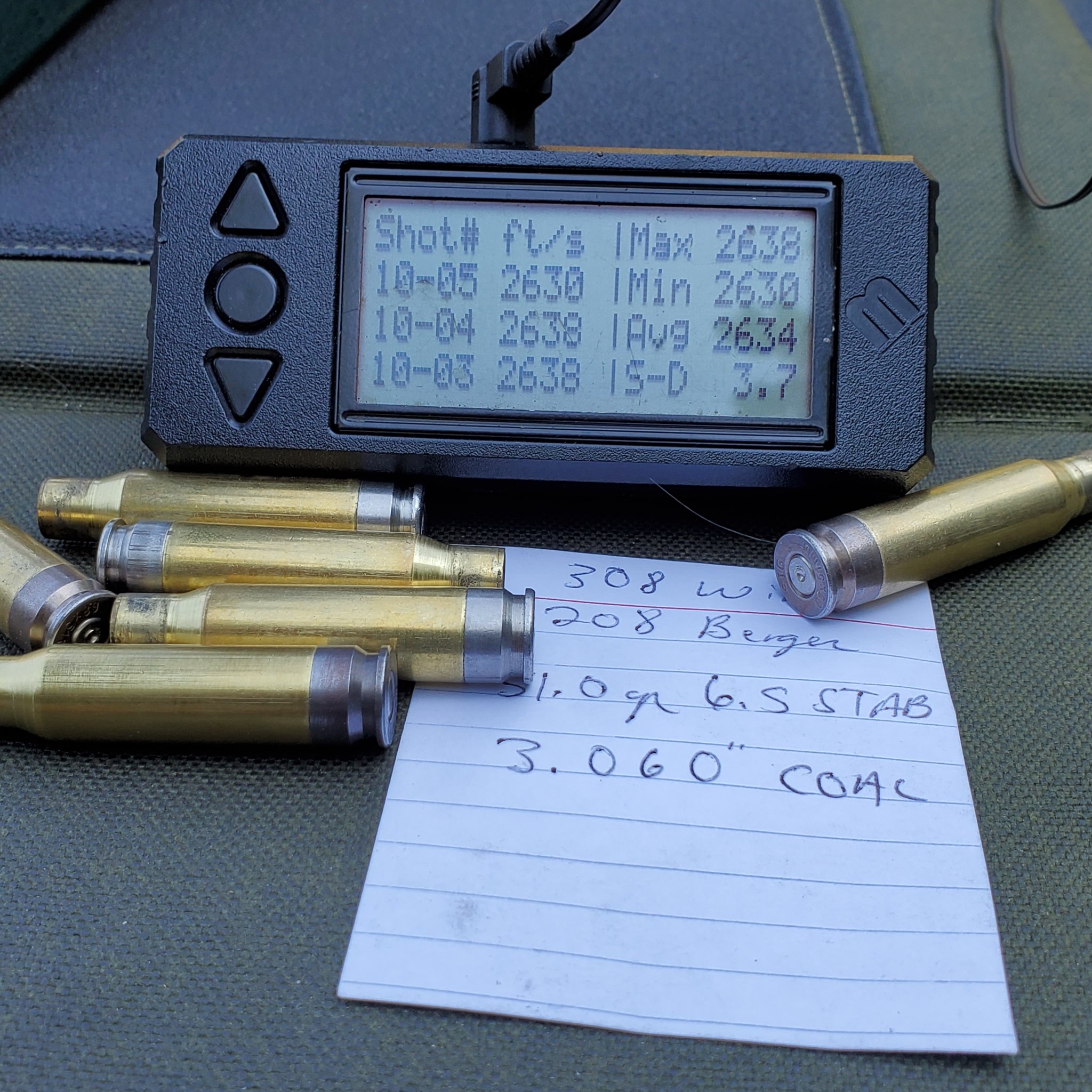

Just ran some 208 Bergers 2634 fps in the 22" 9 twist and 215 Berger 2600 fps just 2 days ago.

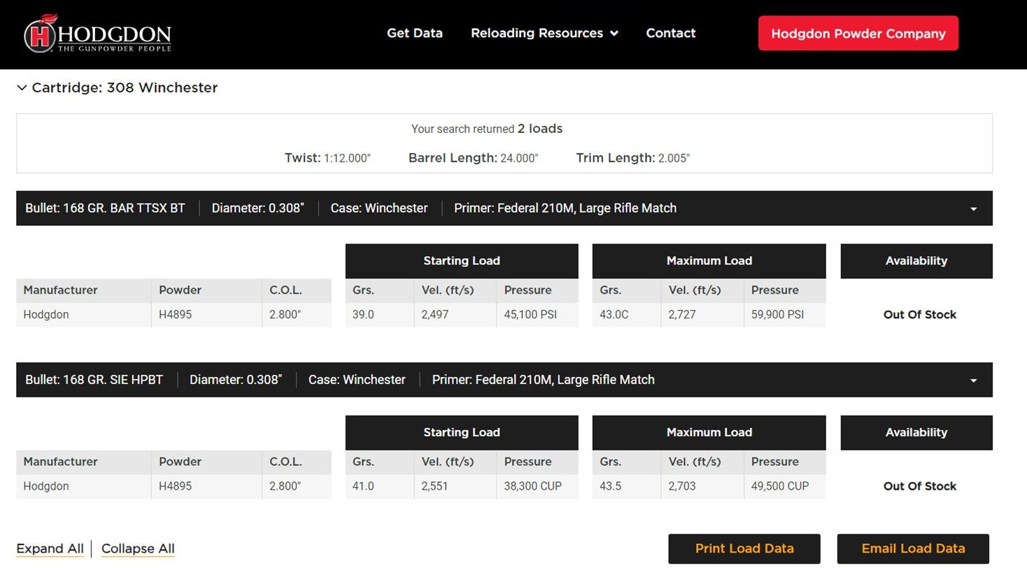

Anyone have any experience with N140, Lapua cases, and SMK 169? I’ll be shooting out of a 24” MRAD. I was going to use the 168s for 600 and under, 169s for up to 1k (hopefully) and 338 Lapua for greater than 1k
The 168 SMK is in the Viht manual...N140 start 38.3 gr Max 42.9 gr.
I don't use this powder, and have shot the 169 gr with accuracy in the 16" 308 AR platform, with different powder and my barrel was super accurate with 168 ELDM.
Thank you! I only have the newest Hornady manual and I was afraid the VV may not have the 169 data and I wasn’t sure how close the 168 would be. I greatly appreciate it sir!

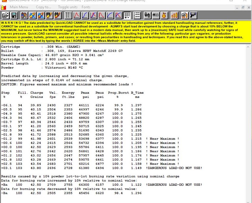

I don't have any direct experience with that, but I don't see any reason why it might not work for you.
Your velocities most likely will be different from what here:

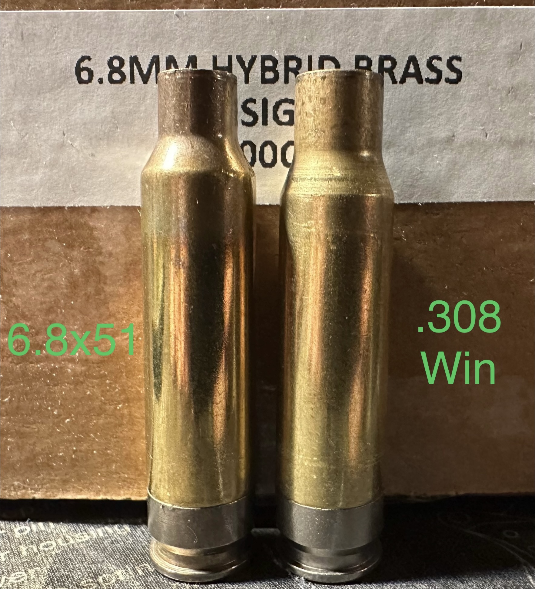

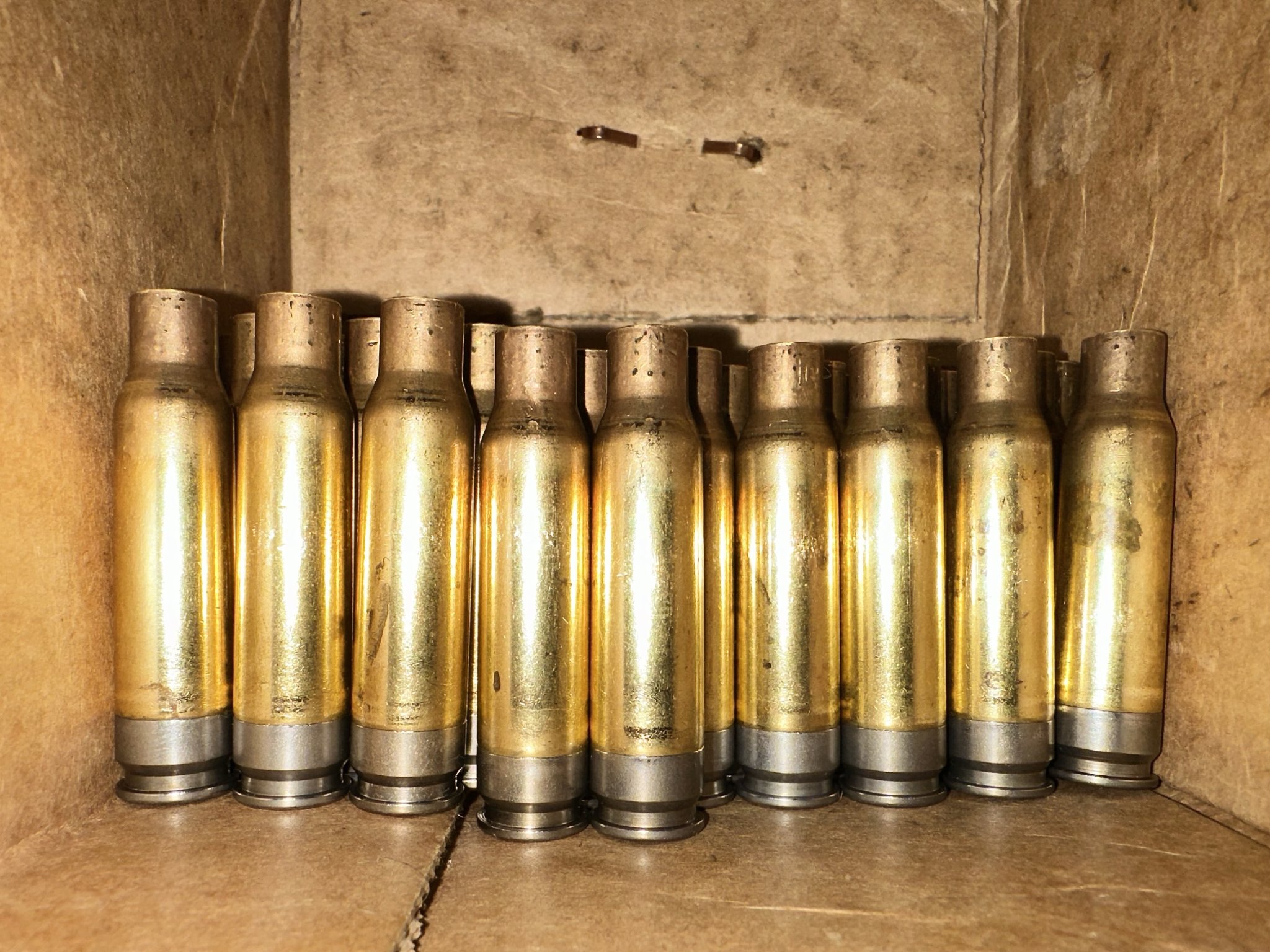

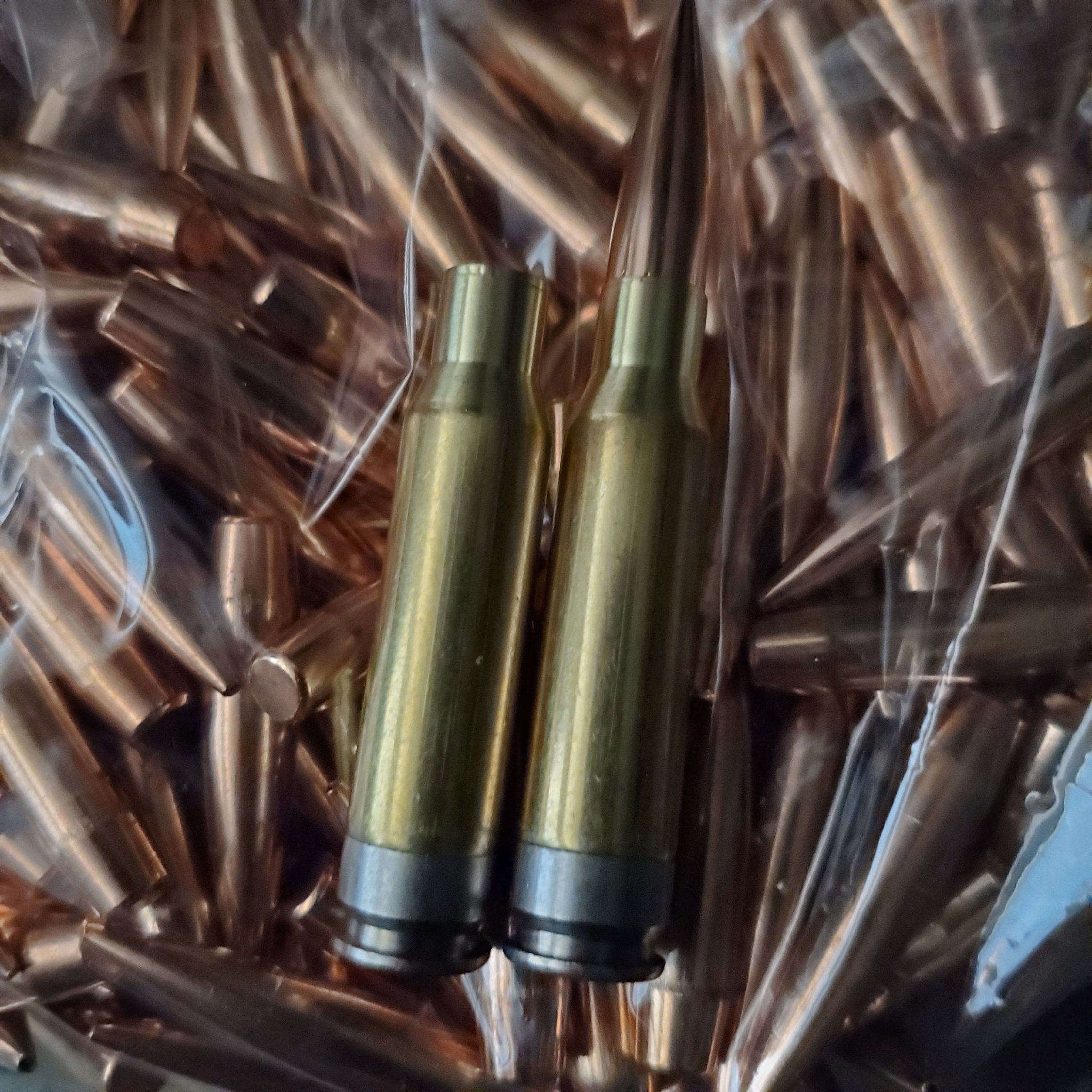

Just finished fire-forming my reformed SIG 6.8x51 Hybrid military cases. Got some new tear down cases with primers still in them for SUPER cheap. I reformed them Friday night, and then loaded them up yesterday. Went and shot them today, and will clean and polish them when I get ready to run another batch of brass in the US cleaner and tumbler.

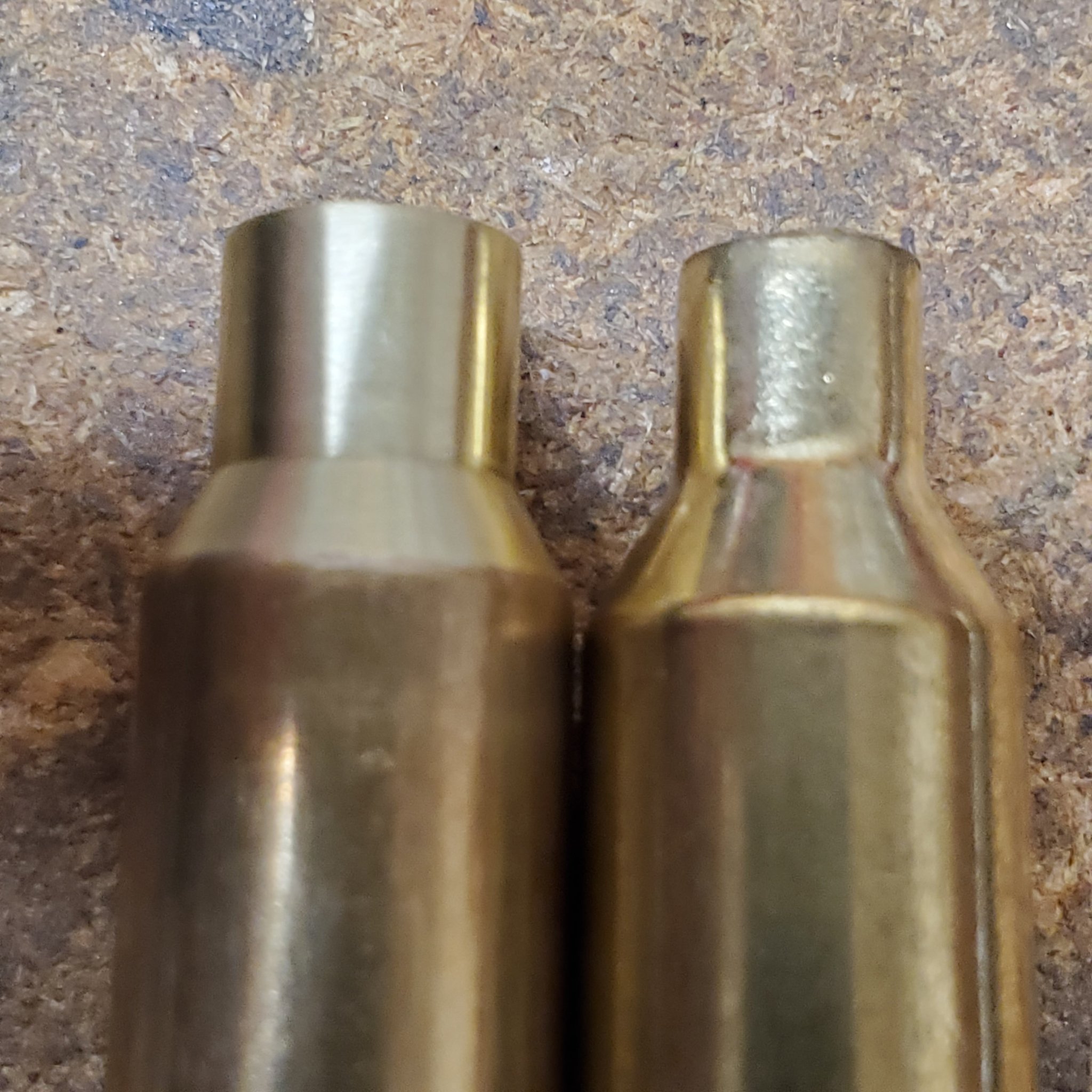

Here they are after pushing the shoulders and necks back and reforming them for .308 Win. It's not a simple 1-step process to avoid the donuts or getting lube dents in the necks, so you have to use a body die and size down the case, then mandrel the necks to .30 caliber, and FL size them.
I lube inside necks, then mandrel up first.
Size with the FL sizing die, don't lube where the neck is being formed.
Neck turn, and body die.
No dents, no donuts.

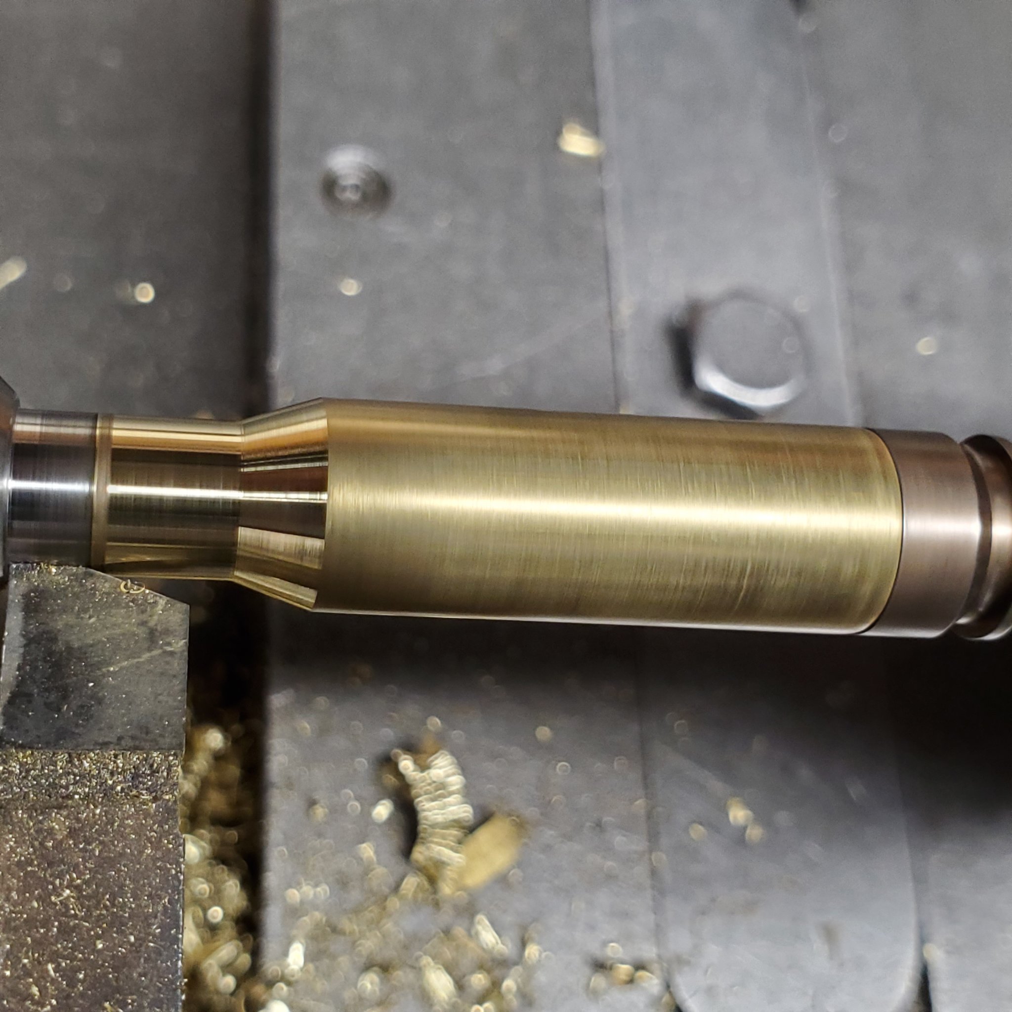

Here is the lathe neck turning operation.
It cuts the full 20° angle of the 308, but notice the sharp angle at the neck / shoulder junction. This takes away donut material.
Here is a loaded 308 win 215 gr Berger from the neck turned case.
A better close up of losing the donut.
This formed 338 RCM case necked from 6.5PRC ...note the neck/ shoulder junction sharper angle of the newly formed 338 RCM against the factory 6.5 PRC.
I always cut it completely, neck, radius and shoulder angle...cause I have a lathe.
But hand neck turned into the shoulder will accomplish most of what is needed.

When powder manufacturers list a load amount for a particular round are they using a cartridge made for a magazine? How would the load amount change with a longer CBTO? I'm new to this so it might not make sense.
I guess I used the wrong terminology. Not using the mag, just single feed.
When you look at powder manufacturers page of data, how the cartridges are loaded is usually listed at the top along with COAL (C.O.L.) with the barrel length (often 24") for velocity reference purpose. They do not list CBTO since everyone's chamber can have a very different freebore and different comparator inserts have various diameters. Like what you see here on Hodgdon's website.
So back to my question. If the bullet is extending further into the chamber and leaving more room in the cartridge can the powder load be increased safely?
Yes. But when doing that you'll want to do it in small increments, starting well below the powder company's maximum recommendation (like ~10% below) and monitor for pressure signs as you increase powder charges.
