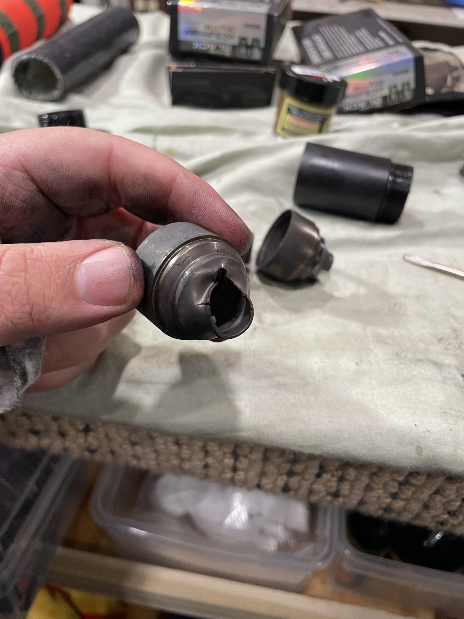

I don’t think the Obsidian 45 can handle 45 Raptor. It can barely/not even handle 450 Bushmaster. I was out shooting mine yesterday out of a 16.5” barrel shooting Bear Creek Ballistics 240gr 450bm chrono’d at an average of 2515fps and it crushed my front baffle like a pop can. No damage on any of the others

Technically I was well within the limits of 16” + barrel length for 450bm. I just doubt they tested it with 450 ammo loaded up like that. Oh well, I’m sure Rugged will take care of me, they’re a solid company. Thankfully no wall explosion or nothing else happened
Do you think it was a pressure issue or a stability issue?
Pressure. There is no visible baffle strike from what I can tell. Unless somehow it struck the first baffle but not any of the others which would be odd I would think.

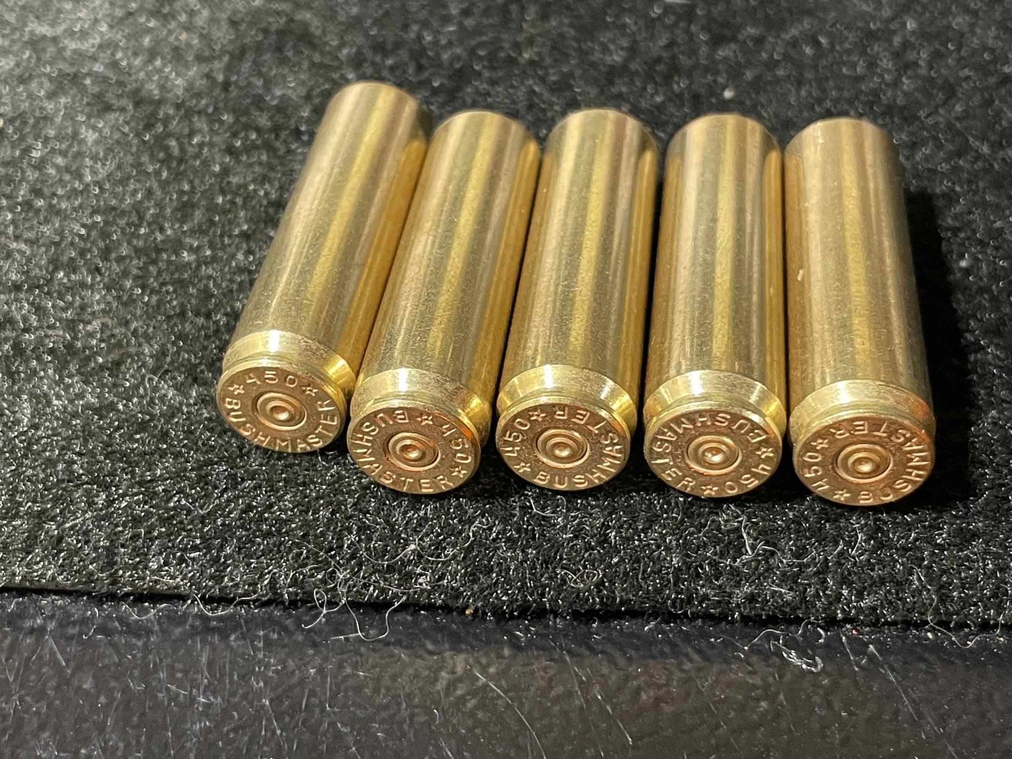

Lol 3050!! Dang! That is smoking! I don’t believe in having pressure signs. I’m not a reloader so honestly I have no idea. Here’s a pic of the spent brass. They all look like this roughly. View attachment 7730691
those are overpressured, the prime is flowing back out, not good
Hmmm interesting. So probably should not shoot any more of it ehh? I wonder if everyone shooting this “factory” ammo is having overpressure signs but just not aware of it. I sent an email of the pic to Bear Creek Ballistics to see what they have to say.

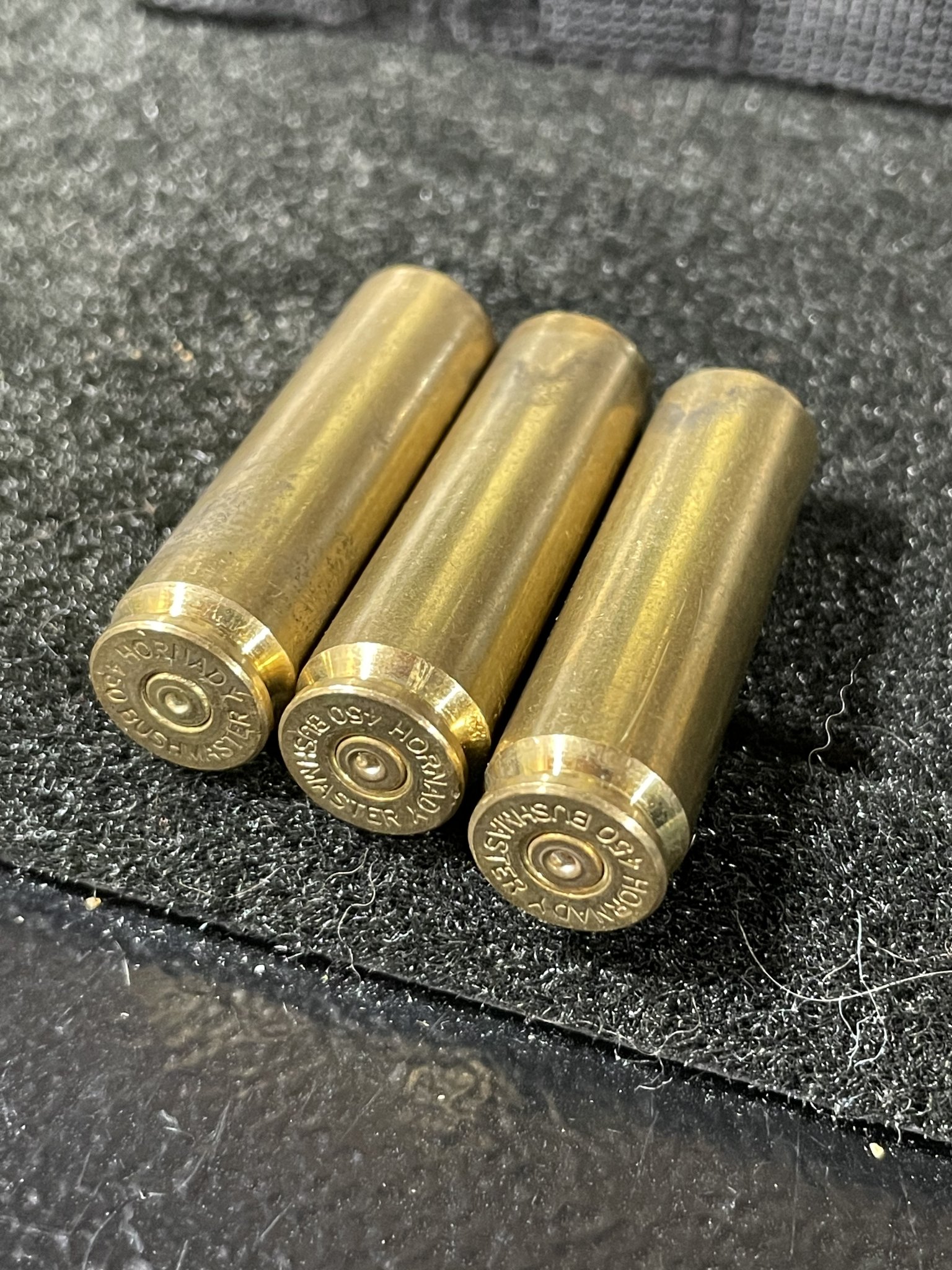

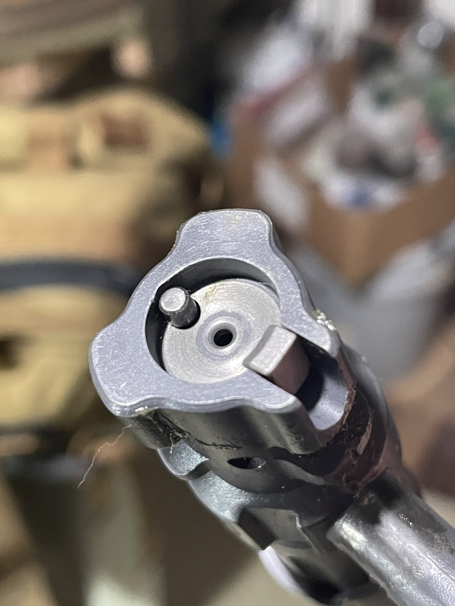

@Adam B @stello1001 so I shot some standard Hornady 250gr FTX loads and noticed the primers doing the same thing. I think the chamfer on the bolt head is too large. Going to do some groups with in next week to see if it’s effecting accuracy any. The Bear Creek ammo definitely is protruding more but the Hornady is still protruding a smidge
