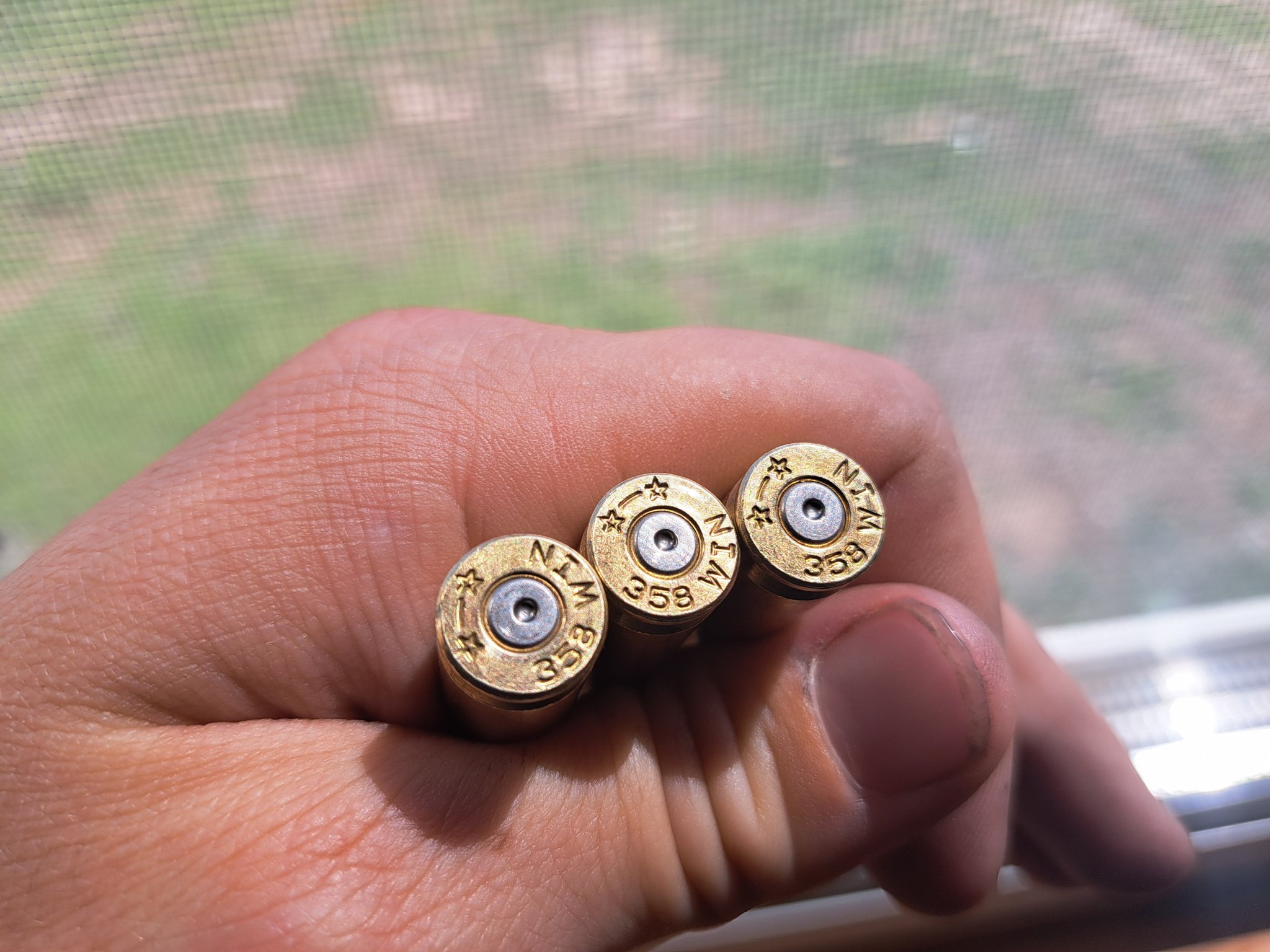

Starline 358 brass with CCI BR2.

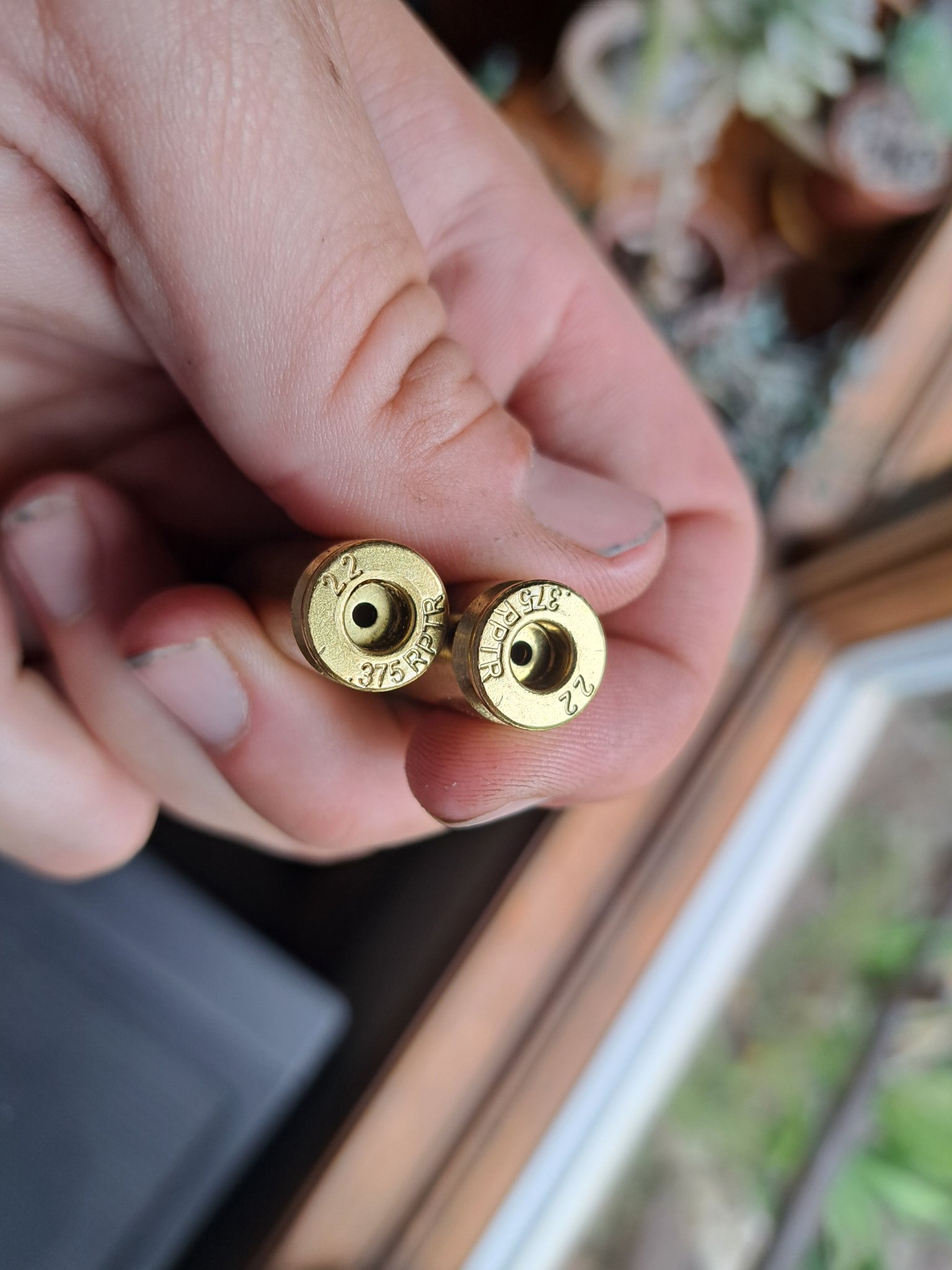

The minimum Starline will do is 50,000 cases and there's an additional retooling cost. (In this case the retooling cost would already be covered.)
They don't mess with trying to sell wildcat cases in small amounts, which is understandable.
Just curious, how many cases would you be willing to get if you could get any quantity?
They are headstamped 375 Raptor.
Ever get that order off I am good for 5K units, I have talked with Starline as well

Somebody correct me if I'm wrong but shouldn't 358 Rem data be a good start for 200 - 250 grain supers?
Can't find anything on 358 Rem. 358 win perhaps? Hard to believe you can't get a download of Quickload. I'll have to rummage around my PC parts bin to see if I have an external CD drive.
