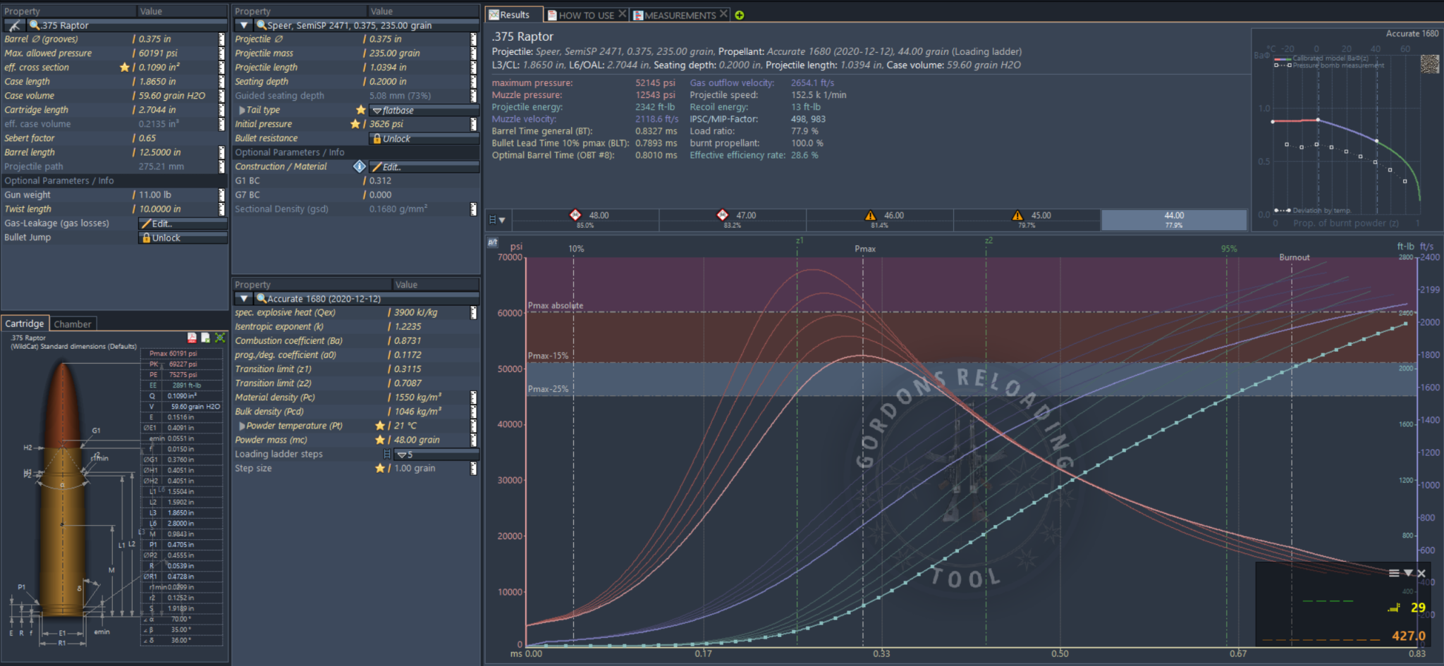

Anyone have quikload or versed in GRT able to do a sanity check for a recipe I received? This is more academic to be honest, but I'll definitely give it a shot assuming it is possible and within reason. Supposedly not a compressed load
375 Raptor
Bullet 235 Speer hotcor sp
Powder H4350
Start Charge 60
Max Charge 65-67
Expected Muzzle Velocity: 2,550–2,650 fps using 12.5" barrel
Estimated Muzzle Energy: ~2,900–3,000 foot-pounds
yeah...that sounded a bit out there. charge weight can vary based on powder type though. Right? I didn't think that much would be possible. I also know there are a lot of people on here with far more knowledge than I have and thought it couldn't hurt to ask!
That would be greatly appreciated. Thank you

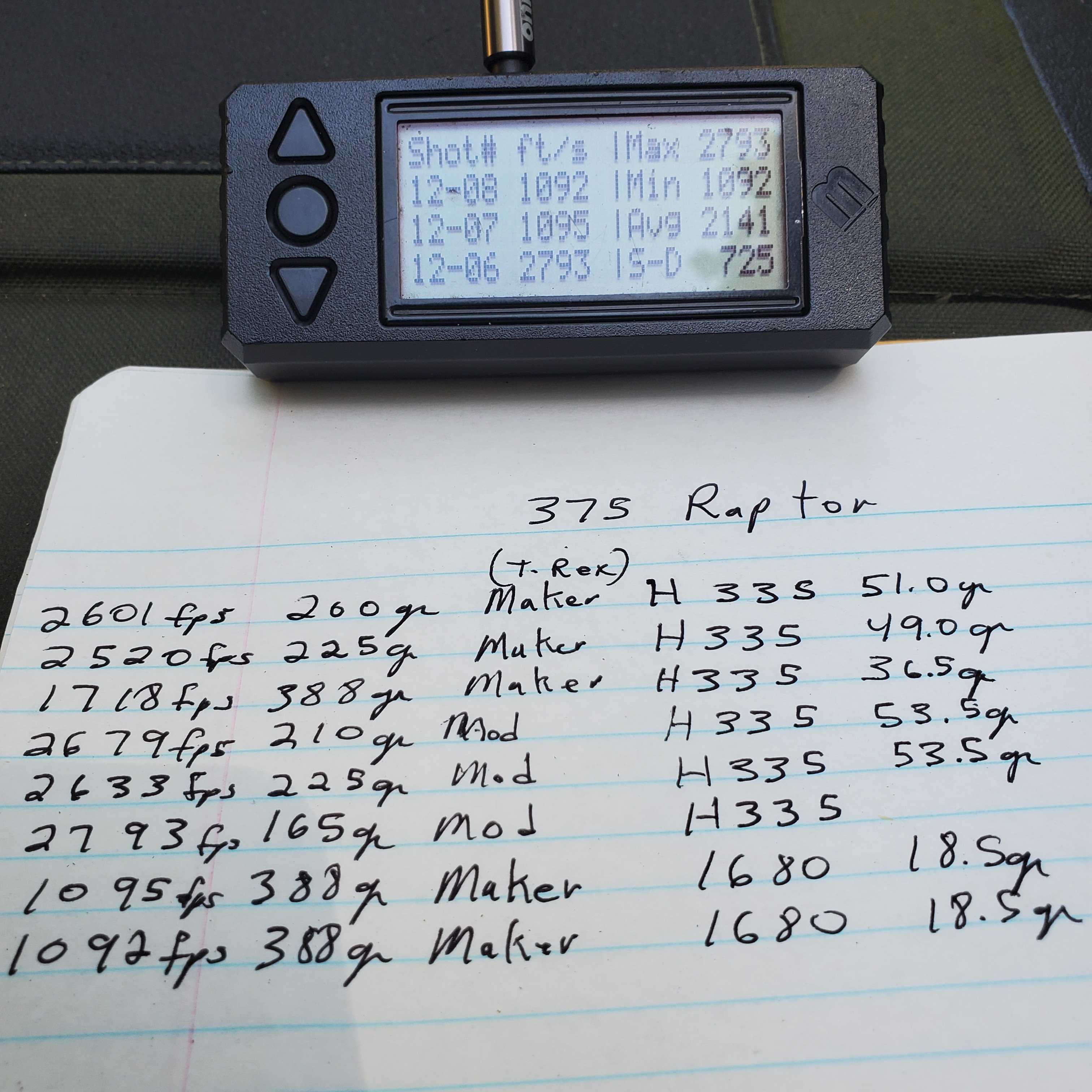

Powder / Bullet / Primer Velocities
38.5 gr SBR SOCOM / Maker 175 gr. TRex / CCI 34 2337 ft/s 5 shot Average Vel.
39.0 gr SBR SOCOM / Maker 175 gr. TRex / CCI 34 2450 ft/s 5 shot Average Vel.
39.5 gr SBR SOCOM / Maker 175 gr. TRex / CCI 34 2490 ft/s 5 shot Average Vel.
40.0 gr SBR SOCOM / Maker 175 gr. TRex / CCI 34 2527 ft/s 5 shot Average Vel.
41.5 gr Accurate 1680 / Maker 175 gr. TRex / CCI 34 2390 ft/s 5 shot Average Vel.
42.0 gr Accurate 1680 / Maker 175 gr. TRex / CCI 34 2420 ft/s 5 shot Average Vel.
43.0 gr Accurate 1680 / Maker 175 gr. TRex / CCI 34 2440 ft/s 5 shot Average Vel.
43.5 gr Accurate 1680 / Maker 175 gr. TRex / CCI 34 2480 ft/s 5 shot Average Vel.
42.3 gr. Vihtavuori N120 / Maker 175 gr. TRex / CCI 34 2520 ft/s 5 shot Average Vel.
42.6 gr. Vihtavuori N120 / Maker 175 gr. TRex / CCI 34 2530 ft/s 5 shot Average Vel.
43.0 gr. Vihtavuori N120 / Maker 175 gr. TRex / CCI 34 2580 ft/s 5 shot Average Vel.

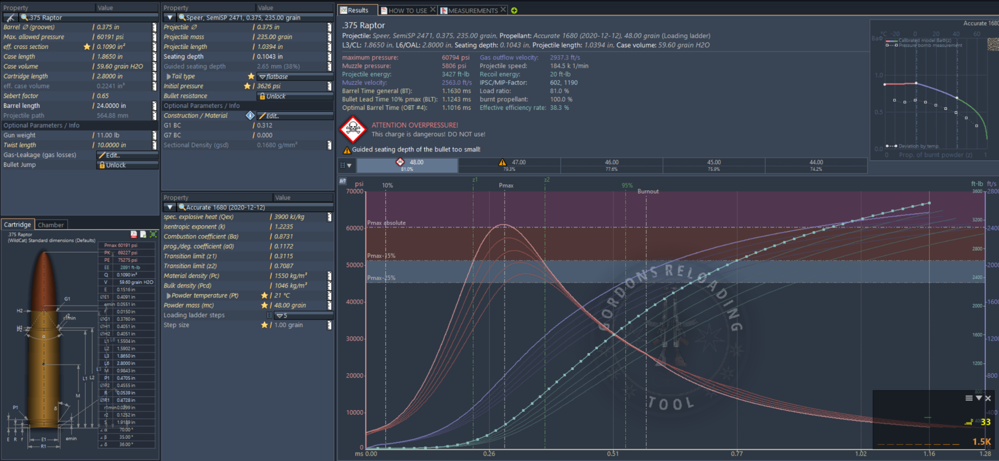

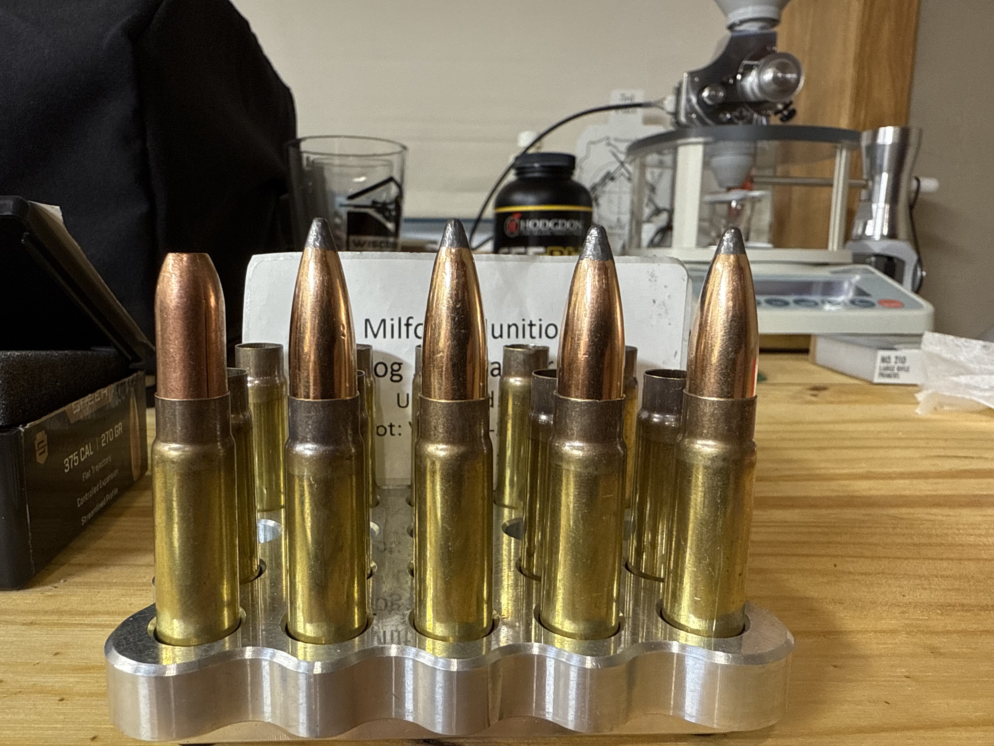

I've stumbled across something that appears odd in GRT. It could be I've just never thought of it to be honest. I have some Speer Hot Cor 235 grain semi spitzer soft points. GRT does have a 375 raptor profile and the bullet I'm looking at loading. I noticed it has a seating depth of .104 which seems too short. I've read a lot of posts that suggest they never do less than the diameter of the bullet as seating depth. And of course, many on the other side of the aisle as well. I also read about concentricity issues by doing too little. I realize seating depth also impacts pressure. Seating deeper generally increasing pressure. Lastly, I know I have to operate within the AR10 mag capacity of 2.800".
After that, my long winded question is, is there a point where seating a bullet too deep causes an issue? Doesn't increasing the amount of jump to the lands cause pressure in of itself? Assuming I stay within pressure limits for the cartridge, is there a difference?
I don't believe bullets normally have a seating depth listed. So if you have a bullet that doesn't list or you can't find a seating depth, is the normal procedure to load to max length of the magazine?
Here is what I'm talking about. It appears that it takes that COAL and subtracts the case length. Then seats the bullet just enough so the bullet length plus the case length equals the COAL. It even warns of the bullets seating depth being too low. So if I push it back .1 (an arbitrary amount) the warning goes away. But, is there some kind of standard minimum seating depth that should be adhered to? An since it now has a larger jump since the COAL is 2.7, is there any issue? It doesn't sound like there is. Thanks for the help.

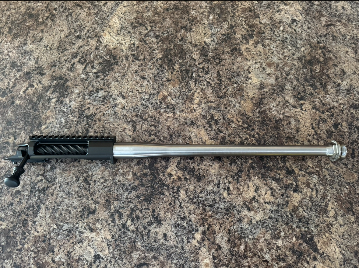

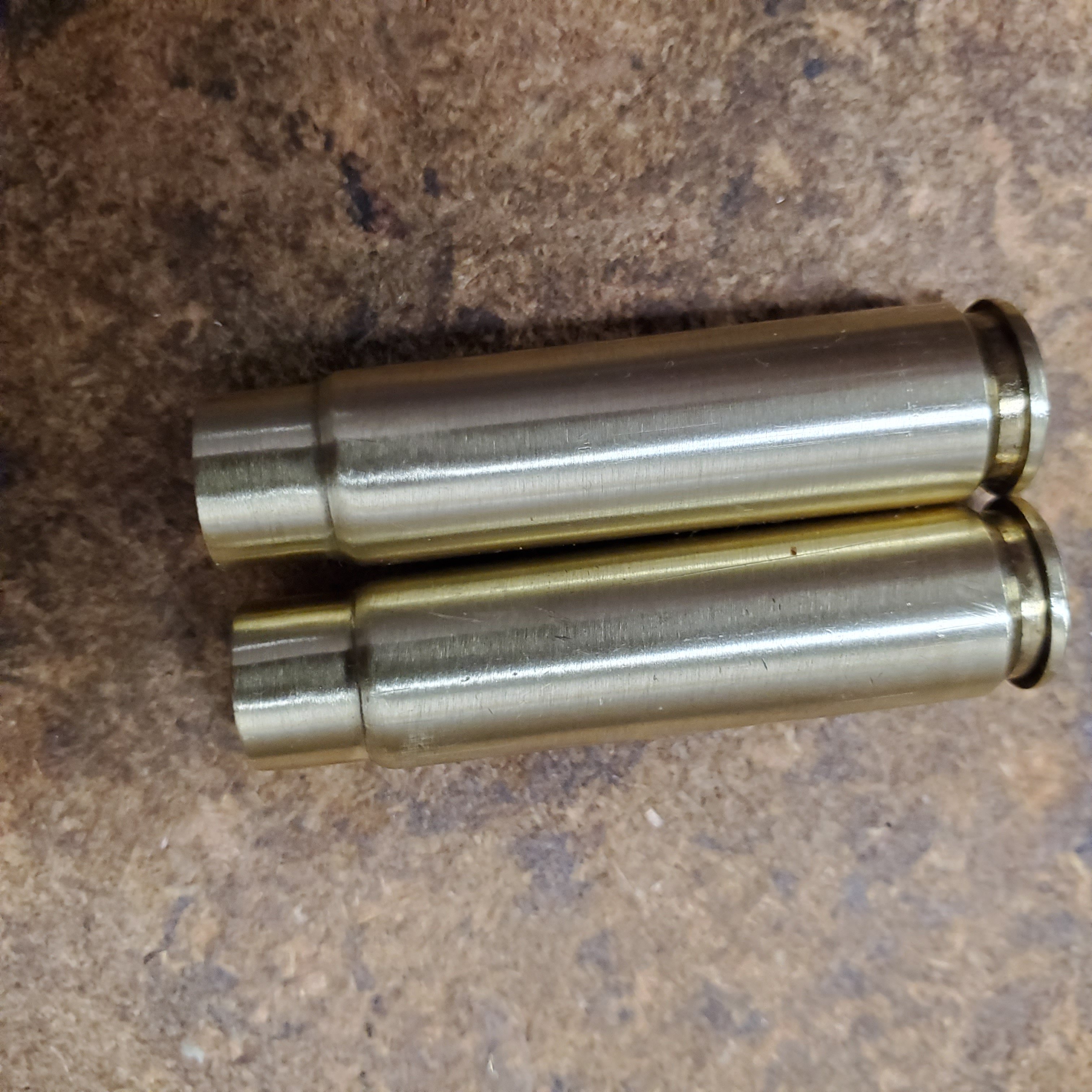

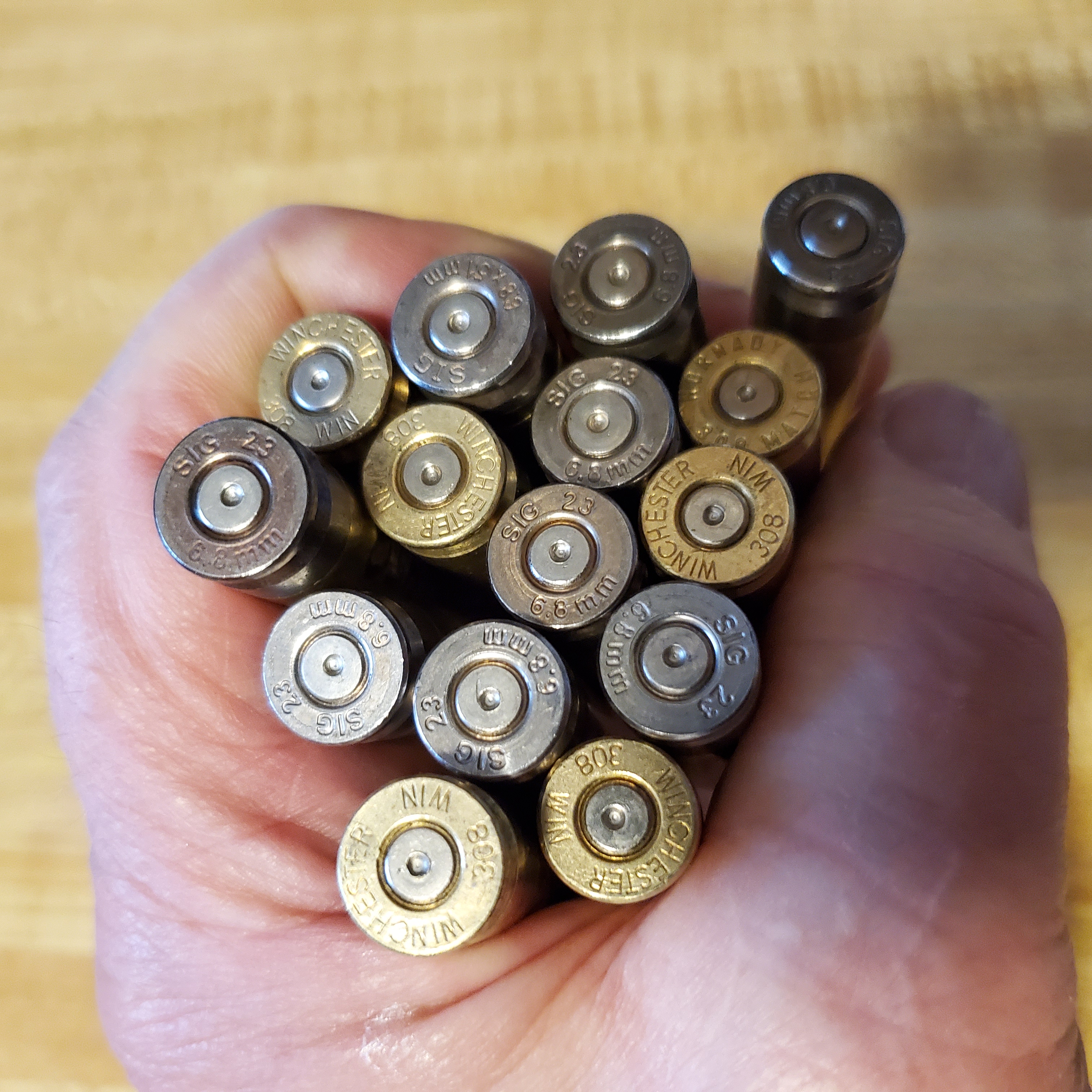

So I got my 375 raptor assembled. Everything seems to work fine except when I'm using my Lee dies to form brass for rounds. I'm using 358 Win brass from Starline. If I form it as usual, after cut/trim with the dies set to shell holder depth -1/4 turn, the brass gets stuck in the chamber and is very difficult to eject. I also noticed that there is no or minimal primer strike from the firing pin. I've had to push the shoulder back some increasing the depth of the sizing die, but then I have to remove the die to do the other stations and finish the round. With the shoulder bumped down, the round chambers and ejects as expected if inserted manually into the chamber and the bolt is allowed to close. If it strips it from the mag, the bolt fails to go into battery completely. If I charge it again, assuming the BCG isn't stuck, it'll work normally after that. Cycling is as expected after the first firing and after the first time it is put into battery. It seems like the first time the bolt closes on newly formed brass it is fixing whatever minimal problem there is.
I'd prefer not to have my BCG cramming the brass into it's final form. Any thoughts on where to look? Could it be the dies? I've also read it could be a stiff extractor spring. I have a known good BCG from a .308. Going to swap that tomorrow with new brass and test that. Additional ideas would be appreciated.

My thoughts on what to check.
-Check barrel with headspace gauge
-Check cases with case gauge
-Buy brass/ammo from BlackCollarMunitions and see if it works. I haven't tried there stuff yet, but it looks like they finally have it available.
I have to run my starline 358 cases through my CH4D die and then through the LEE die. Not sure why, could be tolerances combined with brass springback or something. I haven't tried with my extra LEE dies sets I got recently to see if they have the same issue.

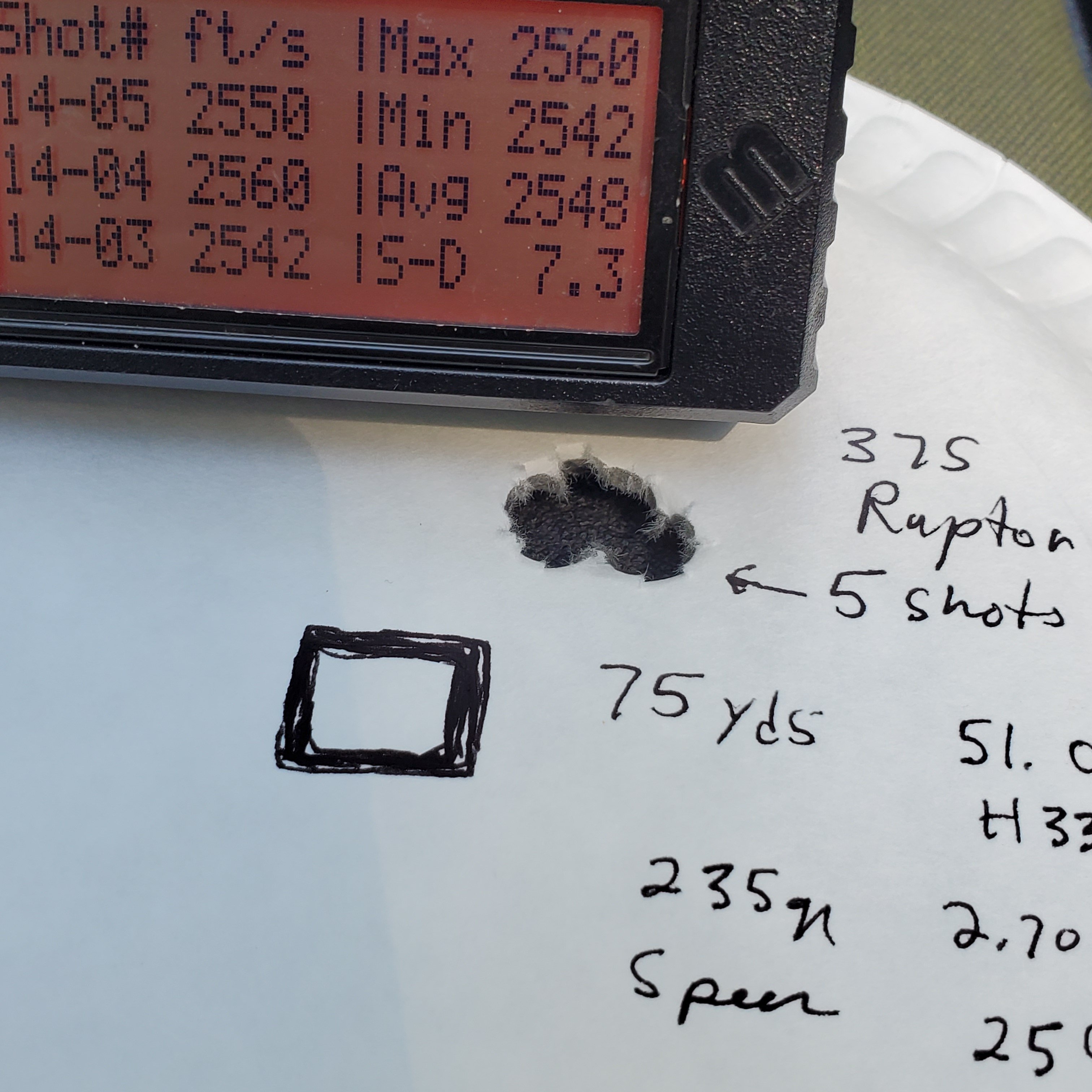

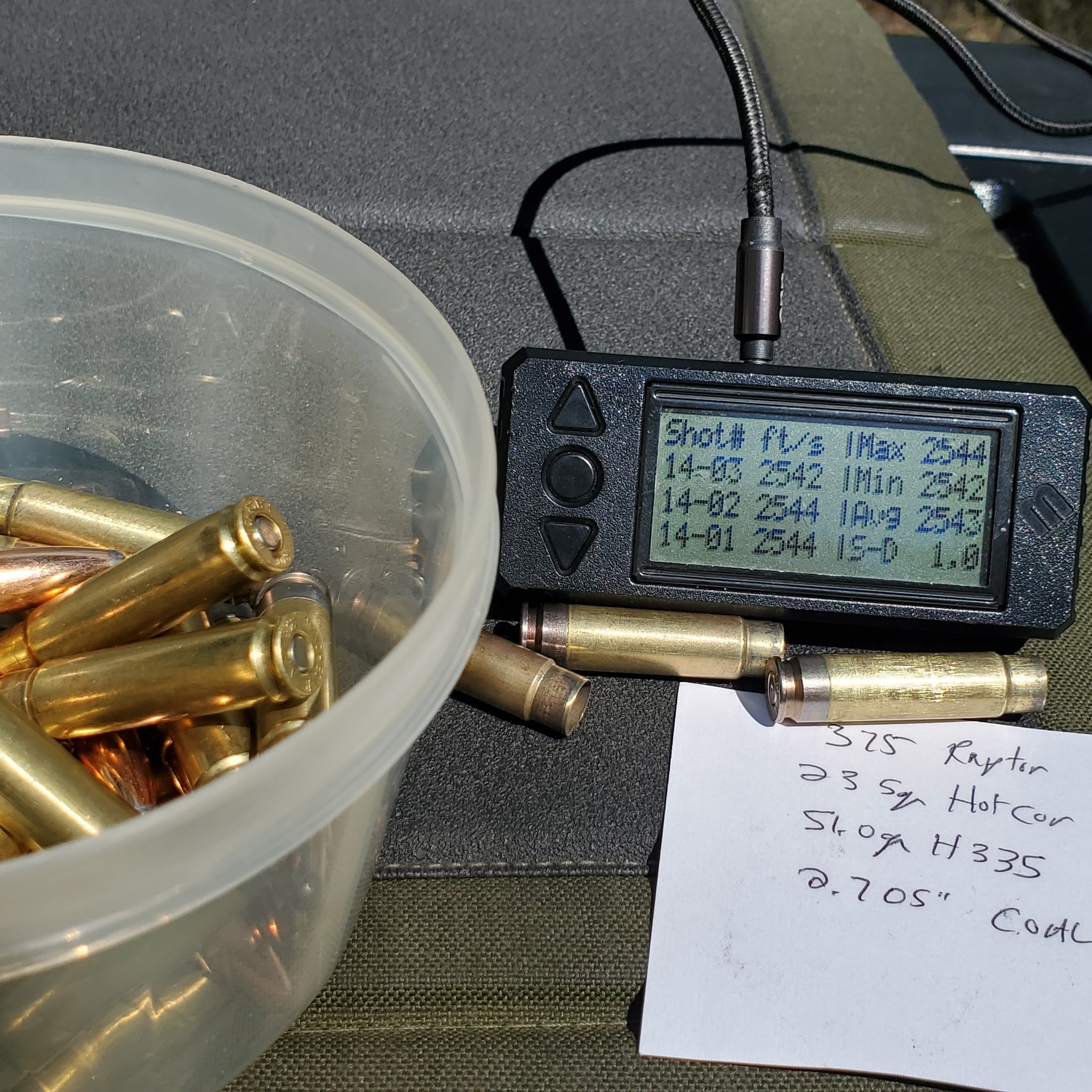

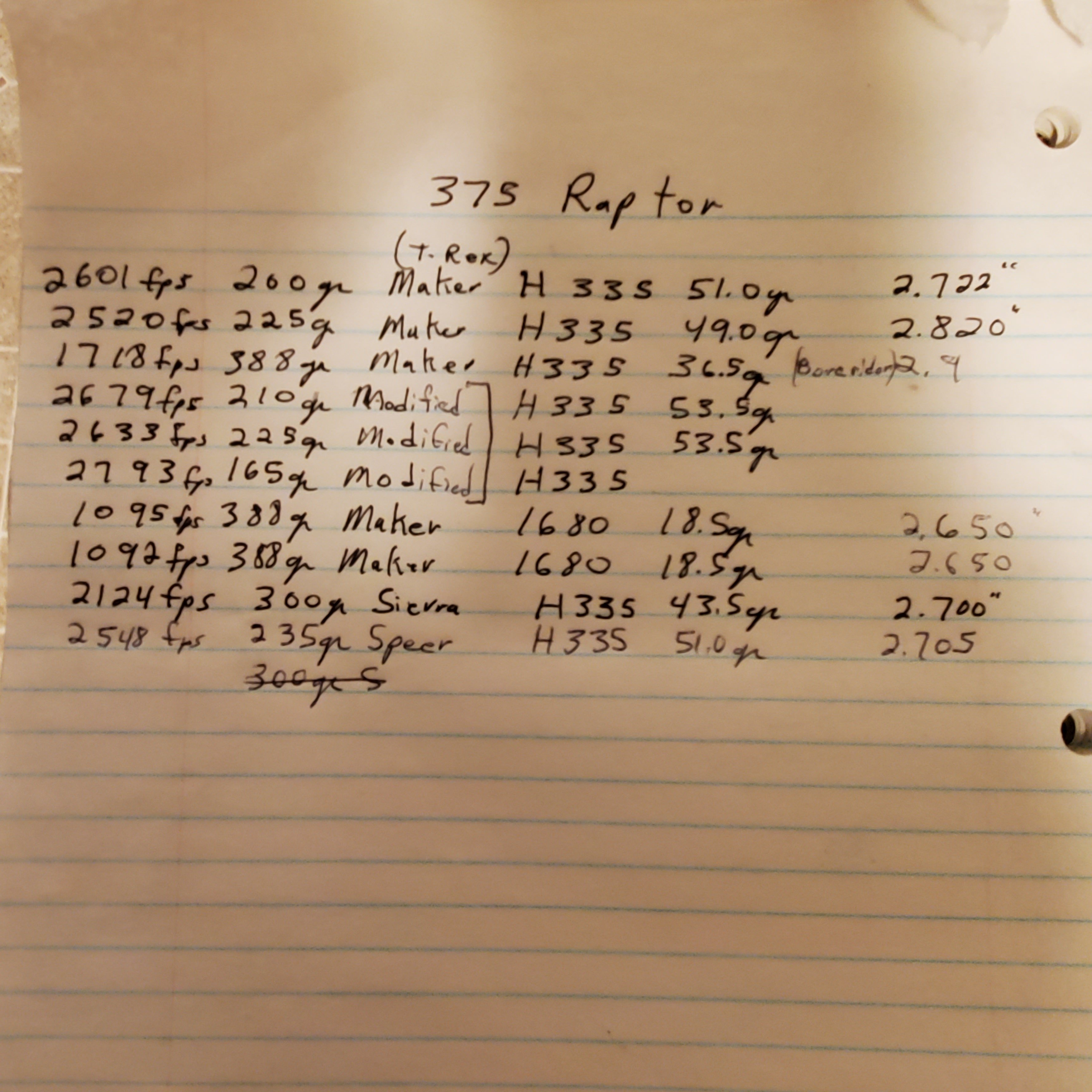

Regarding bullet seating depth, I believe the old data showed 2.710" for the 235gr speer.
Regarding powder for that bullet, I used the data for the 250gr SGK to find where to start. It lists both 10x and AA2200.

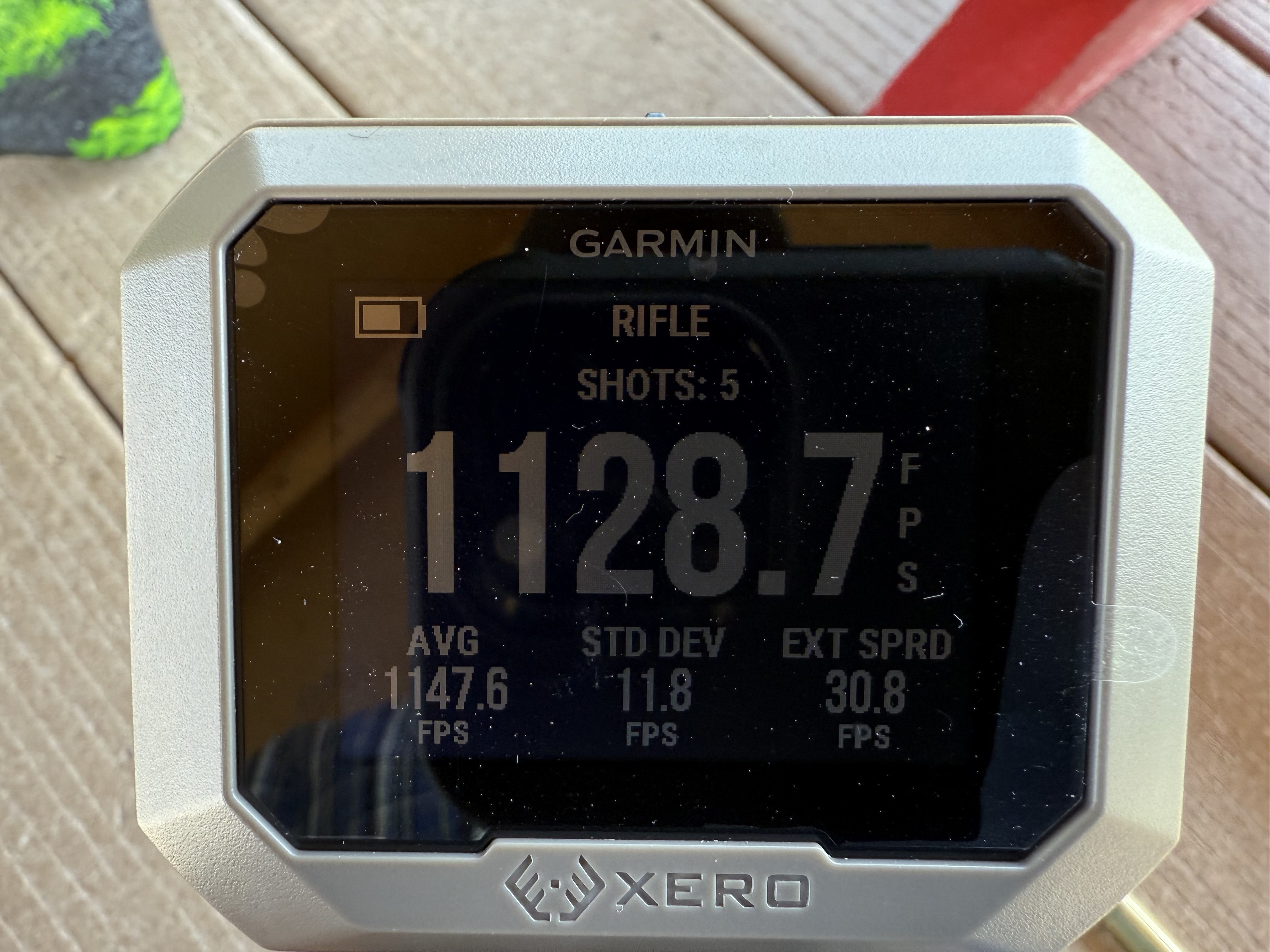

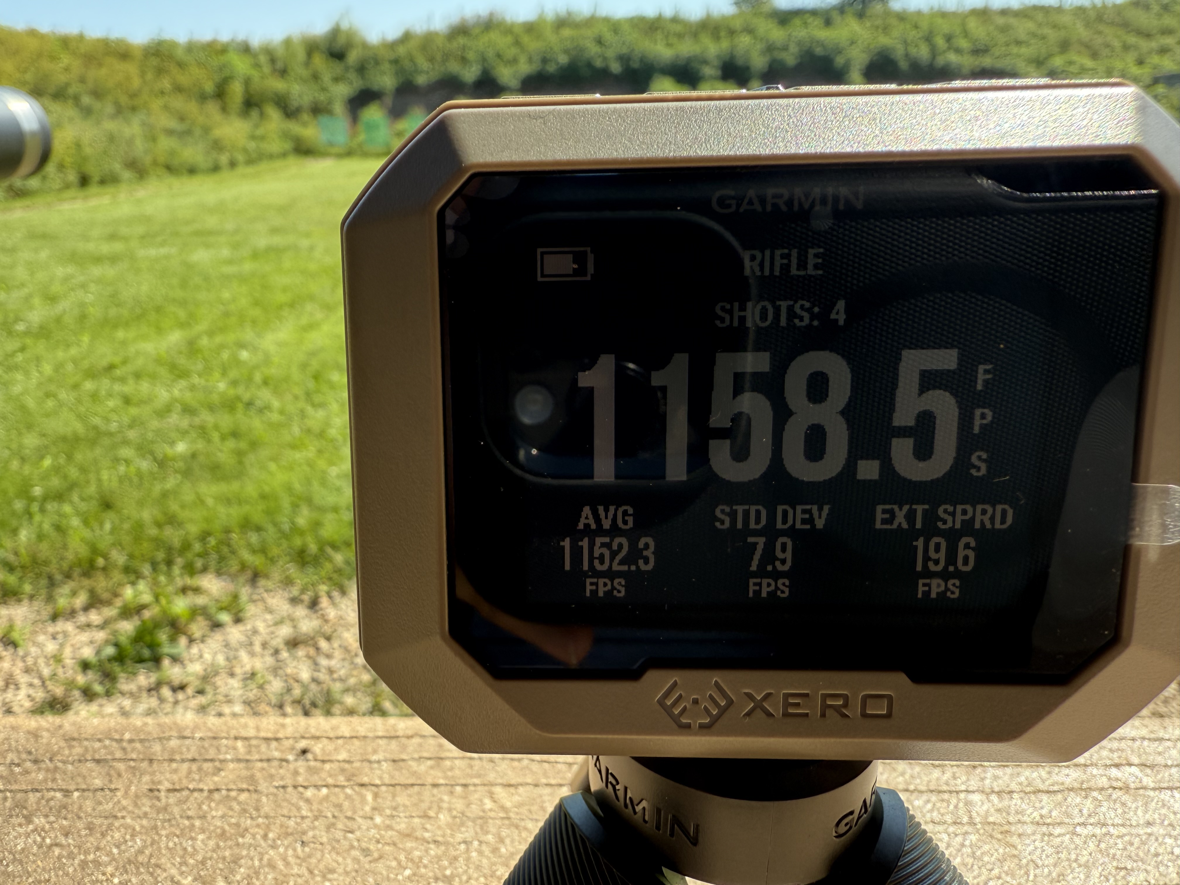

BTW, don't expect to get the velocities listed on the old raptor site data. My velocities are 50-75fps slower.

I don't see any type of gauges available specifically for 375 raptor. So, I went and bought a Hornady headspace gauge to be able to measure the shoulder. I did notice that I have to crank the LEE FS die as far down as I can to be able to get it to match fired brass.
I was thinking about purchasing one of the CH4D dies as well, but it sounds like you have a similar issue with cases using theirs as well.
Do you just use one FS die after the other?
I noticed a lot of the overhype from that page. I'm actually enjoying the 375 Raptor, but it's not going to get to where they say it can be unless you really push your cartridge loads.
I got my headspace gauge from PT&G. Case gauge from Medesha Firearms on ebay.
According to the old raptor website, the CH4D dies used a larger neck outside diameter. This was for sizing thicker military brass. My dies left no neck tension on the once-fired brass I was using.
For new brass, I cut brass with mini saw, expand neck with expander die, trim to spec, one pass through CH4D die, then one pass through lee. I use a Lyman turret press so I can switch dies very easy.
IIRC, I can also just use a filed-down shellholder with my lee dies and skip the CH4D die.
For my brass that is once-fired, I think I just run it through the lee die with a normal shellholder.
Converting brass is a bit of a pain. I will try to get some factory raptor brass while it's available.
Regarding the old website velocity numbers, I think 1200-R was the key to some of that. I think it burns like 10x but since it's a ball powder, you can add more. But yeah, their numbers seem a bit high.
