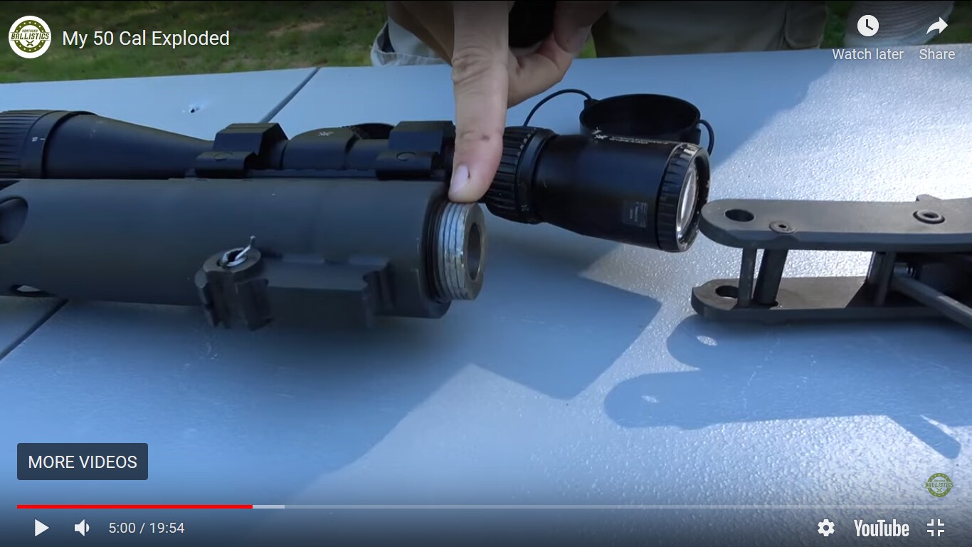

I stopped wasting my time listening when he said he spoke with Mark and they estimated right over 80k cartridge pressures to rip the screw on breech plug....................
That makes me assume a few different things:
1. Serbu does not test each build with certified proof rounds.
2. Serbu does not have dynamic FEA on the design that shows exactly what the pressure would have had to be for the failures.
3. Why does that breech plug rely solely on threads and not any lugs??
4. Unless that is some cheap alloy the pressures were significantly higher than that...the 277 Sig Fury OPERATES at 80k, lolol

I would not say that the rifle is flimsy, but rather that its provisions for handling a catastrophic failure are almost non existent.
This is where firearms tech has made a huge leap in the last hundred years and why you damn near need to load your rifle case with bullseye to have a chance of sending your bolt through your head.
This firearm is not built to safely handle a catastrophic failure.

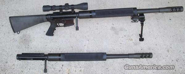

Makes me think of those 50 uppers that fit on large frame AR lowers.....thinking Armalite did one.
Never looked into what holds everything together but if its two push pins.......no thank you.

So, SLAP-T and SLAP is still manufactured if I am correct. The problem with it is that you need to ream some of the chamber as the sabot on the SLAP round sits a little deeper. Not doing this will force the sabot into the chamber and you will see elevated pressures. I have chambered a SLAP-T round for schnitts and giggles into my .50 BMG (but never fired one through my rifle). It took a rubber mallet to close the bolt and the same mallet to open it (slightly the sadist), not all seat that tightly but it is a known thing. I wonder how he got the breach plug to close correctly with that SLAP round? I doubt he did, even though he said he did.

Especially some of that old SA stuff!! That stuff was terrible back in the day. SLAP was known to not be accurate out of bolt guns and also known to require a deeper/longer chamber than your standard .50 BMG chamber because of the plastic sabot. Not having that will increase your chamber pressures. Should it have caused this?

I was always taught that it was 1.5xdia for thread engagement.
thats a rule of thumb.....for anything holding high pressure youd want to actually sit down and figure out the actual strength of the threads using their tensile stress area.....
just looking at those threads, they look like a basic Unified thread and frankly quite paltry....i would have gone with buttress threads, but admittedly i havent actually run any numbers on it.
but it sure as hell doesnt give me the warm and fuzzies.
