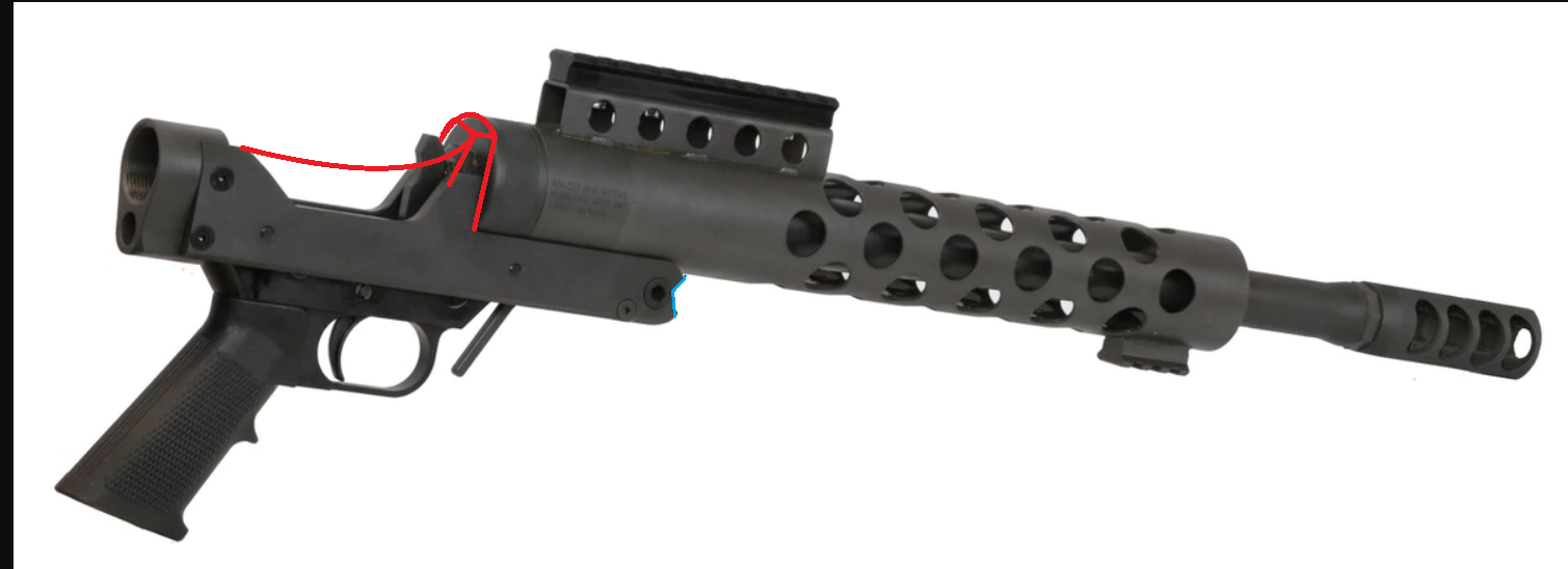

...did repeated firing stretch the cap? Barrel chamber area expands a tiny bit on firing... and that can, over time, potentially expand the cap beyond its elastic limit enough that it can loosen up.
In the Blowed up picture, the threads do not look healthy. They look worn and rounded. Just from firing that one round? Or was this thing high-mileage and the threads were tired.
Then (again) a SLAP round in a weak, tired, under-designed .50? That it has not happened before is remarkable.
This is a great point IMO.
The Kentucky Ballistics guy probably puts more rounds through his Serbu in a week than the average owner would put through one in a lifetime. On top of that he specifically looks for the hottest/most impactful rounds he can find, so he not using standard pressure/velocity rounds.
Hell, he may put more rounds through it than the factory has through theirs...

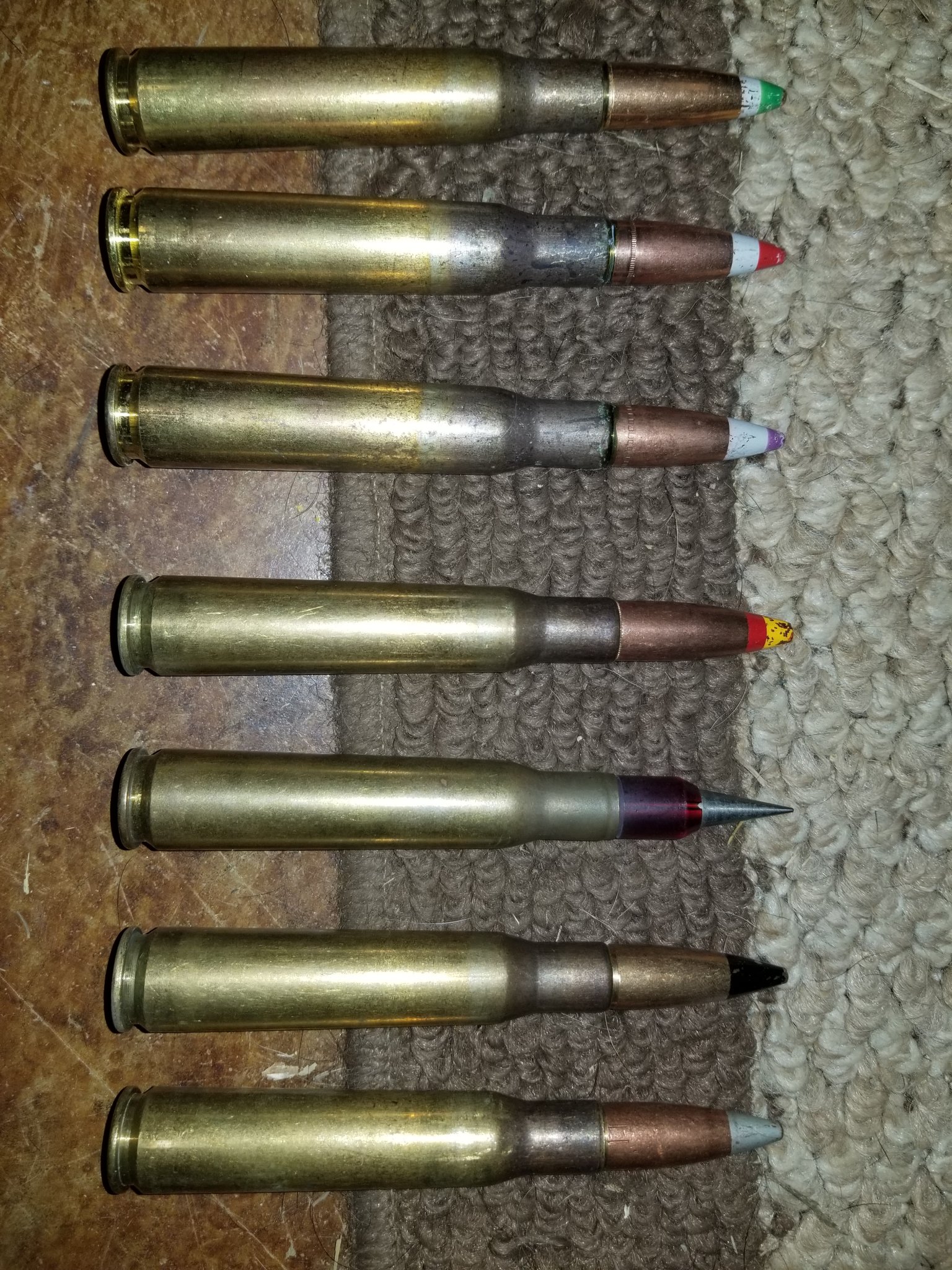

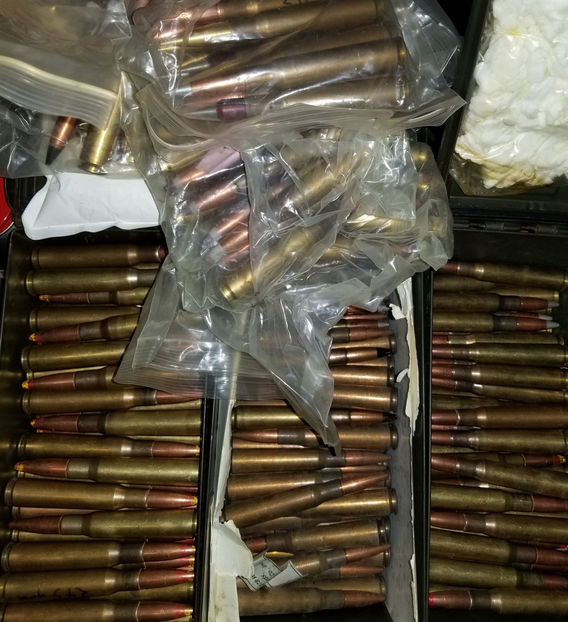

.50 Ammo collecting is kind of a neat past-time. There is a lot of cool stuff designed for the .50.
But much of it is a big no-no when it comes to firing from guns not specifically designed for them. An M2HB will handle about anything. Though there are some cartridges made for aircraft... or Gatling Guns... Or other 'stuff' that is a no-no. For example, 'special' rounds were developed (or handloaded by SF guys) during the VN war that were full of Bullseye pistol powder. Those were left in ammo cache's or left where they would get picked up and used by the enemy. Result... you destroyed a weapon... injured a VC... and now 'all' the ammo in a certain AO was suspect. "If I pull my trigger, will I kill that GI... or blow my face off." That is psychological warfare at its best. Bet some of those came home in footlockers? Like I said... be aware of what you have.
All firearms are a system. And ammo is a key part of it. Just like not putting a .38 Super in your 1902 Colt .38 ACP... that gets expensive and painful when it blows your pistol apart. Yet the rounds are physically identical.
Know what you are doing before just putting a cartridge in a gun! Most here do. But there is arcane stuff that one needs to be aware of.

I believe the shooter stated that he used a heavy barrel with a machine gun chamber was sent to him specifically for shooting the SLAP round.
I didn't hear that either. There was a great site that used to be very active and full of a lot of information about .50 BMG shooting. It is still around but not really active. Before playing with stuff that can run 245grns of H50 or Vhit 20n29 in a load maybe people should learn about the system they are playing with, just a thought :unsure: :unsure: :cautious:

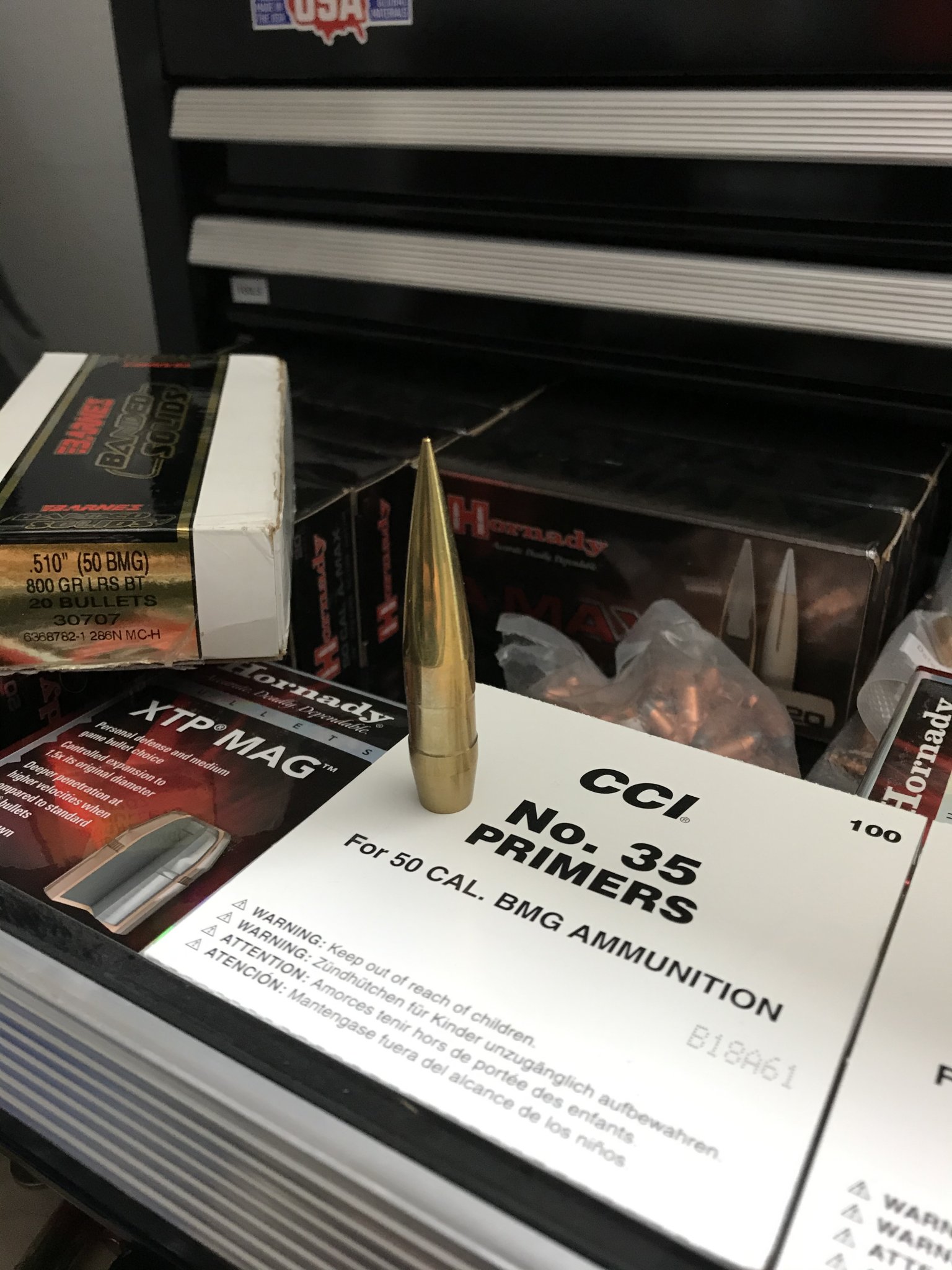

what do you think is this about the right size for 50 BMG I’ll just cut it off and put a cap on it?
Removing the primer crimp on these things sucks BTW.

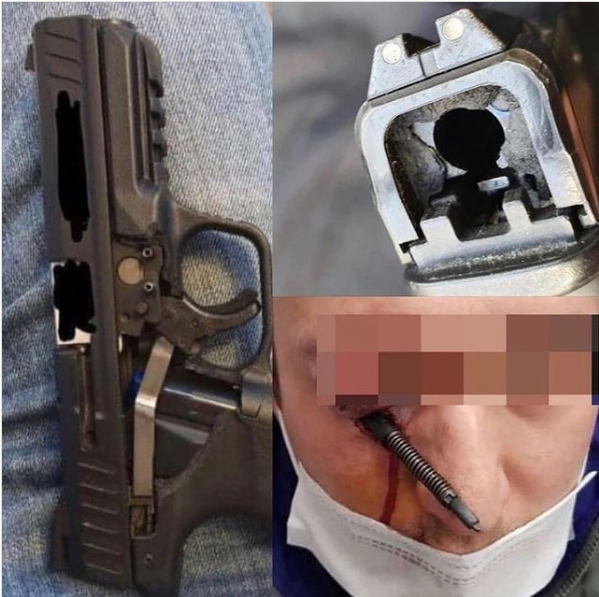

Hell, I'm sure we all remember this poor fuck
Another reason not to buy those cheap ass guns from turkey...
3rd world prices get you 3rd world engineering

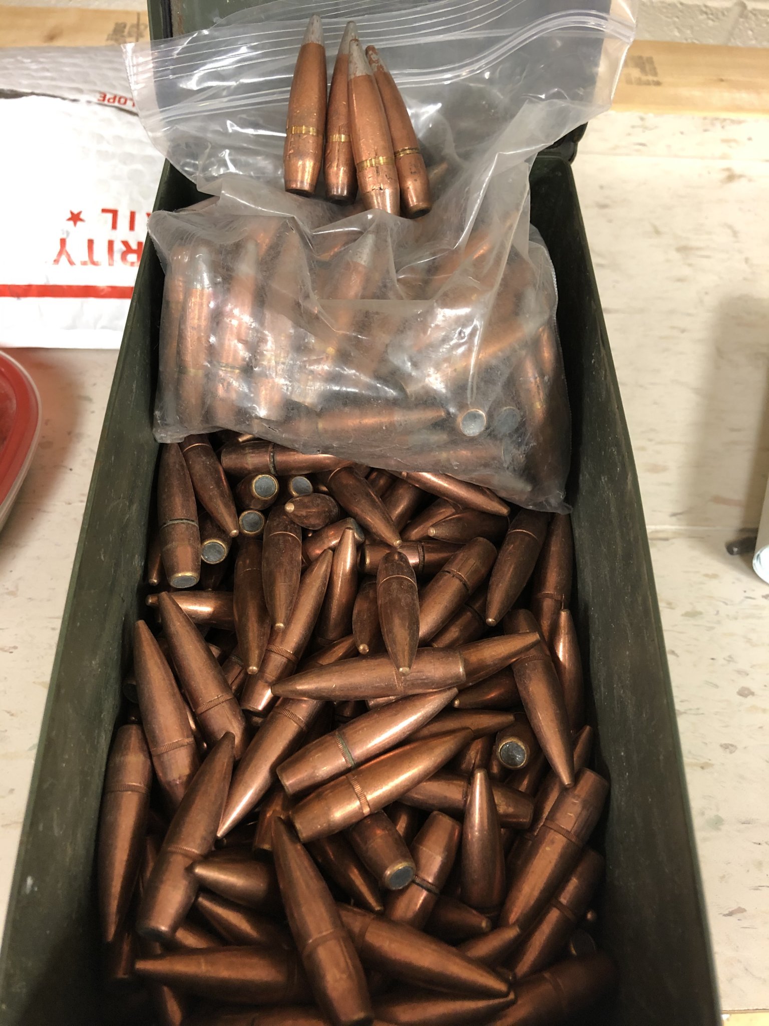

Good news for all those that have a 50 BMG there’s plenty of primers and powder and even cases and you guys are good to go?

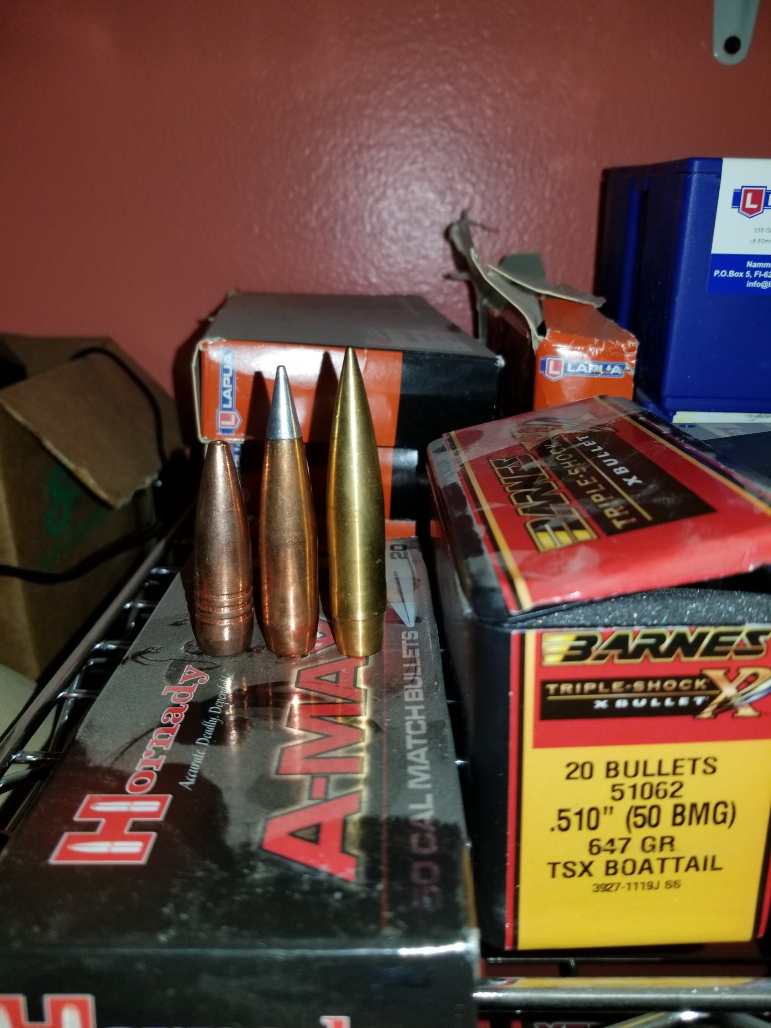

can you reuse those bullets that were pulled?
I don’t think it would cause any failures maybe just some accuracy
Reactions: stefan73
You need to resize the pulled bullets, but yes, you can reuse pulled bullets.

Now I would never fire a SLAP round in my gun, Ferret 50.
I agree that the Serbu 50 design is very bad and shouldn't be out there.
I know that there are Serbu's with thousands of rounds through them with no problems but the design flaws in that gun are to great to ignore imho.
Mark Serbu with the "designer" of the Serbu screw cap 50 cal - Royal Nonesuch. Have to watch to believe...
If you don't have time, skip to the 14:50 mark.... OMG - live loaded 50 cal round, he had no idea and pulled the trigger!!!
Unreal... can't make this shit up, as they say.
