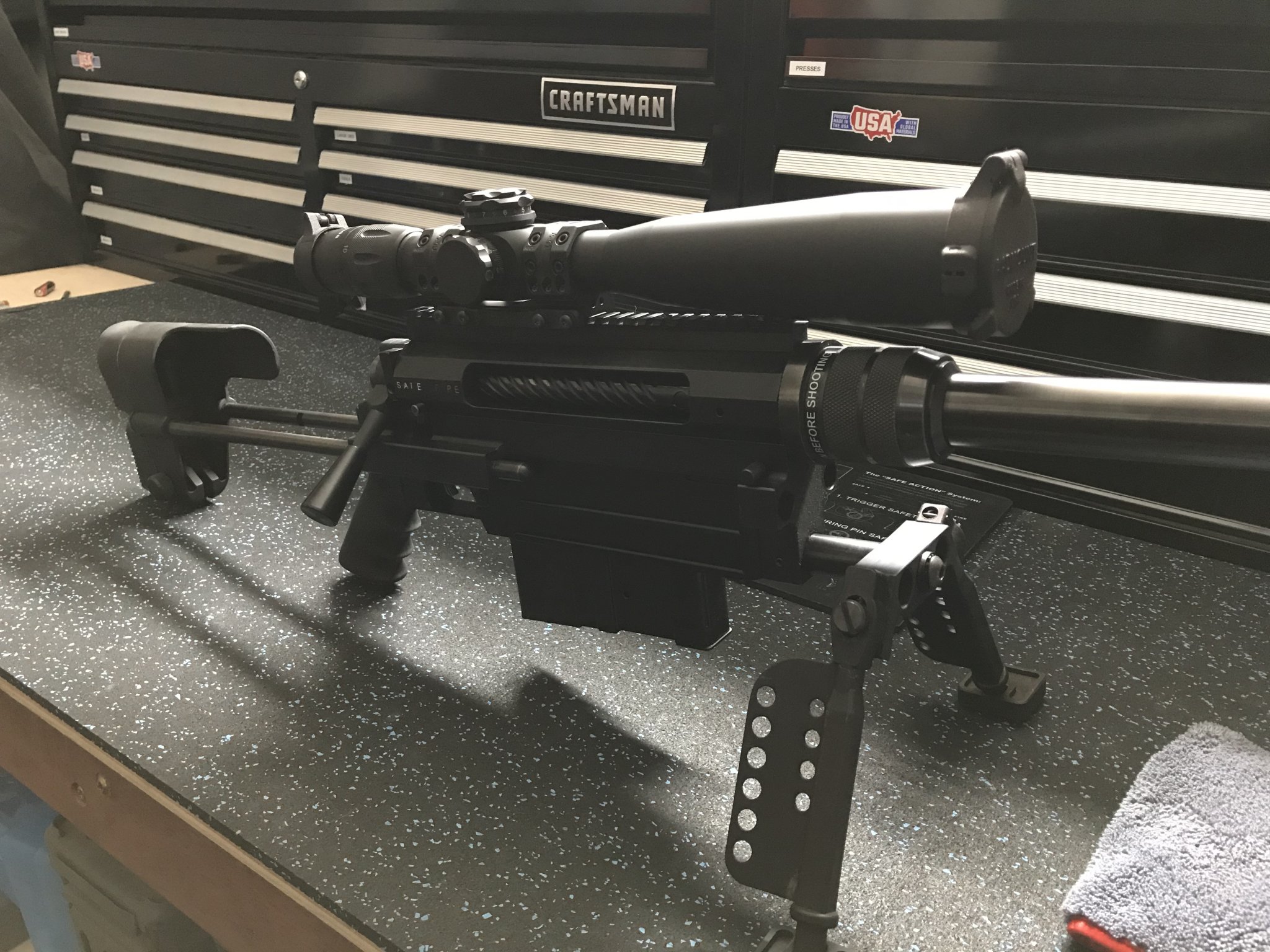

I used to have one of his .50 cal rifles (and a .408) and it doesn't surprise me at all.
His rifles were massively overbuilt for the cartridges they fired.
Heavy as all get out. He was obsessed with making sure the guns would never blow up.
That's also the same reason I'm a huge fan of the Hoplite Rifles @THEIS is making as Theis has that same idea, to make sure your gun never blows up on you.
