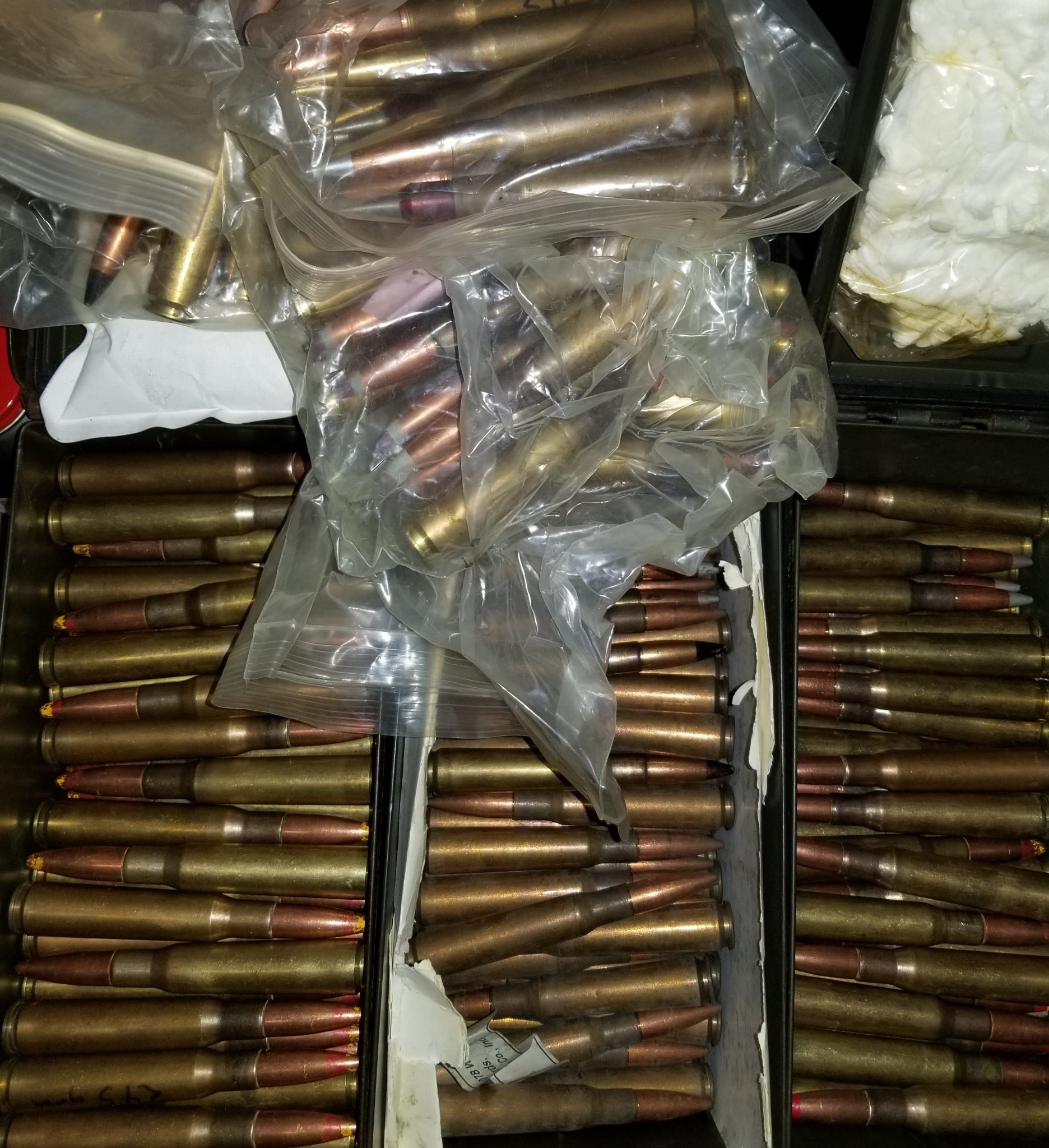

Serbu mentioned counterfeit ammunition.
At $100 a round that’s certainly a possibility.
I’m more suspicious of the ammo than the rifle.
1) they have no proof the ammo was actually counterfeit.....or was at fault at all.
Not saying it wasn't, but without inspecting the gun and doing a forensic engineering analysis, you can't say for sure......for him to come out and claim "yeah it was definitely the ammo and you have nothing to worry about" is borderline negligence.
I would say it was the ammo but usually when manufacturing rifles you blow one up to see the extreme conditions and then make your determinations if you should make changes for the what if but you design for standard ammo . I assumed that as long as you didn't have an obstruction in the barrel that it wouldn't blow up like it did since the bullet is being pushed out. Hearing Serbu say it detonated I'm assuming the round turned into a bomb.

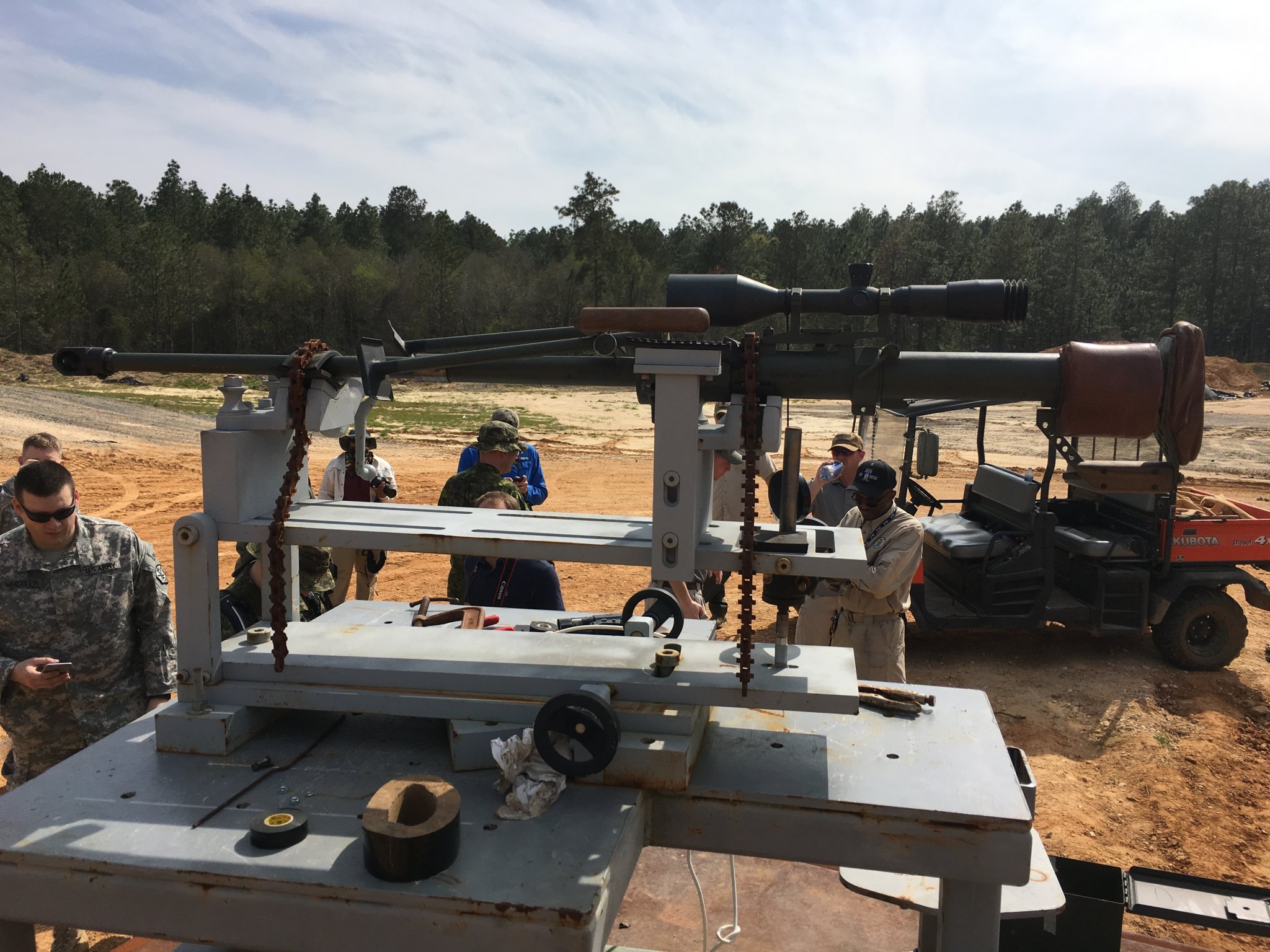

Not exactly the same thing, but many years back on SH, there was a thread where somebody posted a video of them shooting an Accuracy International .50 rifle where one of the cases had a case head separation/rupture, it blew out the safety relief plugs on the rifle, but they didn't even notice it and kept on shooting and didn't realize what happened until they inspected the fired brass and watched the video.
Accuracy International USA advised them the rifle needed to go back to the factory for inspection and maintenance.
A friend of mine had a near complete case head rupture on a .308 Accuracy International AE Mark II, but apart from being shook up and having powder all over one hand, he was unharmed. The steel magazine was bulged and the bolt was sticky, but the rifle still functioned. It went back to the factory for inspection and was repaired.
That is examples of rifles specifically built to handle things going kaboom without injuring the shooter.
If the bolt lugs are able to be sheared off and send the bolt flying back to you, somebody really messed up in design / manufacture.

Watched a couple of his other videos and he has fired a few SLAP rounds in that rifle without
incident but that one particular round grenaded the gun.

Many years ago CBC recalled a bunch of surplus 7.62 ammo that was blowing up rifles. Before the recall I fired over 300 rounds
of that ammo through my M1A without incident and pulled the bullets on another 150 or so and reloaded them years later.
It was said that pistol powder was erroneously used on some of that lot of ammo.
Point being that all the guns were safe until bad ammunition was used.

Folks here need to know first that the KB rifle was specially chambered with a machine gun chambering for 50bmg so that it can shoot the SLAP round. This is mentioned in a previous video. Whether it's properly chambered as such is another question.
The SLAP round that he fired was purchased but no one knows whether it's genuine military surplus or a reload.
The barrel was not obstructed when it blew up, as shown by the fact that he successfully shot a full size projectile right before this kaboom, and he even found that projectile on the target.

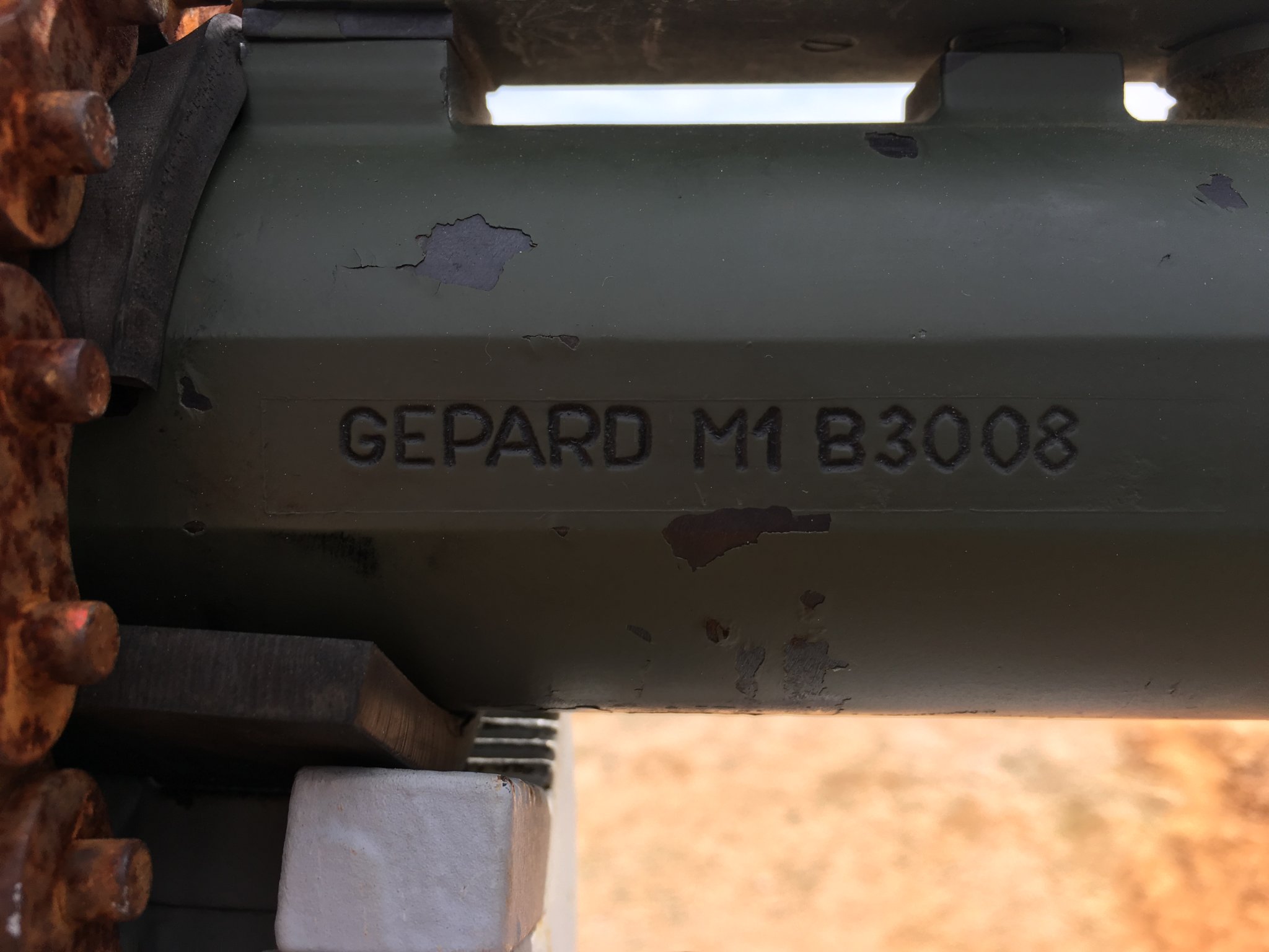

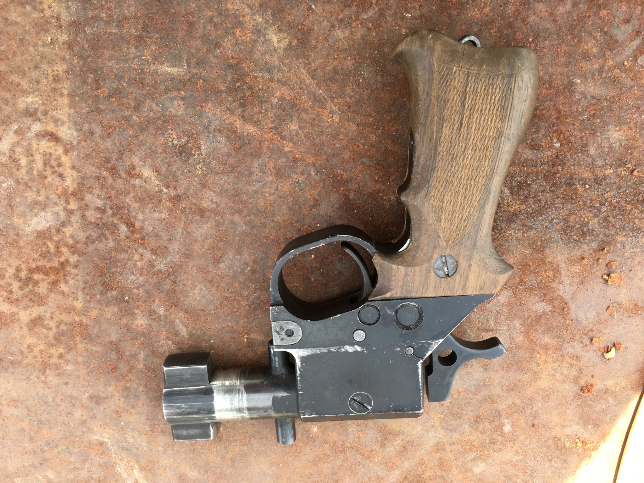

That Gepard is fascinating. I love this quote from Wikipedia, "An even shorter paratrooper variant dubbed M2A2 made it more favorable to airborne forces and special forces, especially because it could be fired from the hip".
