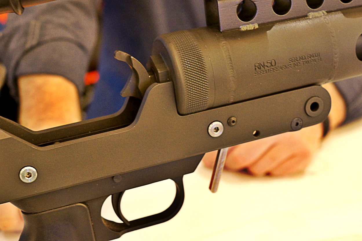

1. No firearm, no matter how shitty of a design can have a catastrophic failure such as the KB one without AMMO.
So the shooter is accountable for that but only that portion of the event in its' entirety. I do not believe the shooter is accountable for anything after pulling the trigger.
2. Once the KB guy essentially started the entire chain of events it is the FIREARMS job to stop the chain of events from being so catastrophic.
In this exact rifle design that starts with something as simple as 45 degree (away from shooter) gas vent holes in that screw cap.
Simply done via 2 drills with a 1/4 inch bit.
That way even during complete case head rupture the gases would not blow the threaded cap off in that such a manner.
As soon as the gas "escaped" the "boltface" area in this screw cap design it put too much force across a larger section in which ripped the screw cap off. No amount of threads in that alloy was going to hold that screw cap on.
In this exact rifle design we can get deeper into the science of it in regards to that screw caps actual weight.
For example IF that screw cap was twice its weight (not size, but alloy weight) then the same amount of pressure would not be able to blow it with same speed and force.
In turn slowing the entire series of events down in regards to how deep the KB throat was cut??
In turn slowing the entire series of events down to the 2 rabbit ears could have helped better since the cap would not have been going with such speed??
Some firearms forensic examiner in Italy threw out some formulas in which the objects would have been moving at a 1/4 of the speed so in theory KB cuts would be a 1/4 of the depth they are right now.
Same examiner has offered to examine this rifle free of charge and anyone want to wager IF he gets that opportunity??

I think another issue here is shear vs compression.
Bolt lugs want to fail in shear. Shear failure when everything is designed right is really hard to achieve. VERY high pressures. Additionally very few bolts with lugs seal so tightly that they need much of a pressure venting system.
Compare that to “El Pipe Bomb de la Serbu”.
Threads. And a cap. Perfect fucking seal. And those threads will partially want to shear and partially want to decompress. There are threads that don’t fail that way (ACME for example) but yeah.

whats even funnier is that in one of the original videos serbu actually jokes that his welder was a "pot head".
from the looks of the welds above i would say hes right
Another reason he should be shut down, knowingly employing someone who is a active drug user and letting him work on firearms.
Not just welding a bipod stud on but actually welding the pipe/receiver together.
