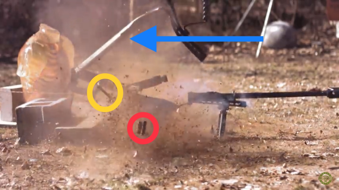

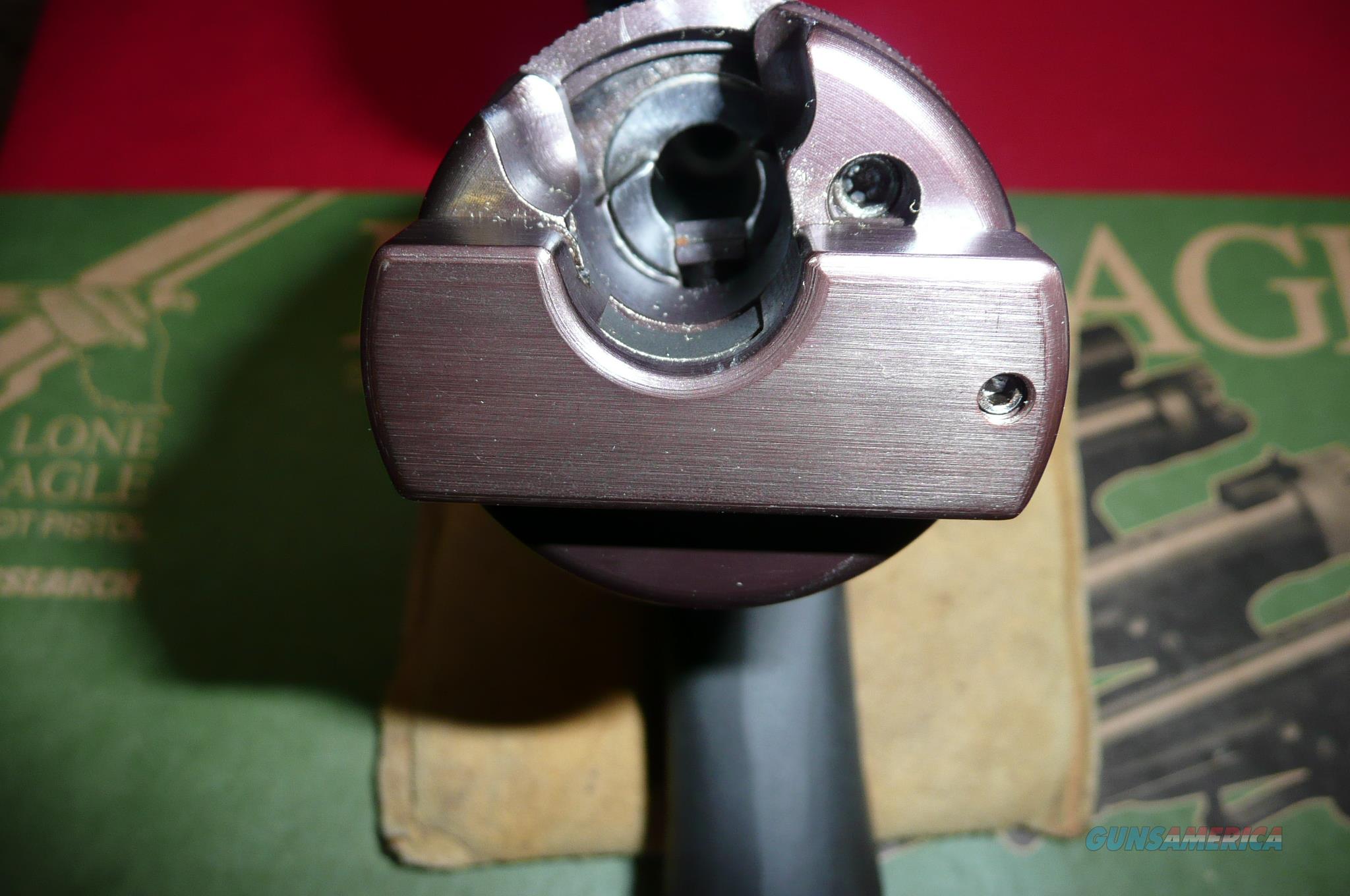

This is a proper cannon breech action.
This is what his stupid ass was trying to achieve....without all the "complications" of a true cannon breech.
Serbu is just another dipshit money guy.
Only a complete idiot, would design and release such a piece of shit, as we see in these videos.
As others have rightly stated, it is literally, a pipe bomb.
You are safer firing taped 50bmg cartridges, in a 12gauge shotgun.
Reactions: Tokay444

Notice how the Barrett safely redirected the pressure and didn't send large chunks of steel back at the shooters face.....huh, it's almost like there Barrett was designed to ....say it with me folks..."fail safely"
....and yet we will still have Serbu supporters saying "BuT aNy gUN WoUlD HaVe ExPloDed!"...
Honestly it's sad to see KB still cucking for Serbu after seeing a blatant difference between t to Barrett and the RN50, and him acting like there wasn't

I find it quit hilarious and sad Anyone would claim that the Barret failure is somehow safe!
That pice of steel With the blue arrow pointing at, would’ve smacked you in the face potentially breaking bones like maybe your orbital socket and jaw.
The two pieces highlighted in the yellow and red circles, although they are directed away from the shooter, are deadly projectiles.
Here is one of two pieces of Shrap Metal that ended up inside the dummy that could’ve easily gone into a neck and cut a jugular.
View attachment 7815008That pice of steel With the blue arrow pointing at, would’ve smacked you in the face potentially breaking bones like maybe your orbital socket and jaw.
There’s some salty dick sucking fucks in here
Yup, the Barrett failed in a very dangerous manner. Your face would have been right up against the upper receiver when it blew upward. Your face most likely would have sustained some serious blunt force trauma and burns. The Barrett shot shrapnel back and to the sides which would have been dangerous to both the shooter and any bystanders.
