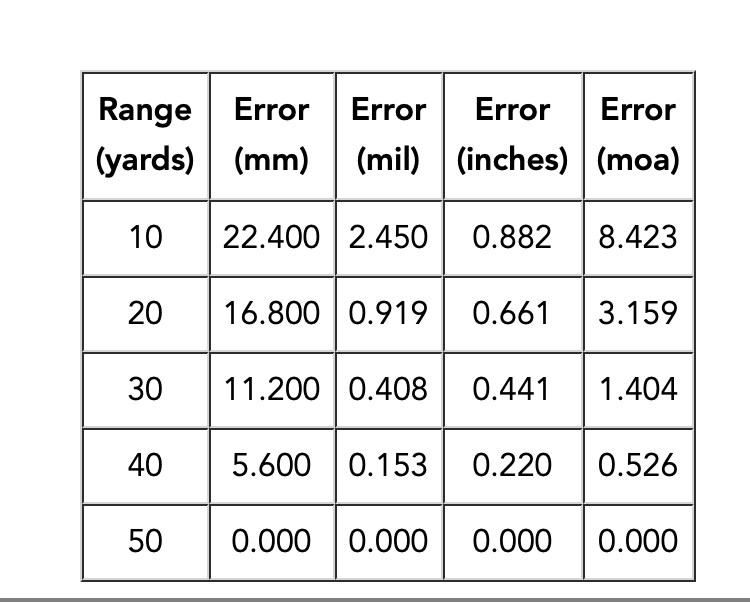

    Here is the max parallax error possible on a 56mm objective optic with the parallax set to 50yds. Starting with 10yds and each subsequent 10yds until you get to 50yds.
    Keep in mind, max error means that you have your head all the way to one end of the optic and the crosshair center appears to be at the complete opposite end of the FoV.
    You can decide if this helps your decision.
    Where did you get this table? Do you have it for a 50mm objective? And are these all set for max error with parallax set to 50yds, or infinity?
    You can use this calculator. Set the "fixed" parallax to whatever distance you would set your optic parallax free and then compare. The example I used, it was set to 50yds. Since OP asked about using an optic with minimum 50yd parallax. So the distances in question would be inside of 50 with parallax set to 50.

    That site rocks, thanks for the link. My local clubs only do NRL22, so looking at the 2024 COFs, 40% had KYLs as the closest targets at 35 yds, and with a 50yds parallax, my max error there is .2 MRAD on the KYLs, and .1 on 40yds targets. I'll give the 3-17x a try and if I miss those KYLs too much, I'll put a scope with lower parallax on it.
