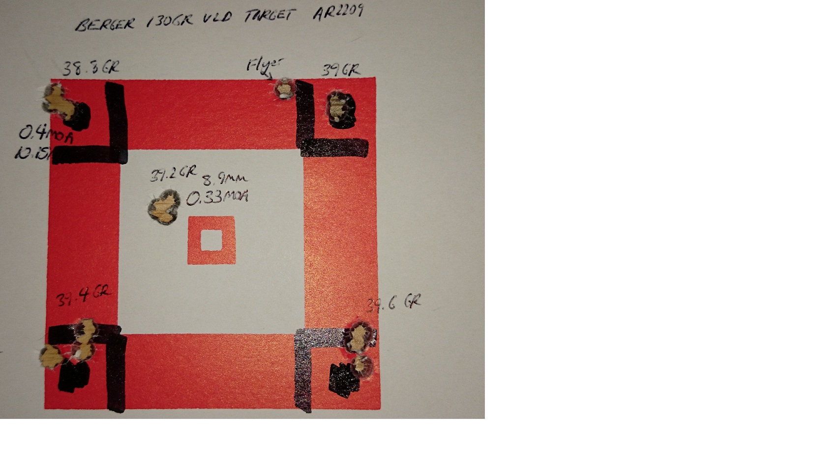

Berger 130gr VLD are shooting better than anything else out of my rifle at the moment. My best grouping has come from 39.2gr of ADI AR2209 (Equivalent to RL15, H4350). I've run Lapua Scenar 123gr, Scenar L 120 and 136gr, 123gr Nosler Custom Comp and 129gr Nosler Accubond LR - I have not been able to get these performing the way they should IMO, whereas the Berger's have been pretty consistent. I'll tinker around with AR2208 next (Equivalent to Varget) and see if that makes a difference for the other projectiles. Running CCI450 primers also.
Rifle is a Tikka T3 with a 26" 1in 8 twist Maddco barrel. I'm new to reloading so I haven't played around with seating depth yet, just making sure the bolt closes smoothly and the bullet gets out of the barrel safely.

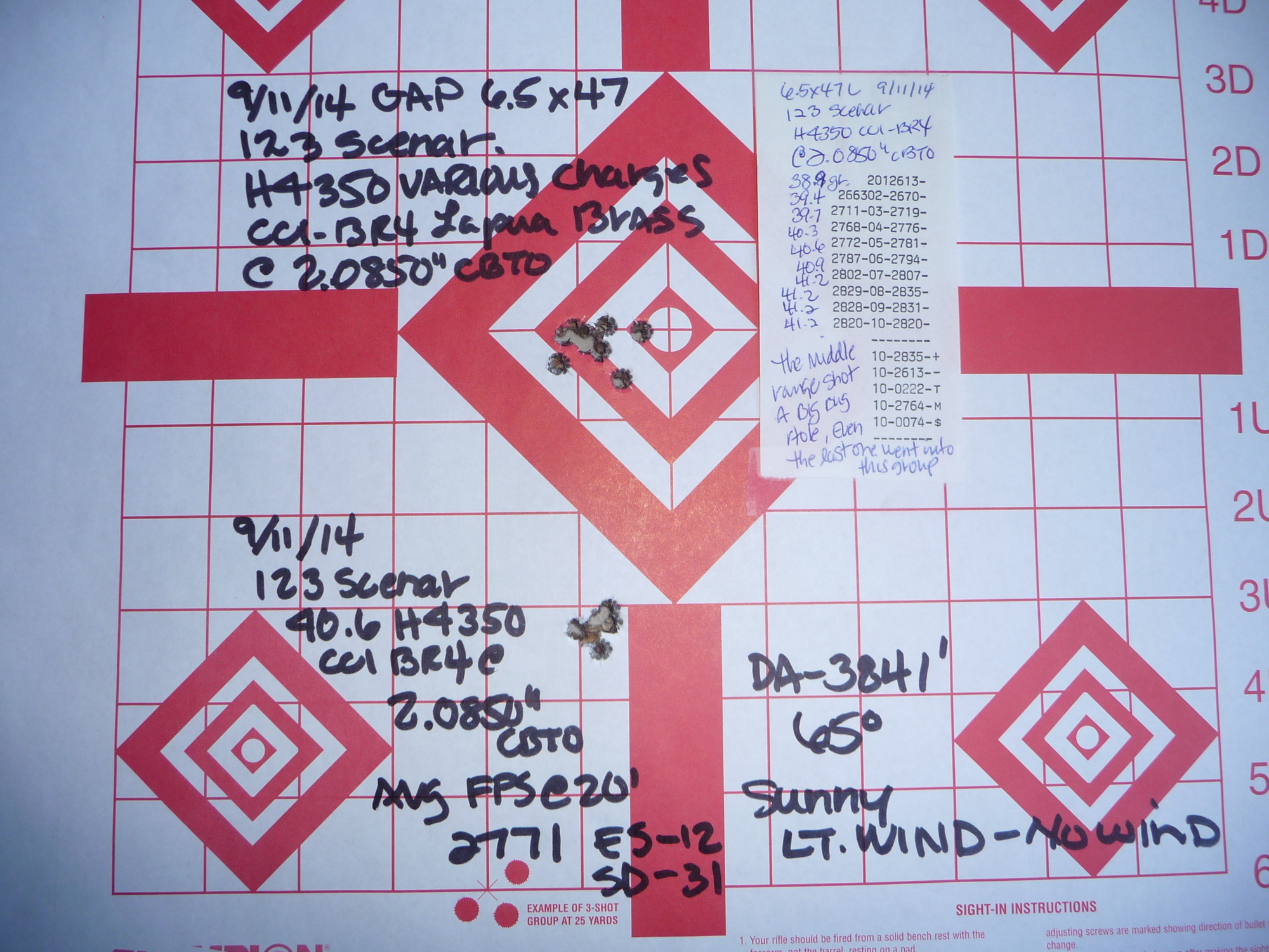

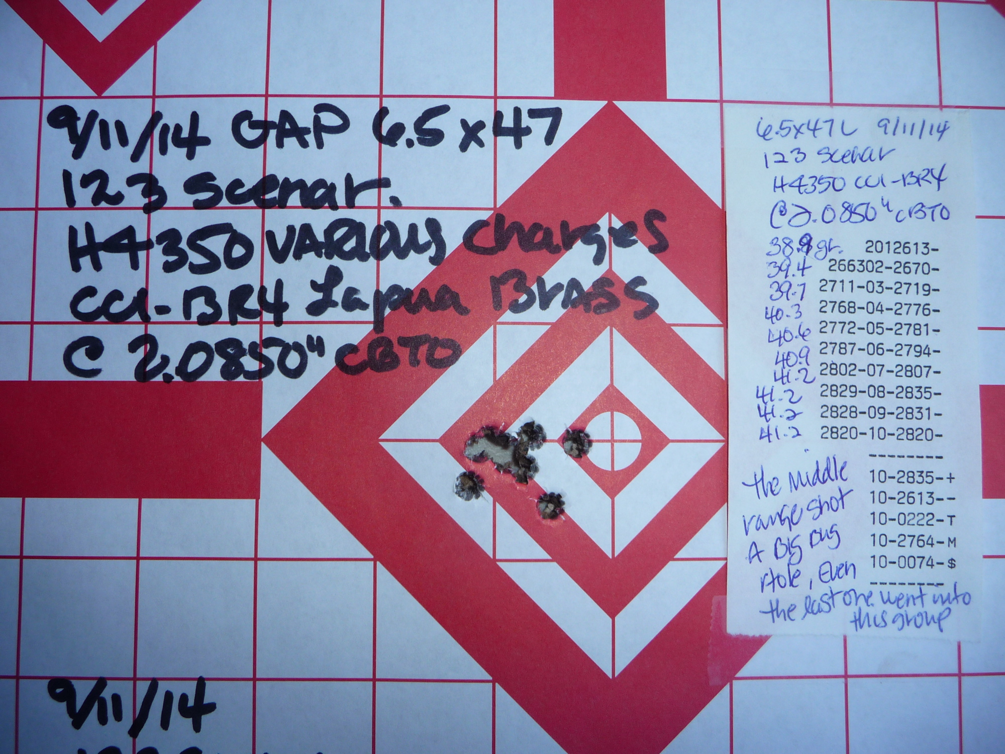

I switched from VarGet to H4350 behind the 123 Scenar after not liking the groups at 600 yards. Only thing was this powder required a lot of powder to even remotely move it along at a decent speed..... 41.2 grains 2829-2835-2828-2831-2820-2820 fps@ 20' from the muzzle from a 24" GAP built TR @ 2.0850" CBTO= .020" off the lands. I didn't go above 41.2 grains simply because the group opened up at lot at that charge weight and seemed too slow of a powder for the 123.
The best groups came from the middle of the range 38.9-40.9, I settled on 40.6 H4350 @ 2.0850" CBTO at an average 2771 fps@20' using my 35P. Which is what Lapua has their factory 123 Scenar ammo traveling along at......2790 fps.
