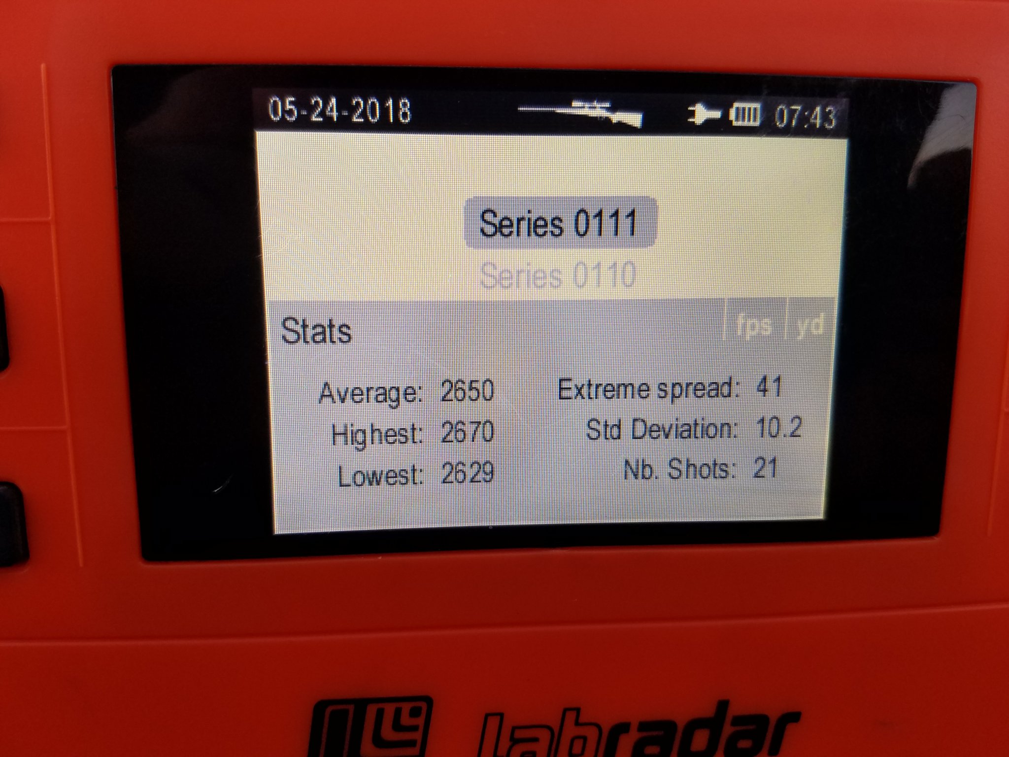

Ah okay, thanks for the answer. Looks like I am going to get one. Dracos is selling the 22" 260 Rem for $426, hard to beat. It sounds like I am going to need an AGK since I will be running my SiCo Omega the whole time.
I am trying Berger 140 Elite Hunters currently. 41gr H4350 is giving me 2630.

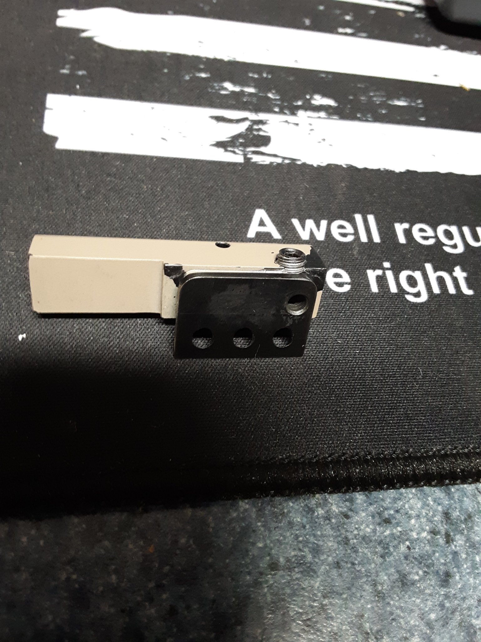

I'm not necessarily recommending that anyone does this, but I know a guy that made the gas block adjustable by drilling a hole just above the gas port hole, tapping it 10x32, and using a set screw to fill said-hole.
That same guy says he should have drilled it on the opposite side of the gas block for easier access, but it works very well. Running suppressed, it only takes one full turn out from bottom to get proper gas on a 6 Creed.
Reactions: LongRangeAggie
Very interesting, thank you for sharing. I wonder if Dracos would send a replacement if it were to not work out.
I saw someone say that each gas block is hand-fitted to each barrel or some such. I call BS. I have two and they're interchangeable. I recon they're just not set up to sell gas blocks individually and don't want to go through the hassle.
I have StraightJacket barrels, not Dracos (although similar in design); and I can assure you my gas blocks are in fact hand fitted. The gas block on the Dracos is also fitted in place, it's only half that comes off, I believe. 3 screws if memory serves.
yes, the block dovetails into a special collar thing in the jacket and is held there by 3 screws. On the two barrels I have, they are identical as far as I can see. I guess I never put the calipers on them, but they are interchangeable. Each fits and functions perfectly on the opposite barrel.

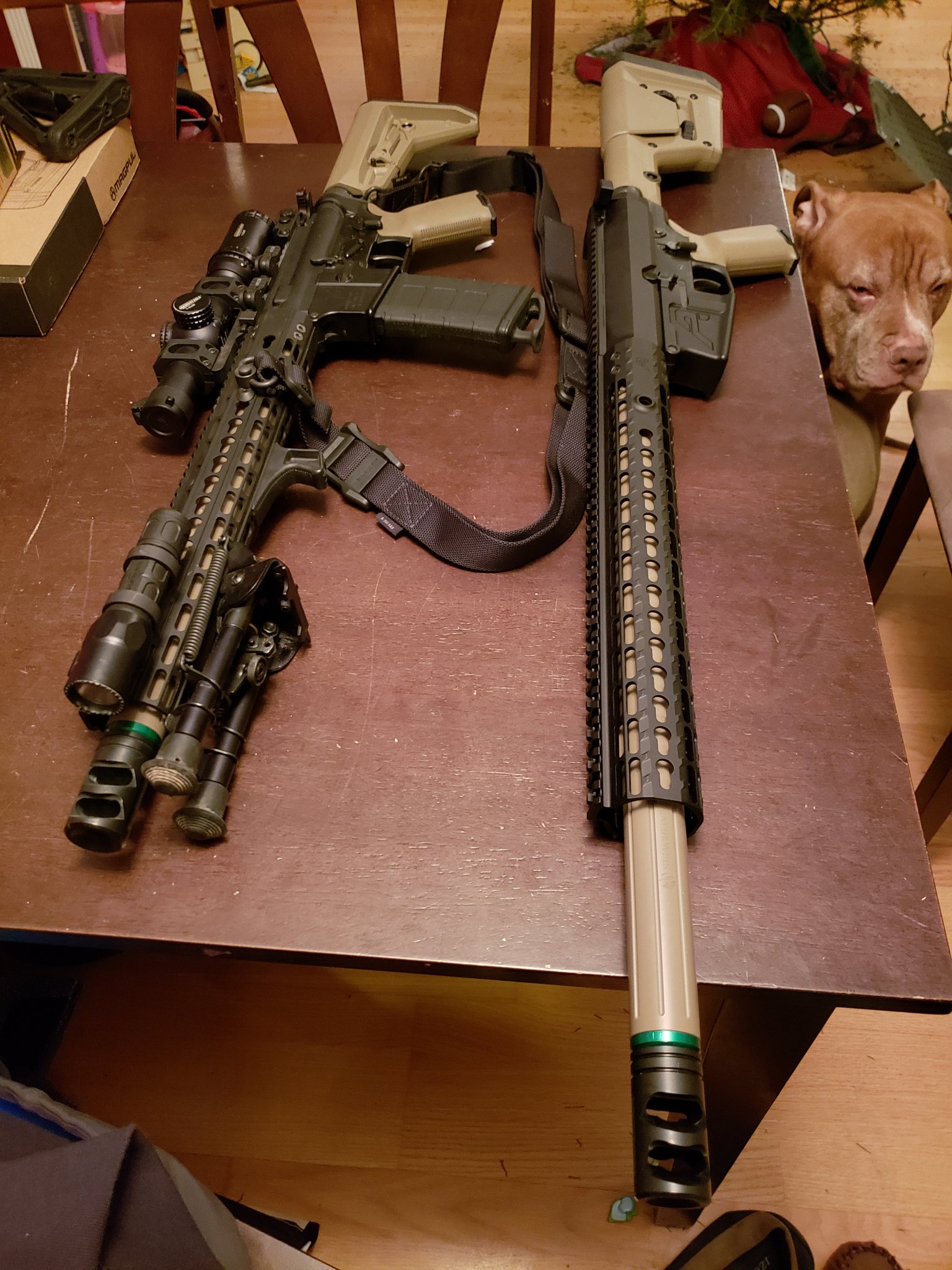

On my jacketed barrels, it's an actual gas block fitted in the jacket. The reason the Dracos is like that, is so you can slip a barrel nut over it, then attach the gas block. My barrels nuts are fixed behind the jacket. Commits me to one type of handguard for that particular system, but I'm ok with that
