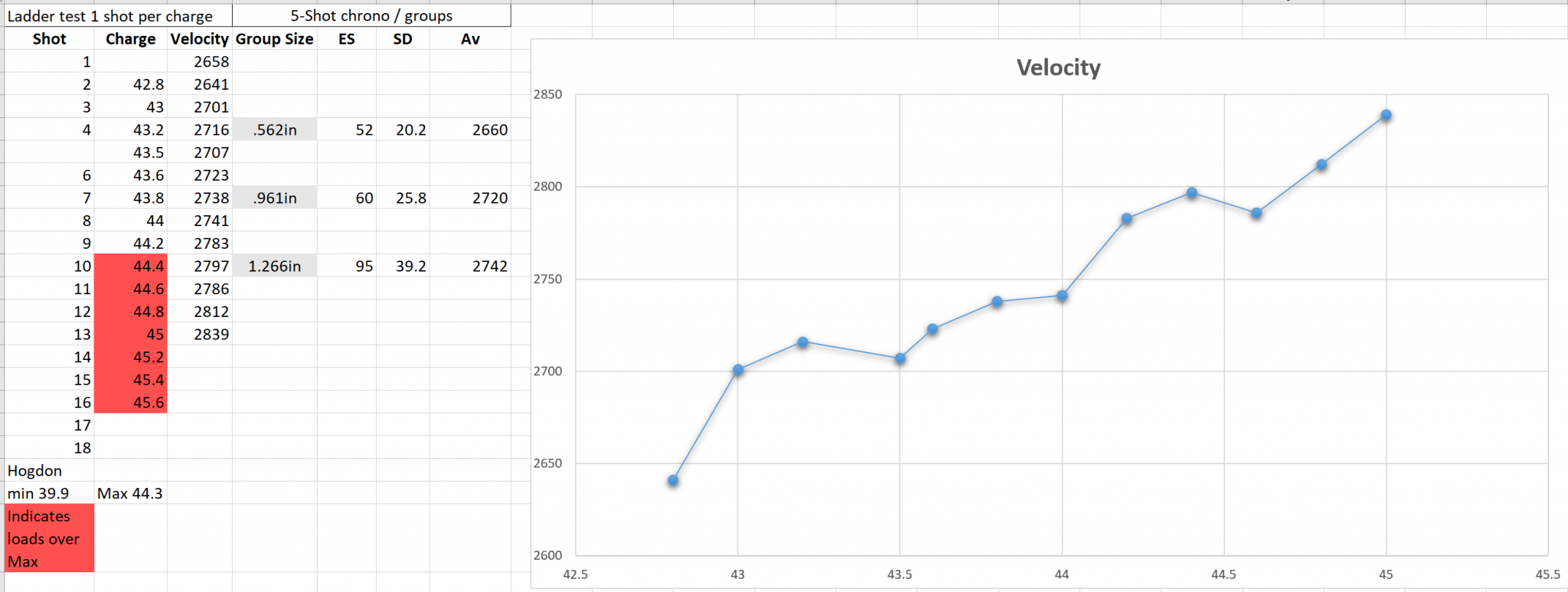

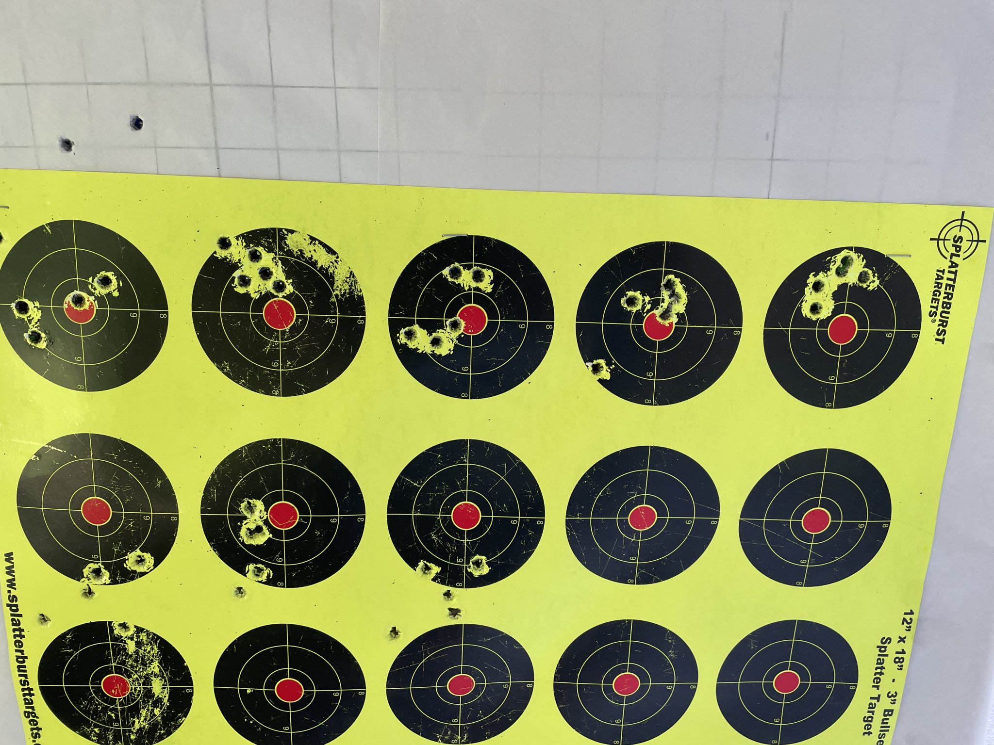

I am working on some 130gr RDF and StaBall 6.5 loads and getting mediocre results. I thought I would share and see if you had any recommendations as to how to get some better SDs with good velocity. Don't mind the group data too much as it was super windy and my target stand was moving and shaking a bit. Being shot from a 22in 1-8 barrel using Hornady brass and cci LR primers, sizing with a Redding Type S full length bushing die with .289 bushing ( I also have a .288). I have not seen any pressure signs as of yet so I am tempted to keep going up.
And on another subject has anyone had luck with the Hornady 140gr BTHP in a gasser?
I appreciate that as I have seen some of your data on them (sadly after purchasing). The problem is that I have 440 to use and only about 3 weeks to prep for a gas gun match. luckily the targets are generous in size and 90% will be 800yds or closer so even a 1-1.25 moa load will be ok. Any ideas/help will be greatly appreciated. And In the mean time I will continue my search for the 130 hybrids.First thing I would do.... ditch those 130 RDF's. Dead serious. I did extensive testing with them in both 6.5cm AR and 6.5x47L and they shot like shit for me in both SD's and accuracy... Thought something was up with my gun honestly they shot so bad. I ended up shooting some known loads with 130 Hybrids and one hole and SD's of 2.. Ditch them. I have had ZERO luck with them in 6.5 and .224......Im also not the only one if you dig up the 70 RDF and 130 RDF threads...

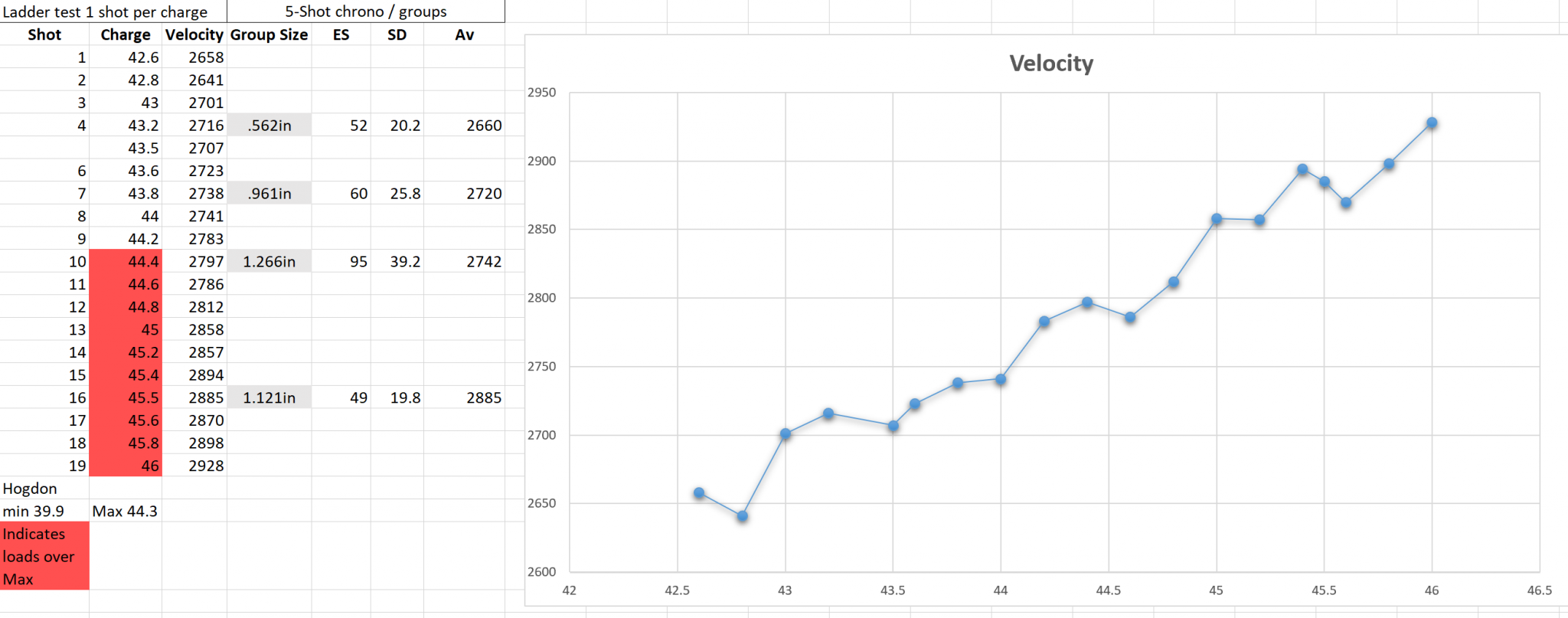

I am going to give it a try and extend the ladder test up to 46 in point .2 increments. Hopefully I see a flat spot. The case is still not totally full even at 46gr. I also have an AGB, no can though. I will hope fully be able to test them out tomorrow and report back.I'd keep going up into the 45.0+ range.
I found my sweet spot at 45.6gr with the 130gr Berger AR Hybrids.
