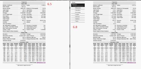

[MENTION=56901]Bradu[/MENTION] [MENTION=9621]Downzero[/MENTION]: My bullet has a bc of .496, the 123 a-max has a bc of .510. I already sent the data to graham. Whether he will read it and interpret it is up to him. I plugged my data in with comparable 6.5 data. How about you do the same, I'll give you the info.
6.8 spcii
130 berger match classic .496 bc
2550 fps
6.5 grendel
123 a-max .510 bc
2495 fps
Plug that in and tell me what happens.

Now you are selecting information - bullets and velocities - to make yourself appear to be correct.
YOU sent me a link with information on it. I merely used the information you provided. NOT my fault you can't find supporting data. ALSO, don't give me any bolt gun shot loads, because the grendel gets cranky when you want to push it too much out of an AR.
You sent me a link to a specific thread with specific velocities of bullets being shot out of a 6.5 grendel with an 18.5 inch barrel. I can attach said message if you forgot what you sent. Why can you not accept the fact that a 6.8 will out perform a 6.5? I never said it will out perform it in every way, shape, and form, but it still has the capability to out perform it. Obviously there are certain bullet combinations with the 6.5 that will make it out perform a 6.8 and vice versa.
Now you are hedging: 'Never said' 'in every way' but 'still has the capability' to outperform....
Sure: The one high BC 6.8 bullet, at a higher velocity than a very low BC, lower velocity 6.5 bullet, will get you close - at those velocities under those conditions in an unequal comparison.
