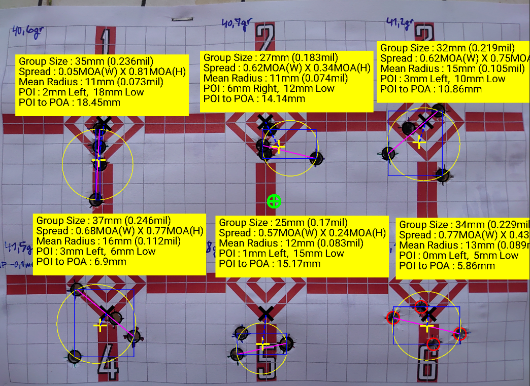

Hi all,
This is my first attempt to reloading, sorry about the lengthy post and bear with me if something sounds stupid
Tikka T3X TAC A1 6,5 CRMR with original Tikka 24" barrel (486 shots before these)
once shot Sako LRP Brass
- Demprimed and then ultrasonic cleaned
- bumped shoulder back 0.002" to 1.558" (Datum) and FL-sized (Redding Type-S Match dies with 0.289" bushing) trimmed to 1.910".
CCI 200 LRP primers
Hornady ELD-M 147gr
Seated the bullet to 2.265" CBTO, which is also close to my Mag max length
Powder is Vihtavuori N555, as there was no loading data available I shot one shot 38-40 gr in 0.5gr increments to test for pressure and then proceeded to shoot 5 shots in 0.3 gr increments.
Unfortunately my labradar died (battery) after the first five shots of 40.3 gr so I shot one shot each load to test for pressures. That's also the reason why i shot 4 shot strings today. The 40.3 gr gave me AVG=773m/s / 2536fps (powder temp +27C / 80.6F)
First I shot the CB and fouled the barrel with 5 shots of Sako Range.
Range was 150m / 164 yards, after 41.2gr i took 0.1 mrad down to avoid aiming at the POI. Waited about 10 min after every 4 shots to let the chamber and barrell cool down a bit.
40.6 gr (Powder temp +18.7C / 65.7F)
AVG=778 m/s (2552fps), ES=6, SD=3.0

Colours are not that visible in the pic, but:
1st shot = Green
2nd shot = Red
3rd shot = Blue
4th shot = Brown
Didn't get any clear pressure signs and I'm okay happy with the velocities (Tikka barrells are somewhat slow). I'm not happy with groups, but the shooter is a bit rusty here aswell with couple of flyers that were obvious before going to the targets :D
What do you guys think?

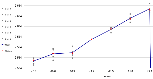

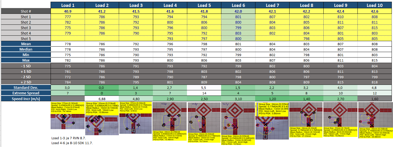

Graph out your distributions, check where the mean of each load looks to be tight as a distribution (low variance) and the groups around each distro looks leveled out. You are looking for a node that is in a stable region that up or down will give little impact and give you the velocities you’ll want to keep the bullet stable at distance. From there fine tune that node up and down to make sure it is in fact stable. After that use that load and begin testing your seating depth. Start long then bump back with the same process above.
Reactions: Waltjaevel
I'm not totally sure if I understood you correctly.
I uploaded the data to the 65 Guys spreadsheet:
From this data I don't see a clear node between two increments 0.3 grains (other than 40.6 and 40.9), the variance between velocities within 41.2 and 41.5 seem to be smallest - Am I getting it?
You’re correct. Outside of the lower node it doesn’t look like you have a significant node yet. If you aren’t getting signs of pressure i would maybe keep going up. You COULD also run a ballistics simulation for the powder, bullet seating depth etc variables on Quick Load OR my new favorite Toy Gordon’s Reloading Tool: Link

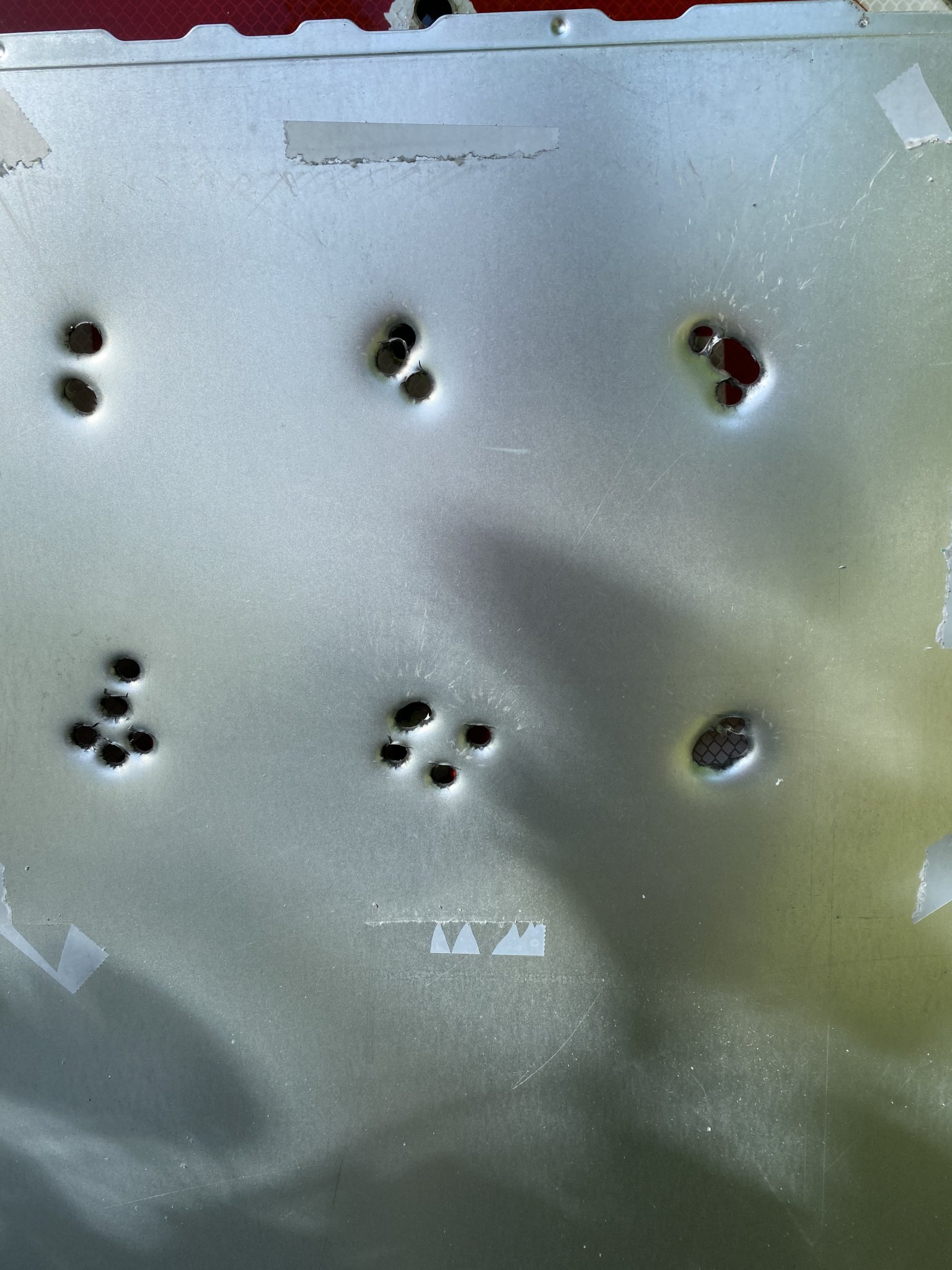

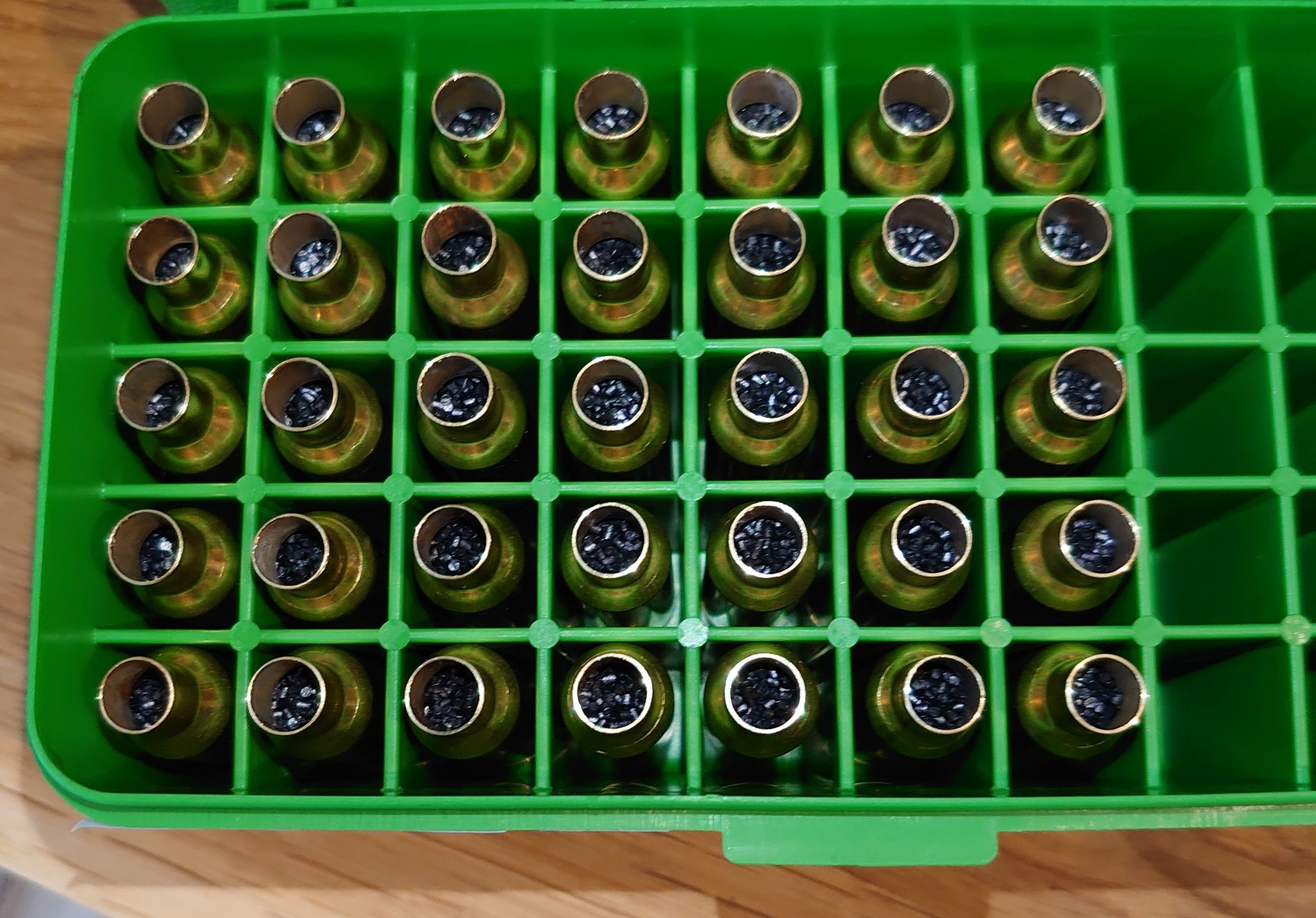

No pressure signs. Had a experienced mentor with me, because of 15 years of shooting government guns I think I wouldn't notice a heavy bolt lift...
My only concern is that if I add more powder, the cases are getting quite full. And if the next step is adjusting the bullet more into the brass, I might get more pressure / inconsistent bullet seating?
On the right side corner in the pic are the 42,1gr - is there enough room for more of the good stuff?
Im not a ballistitian (sp? But I am an engineer) but I’d say you might not have the proper powder and bullet / load combo for your rifle. You may need something that’s faster burning bc you could be “leaving something in the tank” so to speak w h4350 and that short of a barrel or heavy of a bullet. So I’d say maybe try a lighter bullet, 130, 135, 120 and maybe a faster (burning) powder like Varget. You may get better nodes and results…. 🤷🏻‍♂️
Reactions: Hkmiller

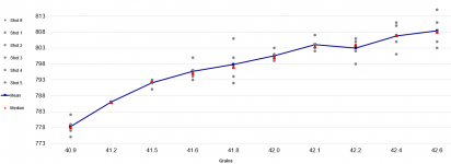

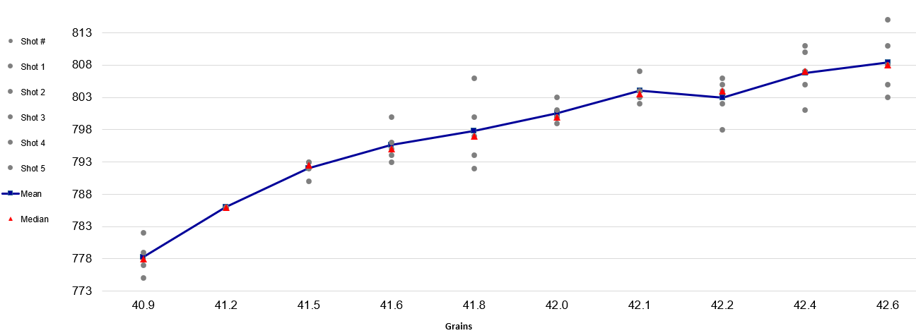

So i went ahead and loaded 5 rounds 41.6 - 42.6 gr in 0.2 increments.
CB + 4 shot group first and then 5 rounds, waited the barrel to cool down between shot strings.
Different range (still 150m), +18 C.
No pressure marks.
I integrated the results to the previous data sheet (yes I know, increments vary) :
I consulted my mentor and I think I'll be going forward with 42.0 gr.
Going to load 5 rounds current CBTO (2.265") + 5 rds CBTO-0.003" + 5 rds CBTO-0.006" and test for the best group
Am I heading to the right direction?
No pressure marks.
View attachment 7910204View attachment 7910205
(Edited and got rid of lots of nonsense)

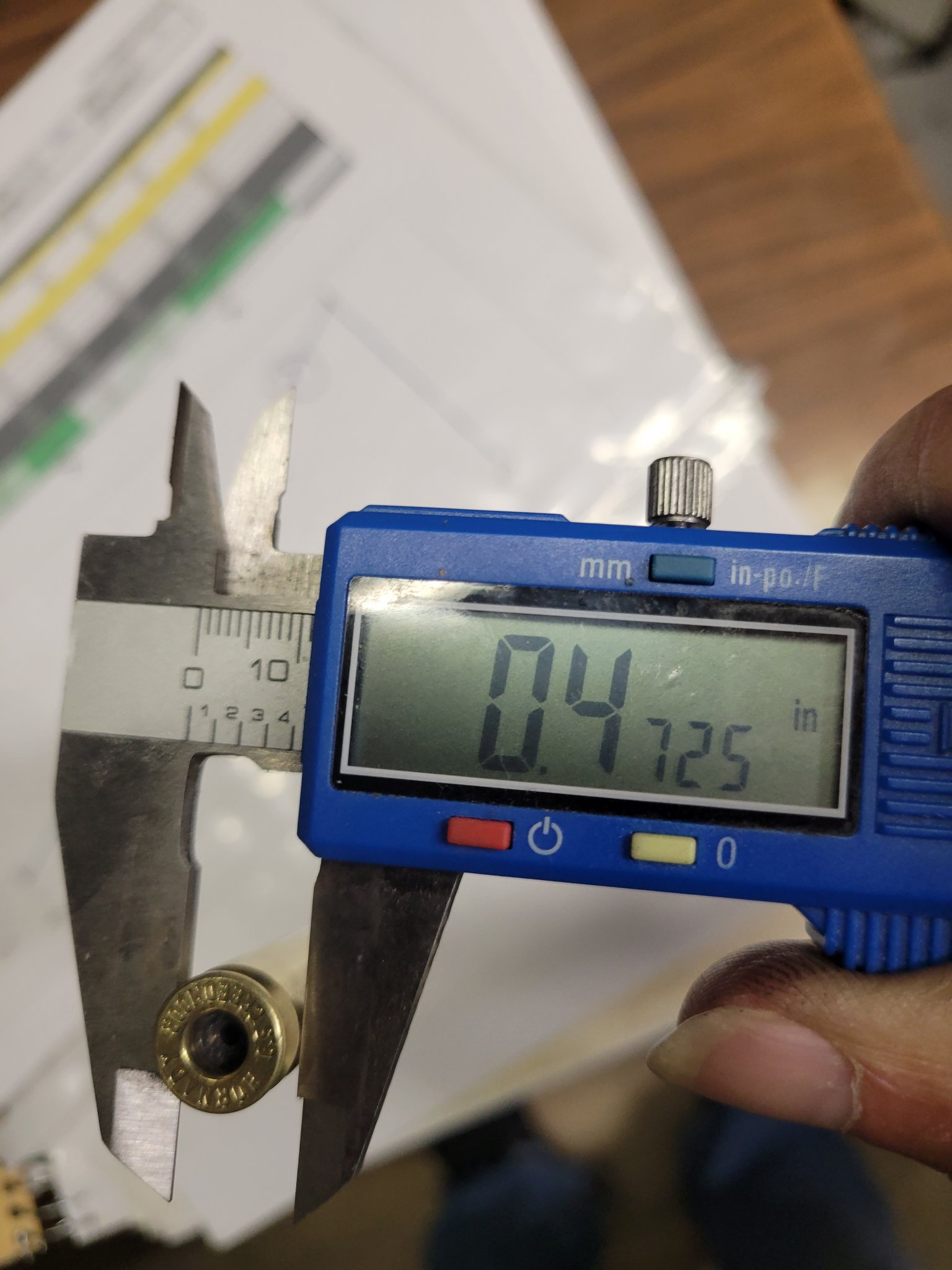

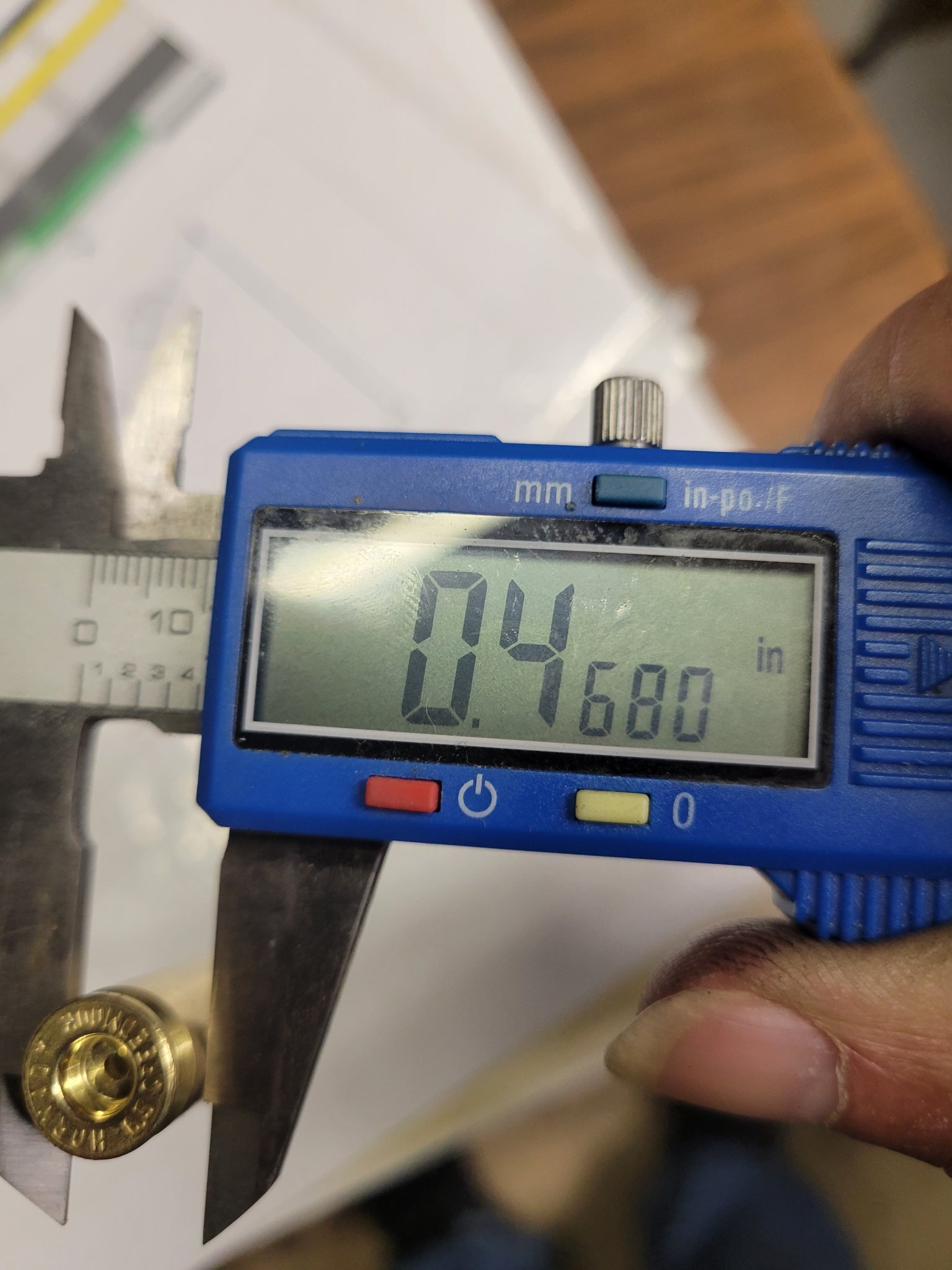

i have a question or 2 though , can you adjust neck tension with full length sizing dies? and does budlging at the base of the case ie near the primer suggest case wearing out??? have had case start to bulge at the base
Yes, If you change the expander ball or mandrel that you use. The outside will get squeezed a fixed amount, so how far you open it back up controls tension.
After firing, or after sizing?

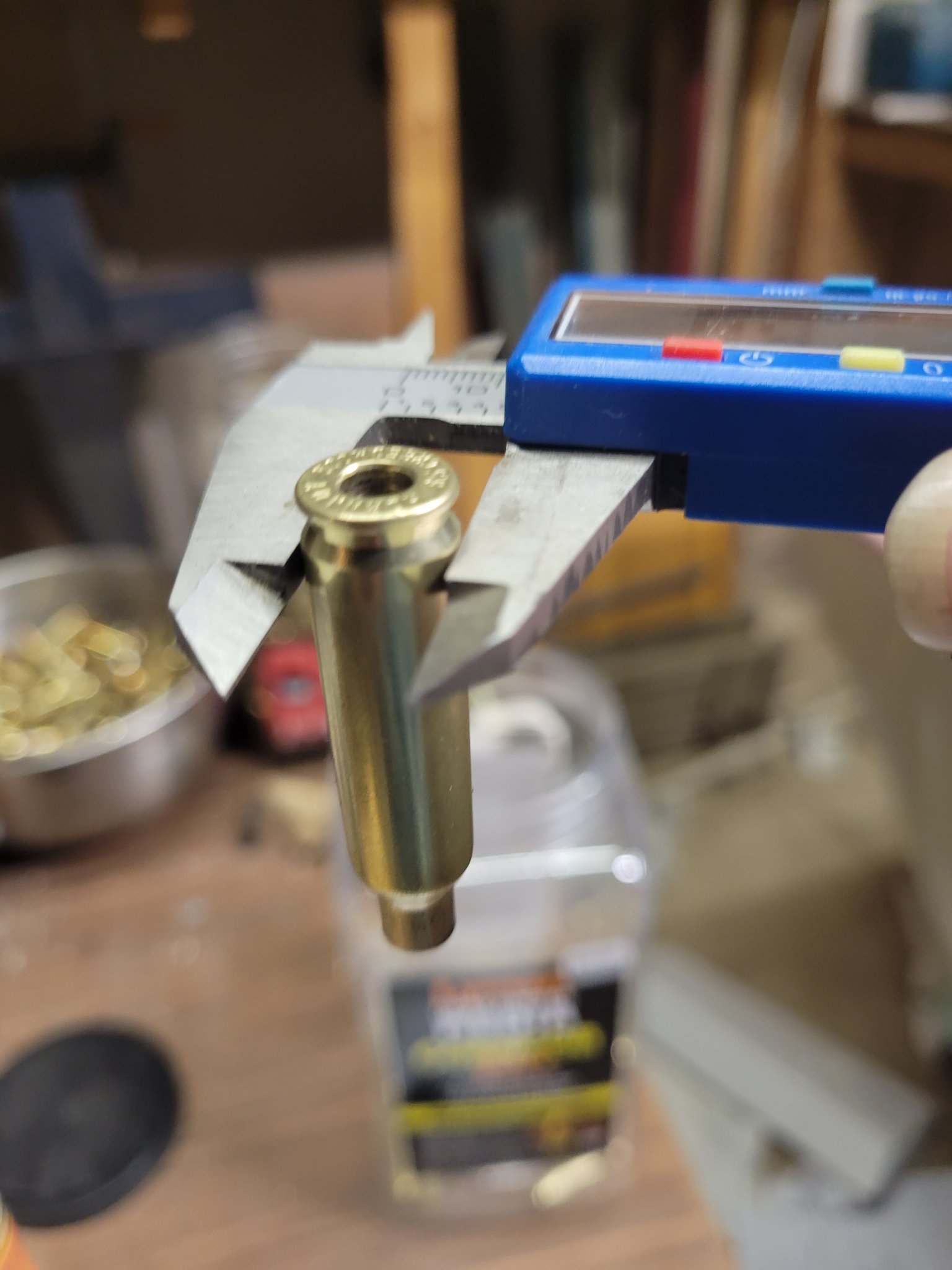

when full length resizing, some of the case, sizes with no problems, but other case is really tight in the neck and hard to press?? and those are the ones that have the bulge near the case head, any thoughts????

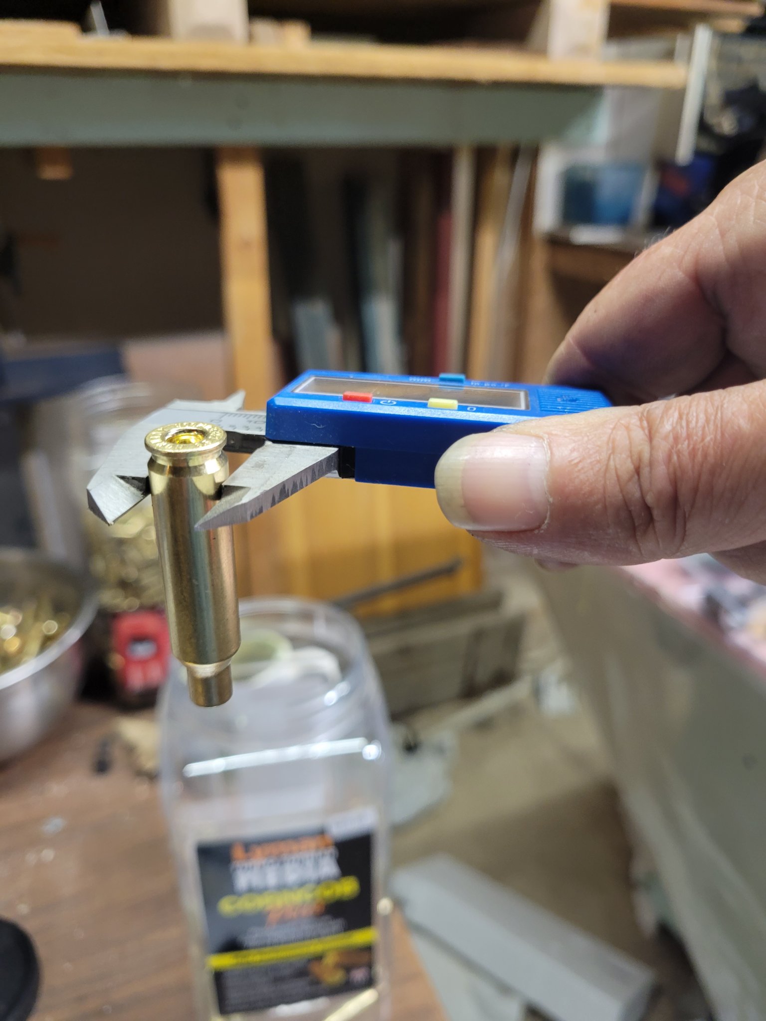

Have you measured the head space of your fire formed brass yet and adjusted your shoulder bump? Are you using enough and even lube? Do you have pics of the case bulge? Are you seeing pressure signs on the brass? Swiping, cratering, etc…?
i go 2thou back on the bump always, always use lube on the brass,the brass always looks scratched no pics right now, the head of the case looks like its bulging where there would be case seperation but no cracking
“Brass always looks scratched” is that after firing, or after sizing? Sounds like a lube and die galling problems, but pictures and a full description of your process and loads are needed, otherwise you’re going to get a less than useful back and forth.
ok got it figured out found out one of my die bushings for my sizing die is worn out, which means everytime i resize a case my die is lifting up some. so as the pictures show on a case that is still good the diameter near the case head is .4680 but sizing now with the bushing issue the diameter near the case head is .4725 which means it wont go into battery and gets jammed in the chamber.so most of the case is resized except for near the case head. had to order new bushings for the dies but have figured out the bushings are made of aluminum and keep wearing out. so went out and bought a rcbs rock crusher single stage, and use it for just resizing the case with. but the case with all the problems now wont size and chamber. so lost about 300 case this week!!! oh well live and learn!!
No pressure marks.
Yes you are on the right track: Speed graph is rather flat in this area, and SD nrs came way down too, and that is a very good sign.
I would redo 42.0, 42.1, 42.2 and 42.3 gns, using 5 shot groups, and see 1) Does the flat spot repeat in the same area (at different ambient temp), and 2) Is SD still small, and where is the “middle of powder node”? Ignore group size for this step.
Then optimize seating depth in increments of 3 thou, like you proposed, being very careful with your shoulder bump: Errors in shoulder bump changes actual distance to the lands, since the case indexes off the shoulder once inside the chamber. Put aside any cases for now where the case head to shoulder datum line did not come out correct. Around 1.0 to 1.5 thou is about as best you can measure with calipers. Turn the case with your fingers until you get the minimum measurement.
You should be able to shrink your group size a lot via seating depth optimization. A barrel tuner does the same job btw.
When reconfirming your powder node/speed flat spot, wait for a colder or hotter day: If your chosen powder is rather temp sensitive, you may see the powder node move to a different value, but check the speed, it should still correlated well with the speed you saw before (if your crony is top accuracy, so Labradar or Magnetospeed). [Remember that mounting your Labradar at a way different distance from the muzzle every time will cause a speed error, which could confuse your experimental data.]
If the associate speed of the flat spot is consistent, but the required powder charge moves with ambient temp, then you could still figure out a correction in powder charge to compensate for hotter or colder weather. Load more than one batch and pick the most appropriate batch based on the weather prediction.
If the flat spot does not show up this time, then the data from the previous test (or this test) was just blind good luck (or sadly bad luck), and you need to keep looking…
But: Looks like you might be close… Best of luck!
You could try to rescue your old brass using a small base die. Use lots of lube.
If the web area and primer pockets have expanded, often a sign of over pressure loads, it likely won’t help, but still worth a shot. Brass is expensive, and a small base die will prove to be useful in future (e. g. if a replacement custom barrels has a tight/march chamber), and they are not really expensive.
Best solution: There is a thing called a “ring die”, that is designed to resize the web area. Patriot Valley Arms used to make one, but it seems they stopped. Don’t have one, but would love to have it in reserve…

I got my hands on h4350 so i have staball and h4350 where would you start with that powder i read a lot and that powder was considered to be the best for 6.5creedmoor with the srp brass thanks for your help
Both are good:
Perhaps use Staball for plinking/practice loads, since it is far easier to get. Also very convenient and fast to load. Of all the ball powders, it is the least temperature sensitive, and it meters very well, so you can use a cheap $30 Lee powder measure to throw the charges, no need to weigh and trickle up each one, as long as you are not super close to a max load. Will be on par or slightly better than factory ammo with an SD of 12-16 fps. Saves a lot of time in the reloading room. I got charges thrown to within 0.2 grain, which is plenty good out to 400 yards. Depends in where you live, but you probably will need a winter and summer load, and that is perfectly fine (if you have access to a crony). Should be a good practice load.
Maybe use H4350 for the 600-1500 yard range, it often produces the best ES, and is very temp insensitive. It beats Staball by about 3x in terms of temp stability. No need for a different winter and summer load. Not hard on the barrel (compared to say double base powders like RL-26), less speed but more barrel life. Generally very accurate in 6.5 Creedmoor. But very hard to find. IMR4350 is similar but not identical, and a viable alternative, but powder charge needed for the same speed will be about 0.6 gn different. I would save H4350 powder for the more serious activities. Very good powder, but can be hard to find.
Enjoy your rifle, and be safe.
