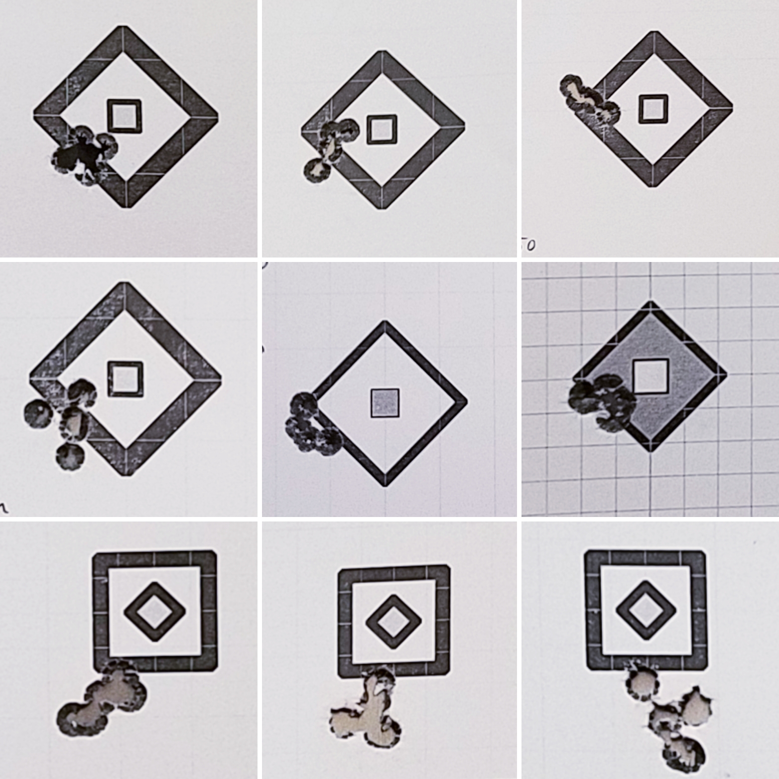

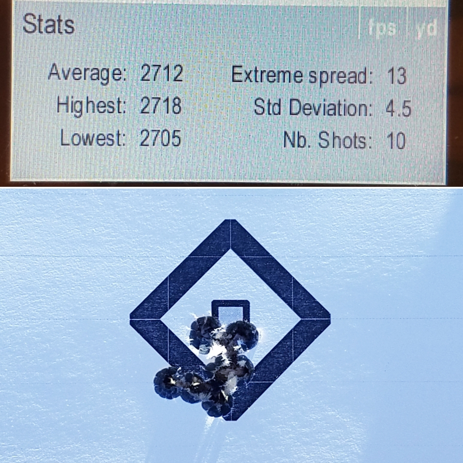

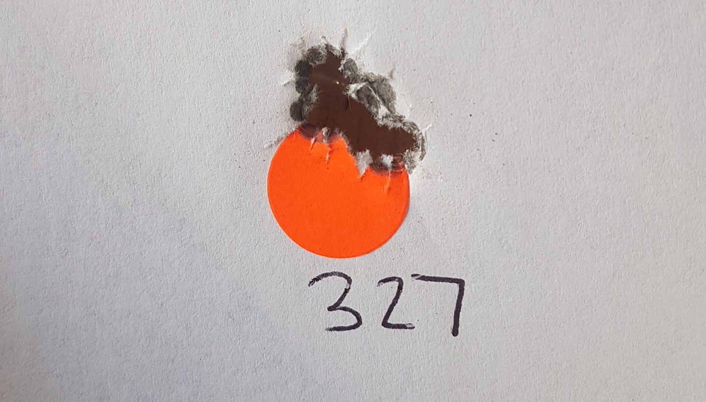

This was 6.5cm 142 smk PRIME yesterday, shot very well <0.5moa, 1-8, 5R, 26" barrel, 2600 seems slow even for a 22"?

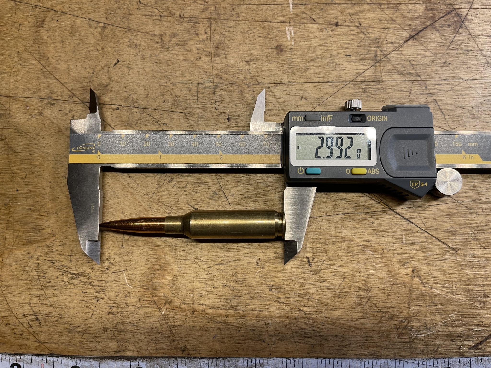

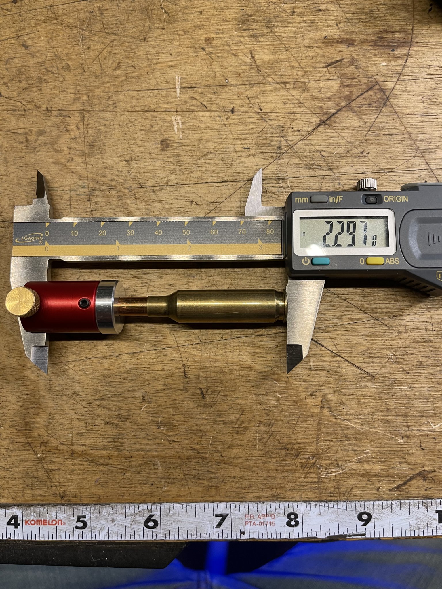

Quick question. I have searched. F@#£ all info anywhere really. Chopped one of my 6.5CM barrels to 16 inches for something different. I’m in Australia so my appropriate powders are Varget or H4350. No RL 16 etc. Is Varget best for short 6.5? Playing with the 123ELD-M…. 38.9 Varget gives 2750fps but that’s very mild and will move on up, and 43.3 H4350 gave similar. My usual 140 ELD-M load of 41.9 H4350 gives me 2620fps. My PRS comps only go out to 500m so thinking this willl be a fun rifle for it. So is Varget best for shorter barrel with lighter bullet? Cheers
Lyman published a " Long Range Precision Rifle Reloading Handbook" and in it they list loads for the 6.5 CM. for the 123 SMK, they list 38.4 gn. of Varget as their "accuracy" load.
Don't know if you have access to RL 15 or it's equivalent, but I've had good results with it and the 123's.

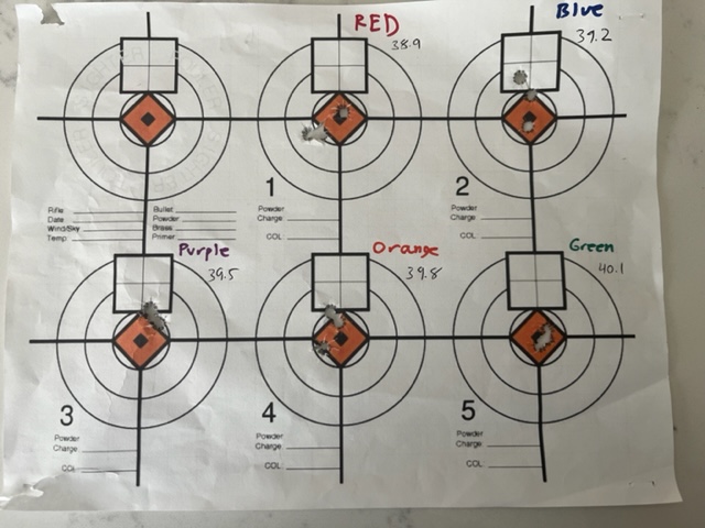

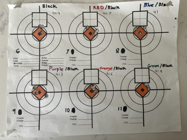

First time reloader here. Possiblity stupid questions to follow. I am wondering if I can get some advise on interpreting some data I gather during a OWC test.
The targets have the charge weights written below the colors. There are three shots on each target.
I am using the following components:
H4350
140gr. Hornaday ELD-M
Once fired Lapua Brass
Federal 210M primers
These were fired from a stock RPR (24" barrel).
I am tempted to use the node at 41.6-41.9gr for the next round of testing but I am a bit concerned since this is above the 41.5gr max powder load I am seeing from Hodgdon and on this thread. I did not see any obvious overpressure signs; the bolt lift was normal and the primers looks normal. I am also worried about a lower barrel life with this load. Otherwise, the next best node I am seeing is between 39.5gr and 40.1gr.
Should develop a load between 41.6-41.9gr, should I try between 39.5gr. and 40.1gr, or should I try something else?
It is hard to interpret 3 shot groups. If you shot 10 3 shot groups with Hornady ELD-M what would they look like? Your big groups and small groups could just be luck. I shoot 5-10 shot groups during load development. Closer I get, more shots to prove it is real.
Without Chronograph speeds, it is also hard to see wheer the load is getting a consistent burn with low SD.
I would start with a box of factory 140 ELD-M and chrono it.
Load single rounds with same bullet and COAL and find the matching velocity assuming factory shot well from your rifle.
Load up 5 or more of that charge, .4 below, .2 below, .2 above and .4 above. Shoot and Chrono each.
Then you should have a good idea of where your sweet spot is. Then play with different COAL.
41.6ish is your load.
Same aggregate POI all the way up to 41.9, which is probably a bit spicy so I'd start at the lower end of it.
Also, put a minute of elevation on the gun and move your POI away from your POA. Put the rounds in the square above and stop shooting out your POA.
You'll be surprised by the results.
Personally I would stay under the 41.0. You have several great groups, I like the 39.5 or 40.1. I shoot that exact load in 2 CM with the exception of the brass, I am using star line and the both have accuracy nodes at the 2720ish FPS. I would run 39.5-40.5 in at least 5 shot groups AND run through a chrono to find out what it likes. Don’t spend to much time in the weeds looking for that perfect load. Find a load that repeats .5-.75 MOA and go shoot it till the barrel burns out!

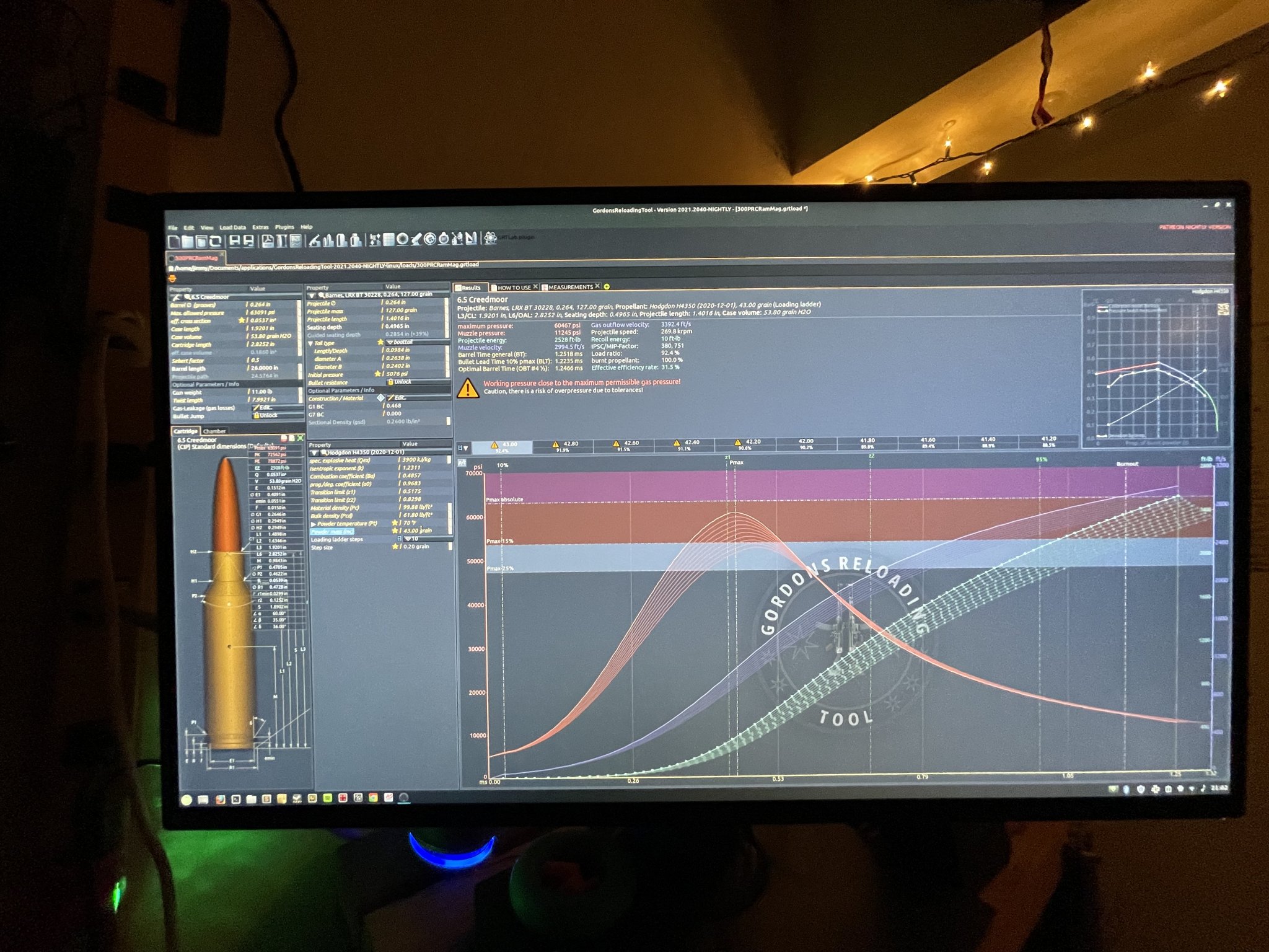

Have you tried running simulations? Such as Gordon’s Reloading Tool or Quick Loads? They aren’t perfect but can give you a good idea of about what to expect.
Here is simulations run for h4350 w 127 Barnes. From 43 Gr down to 41.2. @DEWD_STUFF let me know and I can send you an output file.
Holy cow thanks for the help! I have not tried quick load or Gordon’s.
