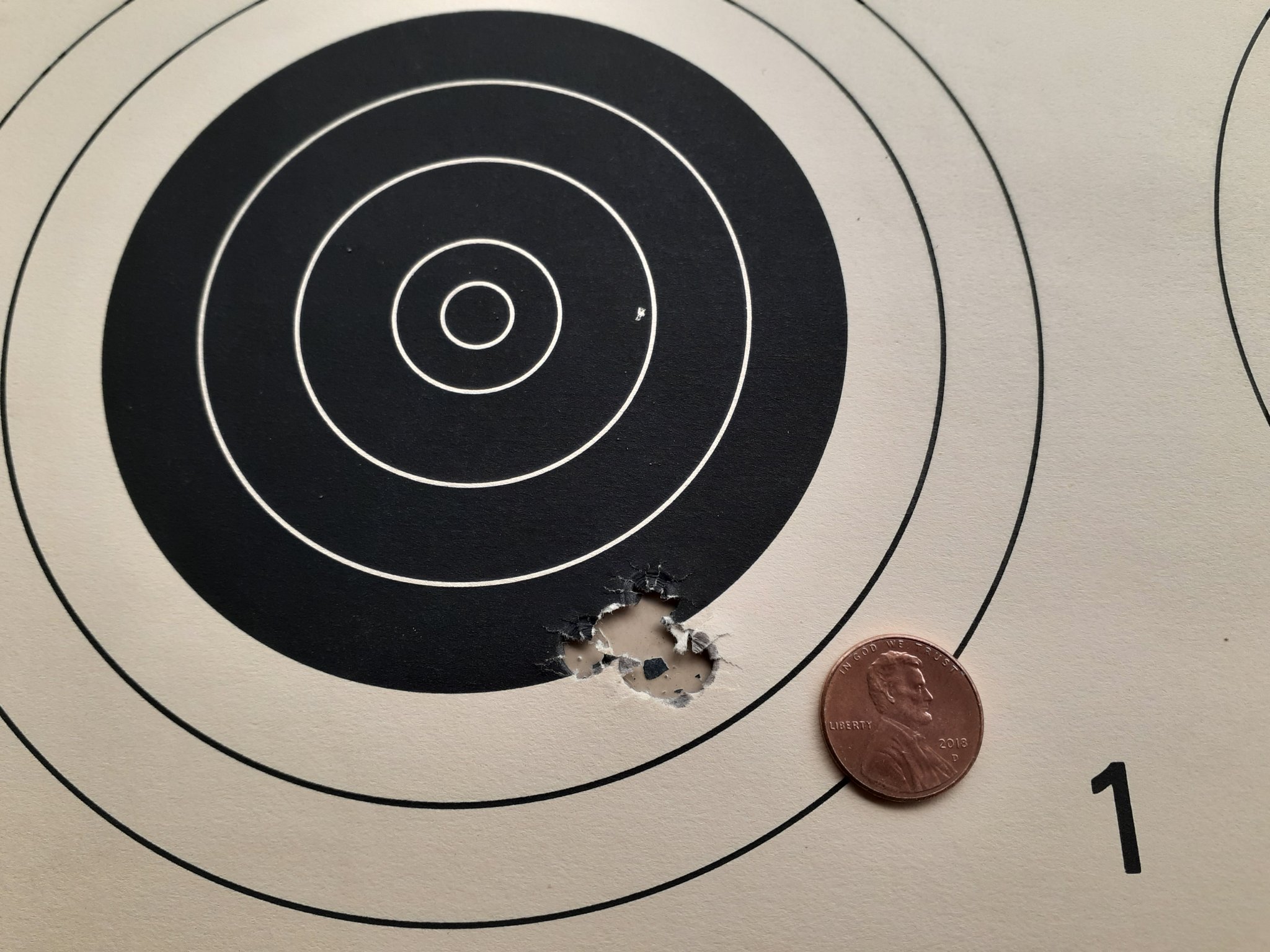

6.5 Creedmoor
140 MB RL16 42.9 Lapua sm primer brass 5 shot group
Reactions: 1588

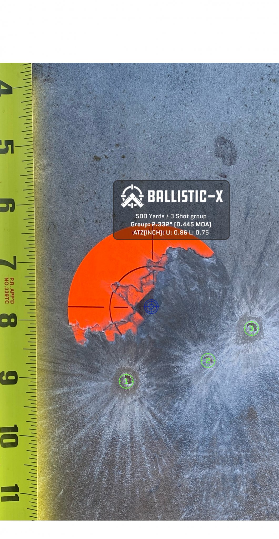

Trued the axial form factor in 4DOF of my 140 ELDM load at 525 and 780 yards Thursday evening. First 3 shots at 780 were .1 mil below the waterline. Re-painted the target and the next four wer .1 mil high. Repainted, pulled my head out and made the correction I needed, fired 3 shots without holding any wind, and heard 3 impacts. Drove down to the target and thought I only saw one impact. Had 3 shots in 1.5". My rifle is ready for the NRL Hunter match next week, hopefully I am.
40.5 gr Rl16. Peterson brass, CCI450, .055" off the lands, 2844 fps, Sd of 4.

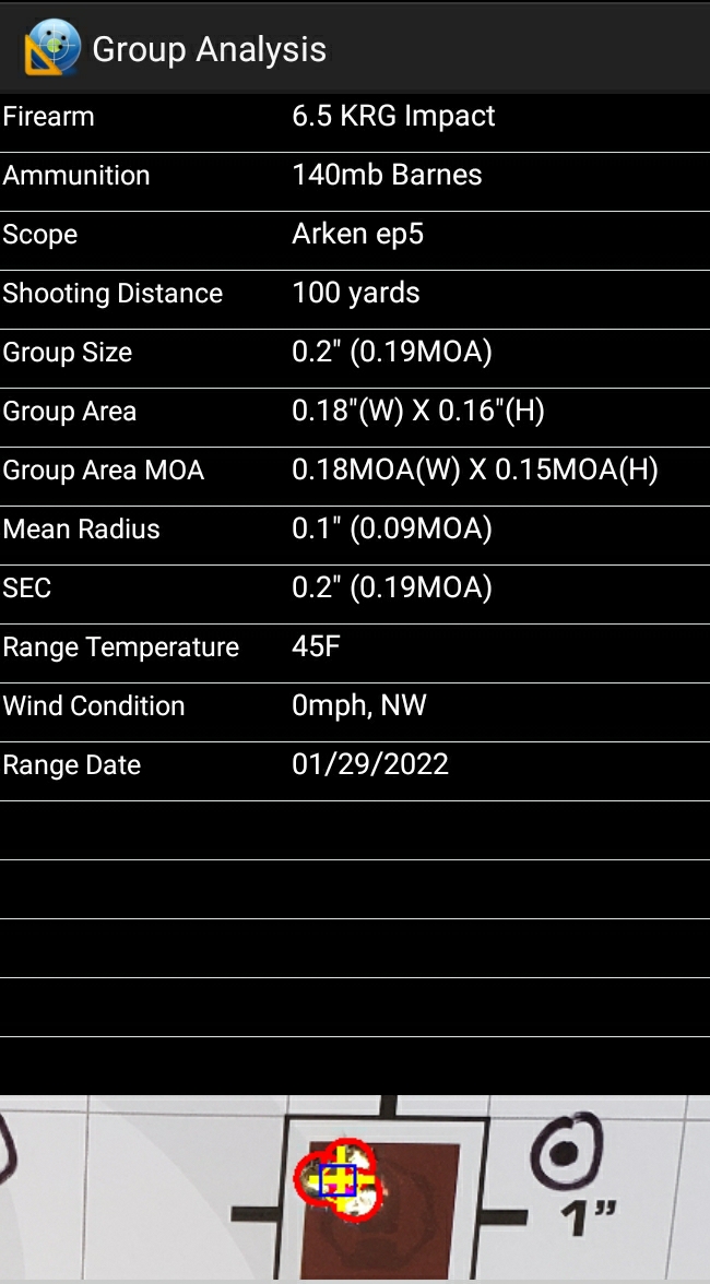

Just started hand loading august of 2021 and I’m deep down the rabbit hole at this point. Recently picked up a Daniel Defense Delta 5 at the recommendation of a friend.
Have 250 rounds through it so far. More on the gun later. Here’s the load I’ve found it likes:
Lapua SRP Brass
CCI 400 primers
40gn IMR 4350
142gn Sierra Match King
2.277 BTO
Got a personal best 5 shot SD (1) and ES (3) with this load cruising at 2600fps at 550’ elev and get groups consistently around .3 moa ..a little on the slow side, but I’m after accuracy for this rifle.

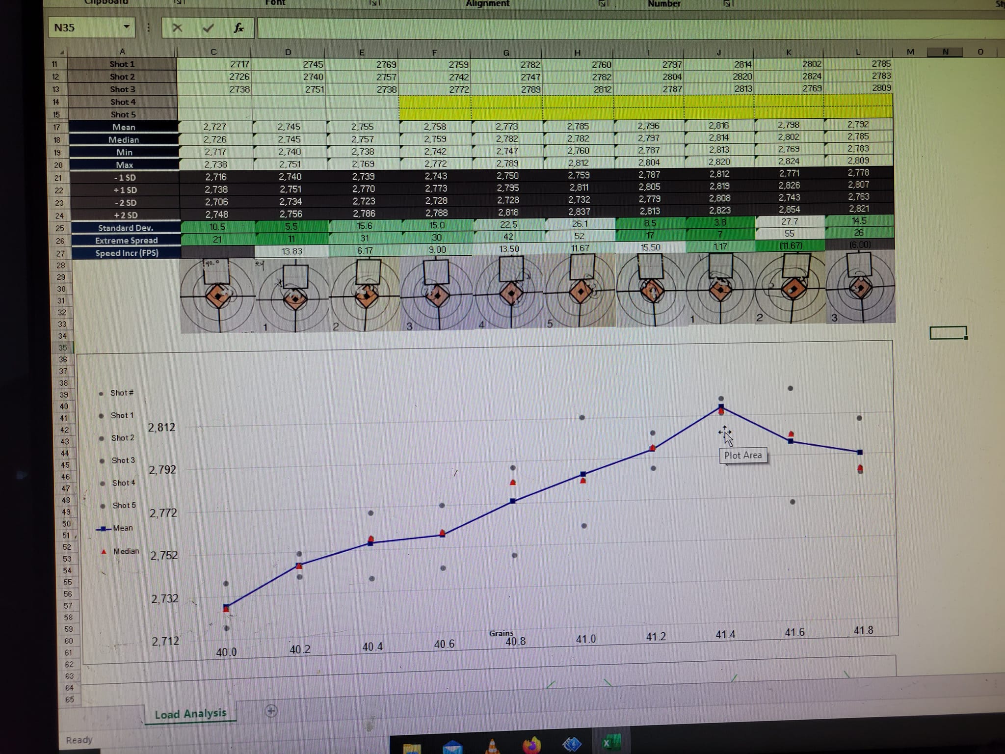

Usually 5x5 for powder ladder and then 3x5 for seating depth. There's something out of that looks good I will take that load out to confirm at least two more times to ensure that it repeats. So another 20 rounds. If it doesn't repeat then I revisit. But it really depends on if it is a new cartridge a new powder a new bullet a new barrel or am I just brushing up on a barrel I haven't shot in a year.
Typically you do the .5gr increments or go down to .2? I just picked up an 8lb'er of staball and have read the threads that it likes to be at or just a hair over book max. Going to be shot out of a 20"tikka ctr and i know they typically run slower

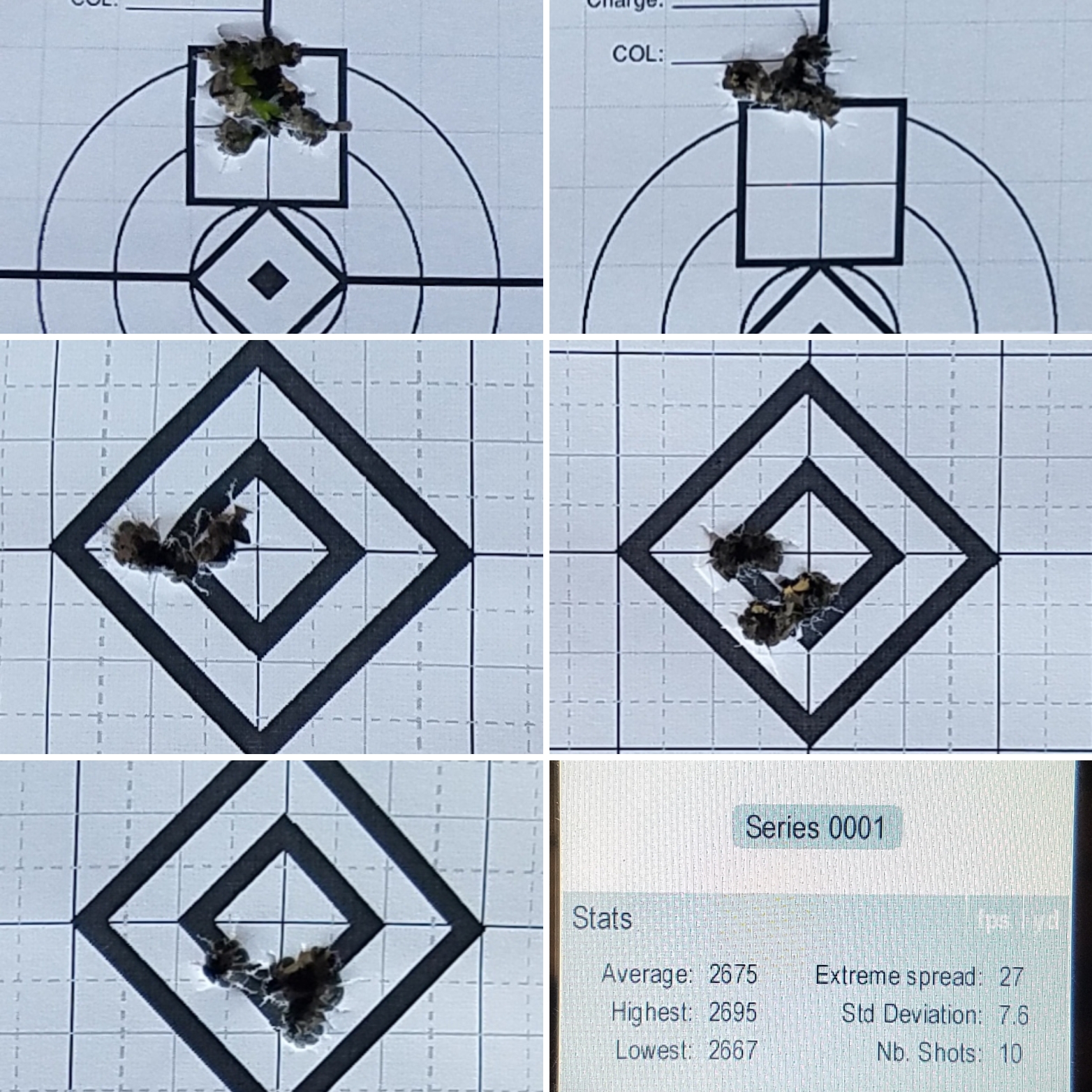

Shot my first 6 5cm loads today.
Pretty happy with the results.
I wasn't able to get to my regular reloading equipment, so I used my backup stuff.
My impromptu setup was a Lee hand press, old gem pro 20 scale, Lee PPM, Franklin trickler and a Lee die set with their collet neck sizer, of which I polished the mandrel in my drill stepping up to 5000g sand paper and light oil. It looks like a mirror.
I settled on
41.5gr H4350
Cci450 primers
140gr Eldm
Lapua virgin brass
I lightly lubed the inside of each neck with imperial wax and collet sized.
Cleaned the wax out with 99%iso and a qtip. Everything went smoothly.
Pretty happy with the groups.
Thought some of you may get a kick out of the minimal setup and results.
Btw, the targets with the large diamonds were not printed to scale. The 1 moa squares are more like .85moa
Top left target 10rds. All other groups 5rds
