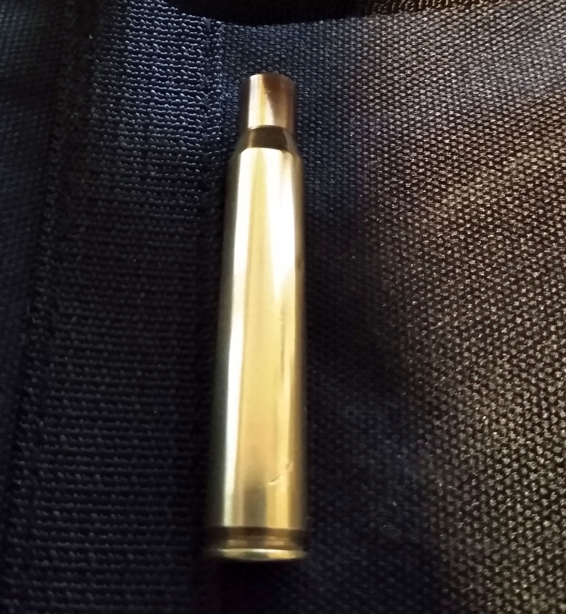

IF for no other reason de capping spent primers removes another source of carbon and even glass particles in some instances . Yet mainly to keep MY cleaning solution and method from unnecessary contamination and ease in the re-seating of New primers . Easy enough to use a universal de-capping die and therefore NOT use a sizing die .
I use a 3 transducer commercial variable frequency ultrasonic cleaner and Nothing I've found cleans better or quicker , From funky UGLY to Super clean inside and out in 3.5 minutes or less for Normal cases :)

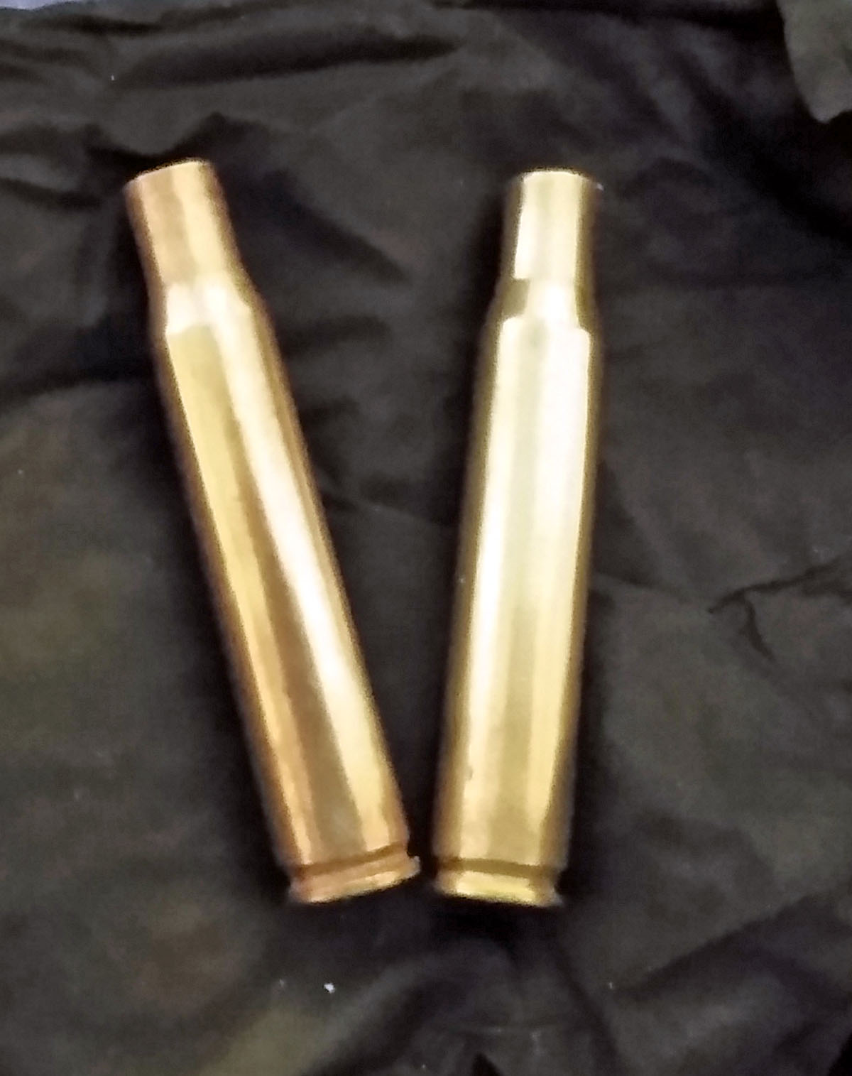

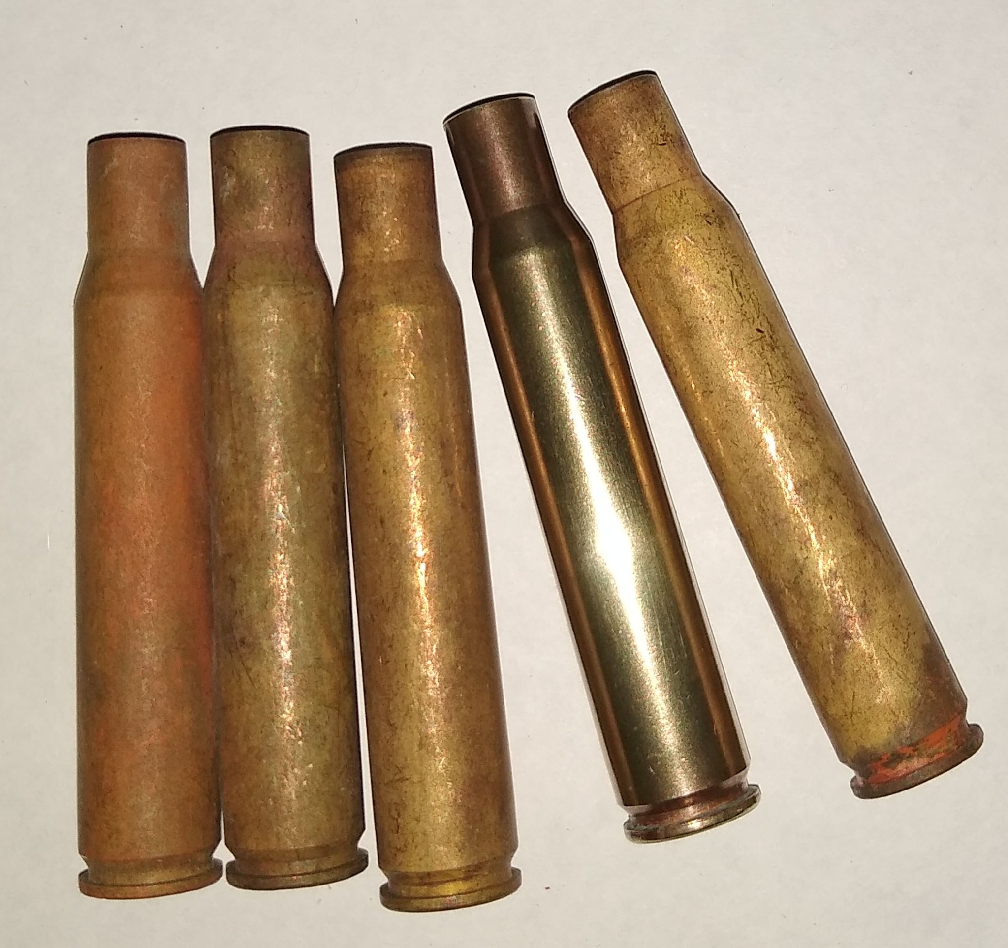

Original once fired 1942 LC & SL M2 cases ,which set outside for 63 years or more, before I acquired them and cleaned them . Reloaded and fired #50 times ,partial annealed every 4 Th. firing and haven't lost any other than the one's I cut to get an accurate wall thickness measure on . Not a single torn or chipped rim from the extractors ,which speaks Volumes for case composition and work hardening of the body and base
ALL were loaded within 1.0 Gr. of maximum listed IMR 4064 loads for M1 Garands . And had I realized at the time the damn trunion was stripped on MY Beater ,I could have had a NICE looking paper plate with a 150 Yd. great grouping ,as all 8 are there just low .

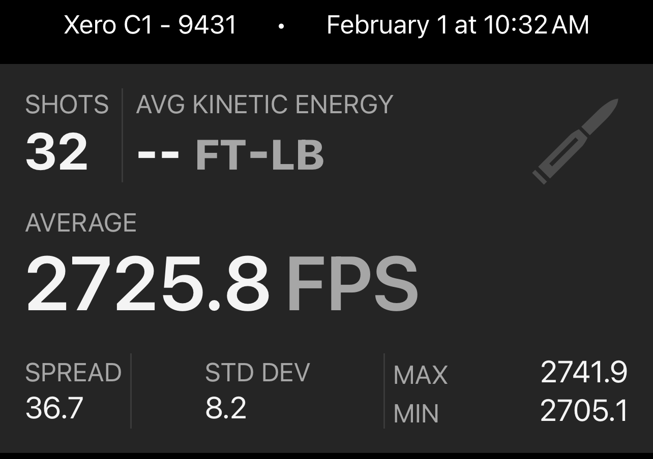

Selected from previous testing with Staball 6.5 and Berger 140 hybrids. It was summer in Texas😀
AIAT
26” bbl
COAL mean 2.825”
CBO mean 2.116”
Remington LRP
43.2gr Staball 6.5
Berger 140 Hybrid
N = 10
Velocity mean = 2790
SD = 9.4 fps
100°F
26%RH
288ASL
MagnetoSpeed Chrono
If SH reports are accurate at 0.38fps/F° change, then velocity should be ~2763fps at 32°F.
Regression of test data Velocity=88.333xGrains — 1036.3
Shoots well, fairly clean, flows like water in Dillon 550. YMMV. Be safe.

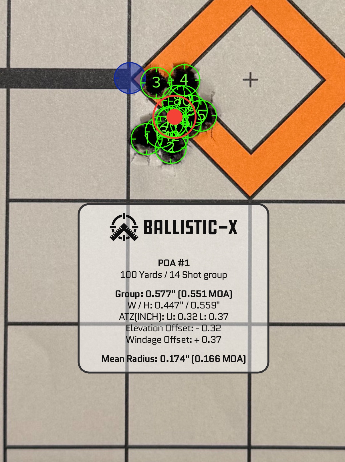

Update: Amazing results with N555 and 153 ATIPs. I only loaded 15 rounds, Peterson SRP brass, CCI BR4, 41.0 of N555 80 thou of jump. It was running 2625 avg with a 2.2 SD and 6.8 ES. Group was .551 MOA @ 100yds. I'll be loading more of this to verify.

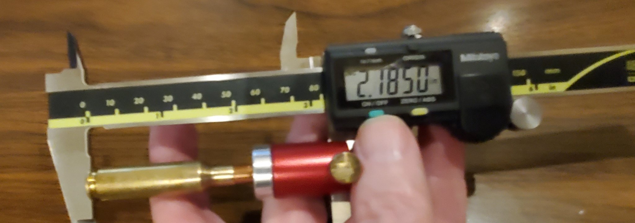

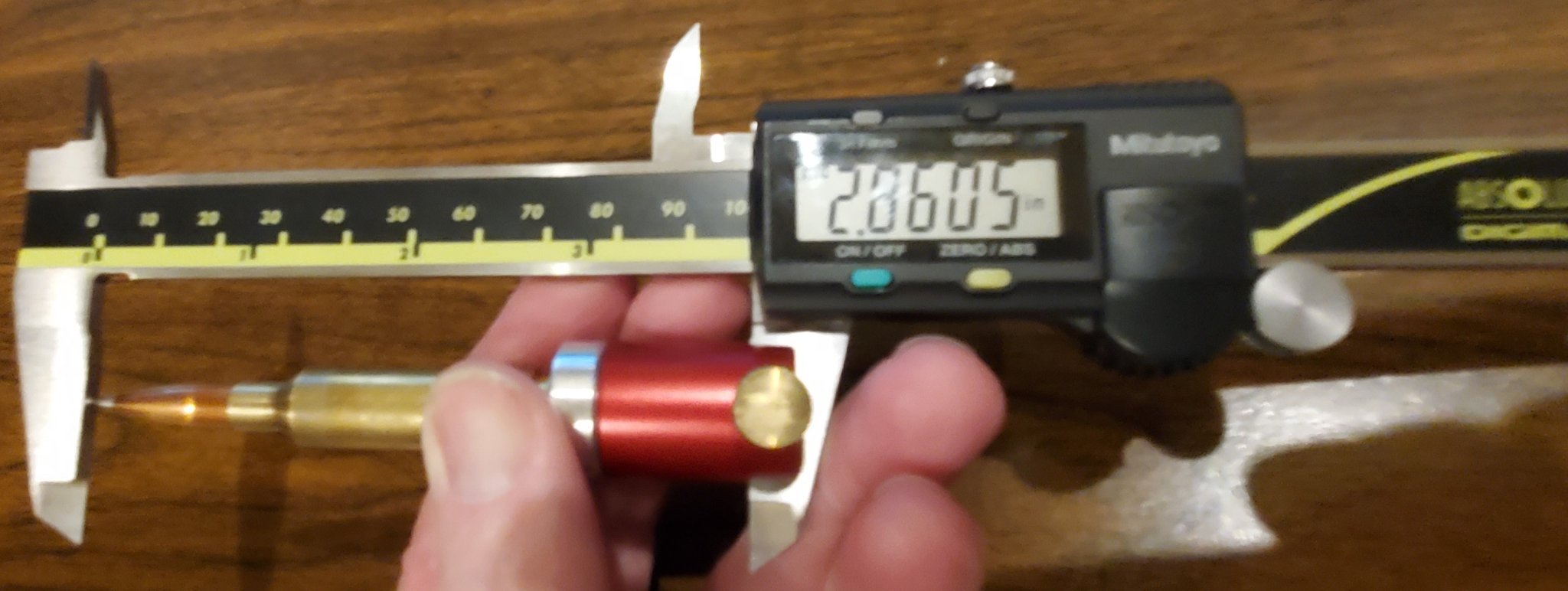

Am curious as to what seating depth you've used as the .080 jump doesn't tell me that since various chambers are different lengths. What was you2r COAL?
Using the SAC comparator my CBTO was 2.080".
It's not a 140. How fast do you want to push 153s out of a creed?
I can push the 153's up to about 2700-2720 but start getting over pressure signs. I don't see a good reason to run that hot, dispersion/ES/SD's open up and your throat is getting blasted away.
Reactions: stello1001
Thanks . . . but sorry, CBTO doesn't help me have a good idea regarding your seating depth. With your comparator showing 2.080, my comparator may measure your cartridge at 2.050 or 2.110 as there can be big difference in the size of the comparator holes. Like there's .067" difference in a measured CBTO when I compare one of my cartridges with my Hornady comparator to my Sinclair comparator. 😵‍💫
That's why I asked about COAL. :)
Reactions: Simonsza1
Copy that. COAL is 2.861 +/- .001
